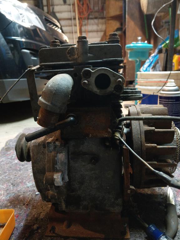

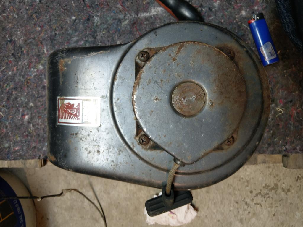

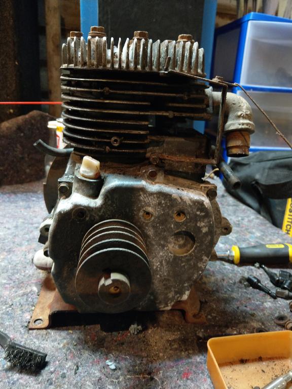

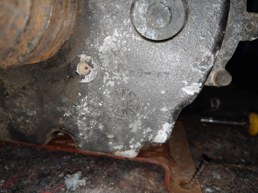

Can anyone help finding year of this tecumseh motor off a 603. I need a carburetor.

That engine is a replacement.Look for one for a H60.

Welcome @Nathan!  I recently tossed a Kohler carb on a Tecumseh and it runs pretty good!

:text-yeahthat:      Like Kevin said, the engine won't know what name is on the carb. as long as it is about the right size.  :techie-ebay: has lots of new aftermarket carbs at reasonable prices.

I would recommend a kohler carb. I say this because my daughters which use to be mine suped up workhorse 800. i mounted a 12 hp tecumseh on it years ago and got tired of the tecumseh carb never working right and i mounted a kohler carb and have never had another issue with it running. I did the fix back 1998 she is still going. But like 953 nut said you can find a carb on ebay just look at the reviews first there is alot of cheap crap that has to many flaws.
