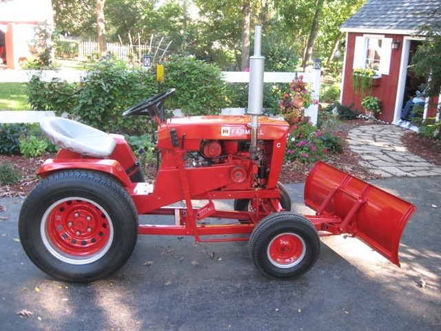

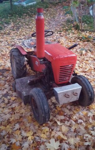

Here's my cherry bomb special
post-10921-0-60627200-1414409995_thumb.j
  • Like 6
Geno
Now that's a fat stack!   :handgestures-thumbsup:
My original pepper shaker pipe was so badly rusted there were no threads left to thread into the freshly chased block... so I had to do something.  That whole "it was laying around the shop" budget really helped with that one!

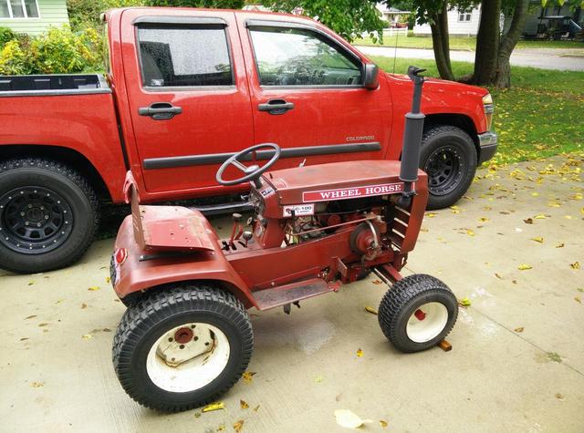

I better add mine. Its the typical, but I like it.  :)

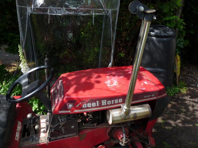

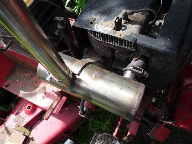

Here is the one I made for my 312-8 afer the original rusted through.
I made it from stainless & copied the original down to the internal volume, # of holes in the tubes etc because it is fitted with the Walbro non adjustable carb, but then bought a Kohler carb from Joe's outdoor power, it is very quiet  :UK:

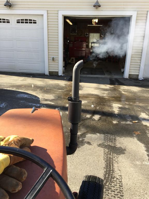

ronhatch
post-9096-0-98656000-1415122759.jpgI installed the typical Cub Cadet muffler on my 857 but what is different is how I supported it.  Instead of a 1" 90, I used a tee that is 1" x 1" x 1/2". Then I screwed in a 1/2" plug and taped a 3/8" hole in it so I could add 2 flat iron braces that go from the bottom of the tee to 2 exsiting 3/8" threaded holes in the block. I also like to cover the black pipe with chrome pipe that is used for kitchen and bathroom sink drains.

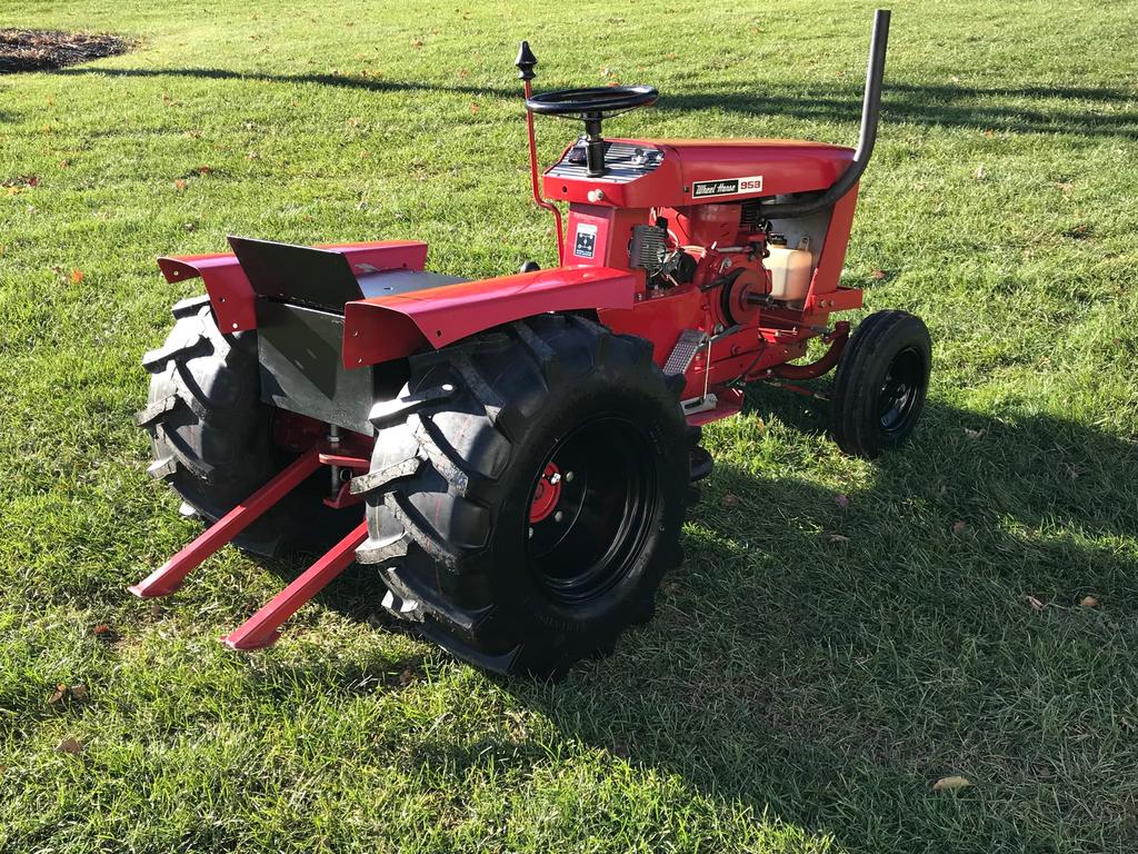

Good morning boys—time to resurrect a thread.  Unfortunately this one has A LOT of the old 3rd party hosting of pics, it is amazing to me how much that has changed in the last 5 years or so for the better.
Anyway, everyone on here who knows me knows that I’m a dyed in the wool Plow Dog (meaning I love furrow plowing with GT’s) and so on a plow mule (a GT setup for furrow plowing) nothing looks cooler than a big set of AG’s on the back, Tri ribs on the front, and a vertical stack beside the hood (although vertical stacks look cool on non plow mule tractors too:handgestures-thumbupright:).
Here’s just a couple of ours...

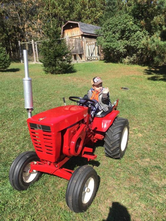

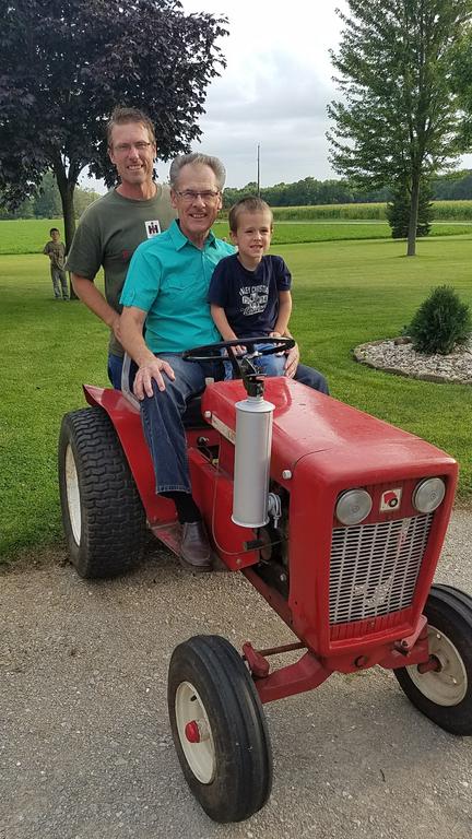

This is my dad’s 875 that we call the Iron Horse—he has owned it for 43 years and he installed this IH farmall Cub stack when he restored it the first time in 1979.  It is an authentic IH product and has been on the tractor nearly my whole life. I love the sound every time I hear it—takes me back to cutting lawn and working the ground and with it in the 1980’s.

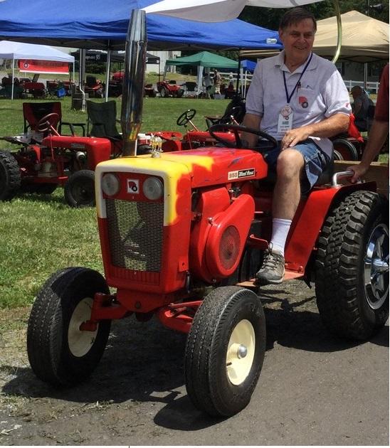

Also Dad’s tractor. His 953 that we call Clyde.  I’m not sure if the origin (maybe @Shynon can chime in) but it is a mellow sound and looks cool with the rain flapper!

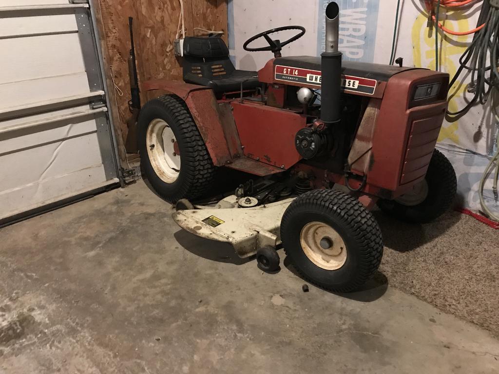

My son Zach’s GT14. We call it Blackbeard.  It has a Cub Cadet muffler off of an early 1970’s Cub.  I cut off the upper bracket and we painted it Black at Zach’s request.  Sounds mellow as well and have him the vertical stack he wanted soooo bad.
It's a cub cadet muffler from Tulsa engine warehouse, just cut the tip straight and cut of the bracket. Yes I agree I like the sound @WHX17 has one on the 702 also. IMO the height is correct for a garden tractor.
