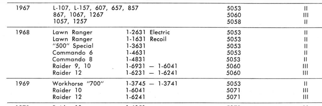

Handy Don 17,474 #11 Posted April 1 7 minutes ago, cafoose said: GT-14 all have limited slip? News to me. Perhaps the reference was to the longer axles in the GT-14 which could be paired with an LSD from elsewhere? 5060 and 5071 Unidrives are "6-speed with limited slip differentials". 5060 with aluminum endplates and 5071 with steel. Share this post Link to post Share on other sites
cafoose 3,839 #12 Posted April 1 3 minutes ago, Handy Don said: 5060 and 5071 Unidrives are "6-speed with limited slip differentials". 5060 with aluminum endplates and 5071 with steel. Is there a casting number or tag that identifies the different unidrives? Share this post Link to post Share on other sites

Handy Don 17,474 #14 Posted April 1 (edited) The external characteristics for “6-speeds” are: - 1-2-3-R shifter - Hi-lo shifter - No top-side hole for a dipstick - A 1” pipe extension on the oil fill at the lower left rear of the transaxle (allows filling oil to a higher level) - 5/8” (0.625) input drive shaft but it’s shorter than later 8-speeds’ (corrected 6Apr26 -- thanks @kpinnc) - A brake drum that brings the brake band to within an inch of the rear axle housing casting - A brake drum that turns clockwise when the tractor is moving forward There was at least one “8-speed” that also had a LSD--I think it was the 5073. This had a topside dipstick port and the brake drum was farther from the rear axle and turned counter-clockwise and had a ⅝” input shaft making it externally indistinguishable from an open-differential 8-speed. As for the rest, the link to the thread in @953 nut’s post (above) has the relevant information. Edited April 6 by Handy Don 2 2 Share this post Link to post Share on other sites
cafoose 3,839 #15 Posted April 1 9 minutes ago, Handy Don said: The external characteristics for “6-speeds” are: - 1-2-3-R shifter - Hi-lo shifter - No top-side hole for a dipstick - A 1” pipe extension on the oil fill at the lower left rear of the transaxle (allows filling oil to a higher level) - ¾” input drive shaft (that’s also shorter than later 8-speeds’ ⅝” shaft) - A brake drum that brings the brake band to within an inch of the rear axle housing casting - A brake drum that turns clockwise when the tractor is moving forward There was at least one “8-speed” that also had a LSD--I think it was the 5073. This had a topside dipstick port and the brake drum was farther from the rear axle and turned counter-clockwise and had a ⅝” input shaft making it externally indistinguishable from an open-differential 8-speed. As for the rest, the link to the thread in @953 nut’s post (above) has the relevant information. @stevasaurus Thoughts? Share this post Link to post Share on other sites
