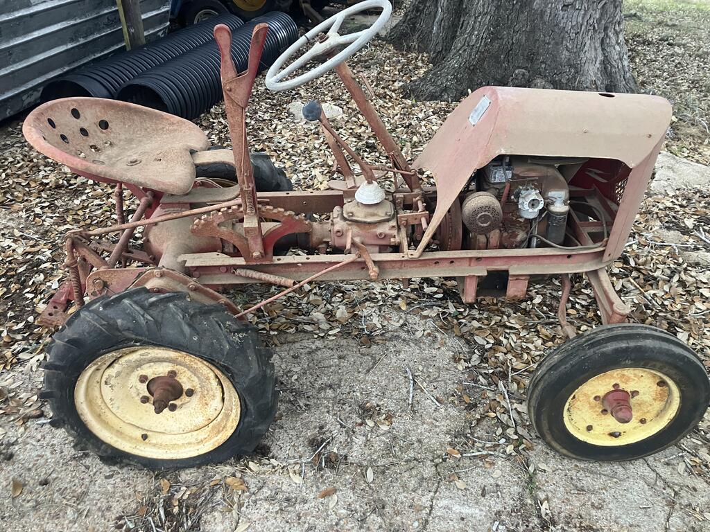

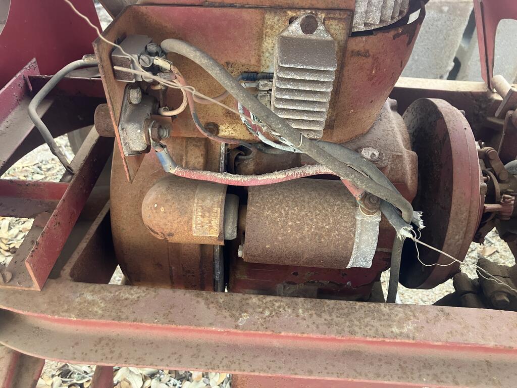

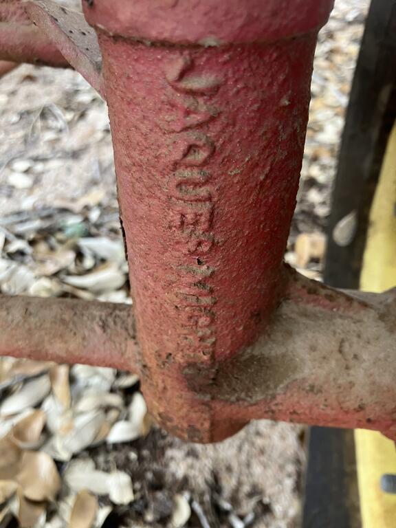

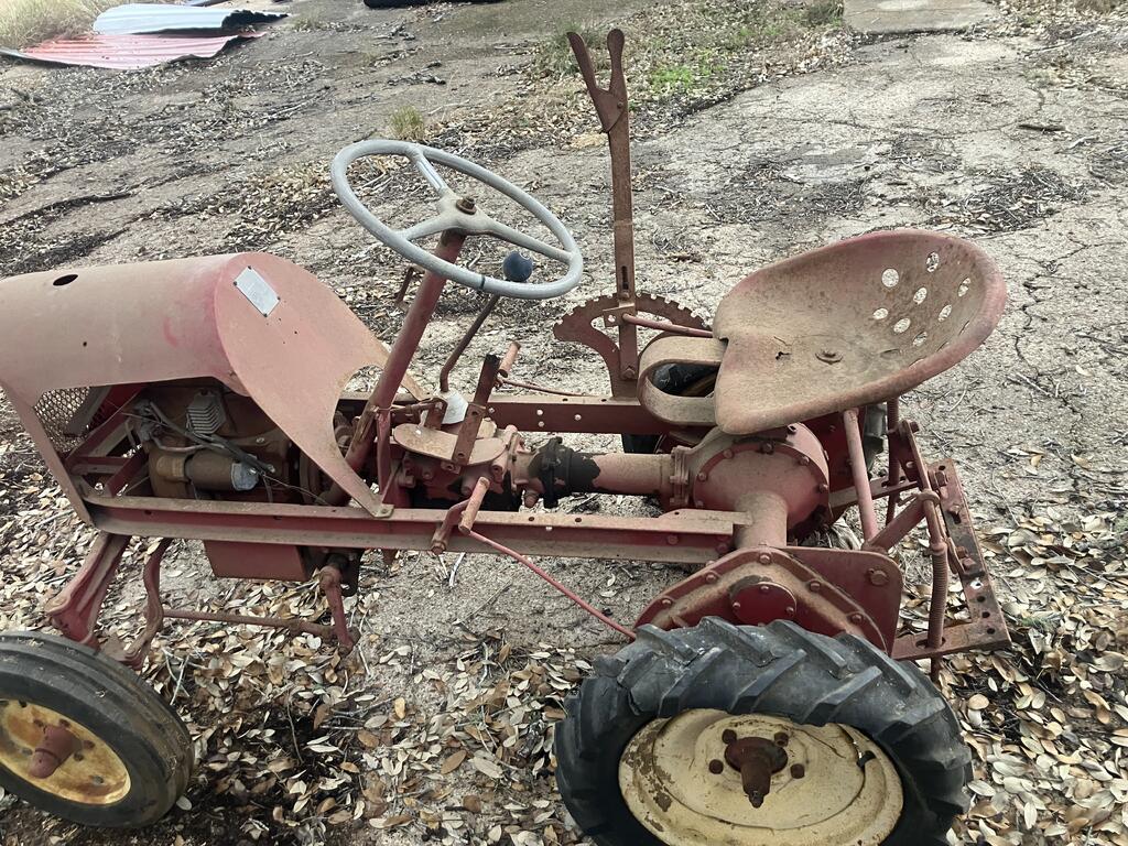

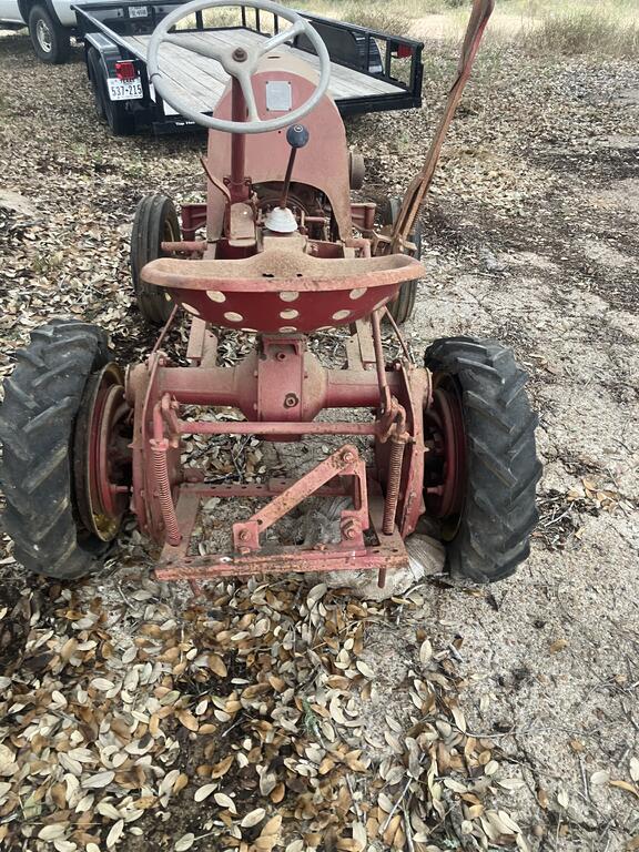

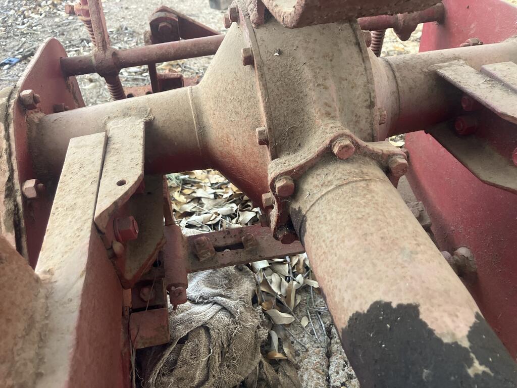

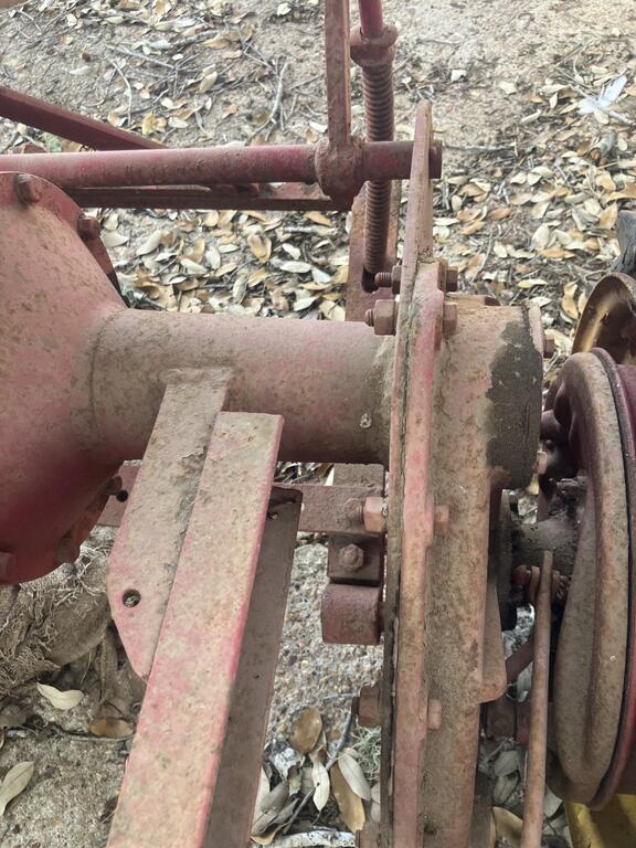

oliver2-44 11,751 #1 Posted December 15, 2025 (edited) The only tractor that was designed and built in Texas is this Jacques Mighty Mite model MM and the subsequent model 10. They were built between 1946-49 in Denison Tx. I believe @oldiron has a model Jaques model 10. I've had one of these on my someday list for quite a while. A special thanks to @Chrishar for finding and helping me haul it to the farm for short term storage. Since it was built in Texas, it's kind of on the level of a Pond RS83 to me. I think it is roughly the size of a Pond, and some what similar in design. They don't have the following that a Pond has, so thankfully they are not in that price range. I've read somewhere between 35500 to 5000 were built under a couple of different names/owners The angled bracket on the rear hitch was a plow mounting bracket. The front wheels are a 2 piece split rim, the same as on a David Bradley 2 wheel tractor or an early Sears/David Bradley The front axle has Jaques Mighty Mite cast into it. The original engine would have been a Briggs 23 or some later ones had twin cylinder Wisconsin's. Someone did a nice job of retrofitting an electric start Kohler K301 into it some wherein the past. The clutch linkage is stuck, but looks complete. I need to learn if this is the original "Twin-Disc" clutch o that was done when the Kohler was installed. It has the original foot and hand clutch, but the hand clutch handle has been modified I need to figure out was transmission this is. it is a 3 speed with reverse and a top access gearbox. The rear axle is a shortened Ford Model T "Banjo" axle. The rear axle has drop boxes on it made by Jaques, then looks like it uses the Ford Brakes and Hubs. Lots to do to get it working. Edited December 15, 2025 by oliver2-44 8 12 2 Share this post Link to post Share on other sites

953 nut 69,315 #3 Posted December 16, 2025 Here is the information I was able to put together a couple of years ago. Jaques power Saw Company was located in Austin, Texas. 1 1 Share this post Link to post Share on other sites
Achto 32,705 #4 Posted December 16, 2025 Nice score !!! Keep us updated on your progress please. 2 Share this post Link to post Share on other sites

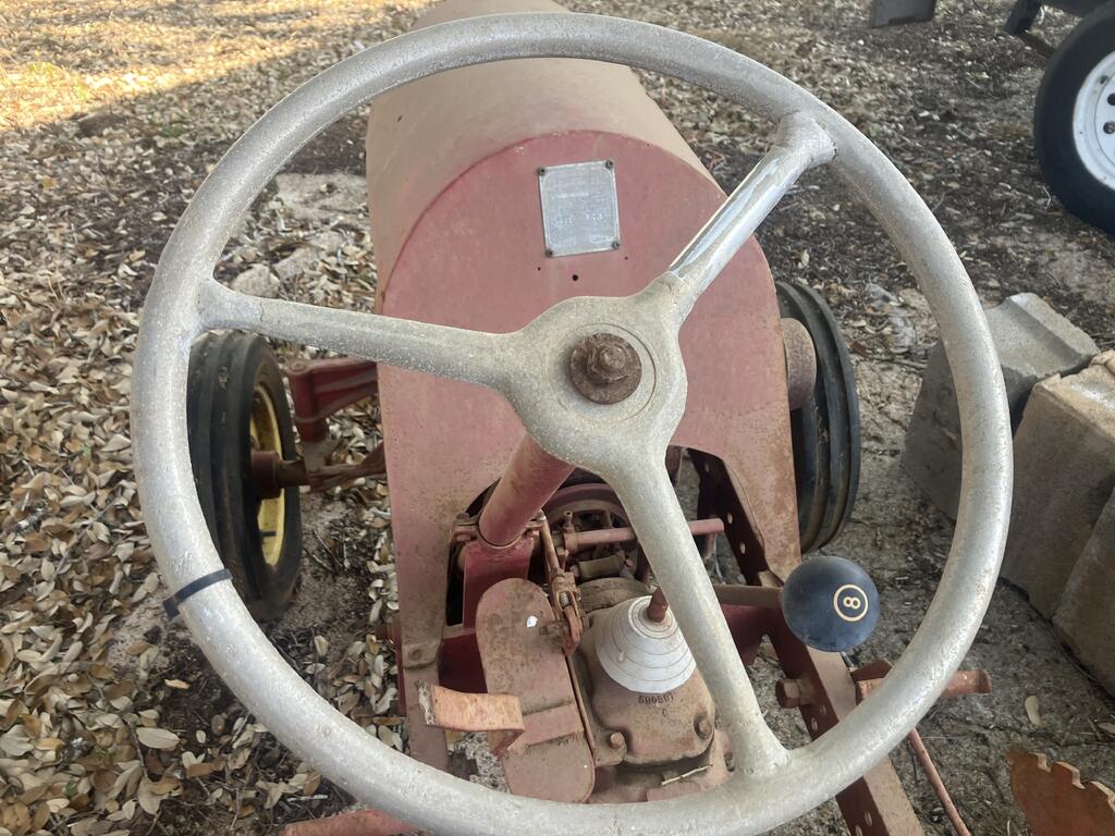

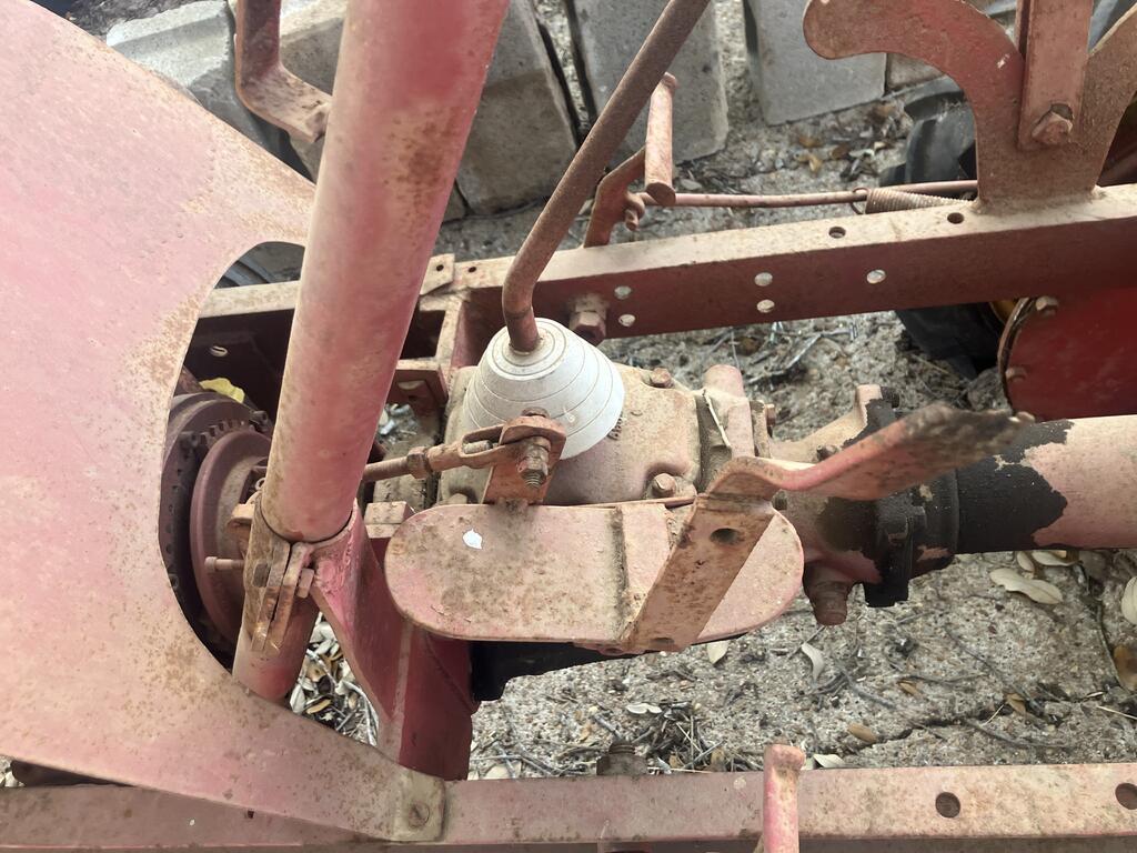

JoeM 10,267 #5 Posted December 16, 2025 I don't know how much I would change on that machine, just a time capsule right down to the 8 ball shift knob. 2 2 Share this post Link to post Share on other sites
rjg854 13,359 #6 Posted December 16, 2025 12 hours ago, Achto said: Nice score !!! Keep us updated on your progress please. 1 Share this post Link to post Share on other sites
oliver2-44 11,751 #7 Posted December 16, 2025 8 hours ago, JoeM said: I don't know how much I would change on that machine, just a time capsule right down to the 8 ball shift knob. wow, I didn't see that 8 ball yet. So much to look at at figure out, especially the clutch and rear brake linkage and assemblies. For now I want to get it running. I'll start out keeping it original. If I end up with a lot of disassemble for repairs it might end up going the restoration route. 2 3 Share this post Link to post Share on other sites

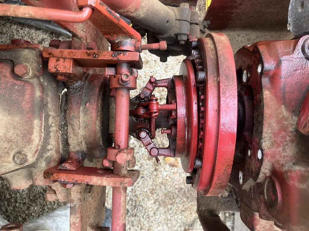

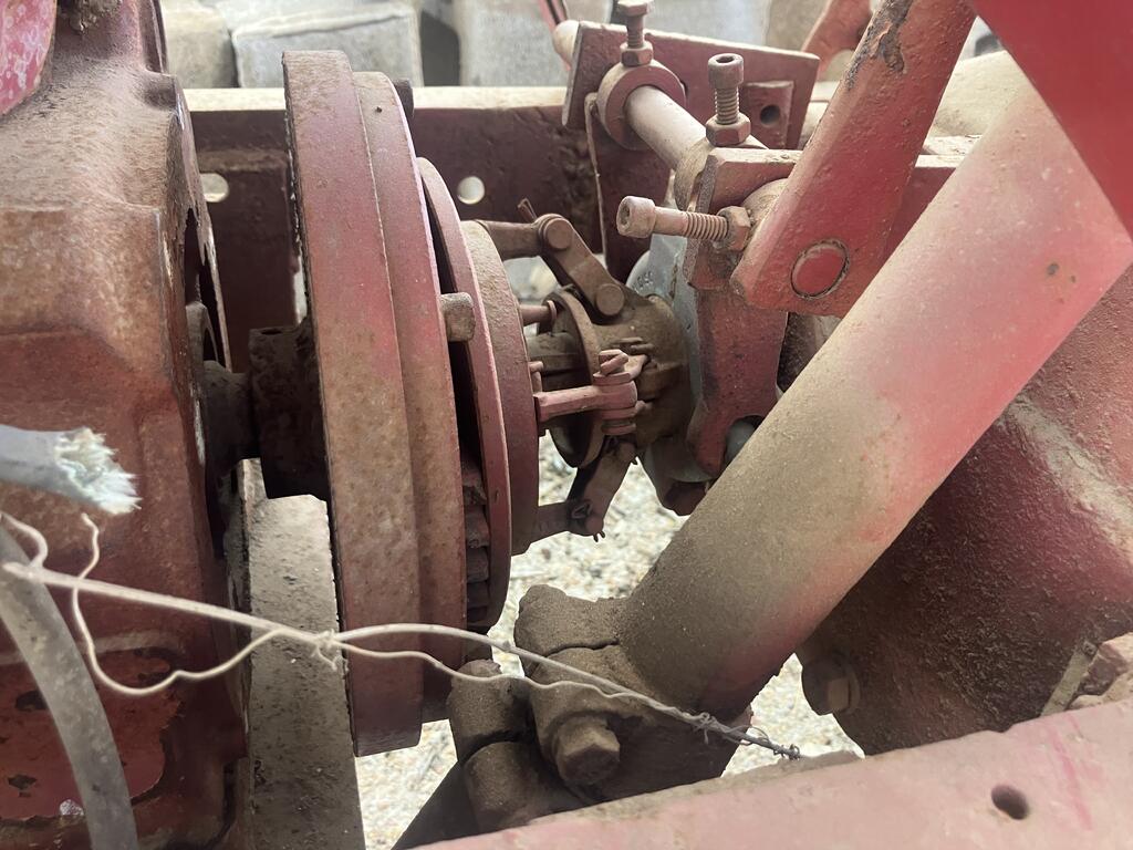

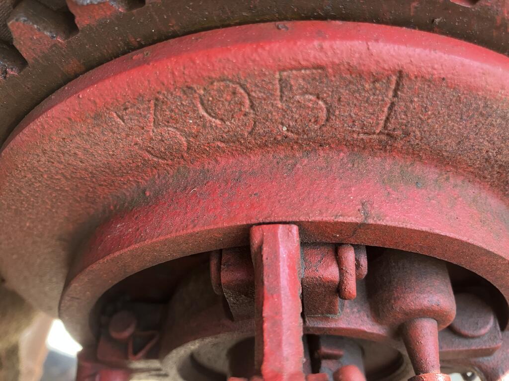

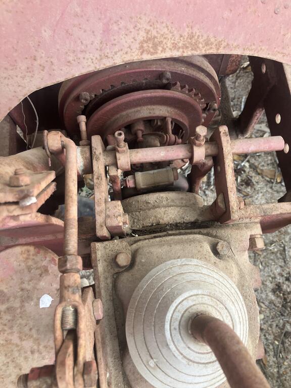

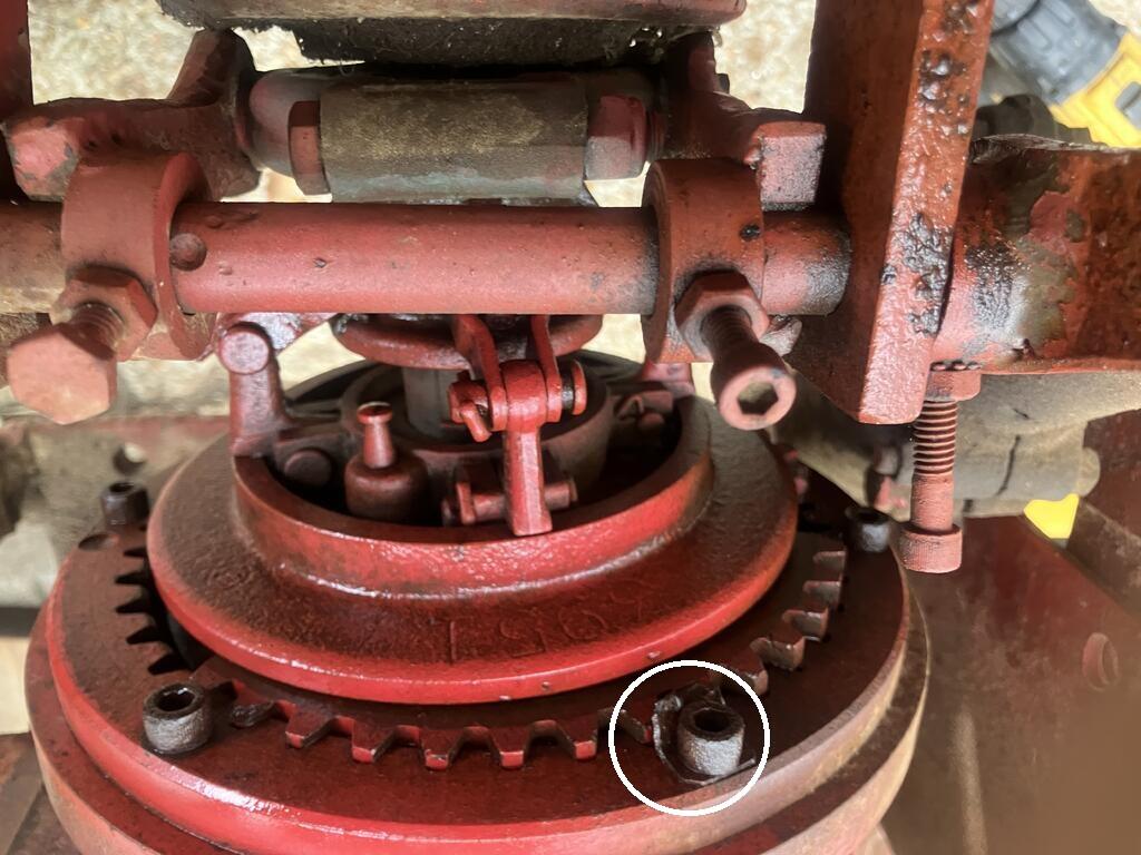

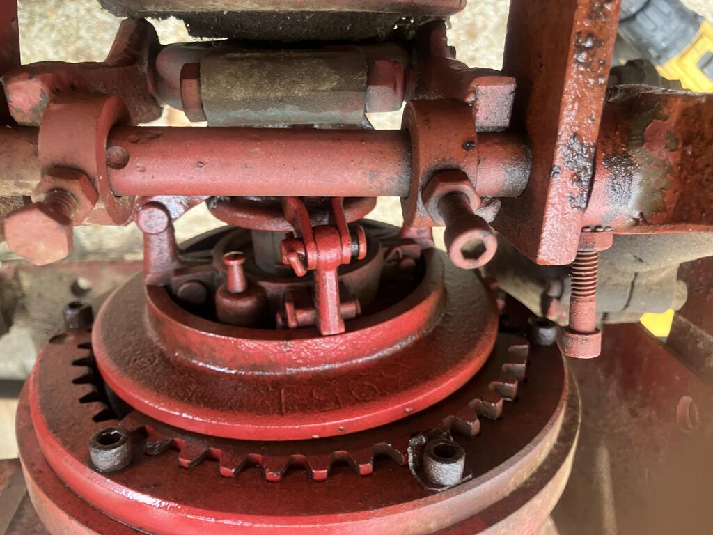

oliver2-44 11,751 #8 Posted December 19, 2025 Had the hood off today and got some of the clutch linkage freezer up by soaking it with Kroil last week. Here some pictures of the clutch assembly. I think the throw out bearing on the left side of the picture is still frozen keeping it from sliding on the shaft Does any one recognize this clutch. I don’t understand the ring with the teeth engaging into the flywheel. It’s almost like it’s a steel teethed clutch instead of a flat clutch disc. @oldiron @kpinnc @Pullstart @953 nut 2 2 Share this post Link to post Share on other sites
953 nut 69,315 #9 Posted December 19, 2025 9 hours ago, oliver2-44 said: any one recognize this clutch. I don’t understand the ring with the teeth engaging into the flywheel. It’s almost like it’s a steel teethed clutch instead of a flat clutch disc Don't recall ever seeing a clutch like that. The teeth engaging the flywheel could have been to lock out the device being driven don't know. looks like the two gear halves could only be engaged at one portion of the flywheel, once again, why? I've worked on combine and hay baler clutches and tractor clutches but none like that. Of course that clutch isn't heavy enough for those applications anyway. Perhaps a winch would have an in-out clutch to allow free wheeling to extend a cable then lock the two clutch halves together for pulling. Just a guess. The tab under one of the socket-head bolts seems to be latching the two pieces together, guess that was a retrofit to allow it to work in its new configuration. 1 Share this post Link to post Share on other sites
Pullstart 71,248 #10 Posted December 19, 2025 Wow Jim, that is a cool machine! I have never seen a clutch like that, but the mechanicals of it kind of make me love it! Congrats on the score, and lots to look at, reverse engineer, and marvel at! 2 Share this post Link to post Share on other sites
Handy Don 17,474 #11 Posted December 19, 2025 I realize it isn’t fully functional yet, but I’m wondering if there are both a pressure plate and toothed parts. The plate for transition from stopped to moving and the teeth as a cruder version of the “lockup” in early automatic transmissions. 2 Share this post Link to post Share on other sites
