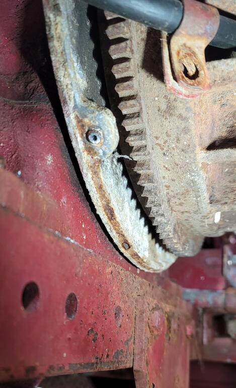

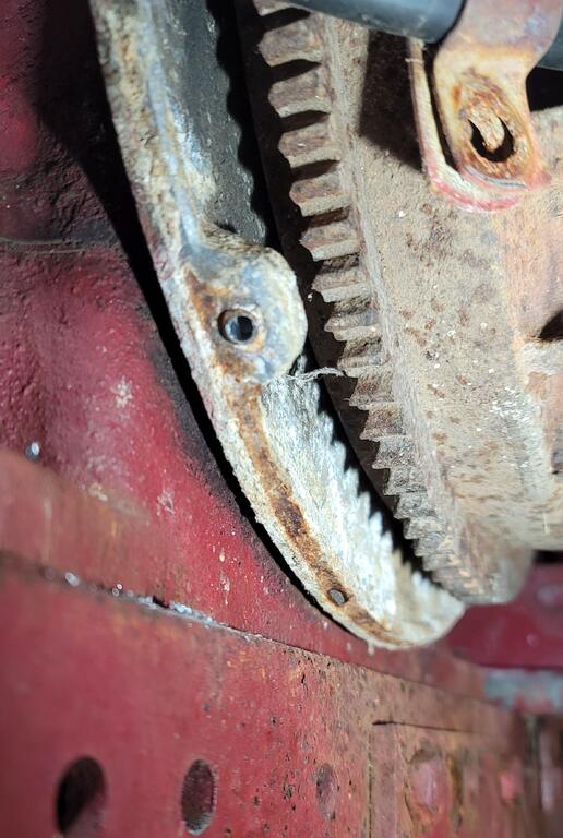

BradKahler 407 #35 Posted December 7, 2025 (edited) I needed to remove the fan shroud so I could blow out the mouse nest. As luck would have it one of the bolts snapped off. This was the bolt on the lower left corner when looking at the shroud. I didn't want to leave it like that but I also didn't want to remove the flywheel so I figured I might as well at least try and drill it out and re-tap the hole. I have a 12" long set of drill bits in 1/16" increments so I decided to give it a try. I started with the 1/16" and succeeded in getting it centered and drilled all the way through the bolt remnants. Next was the 1/8" and then the 3/16". I don't have a long #7 drill bit so I had to settle for trying to use the 1/4-10 tap in an undersized hole and see what would happen. My biggest fear was breaking the tap off. I didn't have a long enough tap handle so I had to settle for a small wrench to turn the tap. Beyond all expectations I managed to succeed with the tap. I hope to never have to try that again The tip of the tap sticking through the hole is shown circled in red in the last picture. 1/16" drill bit 1/8" drill bit The tip of the tap as it broke through. Edited December 7, 2025 by BradKahler 3 3 1 Share this post Link to post Share on other sites
Handy Don 17,474 #36 Posted December 8, 2025 1 hour ago, BradKahler said: This was the bolt on the lower left corner when looking at the shroud. Your patience and care paid off. Nice job. Mine came to me with this hole stripped so now I have one shroud bolt that is larger than all the rest. 😄 1 Share this post Link to post Share on other sites
BradKahler 407 #37 Posted December 8, 2025 1 minute ago, Handy Don said: Your patience and care paid off. Nice job. Thanks 😊 1 minute ago, Handy Don said: Mine came to me with this hole stripped so now I have one shroud bolt that is larger than all the rest. 😄 Better an oversize bolt than no bolt. 2 Share this post Link to post Share on other sites
Handy Don 17,474 #38 Posted December 8, 2025 1 minute ago, BradKahler said: Better an oversize bolt than no bolt. I was afraid there wouldn’t be enough metal left after bringing the hole to the right size and then tapping it, but so far so good. 3 Share this post Link to post Share on other sites
BradKahler 407 #39 Posted December 8, 2025 30 minutes ago, Handy Don said: I was afraid there wouldn’t be enough metal left after bringing the hole to the right size and then tapping it, but so far so good. That's a valid concern, especially in a aluminum. 3 Share this post Link to post Share on other sites

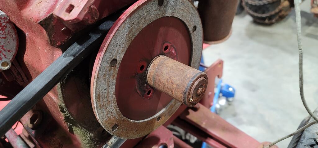

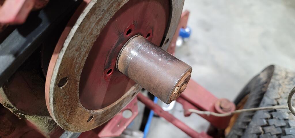

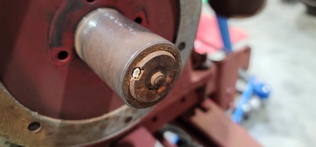

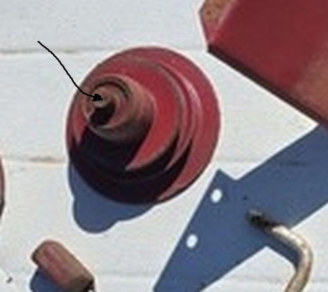

BradKahler 407 #42 Posted December 8, 2025 Unfortunately the PTO pulley had been pulled off by someone a number of years ago. The pulley itself is in good condition, however the bearing race is pretty corroded. I used some scotch-brite to see if it would polish up but it's not going to. The bearing race itself appears to be frozen to the shaft. I've done some searching but the only thing I found was to use a bearing separator. I don't have one large enough. It appears that even if I found one large enough, it wouldn't fit behind between the disc and the drive pulley. Suggestions on how I should proceed? 1 Share this post Link to post Share on other sites
ebinmaine 80,709 #43 Posted December 8, 2025 4 hours ago, BradKahler said: Suggestions on how I should proceed? @pfrederi @953 nut @Handy Don Any help here? 2 Share this post Link to post Share on other sites
Handy Don 17,474 #44 Posted December 8, 2025 4 hours ago, BradKahler said: Suggestions on how I should proceed? 3 minutes ago, ebinmaine said: Any help here? I've been fortunate. I’ve encountered a badly rusted outer shell with the pulleys but never a rusted inner race. If you’ve decided it is scrap, you might consider grinding notches in it or welding on a trio of large hex nuts so that your 3-jaw puller can get a grip. Of course, a multi-day course of penetrant in advance is always a good idea. 2 Share this post Link to post Share on other sites

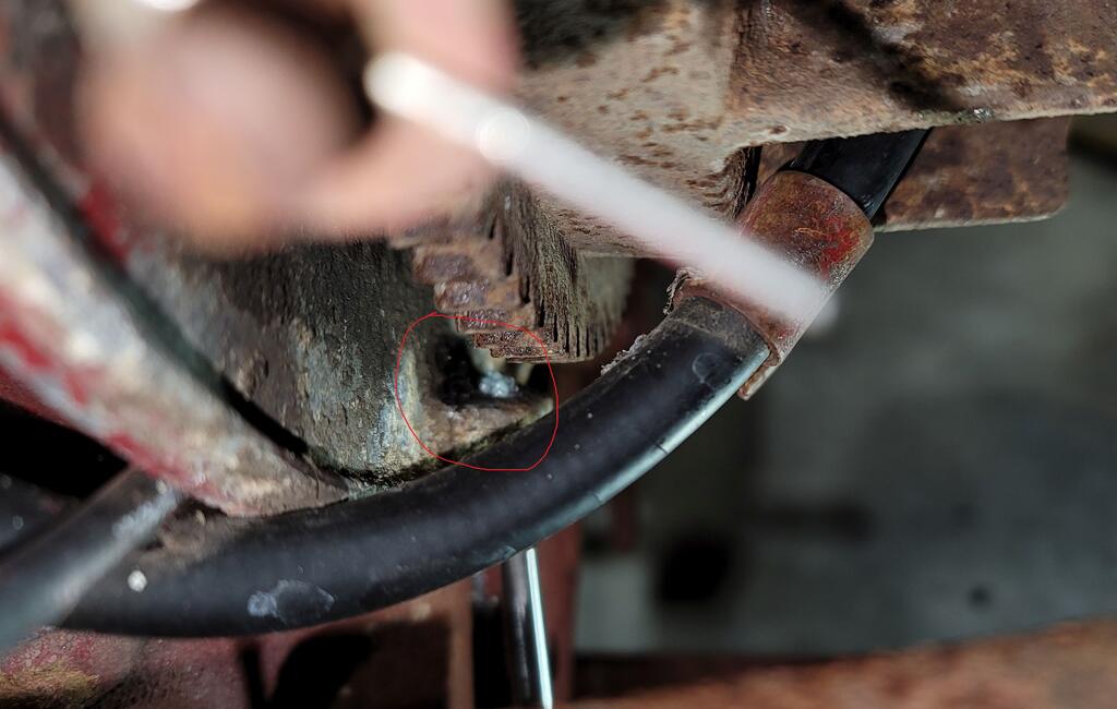

BradKahler 407 #45 Posted December 8, 2025 (edited) 18 minutes ago, Handy Don said: I've been fortunate. I’ve encountered a badly rusted outer shell with the pulleys but never a rusted inner race. If you’ve decided it is scrap, you might consider grinding notches in it or welding on a trio of large hex nuts so that your 3-jaw puller can get a grip. Of course, a multi-day course of penetrant in advance is always a good idea. I might have just figured out why the PTO pulley was removed. In the attached picture, it looks like a stud has been broken off at the end of the crankshaft. I suppose I'm going to have to carfully drill it out and clean up the threads. As for the bearing race, I can feel roughness on the surface of the race so I think replacing it is the safer approach. I was wondering if welding something on the race that a puller could bite on. Thanks for the suggestion. Edited December 8, 2025 by BradKahler 1 Share this post Link to post Share on other sites
Handy Don 17,474 #46 Posted December 8, 2025 (edited) I”m not familiar with any studs/bolts in the ends of crankshafts except on engines spec’d for electric clutches. The outer bell of the style of PTO shown in your picture is held in by a thrust bearing in the bell linked via a stub shaft to the outer bail of the PTO actuator linkage. Edited December 8, 2025 by Handy Don 1 Share this post Link to post Share on other sites

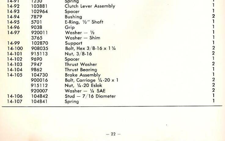

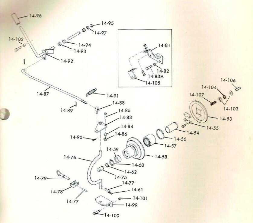

BradKahler 407 #47 Posted December 8, 2025 9 minutes ago, Handy Don said: I”m not familiar with any studs/bolts in the ends of crankshafts except on engines spec’d for electric clutches. The outer bell of the style of PTO shown in your picture is held in by a thrust bearing in the bell linked via a stub shaft to the outer bail of the PTO actuator linkage. In the parts list below, item 14-106 is listed as a 7/16 stud. I was assuming that was what was in the end of the crankshaft. 1 Share this post Link to post Share on other sites
Handy Don 17,474 #48 Posted December 9, 2025 (edited) You’re referring to 14-106. The stub shaft 14-75 with cir-clip 14-62 hold the bell. I can recall hearing that on some models there was a spring that pushed the bell away from the clutch plate when the PTO was disengaged but I’ve never seen one. I strongly suspect it was eventually deemed unnecessary. It isn’t on any of the 3- and 5- series PTOs I’ve had apart. @c-series don @squonk @Achto have ¢2 to add here? Edited December 9, 2025 by Handy Don 2 Share this post Link to post Share on other sites
BradKahler 407 #49 Posted December 9, 2025 4 minutes ago, Handy Don said: You’re referring to 14-106. The stub shaft 14-75 with cir-clip 14-62 hold the bell. I can recall hearing that on some models there was a spring that pushed the bell away from the clutch plate when the PTO was disengaged but I’ve never seen one. I strongly suspect it was eventually deemed unnecessary. It isn’t on any of the 3- and 5- series PTOs I’ve had apart. @c-series don @squonk @Achto have ¢2 to add here? So when the PTO wasn't engaged the spring would push the bell outwards towards the brake pad? I'm still trying to make sense of all this stuff Is the black arrow pointing to 14-75? 1 Share this post Link to post Share on other sites
953 nut 69,315 #50 Posted December 9, 2025 6 hours ago, BradKahler said: Suggestions on how I should proceed? If you make up a plate with four holes that line up with your pulley holes and three equally spaced notches for a three jaw puller you could bolt it to the pulley with spacers and use a three jaw puller to remove the entire disc and bearing race as a unit. Frequent applications of penetrating oil in advance and a bit of heat while pulling will probably help. 3 1 Share this post Link to post Share on other sites
