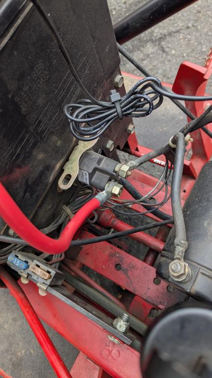

Alrashid2 476 #19 Posted November 22, 2025 8 minutes ago, kpinnc said: What does the battery itself settle at? With the tractor switched off, your battery should be about 12.6VDC. I would think anything between 12.2 and 12.8VDC would be ok. Check it with a multimeter, not through the key switch and on board voltmeter. Yup I checked with a multimeter. My dash gauge is pretty close to accurate. Off the battery is at 12.6V. will monitor! You guys think my starter solenoid is ok like this? Share this post Link to post Share on other sites
Handy Don 17,186 #20 Posted November 23, 2025 3 hours ago, Alrashid2 said: You guys think my starter solenoid is ok like this? As long as there is clean electrical contact and the cable lug stays nice and snug, it’ll do just fine. Good on-the-fly remediation! 1 Share this post Link to post Share on other sites
Alrashid2 476 #21 Posted November 23, 2025 14 hours ago, Handy Don said: As long as there is clean electrical contact and the cable lug stays nice and snug, it’ll do just fine. Good on-the-fly remediation! Thanks for weighing in! I got it nice and tight and I put a sharpie witness mark too to double check it doesn't loosen up! Share this post Link to post Share on other sites
