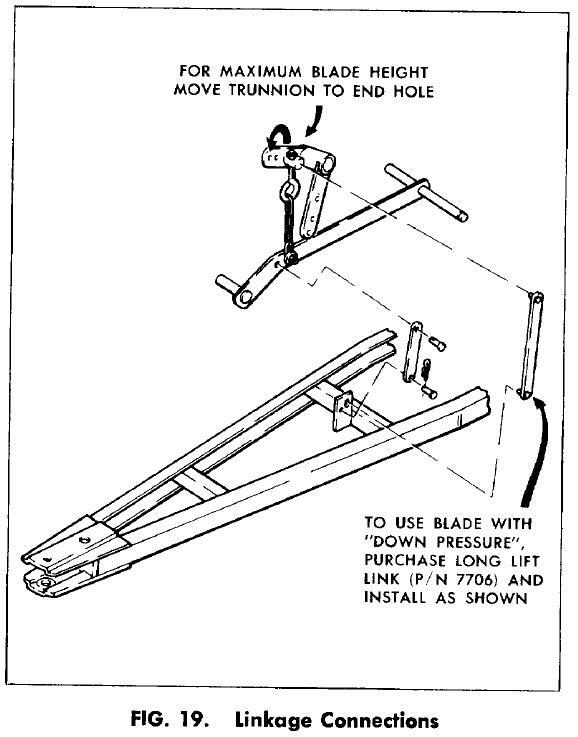

eo1bart 54 #1 Posted July 9, 2025 Hello, I recently purchased 1985 Wheel Horse 312-8, and am getting it set up with a 37" mower. I will also be using it for snow plowing next winter. My machine does not have a lift level adjustment bolt with the black knob. Is it possible to add this? I've seen the assembly for sale used. Next question is regarding how to install the long link for down pressure on the snow blade. Does this eliminate the chain and short link? It's hard to tell from the diagram. Thanks Bob Share this post Link to post Share on other sites

kpinnc 19,107 #3 Posted July 9, 2025 (edited) You're referring to the "dial-a-height" adjuster I think. The mechanical portion of this is available as a used part. There is no modification required on the frame and center column to add this. As @rick said, the outer covers can be cut to allow the adjuster barrel to pass through, or you can also find those parts as well that are already notched for the adjuster. Check the vendor section. They probably have what you need. And yes, the solid link replaces the chain on the lift arm. Edited July 9, 2025 by kpinnc 2 Share this post Link to post Share on other sites

eo1bart 54 #5 Posted July 9, 2025 1 hour ago, Handy Don said: Be sure to understand that the dial-a-height isn’t intended to govern the cutting height of the mower deck--that is by controls on the deck itself. It can be useful for setting a minimum height for the snow/dozer blade, a blower, or a mid-mounted grader blade, for instance. Sounds the solid bar and dial-a-height combo is just what I need for plowing. Part of my driveway is asphalt, so I'll want the down pressure. The other part of the driveway is 3/8" stone, so I'll want to keep the blade up a bit to keep from bulldozing the stone. Thanks 2 Share this post Link to post Share on other sites
