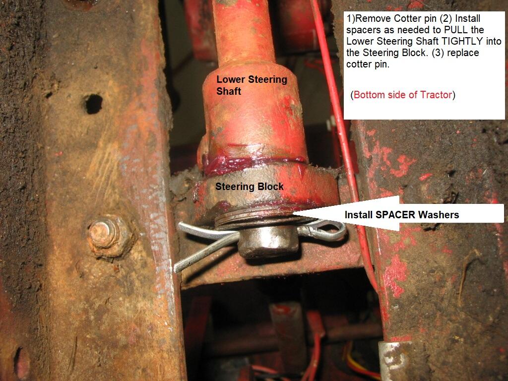

953 nut 60,097 #2 Posted April 7 Go to the Hillman cabinets and buy an assortment of 3/4" round shim washers and put in as many as needed to push the fan gear forward toward the pinion. 4 2 Share this post Link to post Share on other sites

953 nut 60,097 #6 Posted April 7 (edited) 17 minutes ago, Horse Newbie said: Would this work with gear reduction steering on a 1994 520 H ? As Mike pointed out it could be a cracked/broken steering support block. If the play is between the fan gear and pinion it would. If it is too bad you may have to remove the block, drill it out and put in a bushing but most times just bushing the fan gear will do the trick. The shim washers go behind the steering block between the block and the roll pin/cotter key. @cleat has pictures in his excellent thread. Edited April 7 by 953 nut 2 Share this post Link to post Share on other sites

kpinnc 14,652 #9 Posted April 7 48 minutes ago, Horse Newbie said: Would this work with gear reduction steering on a 1994 520 H ? The reduction steering fan mount usually has shims underneath it. If you don't see any under the fan mount, let me know. I have some that we can "copy" if you want to. 3 Share this post Link to post Share on other sites

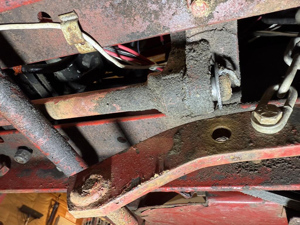

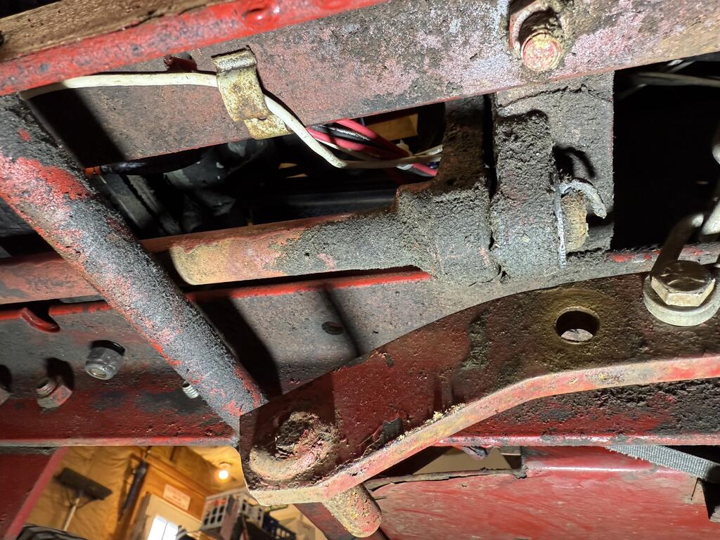

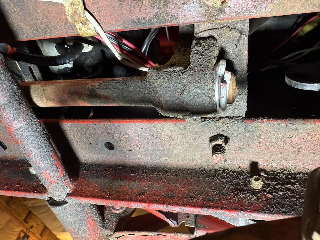

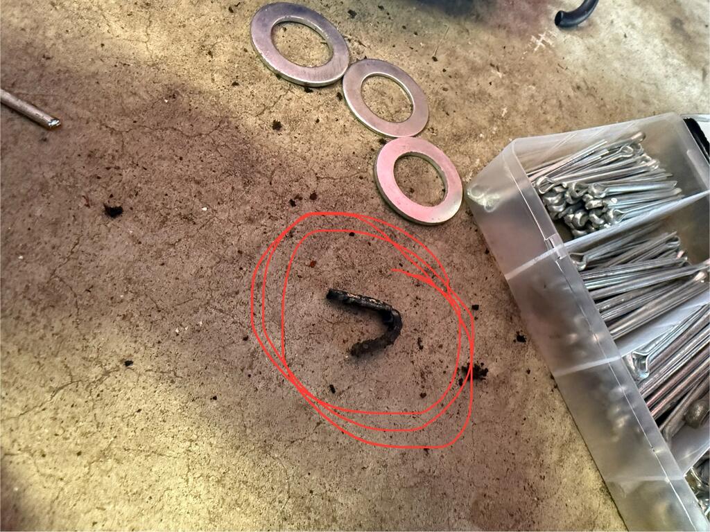

Sparky-(Admin) 23,169 #16 Posted April 10 Steering block was solid with no cracks. Closer inspection showed the cotter pin almost completely worn thru (what was left of it is circled in red). Pictures 2 & 3 show how much front to back slop the lower steering shaft had. Added one thick and one thin shim and a new cotter pin and she’s good as new! 1 4 Share this post Link to post Share on other sites
squonk 43,843 #17 Posted April 10 @Sparky Is that engine mounting bolt loose ? 1 Share this post Link to post Share on other sites
Sparky-(Admin) 23,169 #18 Posted April 10 34 minutes ago, squonk said: @Sparky Is that engine mounting bolt loose ? Hmmm…good eye Mike! The 308 is still in the garage so I’ll have to crawl back under and see 4 Share this post Link to post Share on other sites
squonk 43,843 #19 Posted April 10 All that work and you didn't even "disturb the grease!" 2 3 Share this post Link to post Share on other sites
953 nut 60,097 #20 Posted April 11 15 hours ago, squonk said: didn't even "disturb the grease!" That ain't grease, it is rustproofing material. 4 1 Share this post Link to post Share on other sites
Sparky-(Admin) 23,169 #21 Posted April 11 @squonk Tuned out BOTH the bolts holding the engine mounting plate (rear) were loose! Thanks again… 5 Share this post Link to post Share on other sites
