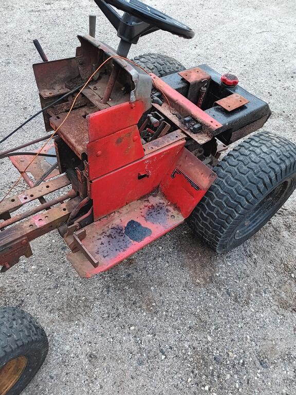

ebinmaine 74,182 #1 Posted November 24, 2024 I got this rolling chassis from @PWL216 to use the parts for changing our own "Ugly Bruce" C121 over to Hydro lift. We believe the transmission should be good so I'd like to set it aside in case we need it. What's the best way to store a Hydro for the long term? @daveoman1966. @pfrederi @953 nut Share this post Link to post Share on other sites

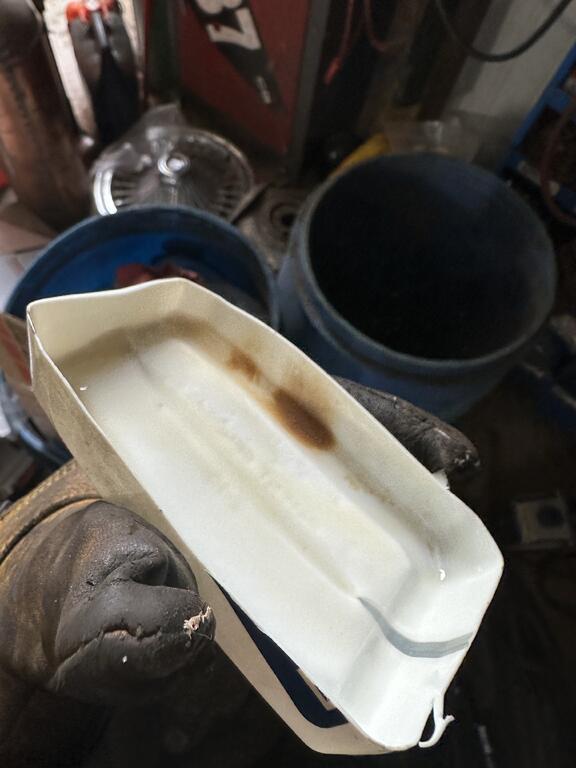

Pullstart 67,734 #16 Posted November 24, 2024 I recently used an old quart of oil. Mainly to cut the bottle and use it as a funnel. This is what we found in the bottom. @ebinmaine mentioned additives settling out. 3 Share this post Link to post Share on other sites
squonk 44,402 #17 Posted November 24, 2024 2 hours ago, Pullstart said: I recently used an old quart of oil. Mainly to cut the bottle and use it as a funnel. This is what we found in the bottom. @ebinmaine mentioned additives settling out. Are those gloves or " elephant paws?" 1 Share this post Link to post Share on other sites
