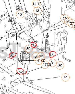

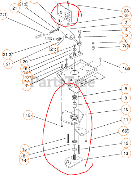

JoeM 9,937 #11 Posted November 21, 2024 I have been into all of those components and did put the power steering on a 520xi. Keep in mind, that is pretty much the first parts installed in the main frame. Easy, not really, but very doable, but I tend to color outside of the lines. The doner machine would be real nice, but not necessary if you can get someone to supply all the parts. The best way of swapping out is to remove the tower (4 bolts and wiring need to be disconnected) with the hydraulics/steering valve, steering wheel and tilt assy. in one shot. leaving the hoses hooked up to the cylinders. The lower steering gear will have to be replace too, as it is different. The tie rods are the same. The hydraulic lines to the hydro are different. Also, there is a bracket on the left side of the frame that has ears to hold the rear of the steering cylinder. A note about the LXI, it has a different wiring arrangement for the ignition. Hope this helps. 522xi 2 Share this post Link to post Share on other sites
