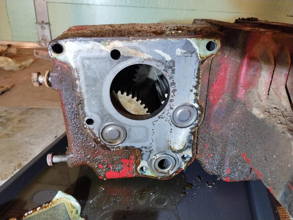

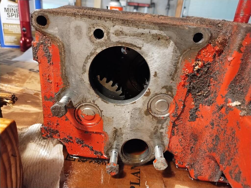

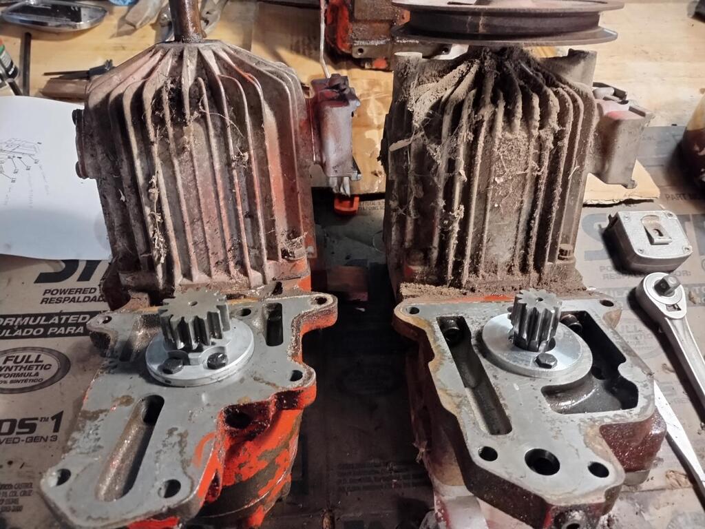

RoadScholar 23 #34 Posted June 29, 2024 Hoo Boy, up to my neck in the Big Muddy on this transaxle swap. I've hit a wall and need some info before proceeding further. As some of you know, I picked up a free transaxle and hydro unit at the WHCC event -- I couldn't see any ID marks but the transaxle case visually matched the broken one from my C-120. So, for free, what the heck, I took it home with me. It was clear that the two hydro units were different, and after i got the freebie on the bench and cleaned up a bit, I found the heavily encrusted ID tag, which revealed it to be a 90-2046. The still-functioning hydro unit from my broken transaxle is a 90-1136. The transaxle mounting bolt patterns appeared to be the same, except the 90-2046 has 5 bolts, and the 90-1136 has only 4. So, I went ahead and took the two hydro units off their respective transaxles, and that's where the collision with the wall occurred. The driver gear on the motor shaft of the 90-2046 is smaller than the motor gear on the 90-1136, and correspondingly, the mating transaxle gear, Here's the 90-2046: And the 90-1136: The other thing I have noticed about the 90-2046 is that it does not have a push valve like the 90-1136. So, obviously, the hydro swap to the new transaxle appears to be not feasible. I'm not up for going down the rabbit hole of opening the transaxles and swapping parts around. The main question I have is: Can i just go ahead and use the "new" transaxle with the 90-2046 to replace the cracked tranny on my C-120? Other than the push valve issue, everything else seems to fit -- the parking brake linkage, transaxle mounting holes, and the cam follower linkage all look to line right up. For the record: here are the two units side by side. You can see the gearing difference (90-1136 is on the right), I'm guessing with the gearing change, I might end up with more power but less speed. But, does anyone see any land mines buried in that path forward? Thanks! 1 Share this post Link to post Share on other sites

stevasaurus 23,892 #36 Posted June 29, 2024 There is one thing to know about hydros...things need to be super clean, spotless. Those pumps and outside cases should have been steam-cleaned before opening. Any of those grass bits could could kill your project. 1 Share this post Link to post Share on other sites

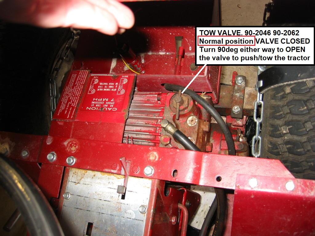

daveoman1966 3,885 #37 Posted June 29, 2024 The other thing I have noticed about the 90-2046 is that it does not have a push valve like the 90-1136. The PUSH/TOW valve for the 90-2046 hydrogear is on the top of the pump end cap---not the side lie the C-120. 1 Share this post Link to post Share on other sites
kpinnc 19,107 #38 Posted June 29, 2024 4 minutes ago, stevasaurus said: There is one thing to know about hydros...things need to be super clean, Agreed 1000%! I would place a plastic bag over that pump and vacuum those ports very well before reassembly. Share this post Link to post Share on other sites

RoadScholar 23 #41 Posted June 30, 2024 Thanks, @squonk, I managed to score a new/old stock gasket on Ebay. Thanks also to those with comments about maintaining a clean work environment. I admit the photos look pretty gnarly (they were taken right after I opened the units up), but believe it or not, I have taken great care to keep the machined surfaces clean and have kept the holes plugged with wadded paper towels. I really would have like to degreased and power washed both cases beforehand, but for various aggravating circumstances that did not happen. @kpinnc, I like your idea of the plastic bag and final vacuuming (I've been vacuuming as I go along). Twenty-twenty hindsight is always informative, and I now have a reference project to look back on should I have to do this again. Also, thanks to @daveoman1966 regarding the tow valve info. After I posted earlier, I found a reference to it in a service manual, which refers to it as a "free wheeling valve." Same operation as the push valve, but the service manual didn't specify the on/off behavior. Thanks for sharing! And I appreciate your offer of a C-120 transaxle, but right now, I'm just trying to get a working tractor, and it's a pretty good hike up to your neck of the woods, so I think I'll forge ahead and put in the hydro gear pump, motor, and transaxle. It bugs me that I'll end up with a 1975 tractor with a hydro/transaxle that is from somewhere between 1968 and 1973 (according to the master model list). But as I said, I really need to get this baby back on the grass, so we will see. I'll still have my original 90-1136 hydro unit, so who knows -- maybe next WHCC I'll pick up a matching C-120 transaxle and make it right! At least I'll have a bit more of a clue the second time around... One more question - in @daveoman1966's photo of the tow valve, just above the valve you can see a slender spiral tube that runs under the hydro unit and sticks out just behind the tool box. What is it, and what is it for? I have one on my tractor but i can't find it on any parts list or figure out what it's for. Thanks! 1 Share this post Link to post Share on other sites

RoadScholar 23 #45 Posted July 10, 2024 Hello all, just wanted to report that the transplant operation was a success, and i was able to mow today with no observable problems. Yay! So yes, you can swap a 90-2046 & mating transaxle for a 90-1136 & mating transaxle. However, there were some bumps along the way, and unless you have a lot more experience at this than I did when I started it, you should be aware of these points: - As the hydro pump/motor casting looks identical in both units, my initial thought was that I could keep my 90-1136 and bolt it onto the 90-2046 transaxle. They even use the same gasket. But ... wrong! The fly in the ointment is that the gearing is different from one to the other. (see my earlier post above). Upshot: time spent on taking both of the hydro pumps/motors off of their respective transaxles, when I could have just used the 90-2046 as I received it. However, this did give me the opportunity to inspect the innards of the 90-2046 transaxle, which turned out to be just fine. The different gearing means a bit less speed and a bit more power, but driving it today, I really didn't notice any appreciable difference. "Fast" is fast enough. - The 90-2046 I got did not have the drive pulley attached. No big deal, thought I, I'll just take the pulley off my 90-1136. Wrong! The 90-1136 pulley has a splined shaft, and the 90-2046 has a smooth shaft with a key and set-screw. Oh well. A visit to eBay turned up the needed pulley at a reasonable price. - And I now have to use transmission oil in the 90-2046 instead of the 30w motor oil that is used in the 90-1136. Now that I think about it, there's another reason why I couldn't have used the 90-1136 hydro and pump on the 90-2046 transaxle. But, I didn't find out about the different oil requirement until later on in the project. Overall, that would be the biggest issue I had -- "you don't know what you don't know." I am extremely grateful for this forum and the vast amount of information and advice available on it -- without it, I couldn't have succeeded. Although there were a few instances of hair-tearing despair along the way. One aggravating issue I had was with the parking brake assembly, which I failed to take a photo of during disassembly. The brake lever on the transaxle was bent in such as way as to look legit but it did not work (probably happened just being moved around). Needless to say, the forum came through with the exact photo I needed to set it up correctly. Looking ahead, here in northern Virginia we usually have 4-6 weeks of "down time" between fall and winter, when there's no mowing to be done, but no snow on the ground either. So, I'll probably take advantage of that window to do some more work, and if it all works out, possibly even get another 90-1136 transaxle and look at refurbing the hydro pump and motor as @daveoman1966 has suggested, and put the whole thing back into its original configuration. It may seem like a round-about way of repairing the original cracked transaxle problem, but I'm inclined to look at the whole thing as an extended learning experience. And for now, I have a working tractor for the cost of a gasket and a drive pulley. My other takeaway from this project is a expanded and profound appreciation for the engineers and craftsman who designed and built this tractor. These are truly great machines that reflect the best that American engineering can produce. 2 3 Share this post Link to post Share on other sites
