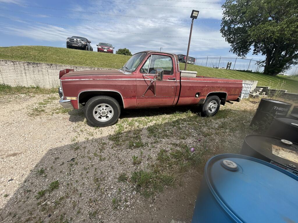

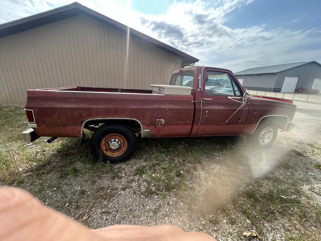

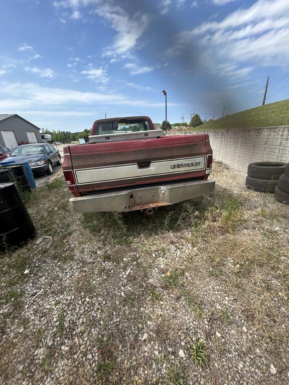

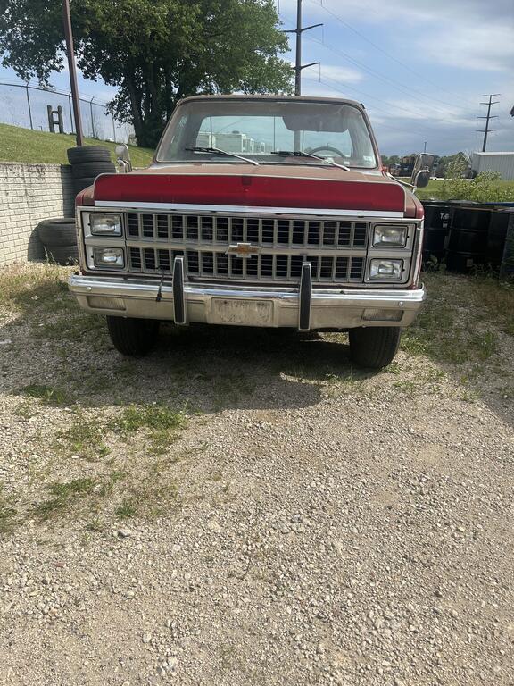

Keaton 466 #5 Posted June 15, 2024 @953 nut yes it is patina, and my dad was guessing it is a 4:11 but he cant find the tag on the dif, and the engine has been swapped but not the transmission, @squonk I think it is a camper special, I will post some pics now. 1 Share this post Link to post Share on other sites
Keaton 466 #6 Posted June 15, 2024 and the dash says it only has 12 k miles, witch I doubt could be right I bet it has rolled over once at least 2 3 1 Share this post Link to post Share on other sites
ebinmaine 81,282 #7 Posted June 15, 2024 That's a good strong solid truck! 1 Share this post Link to post Share on other sites
squonk 48,427 #8 Posted June 15, 2024 If the wheels have the 8 lugs like the caps show, it's a HD chassis 2 Share this post Link to post Share on other sites
ebinmaine 81,282 #9 Posted June 15, 2024 2 minutes ago, squonk said: If the wheels have the 8 lugs like the caps show, it's a HD chassis I ~think~ Up until 1986 or so ALL 3/4 and 1 ton GM trucks had 8 lug wheels. 2WD or 4. I've never seen a Camper Special without 8 lugs back then. Not sure if there were any. Doesn't mean they don't exist in another market... The Camper Specials I dealt with were quite often a 1 ton suspension under a 3/4 ton registration to lower Insurance costs. 1 Share this post Link to post Share on other sites
squonk 48,427 #10 Posted June 15, 2024 (edited) Chevy had a std. 3/4 ton with 6 lug wheels. HD had 8 Lots of fun in the parts business when dealing with brake and steering parts. We usually needed the option code which of course the customer didn't have. Always asked "how many lug nuts on a wheel and that would narrow it down. Then the fun really started mid 87 when the redesigned the trucks. The new independent suspension trucks were C and K series and the old square bodies were R and V series. It went like this: "I need a brake caliper for an 88 K 20." " What body style?" "Huh?" "New style or old style?" " What?" "sloped hood or square hood?" " I don't know." " Solid frt. axle or independent with CV shafts?" " Solid" "Ok you have a V20.How many lug nuts?" Edited June 15, 2024 by squonk 1 1 Share this post Link to post Share on other sites

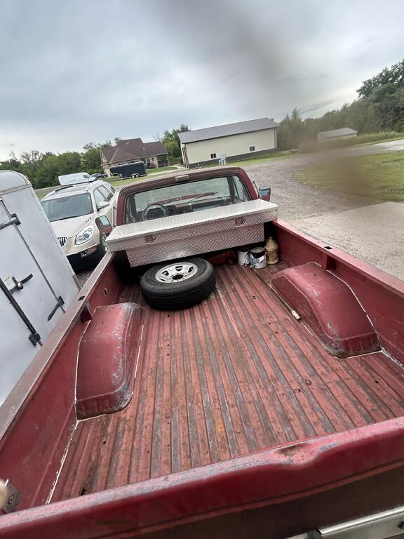

953 nut 70,656 #12 Posted June 15, 2024 Long bed with dual fuel tanks and eight lug hubs, just right for a camper. Love the look of the patina. 3 1 Share this post Link to post Share on other sites

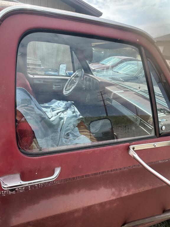

Handy Don 17,735 #13 Posted June 15, 2024 I know zip about old Chevy trucks, but that one looks like it has some life left in it, for sure. Clearly sunburned and the interior fabrics and plastics have probably suffered badly for it but the metal all looks sound. I’m impressed that the bed is so lightly worn. The earlier comments about fuel economy with a big engine and low-ratio rear end might put a strain on your allowance but it sounds like you have the knowledge to address that! Good luck! 2 Share this post Link to post Share on other sites

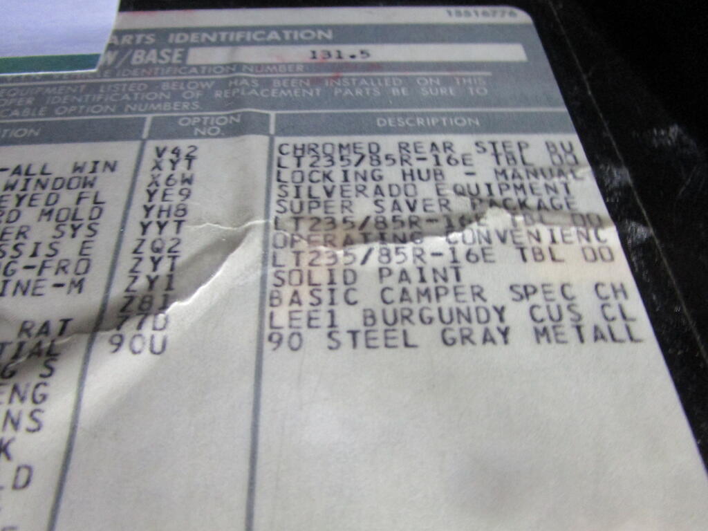

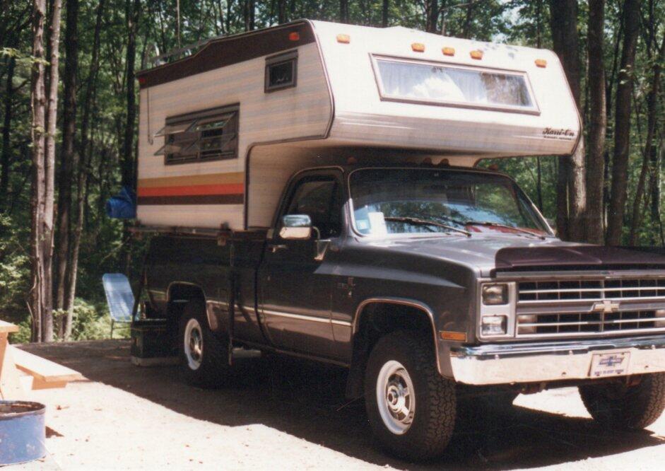

JCM 11,470 #15 Posted June 15, 2024 @Keaton Did you open the glove box and look at all the RPO #'s to see what options the truck was built with ? This is a pic of the partial list for my 86 Chevy K-20. There are more than just this number for a camper special package Z81 is this one. It may head you in the right direction. Also the belt moulding at the base of the rear window where it wraps around usually had some sort of emblem denoting that package. Good luck. 5 1 2 Share this post Link to post Share on other sites

Keaton 466 #17 Posted June 16, 2024 @mrc we tried that but lifted up both sides we will try again tommrow, @jmc that is sweet looking, and in the glove box all it says is camper loading information, its a blue sticker. AND IT DOES RUN!!! we did not ever try starting it because the tech at my dads shop said it didn't run, 2nd crand fired right up, it misses but at about 1/4 throttle it will run, we moved it a bit it will run about 10 feet then die, but cant beat that for free, thanks, and I polished all the chrome the bumper and the trim that was left with a sos pad, and washed it 3 3 Share this post Link to post Share on other sites
