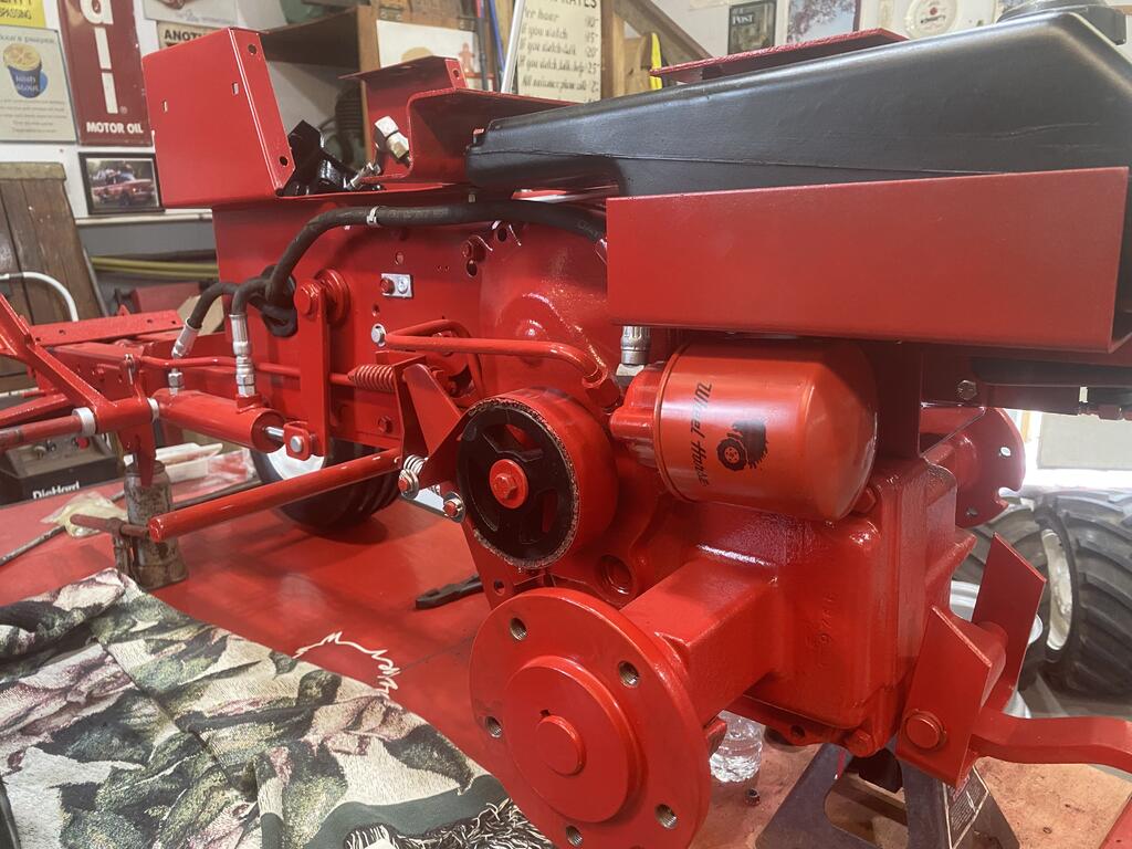

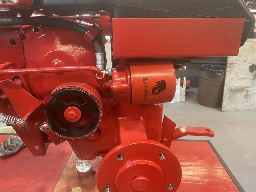

c-series don 11,963 #6 Posted May 5, 2024 Unless you just happen to have an original kickin around and you need it for your C-175 restoration ! 🤣😂 1 4 Share this post Link to post Share on other sites
Racinbob 12,996 #7 Posted May 5, 2024 Outstanding Don but I would have put that on display. It might be a crime but this one is going to work and not be a trailer queen. I've got filters on the way. 1 Share this post Link to post Share on other sites
c-series don 11,963 #8 Posted May 5, 2024 @Racinbob I had that filter on display and thought I would put it on just to see how it looked. Then I liked it so much I thought I’d leave it. But then I realized I probably won’t find another one like that so I was going to take it off!!! Just then my son in law came by and I explained my dilemma. He said my daughter could copy the writing and logo on the filter on her Cricket. It’s kind of like a fancy label maker ( I don’t know anything about it honestly) So I guess with a little red paint and new decals I could paint some 1410’s and have several ! But honestly once the tire is on you can’t see it anyway. Since I haven’t finished this restoration I still may take it off and put it back on the shelf? Decisions, decisions…….. 1 Share this post Link to post Share on other sites
lynnmor 8,843 #9 Posted May 5, 2024 1 hour ago, c-series don said: @Racinbob I had that filter on display and thought I would put it on just to see how it looked. Then I liked it so much I thought I’d leave it. But then I realized I probably won’t find another one like that so I was going to take it off!!! Just then my son in law came by and I explained my dilemma. He said my daughter could copy the writing and logo on the filter on her Cricket. It’s kind of like a fancy label maker ( I don’t know anything about it honestly) So I guess with a little red paint and new decals I could paint some 1410’s and have several ! But honestly once the tire is on you can’t see it anyway. Since I haven’t finished this restoration I still may take it off and put it back on the shelf? Decisions, decisions…….. In the meantime have your daughter produce copies and open a vendor account here. 1 Share this post Link to post Share on other sites
Bill D 2,877 #10 Posted May 5, 2024 14 hours ago, c-series don said: Unless you just happen to have an original kickin around and you need it for your C-175 restoration ! 🤣😂 I'm curious about the hydraulic hoses you're using. Could you please tell me where you purchased them. Thanks. Share this post Link to post Share on other sites
c-series don 11,963 #11 Posted May 5, 2024 @Bill D In full disclosure Bill, they were not leaking so I didn’t replace them. I did however paint the fittings with Rustoleum aluminum paint. Now that I have said that they don’t leak, well you know what is going to happen 😂😂 Share this post Link to post Share on other sites
Bill D 2,877 #12 Posted May 5, 2024 39 minutes ago, c-series don said: @Bill D In full disclosure Bill, they were not leaking so I didn’t replace them. I did however paint the fittings with Rustoleum aluminum paint. Now that I have said that they don’t leak, well you know what is going to happen 😂😂 I don't think those hoses are OEM. They don't look like the old hoses I have. I'm thinking the previous owner replaced them. Do you have any more close up pictures. Share this post Link to post Share on other sites

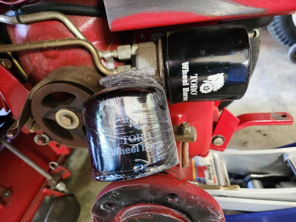

Racinbob 12,996 #13 Posted May 10, 2024 Pulled the left rear to try and repair a slow leak. I was a bit surprised to find the logo on the filter. Even more surprised to find it on the three new OEM filters I purchased. Not as cool as @Bill D 's red but still cool. 3 1 Share this post Link to post Share on other sites

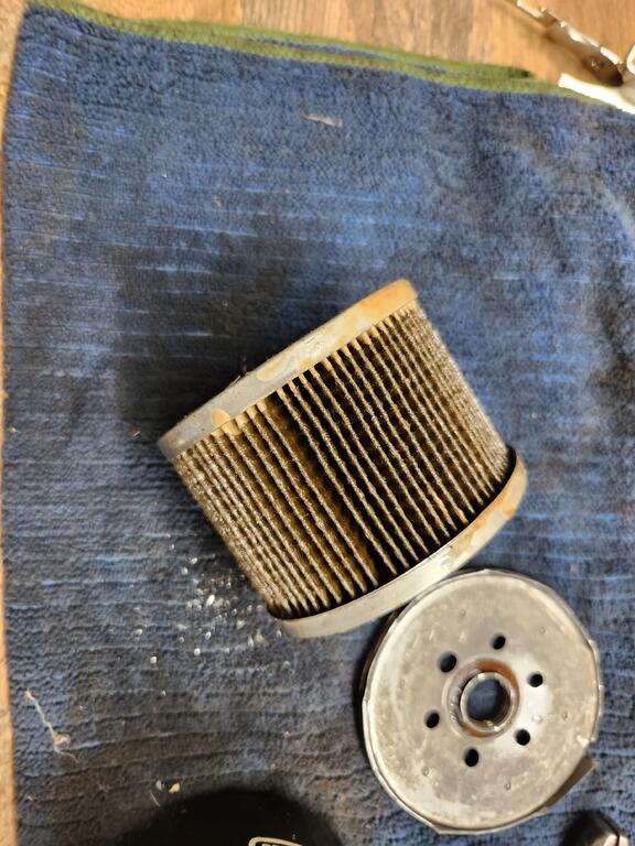

squonk 46,838 #14 Posted May 10, 2024 (edited) Cut your old filter open if you can and lets have a looksee. The older ones were pretty crappy. I'd like to see if they improved them at all. Old Filter: Napa 1410: Edited May 10, 2024 by squonk 1 Share this post Link to post Share on other sites
Bill D 2,877 #15 Posted May 10, 2024 (edited) 3 hours ago, Racinbob said: Pulled the left rear to try and repair a slow leak. I was a bit surprised to find the logo on the filter. Even more surprised to find it on the three new OEM filters I purchased. Not as cool as @Bill D 's red but still cool. I think you meant @c-series don. All my tractors have Wix 51410 filters Edited May 10, 2024 by Bill D 2 Share this post Link to post Share on other sites
Racinbob 12,996 #16 Posted May 10, 2024 46 minutes ago, Bill D said: I think you meant @c-series don. All tractors have Wix 51410 filters Oops! You're right. I just went back to the first picture I saw. Sorry. 1 Share this post Link to post Share on other sites
Racinbob 12,996 #17 Posted May 10, 2024 1 hour ago, squonk said: Cut your old filter open if you can and lets have a looksee. The older ones were pretty crappy. I definitely will Mike. I had a display of cut open filters some time ago prompted by Fram. It won't be long but I want to get the tire issue fixed first. The seller told me about the slow leak in the left rear. I found multiple tiny pinhole leaks in the Dico. Share this post Link to post Share on other sites

Racinbob 12,996 #21 Posted May 20, 2024 On 5/10/2024 at 2:28 PM, squonk said: Cut your old filter open if you can and lets have a looksee. The older ones were pretty crappy. I'd like to see if they improved them at all. Here you go Mike. I see no issue with the quality. I just figured I'd stick with a 10 micron like the recommend. probably no big deal though. Share this post Link to post Share on other sites
squonk 46,838 #22 Posted May 20, 2024 1 hour ago, Racinbob said: Here you go Mike. I see no issue with the quality. I just figured I'd stick with a 10 micron like the recommend. probably no big deal though. Toro probably changed the vendor to a better quality manufacturer as compared to years ago, That filter looks a lot like the Wix/Napa filter, This is out of an older filter probably from the 70's What kind of spring did it have in it? Share this post Link to post Share on other sites
