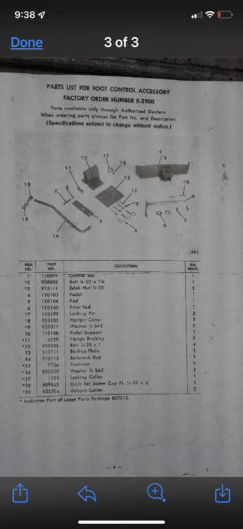

Racinbob 13,043 #3 Posted January 15, 2024 I talked to the builder yesterday and he actually has five built already. Basically a direct copy of the Wheel Horse 8-3900 control. 2 1 Share this post Link to post Share on other sites

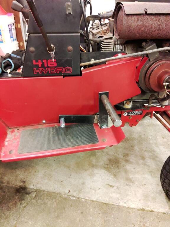

Rick3478 454 #18 Posted January 19, 2024 (edited) 8 hours ago, kpinnc said: What model is that pedal picture from? And do you have a part number? It looks like it might have potential for retrofit modifications. Edited January 19, 2024 by Rick3478 delete extraneous info Share this post Link to post Share on other sites
kpinnc 18,755 #19 Posted January 19, 2024 25 minutes ago, Rick3478 said: What model is that pedal picture from? And do you have a part number? It looks like it might have potential for retrofit modifications. That's one I modified to work on a Wheel Horse. Still in progress... Share this post Link to post Share on other sites

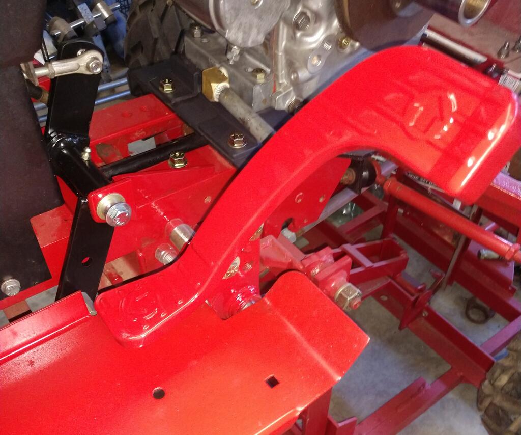

c-series don 12,137 #21 Posted January 19, 2024 Does the factory one require modifying the belt guard? Share this post Link to post Share on other sites
Bill D 2,994 #22 Posted January 19, 2024 50 minutes ago, c-series don said: Does the factory one require modifying the belt guard? Yes. Didn't someone give you a 520H a few years back that had a factory foot pedal? I thought I saw an old post about it. Share this post Link to post Share on other sites
c-series don 12,137 #23 Posted January 19, 2024 9 minutes ago, Bill D said: Yes. Didn't someone give you a 520H a few years back that had a factory foot pedal? I thought I saw an old post about it. Wow Bill, yes they certainly did! I removed the foot control and passed the tractor along to my son in law. I can’t believe you remembered that!! I thought the belt guard on that 520 was cut and I was thinking about putting the foot control on my 418-C that I don’t want to cut up. 1 Share this post Link to post Share on other sites
