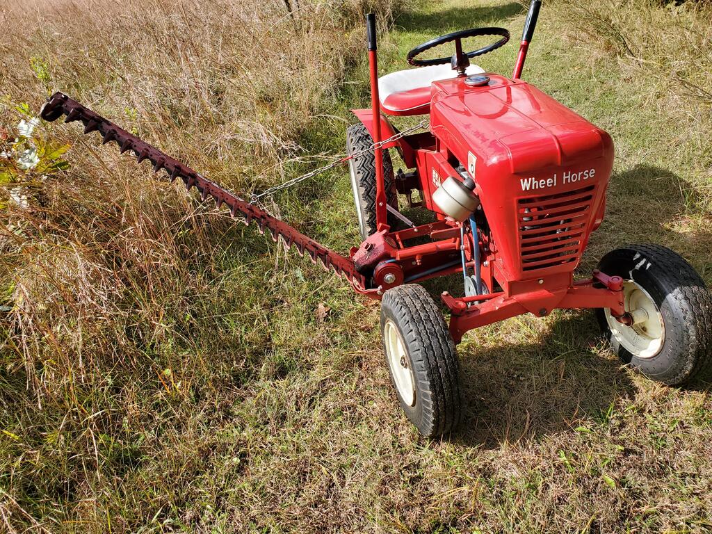

Racinbob 13,213 #4 Posted July 6, 2023 They should be straight. Picture? Here's mine. 1 Share this post Link to post Share on other sites

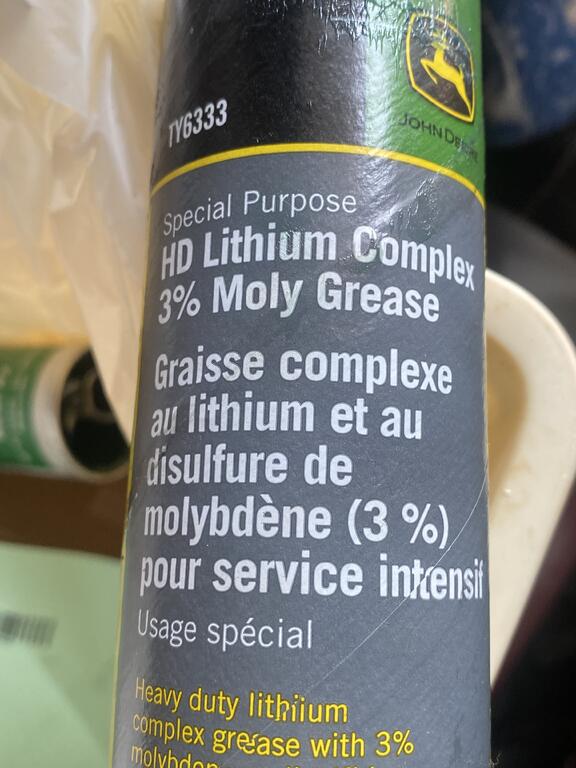

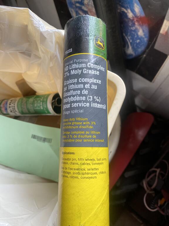

peter lena 10,089 #13 Posted July 19, 2023 @Lane Ranger agree with that trial , most of my experiments is based on repedative failure , why not make a change ? BTW for the others that have an oil emersion set up , personly would add some rislone zink to that set up , its a sacrificial additive that really makes a difference in these old mechanical devises. having been adding that to my engine oil , has been nothing but better , initial flushing effect , then running easier , also have zero smoke , more thorough flushing oil changes . would not be surprised if the JD GREASE IS ALSO POLYUREA RATED . let me know when you can , how its working , easier ? smoother ? these small changes often make a problem go away , hope it helps out , pete 1 Share this post Link to post Share on other sites
peter lena 10,089 #14 Posted July 19, 2023 @Lane Ranger https://www.greenpartstore.com/John-Deere-Special-Purpose-HD-Moly-Gun-Grease-TY6333.html does not have HI TEMP RATING , but worth the trial run , lubrication slide is one of its strong points , I won,t tell anyone you are experimenting with grease , pete 1 Share this post Link to post Share on other sites
