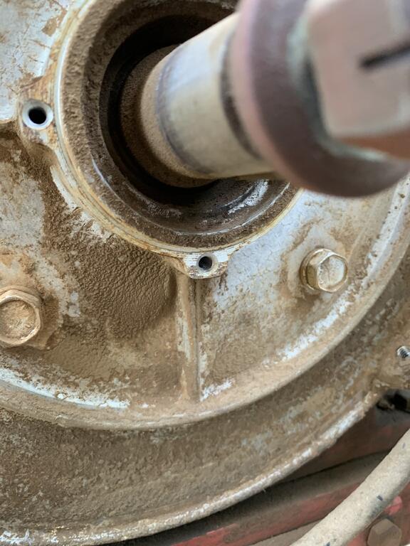

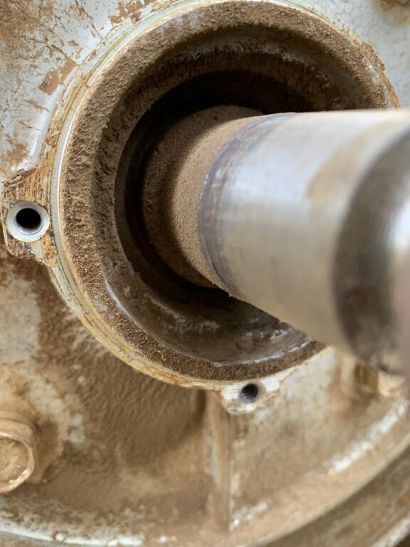

Horse Newbie 7,405 #163 Posted April 20, 2023 So I bought the CRC QD Electronic Cleaner and the Napa brand Mac’s 4710 Electronic Cleaner… Haven’t used either yet as I am still cleaning grime off the Kohler. I don’t see any signs of an oil leak on the crankshaft seal on the flywheel side… Are there any places on this engine that I need to look for oil leaks ? I know to check the crankshaft seals, but what about at fuel pump(plastic😟), governor shaft hole, points cover, etc ? Share this post Link to post Share on other sites
ebinmaine 80,751 #164 Posted April 20, 2023 11 minutes ago, Horse Newbie said: Are there any places on this engine that I need to look for oil leaks ? I know to check the crankshaft seals, but what about Are you still planning on removing the cylinder head? That could be a place to look. The carb and breather should be removed and both cleaned out as well. When you reinstall the breather be SURE it's oriented the right direction. Fuel pump gasket is a potential area. The crank seals we've been leaving alone unless leaking. 1 Share this post Link to post Share on other sites

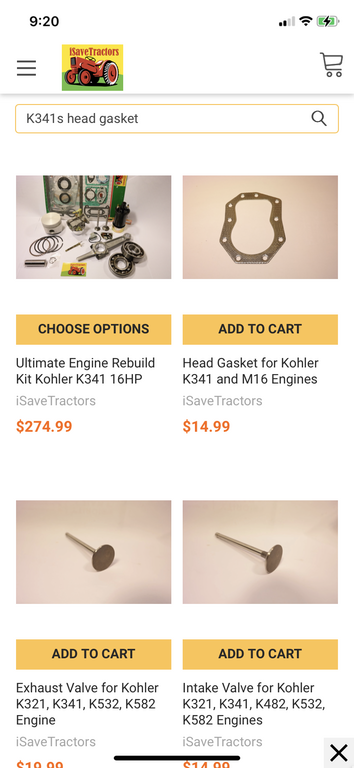

Horse Newbie 7,405 #169 Posted April 21, 2023 I am thinking this head gasket from I Save Tractors… but I also need parts from Wheel Horse Parts and More, so maybe I could get it from Lowell… Where do youse guys get your Kohler head gaskets ? 1 Share this post Link to post Share on other sites
oliver2-44 11,753 #170 Posted April 21, 2023 (edited) This is where those old conservative teachers I had come out in me. If it has a fire ring and it’s not burned, I reuse them. I know their only $15 or so, I have a new one in the drawer, but I can’t help myself. If it’s not broke why fit it. OK now that y’all are laughing at me, here’s the really old school…Clean the head gasket, soak it in water for several hours, then put in the freezer overnight. The water soaked between the layers was to freeze and swell the used gasket back up. Let unfreeze and reuse. I actually tried this and mic’ed thickness and found no change. Now back to the real question. I buy from whoever sells one with the solid inner “fire ring”. Edited April 21, 2023 by oliver2-44 4 2 Share this post Link to post Share on other sites
Bill D 3,156 #171 Posted April 21, 2023 1 hour ago, Horse Newbie said: I am thinking this head gasket from I Save Tractors… but I also need parts from Wheel Horse Parts and More, so maybe I could get it from Lowell… Where do youse guys get your Kohler head gaskets ? NAPA should have them. Made in USA. Great price. 2 Share this post Link to post Share on other sites
ebinmaine 80,751 #172 Posted April 21, 2023 5 hours ago, Bill D said: NAPA should have them. Made in USA. Great price. I couldn't find USA made just a few months ago. Can you please get some documentation on that ? I'd buy those if available. 5 hours ago, oliver2-44 said: buy from whoever sells one with the solid inner “fire ring”. 1 Share this post Link to post Share on other sites
Horse Newbie 7,405 #173 Posted April 21, 2023 2 hours ago, ebinmaine said: buy from whoever sells one with the solid inner “fire ring”. What does a fire ring look like ? Share this post Link to post Share on other sites
953 nut 69,380 #174 Posted April 21, 2023 7 hours ago, Bill D said: NAPA should have them. Made in USA. Great price. Even Kohler OEM parts are made overseas now. Since May 2007, engines produced by Kohler have come from Chongqing, China in a joint venture with a company called YinXiang Ltd. They work closely with their Chinese allies to develop, manufacture, market, sell and distribute most of Kohler’s general-purpose gasoline engines. That said, it seems that Kohler engine parts are what comes from China. Their plants in Saukville, Wisconsin and Hattiesburg, Mississippi engineer and assemble these Chinese-made parts. So, they are still technically “made in the USA.” However, they also have some operations in Mexico. 2 Share this post Link to post Share on other sites
ebinmaine 80,751 #175 Posted April 21, 2023 1 hour ago, Horse Newbie said: What does a fire ring look like ? Zoom in on the picture of a head gasket of a 16 horse versus an 8 horse. The 16 horse is going to have a separate ring of metal on the inside circumference. That's the fire ring. Not all gaskets have that. It's an extra piece of insurance against high temperatures and combustion pressures. 1 Share this post Link to post Share on other sites
