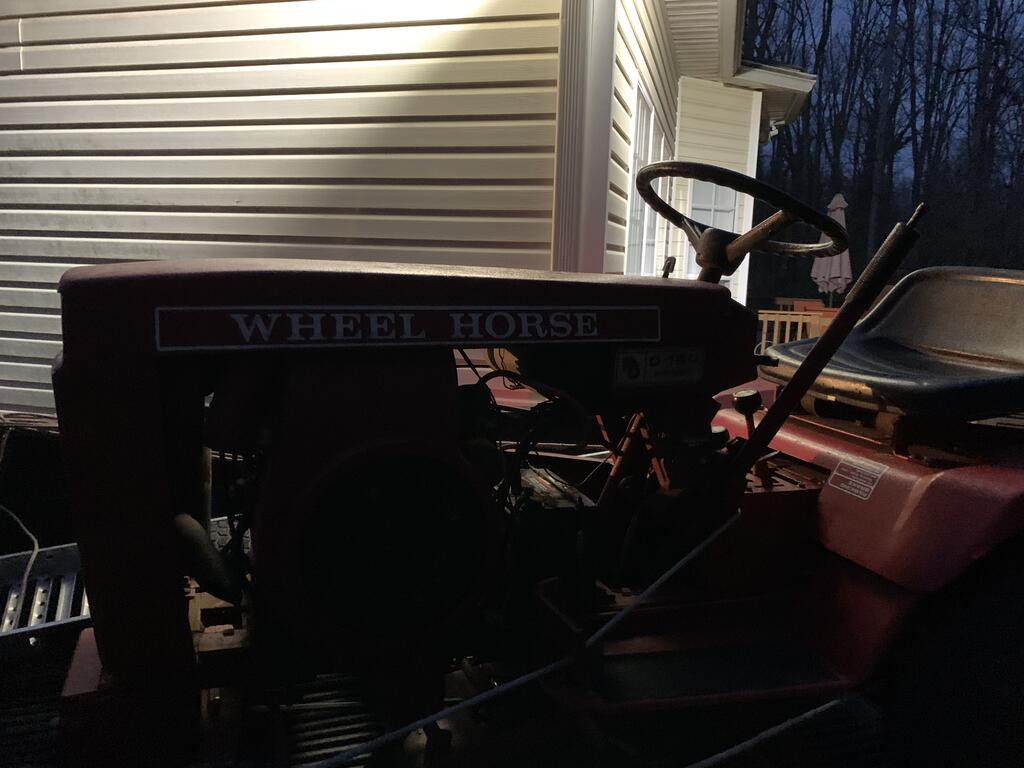

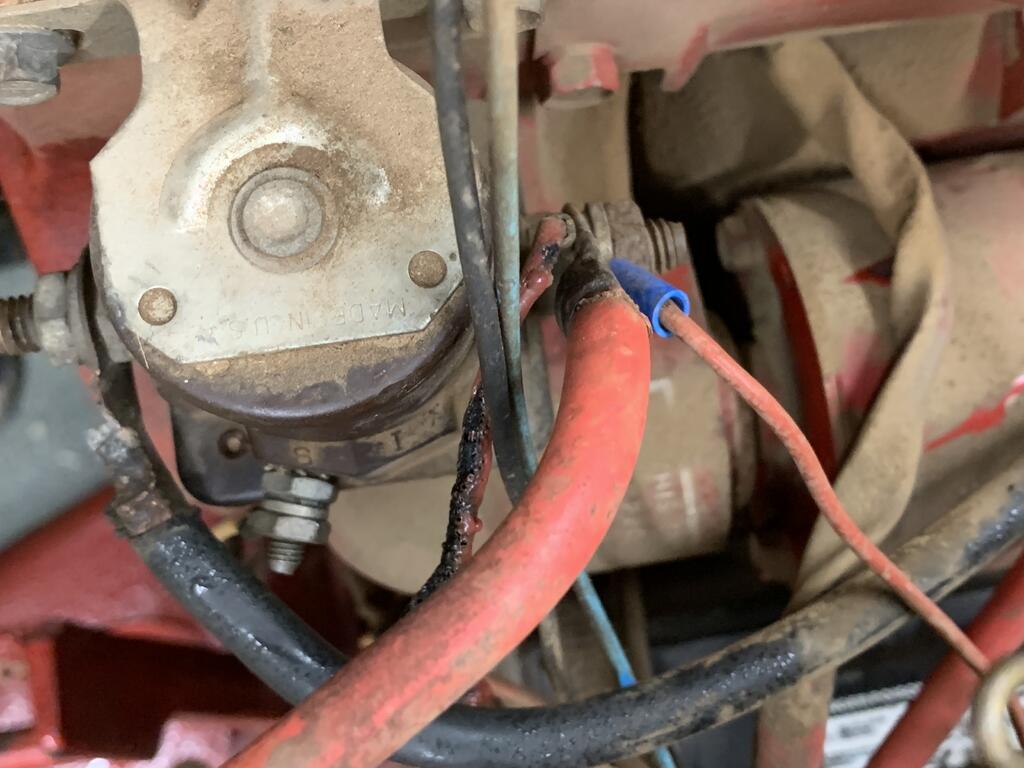

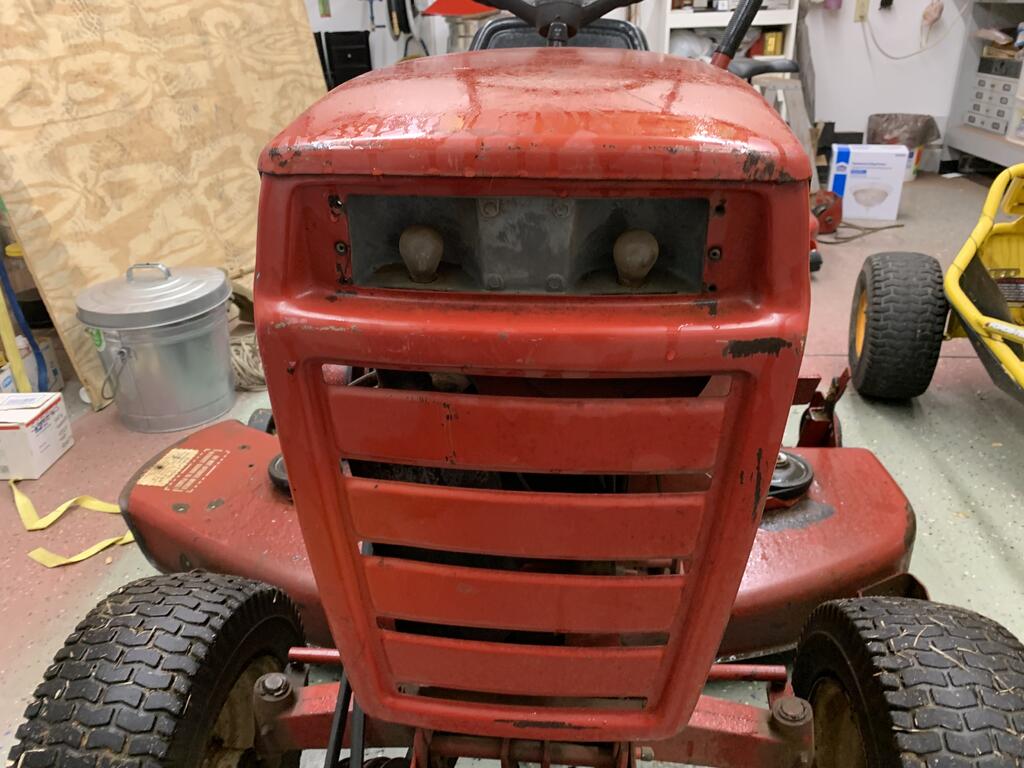

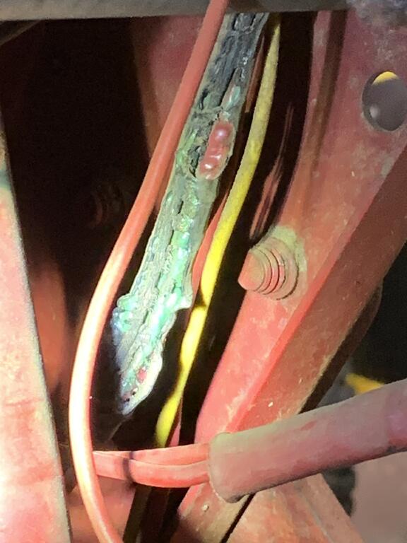

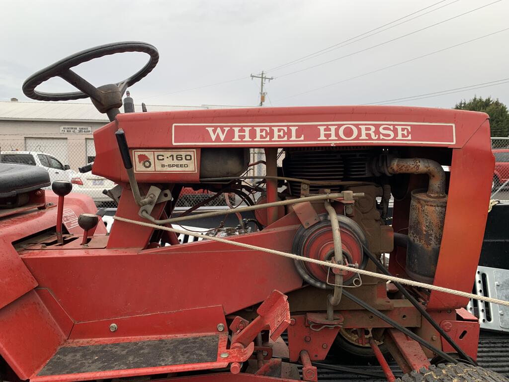

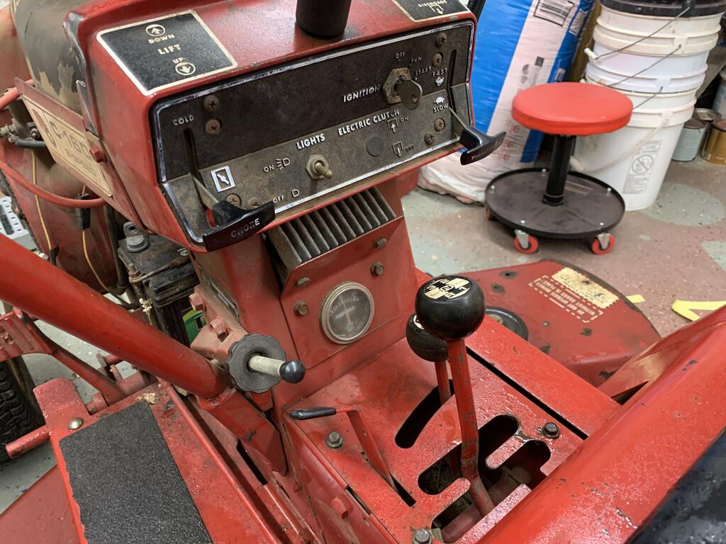

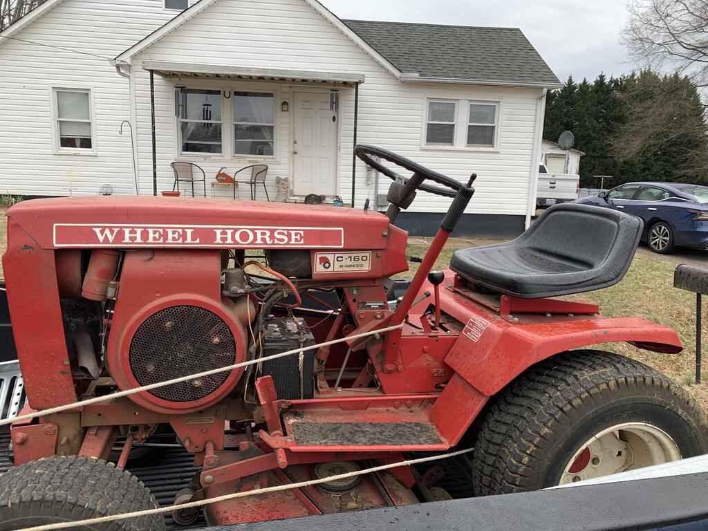

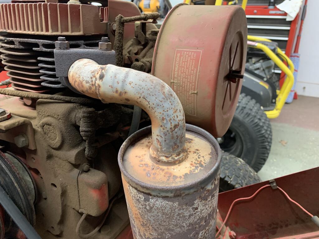

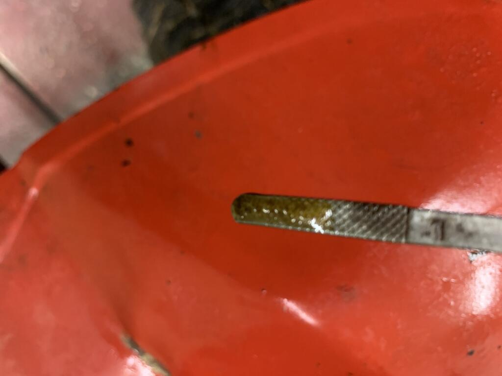

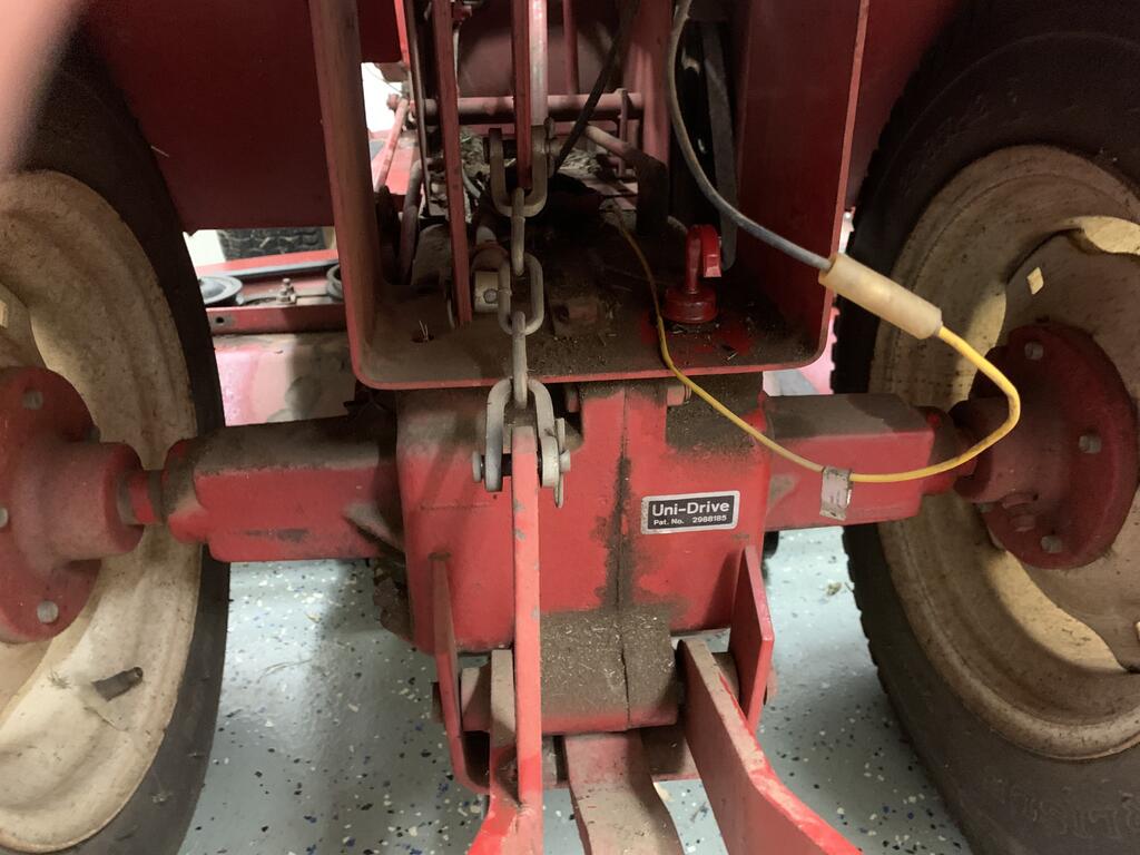

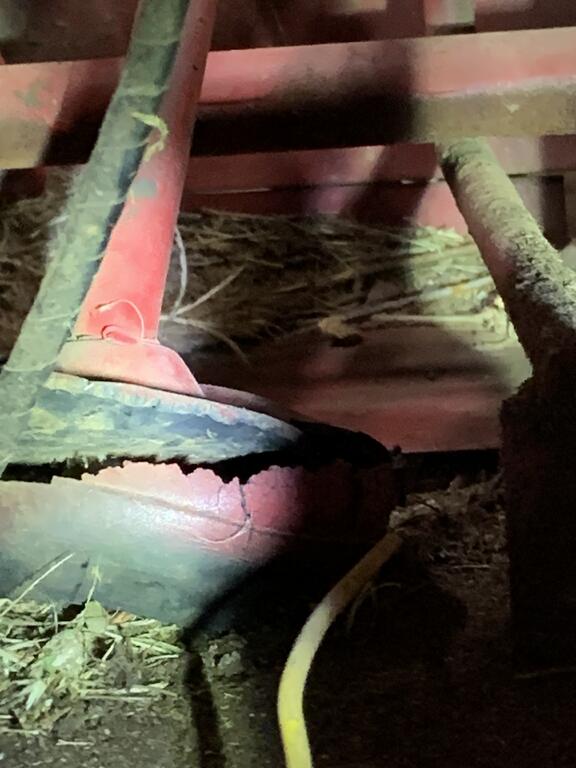

Horse Newbie 7,405 #1 Posted January 30, 2023 (edited) So here it is… my newly acquired 1977 C-160. Drove 89 miles one way to scoop her up… So far here are the obvious things that will need doing… 1. Oil change 2. Check/ charge battery 3. Investigate why my electrical hoses were leaking smoke while I was trying to unload her. 4. Repair or rewire those smoking hoses. 5. When I get her running, flush and refill transmission. 6. Rub down her work clothes with a penetrating fluid to freshen up her threads. 7. Replace front wheel bearings… hope the lack of which did not ruin front spindles. 8. Replace shifter boot. And that’s just a start… here are a few pics… Edited January 30, 2023 by Horse Newbie 8 20 Share this post Link to post Share on other sites

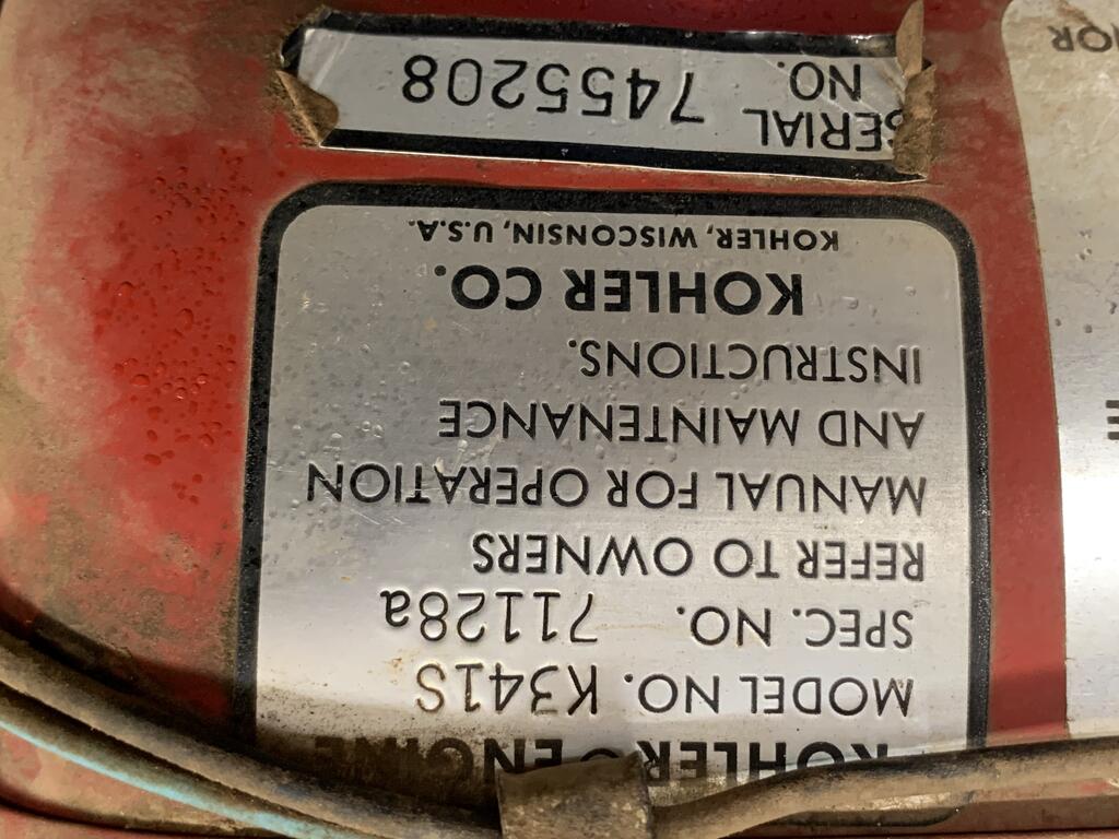

Horse Newbie 7,405 #2 Posted January 30, 2023 What does the K341S mean on the Kohler… I was wondering balance gears or not… Share this post Link to post Share on other sites
GAJoe 852 #3 Posted January 30, 2023 6 minutes ago, Horse Newbie said: What does the K341S mean on the Kohler… I was wondering balance gears or not… 3 Share this post Link to post Share on other sites
OutdoorEnvy 1,817 #4 Posted January 30, 2023 Awesome grab! That will be a fun one to put back to work! K341s is the engine model. You’ll need that for any parts, manuals, etc. 3 1 Share this post Link to post Share on other sites
Horse Newbie 7,405 #5 Posted January 30, 2023 1 minute ago, OutdoorEnvy said: Awesome grab! That will be a fun one to put back to work! K341s is the engine model. You’ll need that for any parts, manuals, etc. Would it have balance gears needing to be taken out ? 1 Share this post Link to post Share on other sites

Achto 32,759 #14 Posted January 30, 2023 (edited) 9 hours ago, Horse Newbie said: What does the K341S mean on the Kohler On Kohler K models the number represents cubic inches and cylinders. K341 = 34 C.I. one cylinder. Edited January 30, 2023 by Achto 5 Share this post Link to post Share on other sites
ebinmaine 80,750 #15 Posted January 30, 2023 36 minutes ago, SylvanLakeWH said: Haiku Nice usage of the emoji on the last line there Jim. 1 1 Share this post Link to post Share on other sites
Horse Newbie 7,405 #16 Posted January 30, 2023 23 minutes ago, Achto said: On Kohler K models the number represents cubic inches and cylinders. K341 = 34 C.I. one cylinder. Does the “s” at the end mean anything ? Share this post Link to post Share on other sites
953 nut 69,380 #17 Posted January 30, 2023 5 minutes ago, Horse Newbie said: Does the “s” at the end mean anything ? Nice find, guess you released all the magic smoke and need some wires. The "S" tells you your engine came with an electric starter. Click on this link and then on page 2 you will find your Spec. number. Follow that line across the page and it will show a code number for each group of parts and the ones that have your code number (in this case 2 for the crankshaft) will show that your engine left the factory with ballance gears. 6 Share this post Link to post Share on other sites
