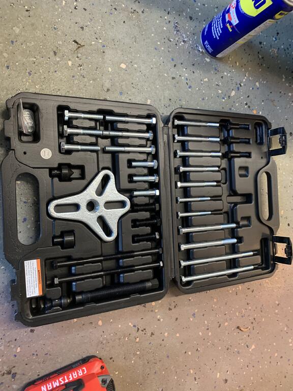

kpinnc 18,969 #133 Posted April 19, 2023 A short piece of flat bar with two holes drilled will pull the flywheel safety. There are usually two tapped 3/8 holes on either side of the flywheel nut. They are for adding a shaft to run things from the flywheel side, but double nicely to make a puller as well. 5 Share this post Link to post Share on other sites
Horse Newbie 7,405 #134 Posted April 19, 2023 23 hours ago, oliver2-44 said: But, you should be able to get a loaner puller from Oreily or other auto supplies to put pressure on the flywheel, then you still give the end of the crankshaft a sharp rap to make it pop loose So if the puller is on there putting pressure on the flywheel , then how do I give the crankshaft a sharp rap ? @oliver2-44 1 Share this post Link to post Share on other sites
kpinnc 18,969 #135 Posted April 19, 2023 3 minutes ago, Horse Newbie said: So if the puller is on there putting pressure on the flywheel , then how do I give the crankshaft a sharp rap ? I've never had to strike one, and do not recommend it. You never strike a cast iron flywheel. Did I mention NEVER? If you use the flat bar like I describe above, and two long bolts- it'll pop right off. And I do mean "pop"... 2 Share this post Link to post Share on other sites
ebinmaine 80,751 #136 Posted April 19, 2023 1 hour ago, kpinnc said: I've never had to strike one, and do not recommend it. You never strike a cast iron flywheel. Did I mention NEVER? The smackage mentioned above is done on the PULLER which is a direct connection to the crankshaft. NO whacking tapping smacking directly on the flywheel should occur. FWIW. The Tecumseh manual mentions a "special tool" that is literally a long nut that threads onto the end of the crankshaft. It's a smack receiver. 🙄 1 Share this post Link to post Share on other sites

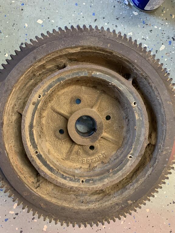

Horse Newbie 7,405 #137 Posted April 19, 2023 @ebinmaine and @kpinnc, I went to Horror Fright and got this… and I didn’t have to smack it… popped right off… Take a look and give me the rundown. Is the crud level behind the flywheel bad or not, with 5 being the worst you’ve seen and 1 being the best ? What would be an acceptable cleaning agent or method for behind there… stator and all ? Also, how can I check the stator electrically speaking ?… measure resistance ? 4 1 Share this post Link to post Share on other sites
ebinmaine 80,751 #138 Posted April 19, 2023 Nice work popping that off there. Crud level... 3, 3.5 I'd say on my charts. Not sure on a cleaner. I'm thinking brake clean? @Achto I believe a bench test can be done. I'm unfamiliar with the procedure. 1 Share this post Link to post Share on other sites

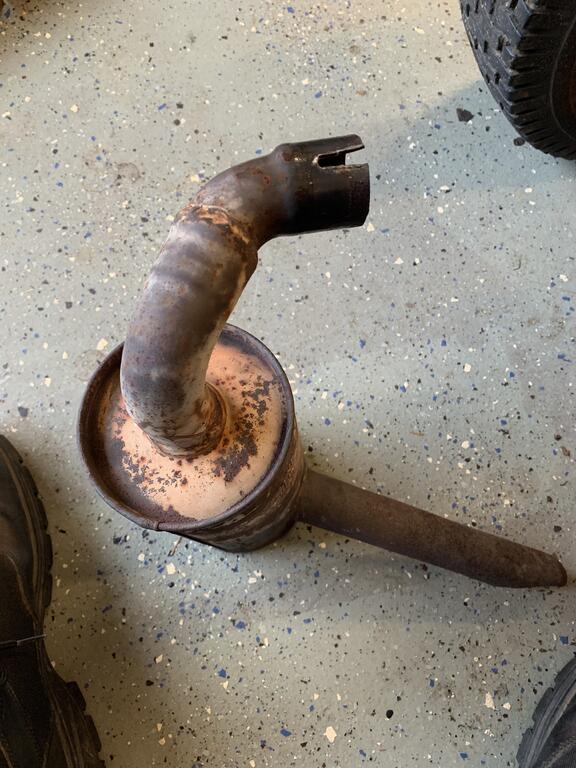

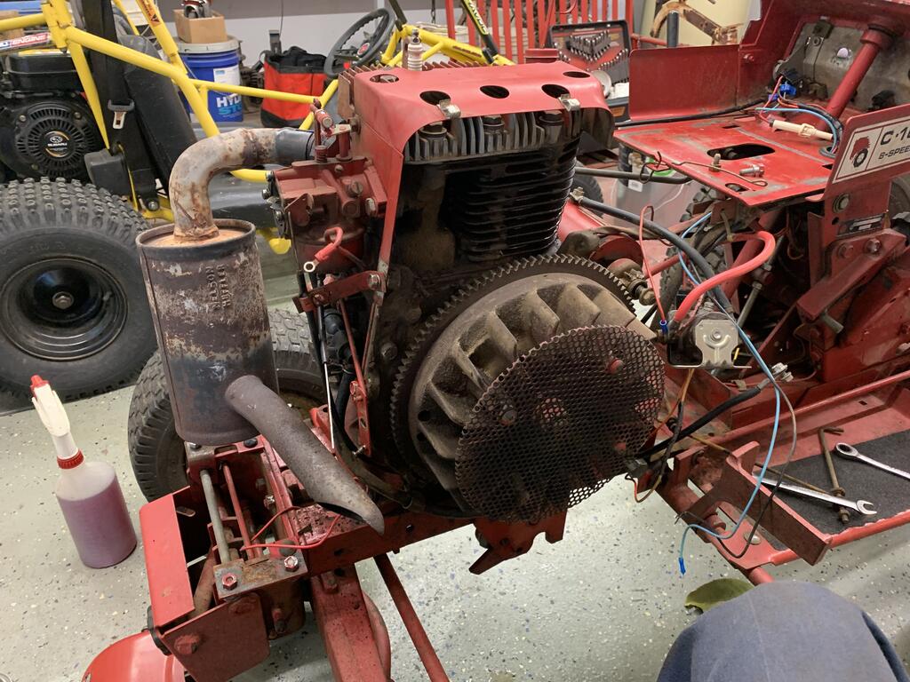

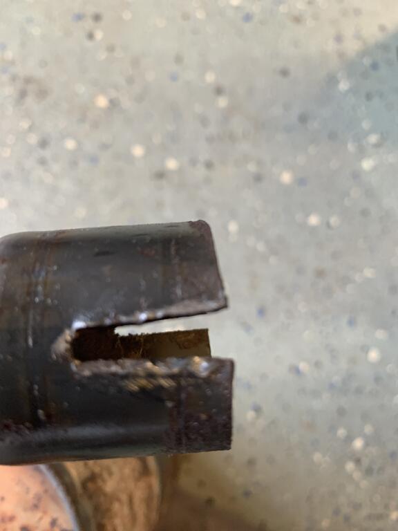

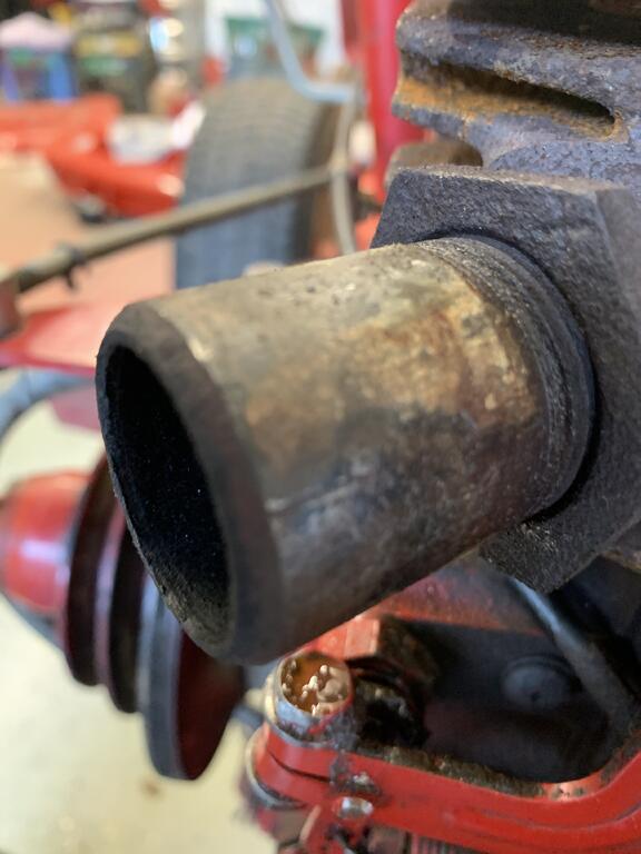

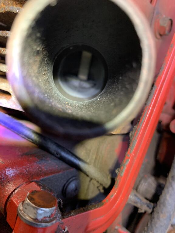

Horse Newbie 7,405 #140 Posted April 19, 2023 Got the, as Taryl would say, muffkin off… I did whack it a little… took a small punch and separated the part that slides over the exhaust nipple that comes off the engine… 4 Share this post Link to post Share on other sites

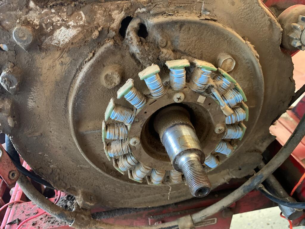

Horse Newbie 7,405 #141 Posted April 19, 2023 (edited) Okay fellows… Please throw me some suggestions as to what to use to clean the stator, and how to bench test the stator. Also if any of you would email me a copy of the Kohler service manual for this engine, I will be glad to print it out and read it so I don’t have to ask you guys stuff like testing the stator. I download files to this iPhone, then I can’t retrieve them. PM me if you are will and I will give you my email address.. Thanks to all ! Edited April 19, 2023 by Horse Newbie 2 Share this post Link to post Share on other sites
Achto 32,759 #142 Posted April 19, 2023 46 minutes ago, ebinmaine said: Not sure on a cleaner. I'm thinking brake clean? 29 minutes ago, Horse Newbie said: Please throw me some suggestions as to what to use to clean the stator, and how to bench test the stator. Brake cleaner would be just fine on the fly wheel, heck even a brass brush to get the big chunks off. Brake cleaner would also work on the stator, but an electrical contact cleaner may be better suited for the job. https://www.walmart.com/ip/CRC-Electronic-Cleaner-Quick-Dry-for-Sensitive-Electronics-11-oz/16817418?wmlspartner=wlpa&selectedSellerId=0&wl13=2986&adid=2222222227716817418_117755028669_12420145346&wmlspartner=wmtlabs&wl0=&wl1=g&wl2=c&wl3=501107745824&wl4=aud-1651068664706:pla-294505072980&wl5=9019452&wl6=&wl7=&wl8=&wl9=pla&wl10=8175035&wl11=local&wl12=16817418&wl13=2986&veh=sem_LIA&gclid=CjwKCAjwov6hBhBsEiwAvrvN6LuAGmCRzLdM3eNrwAGspQCc-ZV6XYMyUKV5NEpyLyJLXHkl8QFeihoCWJAQAvD_BwE&gclsrc=aw.ds About the only bench test that I can offer on the stator is a continuity test. You should have continuity between the two wires that come out of the stator. (fairly low resistance) There should be NO continuity from either stator wire to the block. 1 2 Share this post Link to post Share on other sites
Horse Newbie 7,405 #143 Posted April 19, 2023 8 minutes ago, Achto said: fairly low resistance What is considered low ? 1 Share this post Link to post Share on other sites
ebinmaine 80,751 #144 Posted April 19, 2023 48 minutes ago, Horse Newbie said: I download files to this "smartphone" , then I can’t retrieve them That's what I do!!! 1 Share this post Link to post Share on other sites
Achto 32,759 #145 Posted April 19, 2023 2 minutes ago, Horse Newbie said: What is considered low ? I would think less that 10ohms 1 Share this post Link to post Share on other sites
Horse Newbie 7,405 #146 Posted April 19, 2023 1 minute ago, Achto said: I would think less that 10ohms I believe I can test the stator… I bought me a DMM at Horror Fright a year or so ago… the $7 one… it never worked even once. When I was there the other day I stepped up a little and got a “ not as cheap “ one. Hope I have better luck with it. It got good reviews … FWIW… 1 1 Share this post Link to post Share on other sites
