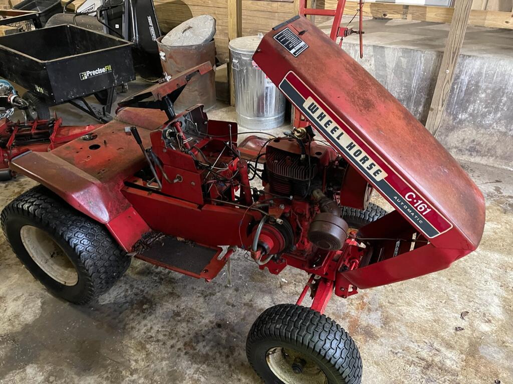

I have little background on this one.  A family member live(s/d) next to a guy named Dave.  He used to sell Wheel Horse parts some years ago.  He supplied my Dad some parts back then and I don’t know too much more about him.  I like to think that he would frequent this site and maybe folks on here knew him.  Not sure.
Anyway, Dave passed away (God Bless him) and a short while later this tractor arrived at my place.
I can tell there had been work/attempts at keeping her going.  Some sporadic areas have rattle can spray on them.  The engine looked as if it had been fussed with.  The engine and transmission oil looked decent, although I did just change both and the trans filter which had a date of 10/97 on it.  That was a great year for me!
Those hood decals look really good compared to the rest of her.  The engine model/serial #’s on the tag look home engraved.  All the numbers match and everything points to it being a true blue 1979 C-161.  I just think ol’ Dave had been doing some work on her and had or bought a new blank tag because the original was “deteriorating”.  I can’t prove it, that’s just my suspicion.   Or he replaced a rotten blower housing from a different model although this blower housing tin has a big hole in it under where the coil/condenser mount.  They are fastened on one side now with a metal drywall anchor (with the folding wings that spread out out after you push it through the hole).  By the way,  I have placed a want-ad for some tins for the engine as the tin on top has a crack in it too.
There was an aftermarket fuel pump zip tied to it, but wasn’t connected to anything.    There were several new stainless steel bolts and nuts put on it.  I found that the mechanical fuel pump was installed backwards/ upside down.  Maybe that was the unknown issue that didn’t get resolved and why she was set aside?

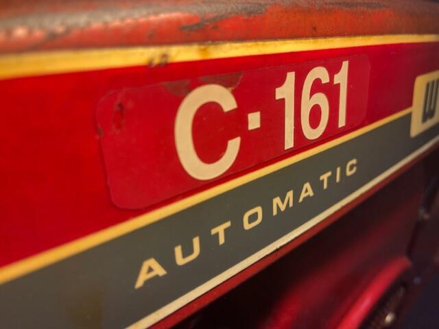

Your comments about that hood decal intrigued me.  I was poking around and found this on redoyourhorse site: spacer.png
I think the C-161 stickers were overlaid to cover the GT 14.  On the other side of the hood I have, the C-161 even looks like it is not original.  They were put on backwards (opposite sides of hood) from original GT 14's, too.  I'll have to get a better photo of the other side...
Another interesting bit is that tow valve decal for the 1970 GT 14.  This C-161 came with an extra part that has that tow valve decal on it.  That's not the right tow valve for the C-161.  And the GT 14 hoods are very different from the C-161 hoods.
Another mystery solved?  Or just another mystery?

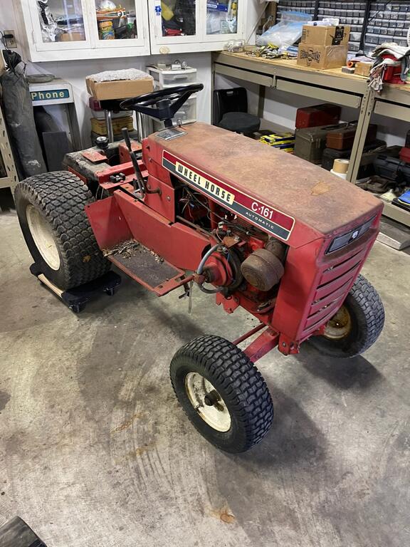

TractorEd

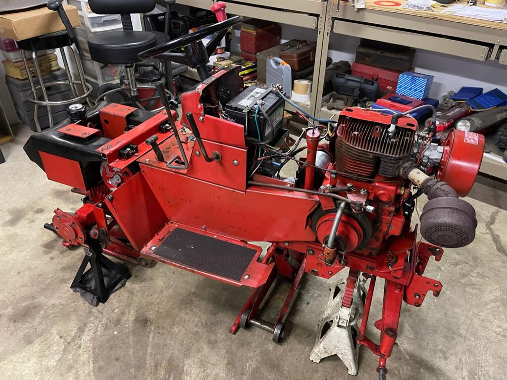

While in the examination area she was looked over and I could tell she had good bones, a real solid girl.  The surface rust added to her appeal in that it showed that she wasn't scared to do some work.
I pulled all the parts she was missing off the C-100 to see if I could get her heart to beat.  After fixing a couple of other minor electrical issues, I poured some gas in where her spark plug was and ... there was a cough and a sputter.  I poured in a bit more and she seemed to have some life in there still.  So, I ordered the new parts she needed (so I could put the C-100 back together).
While waiting for the parts, I cleaned out the fuel tank and put new fuel hose and a filter on her.  I disassembled the carb and cleaned it up.
The parts arrived and I put them on her.  I put a little gas in the tank and started cranking.  Nothing.  Cranked some more and she came to life.  That 16 HP engine on shaker plates was really bucking on that frame!
After letting her run for a few minutes I shut her off.  But what about that transmission?  Does it work?
I jacked the back of her up (her tires are still in bad shape) so I could try!
I started her back up and after a minute of still being fascinated that her heart was beating I moved the motion control forward and the wheels spun.  I moved it back to the middle and they stopped.  I pushed it back and the wheels spun backwards.  This was promising right?  I don't know, they sure weren't spinning very fast.  Was this the reason she was set aside?
Never having ever seen a hydro like this, with controls such as hers, I wasn't sure what she should act like.  But, the wheels did turn, so that's good, right?
I jacked up the front and put her up on jack stands, took her wheels off, tires off the rims, cleaned the rims up and took them to the powder coating shop up the road (same as I did for the C-100).  Should I have spent that money without knowing if that transmission was good or bad?  I bought her all new shoes, too.  That wasn't cheap!  Should I have spent that money so soon without knowing?
I don't know.
In the meantime, I was busy working on other internal and external blemishes.
Just this week I have put on her footrests, side panels, shifter and ammeter plate.  I used the brand new stainless steel hardware I bought.  More money.  I put on new rubber bumpers on her footrests to protect them from the fender/seat pan.
At this point, I'm wondering if I'm doing way too much, spending way too much, without knowing more about that transmission.  And I forgot to even test the hydraulic lift before taking the wheels off!  And I'm not starting her up while she's on those jack stands!  She bucks like crazy when that engines running!
Last night I put the seat springs on the seat pan and then bolted the seat to the seat springs (Note to self: next time, attach the seat to the springs first, then attach it to the seat pan, what a pita!).
I hope to get the fender put on tomorrow and then the seat assembly.  It's been 2 weeks since I dropped off the rims, so they should be ready any day now.
I'll have to get the tires mounted and then install the wheels (and new front wheel bearings!).
I have this ache in the pit of my gut.  Am I asking too much from her?  Is that tranny still good?  What have I done!

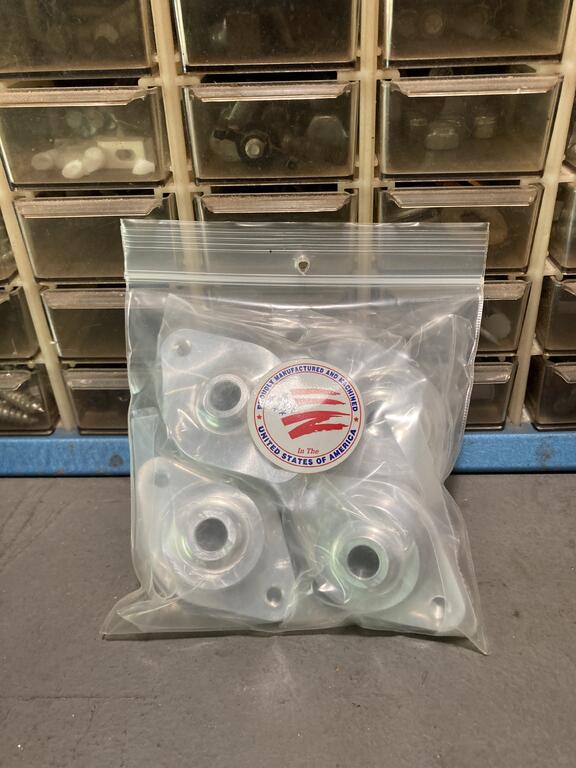

Blasterdad

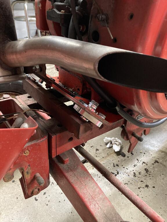

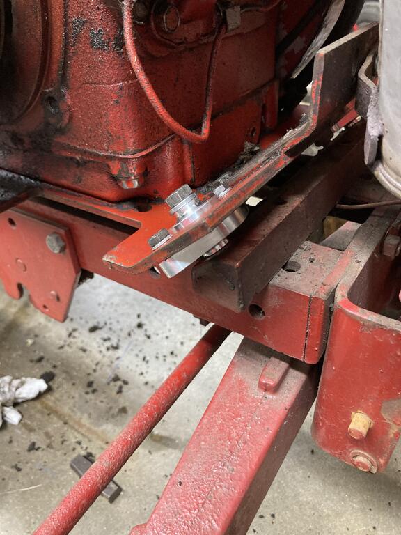

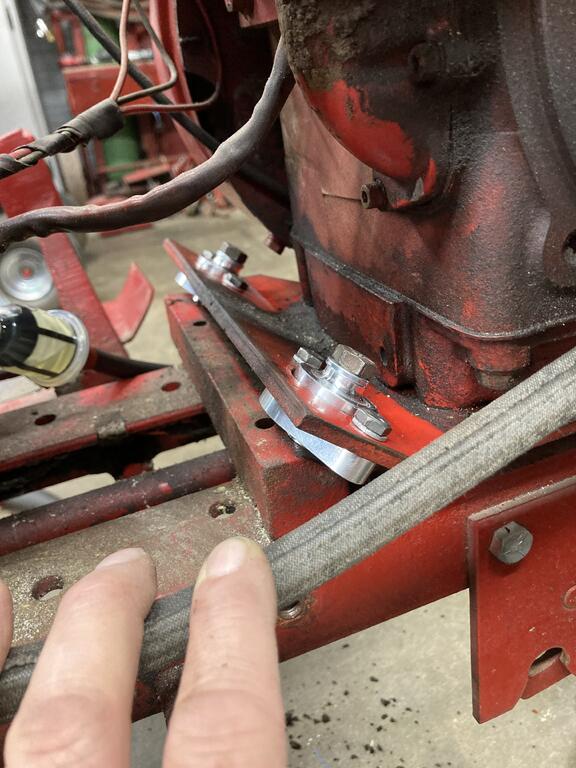

What do you mean by "Bucks like crazy"?
If the rubber isolators in the shaker plate are in good the engine should move very little.
It's very common for those rubber mounts to be rotten, & from what you're describing they're probably shot.
One of the best mods for the shaker plate engines is to replace them with solid mounts.
Toro wants a fortune for the rubber replacement mounts & the solid mounts make everything rock solid.
I just put a set on my C-161, they make a BIG difference.
These are what they look like, I think they were around $60.00. (precision machined billet aluminum & way less expensive than the rubber ones).
IMG_0152.JPG.713c882e38a0897f50b904bf2f2d4631.JPGIMG_0456.JPG.6d01f8537f9798756ad4f857afc4272f.JPGIMG_0457.JPG.9f01294067e665eef4029fa1fb273338.JPGIMG_0458.JPG.237d238faed5559753f7a98d95198df0.JPGIMG_0459.JPG.2c7eb811f2c2d843578b0b99b38729cb.JPG
Edited by Blasterdad
  • Like 9
SylvanLakeWH
:text-yeahthat: Shouldn't be bouncing all over the place..,
Not quite as nice, but a stack of washers works as well...
  • Like 5

TractorEd
Maybe I’m used to the frame mounted engine on the C-100, but this one really bounces in the saddle.  Back and forth with a vengeance.  Exaggerating a little here, but I don’t think it should move like it does.
Sounds like these might be on my short list of upgrades!  Thanks for all that info!

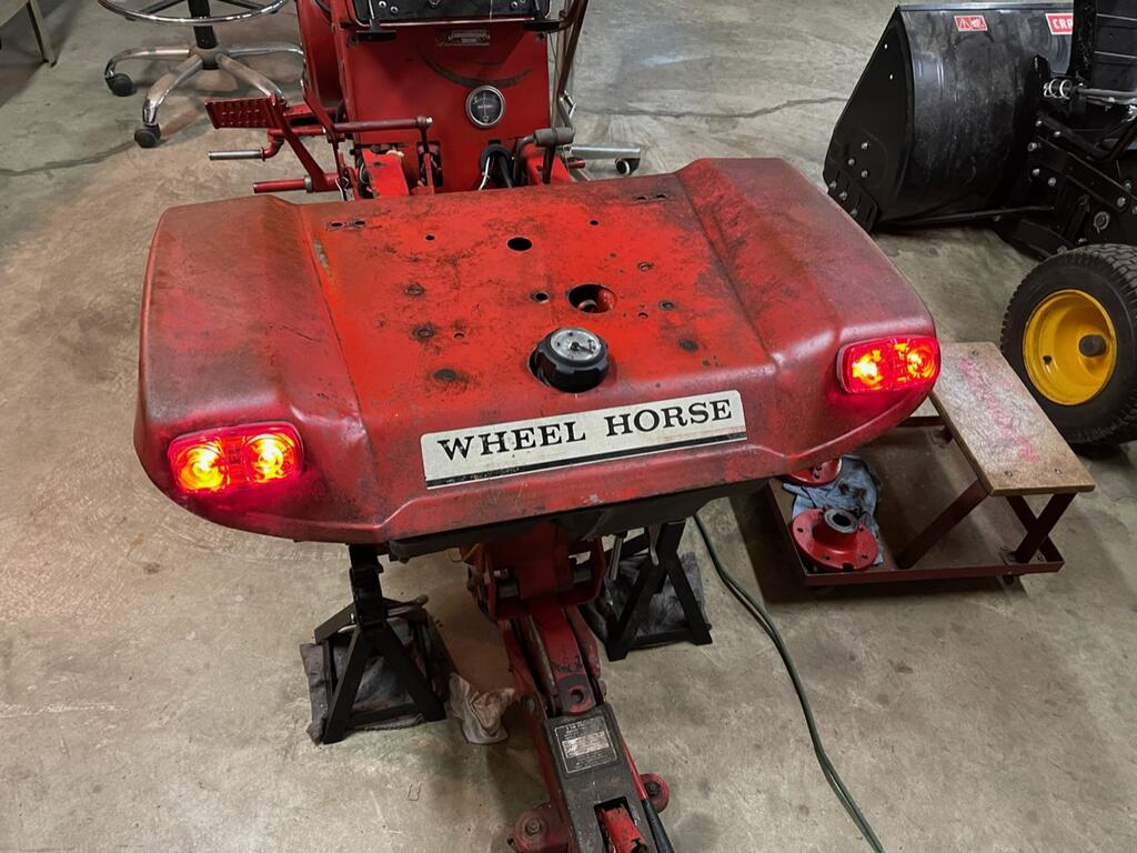

TractorEd
Here I’m testing the new wiring and led bulbs in the tail lights.  Still waiting on that wire sleeve material.  It was supposed to be here today.  Maybe tomorrow!

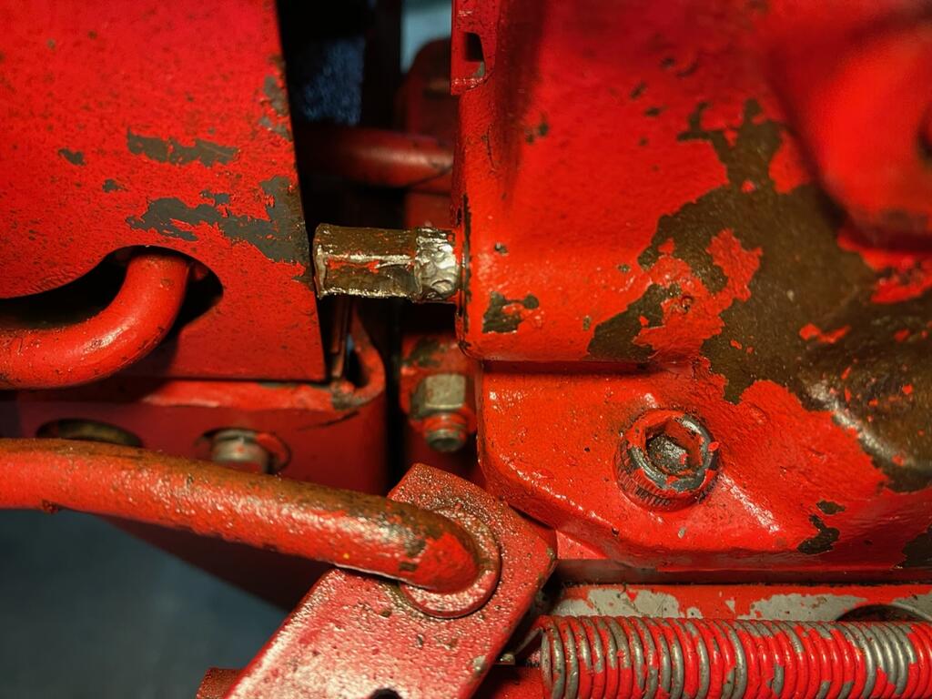

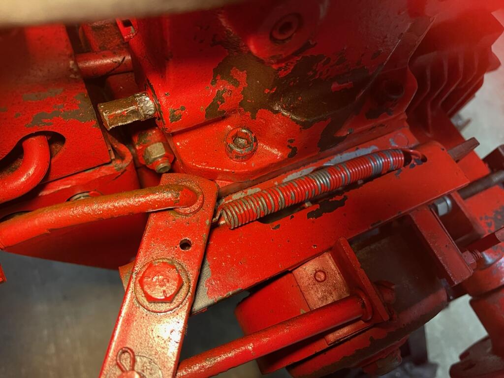

Can you show a close-up of the tow valve?
  • Like 1

I’m going out there shortly and will take a pic of the state of that tow valve.

@ebinmaine
Here’s a couple pics of that tow valve.
I got a little angry at her, LOL.

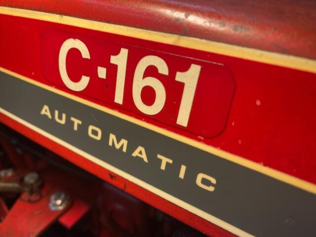

@kpinnc @c-series don
44847990-5115-40C5-9DF4-79892A6DA5AD.jpegI can see the GT 14 peeking out in a couple spots.
