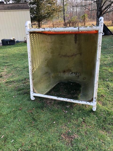

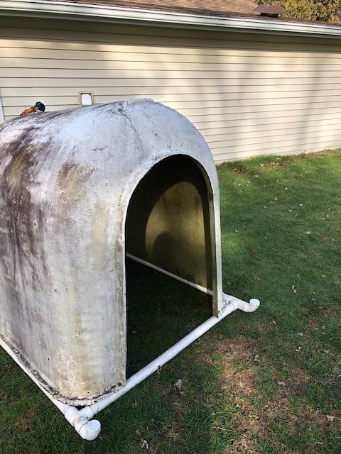

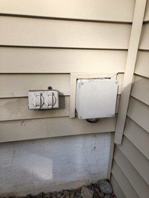

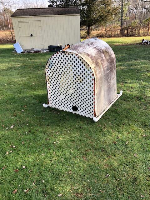

peter lena 9,854 #1 Posted December 23, 2022 picked up this rear crushed , calf hutch for cheap, years ago , cut off back end , added vinyl fencing , for air intake side . 171 pic, front entry pic 122 is now generator exhaust spot . bottom 2" pvc piping screwed on for easy sliding/ movement . basically roll up generator to pic 154 , and lower it down to ground , image 63 big box plug in point ,with cable to basement gen tran switch . heavy weather just drape a heavy chain over it , goes no where , stays absolutely dry and happy . runs under that as long as I need it , no problems at all . unused it just sits next to my shed. like this type / style / size , just another opportunity for a weather issue under power . you might ask a local farmer , thats what I did , he even delivered it , pete 1 5 Share this post Link to post Share on other sites

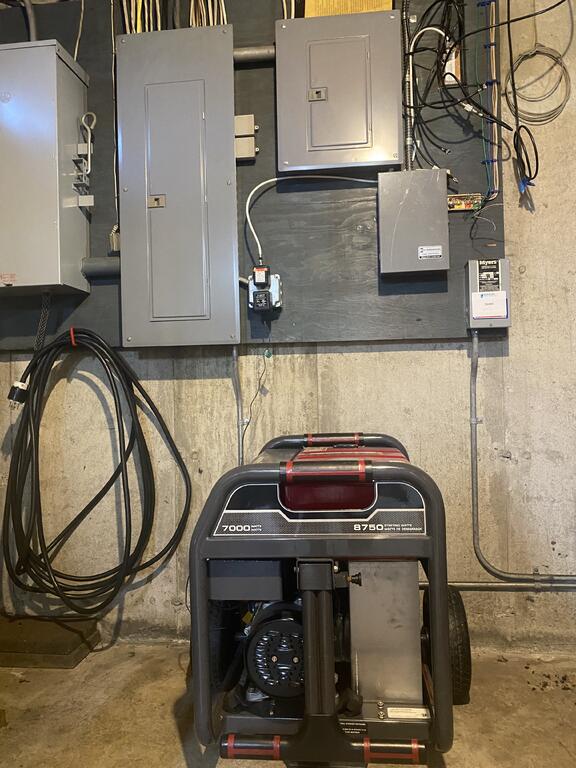

Sparky-(Admin) 25,061 #4 Posted December 24, 2022 I like that “hut” idea if I was forced to store my generator outside. But luckily I have a walk out basement so she lives inside next to the breaker panels where even on the coldest days (like 5 degrees today!!) it never gets below 60 degrees. It’s also always plugged in to the little battery tender thingy that it came with. 4 2 Share this post Link to post Share on other sites
