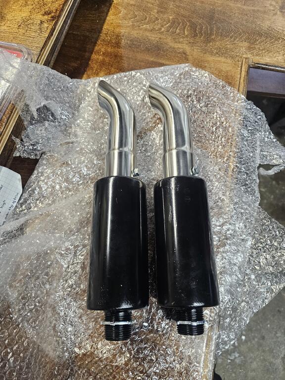

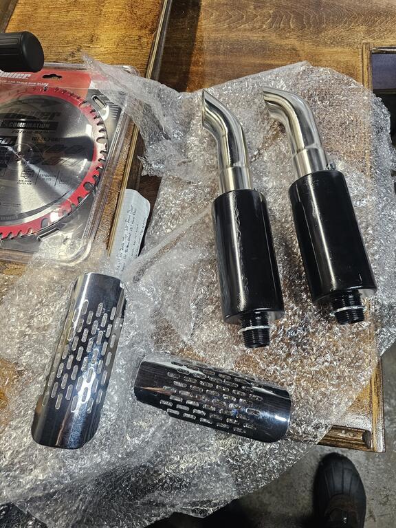

OldWorkHorse 3,153 #27 Posted March 3, 2023 Received the 7317's new stacks from @jimkemp today! Absolutely awesome! Should have got some of these awhile ago. Oh well i have them now and cant wait to have them on the running engine and hear how they sound! Thanks again Jim! 1 5 2 Share this post Link to post Share on other sites
jimkemp 528 #28 Posted March 4, 2023 Those shields are going to look very cool on them , where did you find those ? 1 Share this post Link to post Share on other sites
Blasterdad 3,163 #29 Posted March 4, 2023 29 minutes ago, jimkemp said: Those shields are going to look very cool on them , where did you find those ? I thought the same thing, thought maybe Jim made them but guess not... They look great! 1 1 Share this post Link to post Share on other sites
ebinmaine 78,971 #30 Posted March 4, 2023 8 hours ago, jimkemp said: Those shields are going to look very cool on them , where did you find those ? 8 hours ago, Blasterdad said: I thought the same thing, thought maybe Jim made them but guess not... They look great! They're an eBay/Amazon find. Motorcycle heat shields. @OldWorkHorse sent me a link where one can order chrome or black. 2 Share this post Link to post Share on other sites
OldWorkHorse 3,153 #31 Posted March 4, 2023 Yes picked them up skimming though the jungle site and they fit the 6" stack perfectly! Can't wait to have them plumbed on up on a running engine and tractor. 3 Share this post Link to post Share on other sites

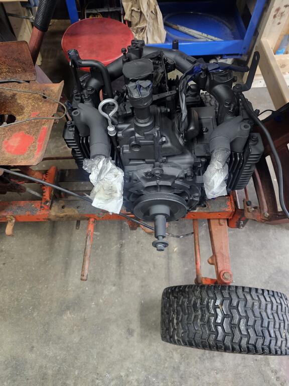

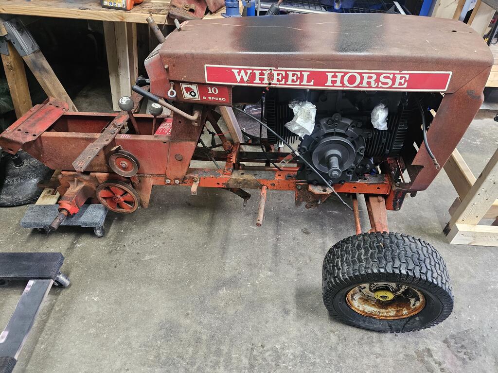

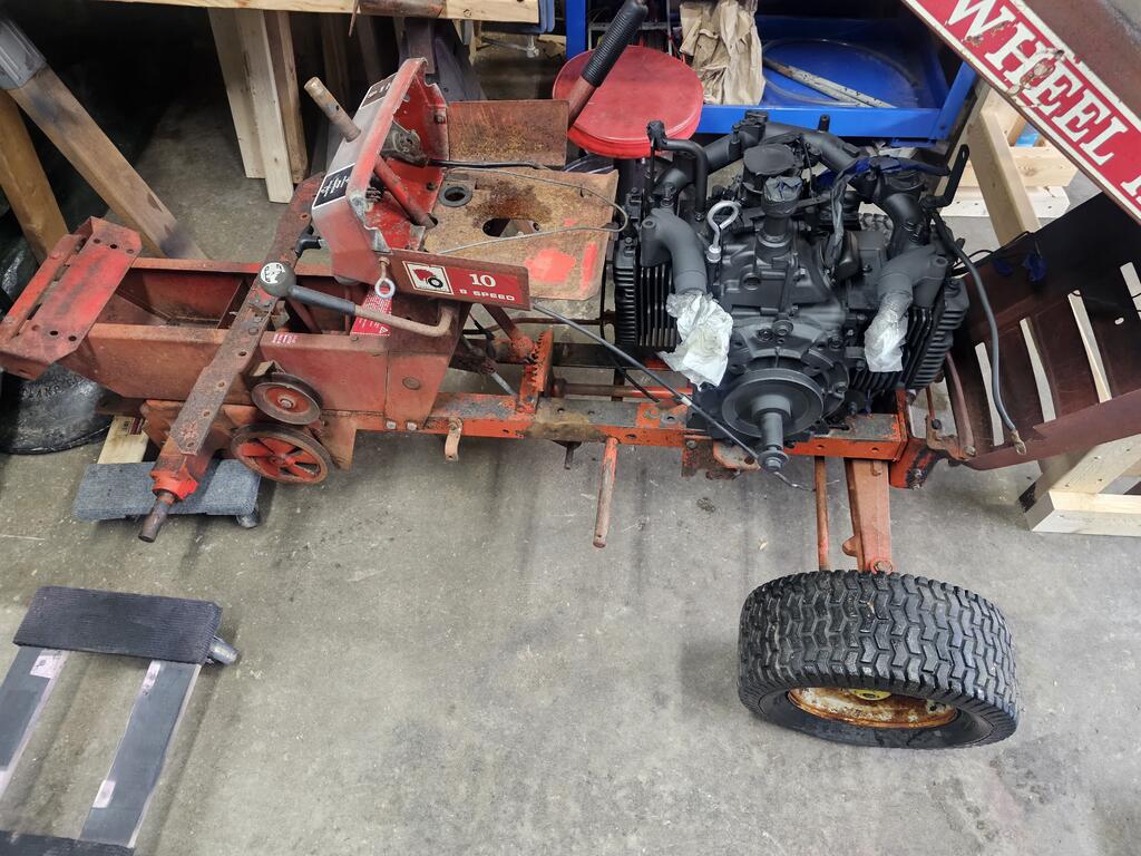

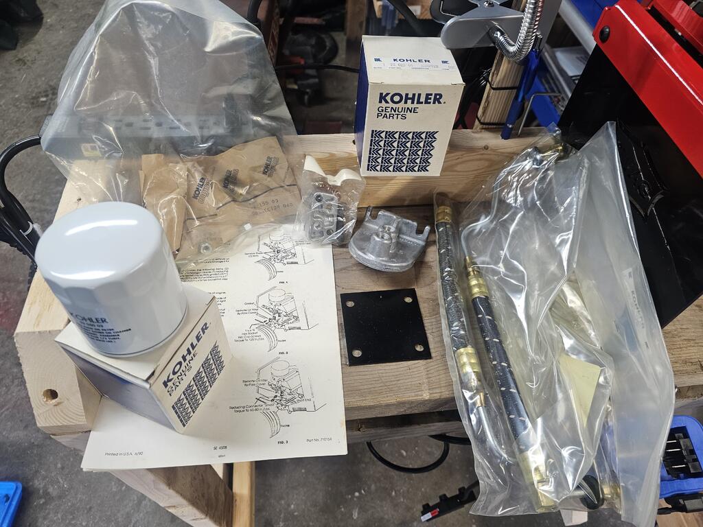

OldWorkHorse 3,153 #34 Posted March 11, 2023 (edited) Found a NOS oil filter kit for the KT17 series 2 with install instructions so that will be a nice addition to the engine also got some gaskets in to have. Set the engine on the frame again so I can start mocking things up get some ideas and numbers before I take it all apart. Going be tight, but if there is a will there is a way. Also took the stock muffler off since was in great shape and stored that, was just to clean to alter it at all, and replaced it with some header pipes I will make the custom exhaust off of to fit the new stacks. Edited March 11, 2023 by OldWorkHorse 4 Share this post Link to post Share on other sites
ebinmaine 78,971 #35 Posted March 11, 2023 6 hours ago, OldWorkHorse said: transmission off to tear it open My transmission bench is ready when you are. 3 hours ago, OldWorkHorse said: . Going be tight Move the battery and it'll add some much needed space. 1 1 Share this post Link to post Share on other sites
OldWorkHorse 3,153 #36 Posted March 11, 2023 (edited) 2 hours ago, ebinmaine said: Move the battery and it'll add some much needed space. Battery and hopfuly fuel tank be relocated. Need to dig though my pile o parts see if I have the fender kit I need and see if it will work. And as for the trans it will be making a appearance as soon as I give it a diesel bath. Also picked up a NOS belt 5/8x82 I think I'm going to have to get a 5/8x83 to adjust the engine to still close hood. Edited March 12, 2023 by OldWorkHorse 2 Share this post Link to post Share on other sites
ebinmaine 78,971 #37 Posted March 12, 2023 25 minutes ago, OldWorkHorse said: fuel tank be relocated Once the snow melts I can look for a fender bracket for you 1 Share this post Link to post Share on other sites
OldWorkHorse 3,153 #38 Posted March 12, 2023 15 minutes ago, ebinmaine said: If*** the snow melts I can look for a fender bracket for you Lol you mean if* it ever melts 😅 just shovled my shop roof to get it ready for the next 1ft. 😐 winter was fun I just want spring now. 2 Share this post Link to post Share on other sites

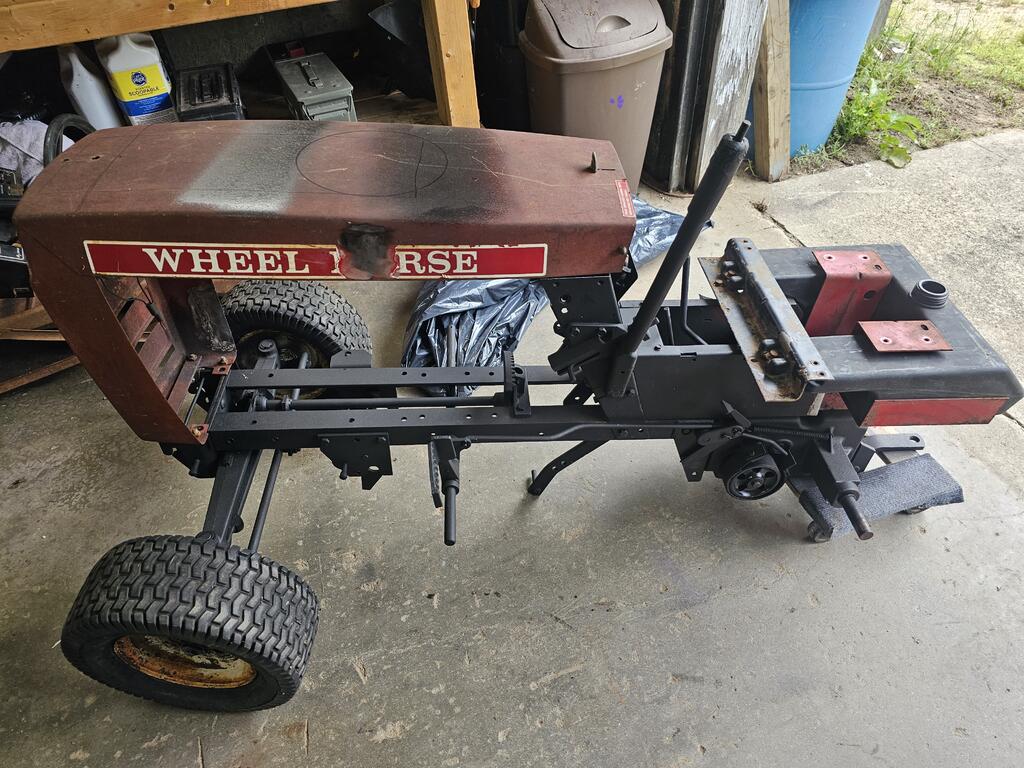

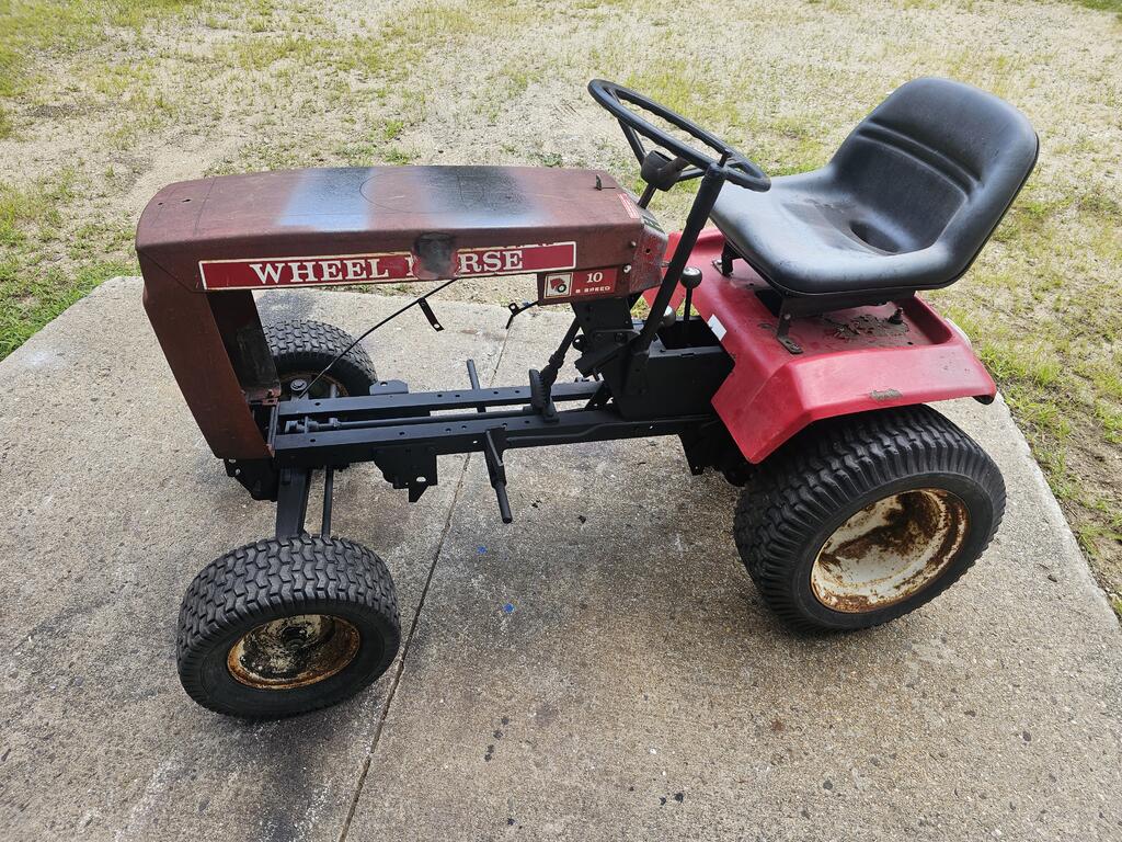

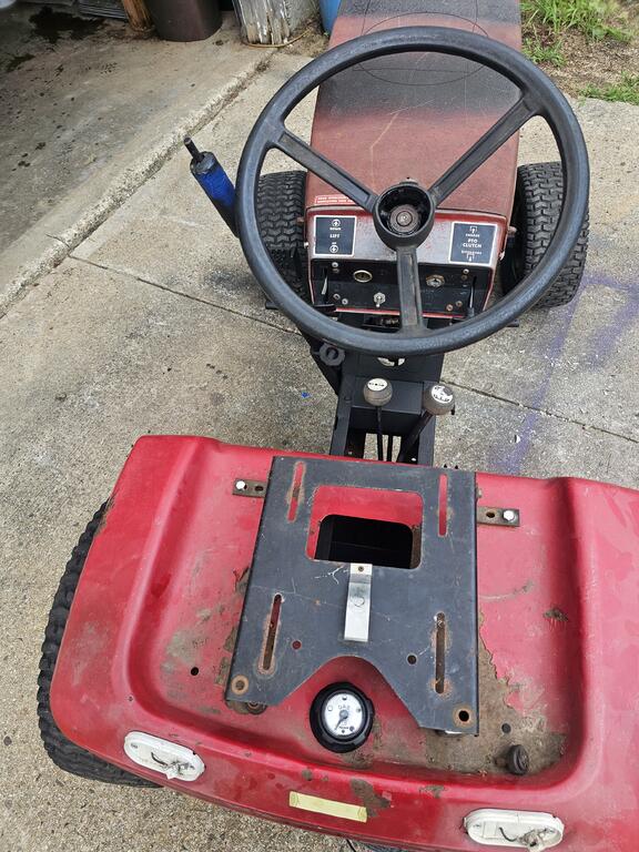

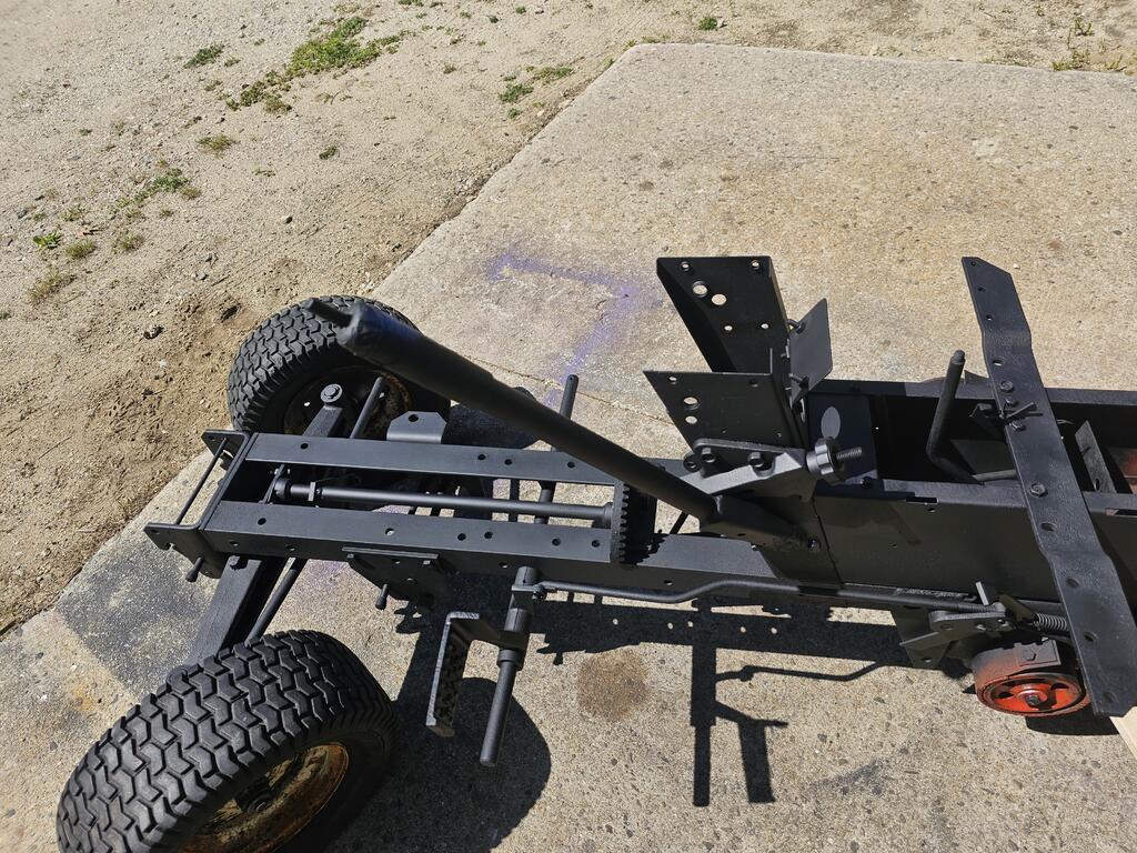

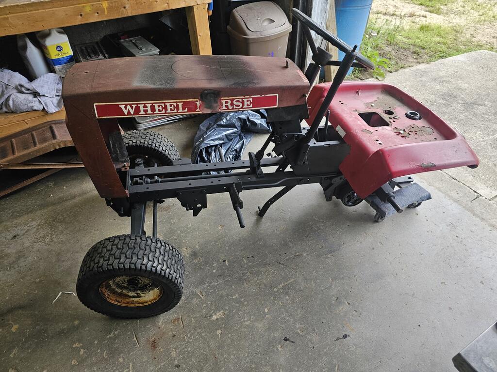

OldWorkHorse 3,153 #48 Posted July 31, 2023 Well it's been a little bit since I last posted on this sub, but I've made a little bit of progress. The hood has been patched and the dash modified for more room for the 17 twin. The rear fuel tank and 400 series rear fenders have been installed steering wheel has been installed had to remove a old one still worse thing to remove on a WH I believe. Still have a few more things to fit and mock up and weld up once get the body and feet rest installed I'll fit the engine and belt cover then tear it all down and start refreshing it. But as of now it's coming along and a good use for all the spare parts I have hanging around. Call it the 7317 but I'm thinking Frankenstein might be a bit more fitting. 3 Share this post Link to post Share on other sites
