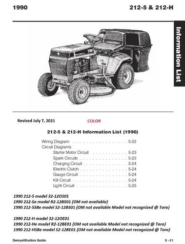

    Tractor 1990 212-5 & 212-5e Wiring Detailed Rev.pdf
    Wiring from Demystification Guide #492-4509
    5 pages 1.5MB color pdf
    p5-21 to p5-25
    Believe there are mistakes in the main diagram.
    p5-22 Wiring Color
    1 page 408KB
    1990 212-5 model 32-12B5A1
    1990 212-5 model 32-12O501
    1990 212-5 model R2-12B501 - Export model 212-5e
    1990 212-5SB model S2-12B501 - Export model 212-5SBe not listed @ Toro (Single blade mower)
    172 downloads
    Updated
  9. Free
    Tractor 1990 212-H Wiring Detailed Rev.pdf
    p5-21 to p5-25
    p5-22 Wiring Color
    1 page 408KB
    1990 212-H model 32-12BEA1
    1990 212-H model 32-12OE01

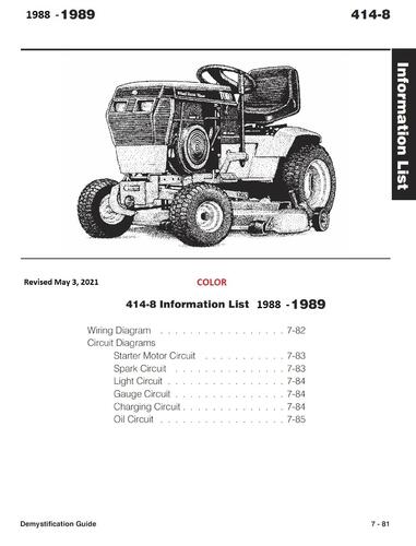

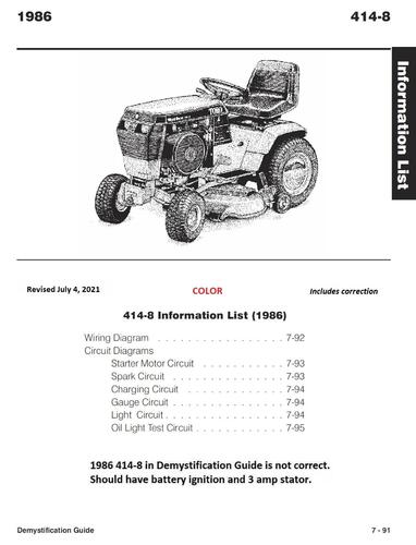

    Tractor 1986 414-8 Wiring Detailed Rev.pdf
    Wiring Detailed from Demystification Guide #492-4509 - Note - The diagram in the 523 page Demystification Guide is wrong. It shows magneto ignition and 15 amp stator
    Wiring Detailed from Demystification Guide #492-4509 Corrected Color pdf
    5 pages 1.6MB
    p7-45 to p7-49
    Uses Kohler K321S-60440 with battery ignition and 3 amp unregulated charging system
    First year for low oil switch and relay
    1986 414-8 model 31-14K801
    464 downloads
    Updated

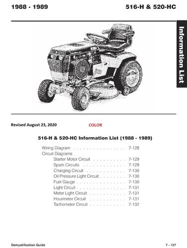

    Tractor 1988 520-HC Wiring Detailed Rev.pdf
    Detailed wiring from IPL #810623R1
    3 pages 1.95MB
    Detailed wiring from Demystification Guide #492-4509 Color
    6 pages 1.8MB
    p7-127 to p7-132
    1988 520-HC model C1-20OE01

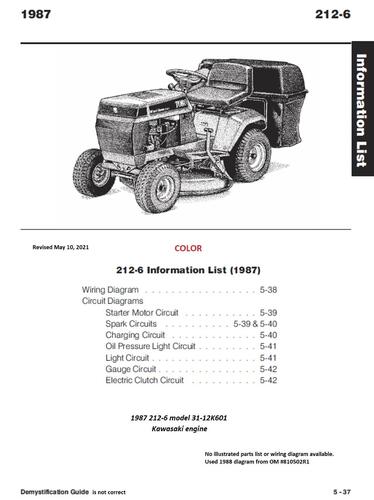

    Tractor 1987 212-6 Wiring Detailed Rev.pdf
    6 pages 226.13KB - This one is wrong
    p5-37 to p5-42
    6 pages 1.6MB Color pdf
    p5-37 to p5-42
    Uses Kawasaki FB460V-AS13
    1987 212-6 model 32-12K601
    209 downloads
    Updated

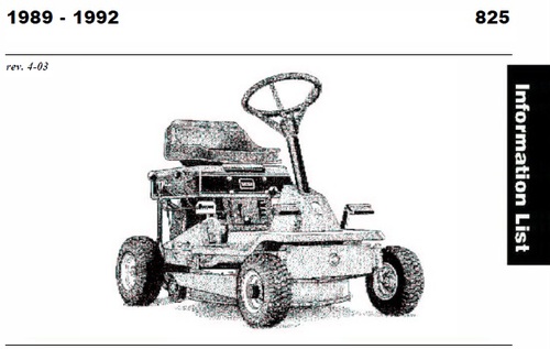

    Tractor 1989 8-25 RER D&A OM IPL Wiring SN.pdf
    Model 56123
    Operator manual #3313-797
    28 pages 2.06MB
    IPL #3313-820
    28 pages 5.24MB
    Details & Attachments
    2 pages 109.52KB
    1989 8-25 Rear Engine Rider model 56123 Serial 9000001-9999999 - Recoil start
    1989 serial numbers that have shown up for the 56123
    9003999 - Could be a 56128
    Model 56127
    28 pages 2.06MB
    IPL #3313-820
    28 pages 5.24MB
    2 pages 104.50KB
    This is an electric start model but the Details page shows recoil start
    Toro names this as a 7-25 but when you get to the manuals it is a 8-25 and in places a 825.
    1989 8-25 Rear Engine Rider model 56127 Serial 9000001-9999999 - Electric start
    1989 serial numbers that have shown up for the 56127
    Model 56128
    28 pages 2.06MB
    IPL #3313-885
    20 pages 3.79MB
    2 pages 110.40KB
    1989 8-25 Rear Engine Rider model 56128 Serial 9000001-9999999 - Electric start
    1989 serial numbers that have shown up for the 56128
    9003999 - Could be a 56123
    390 downloads
    Updated

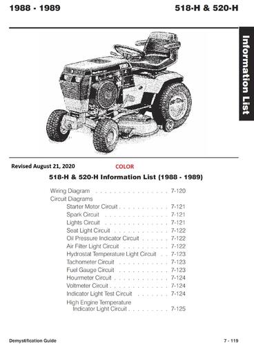

  19. Free
    Tractor 1988 518-H Wiring Detailed Rev.pdf
    3 pages 2.25MB
    Detailed wiring from #492-4509 Color pdf
    7 pages 2.1MB
    p7-119 to p7-125
    1988 518-H model 31-18OE01
    248 downloads
    Updated

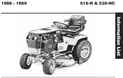

    Tractor 1988 516-H Wiring Detailed Rev.pdf
    Wiring Detailed Color
    6 pages 1.8MB
    p7-127 to p7-132 from the 492-4509 Demystification Guide
    Wiring Detailed from IPL #810623R1
    2 pages 771.80KB
    516-H Wiring Colored pdf
    1 page 344KB
    Wiring from OM #810514R1
    1 page 119.79KB
    1988 516-H model 31-16OE01
    309 downloads
    Updated
  21. Free
    Tractor 1989 520-HC Wiring Detailed Rev.pdf
    6 pages 1.8MB color
    p7-127 to p7-132
    1989 520-HC model C1-20OE02
    147 downloads

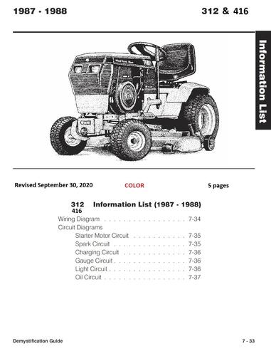

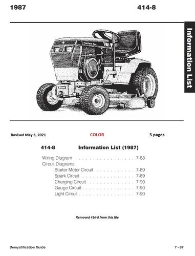

    Tractor 1988 416-8 Wiring Detailed Rev.pdf
    Detailed wiring from the Demystification Guide #492-4509 Revised April 24, 2020
    5 pages 1.7MB Color pdf
    Pages p7-33 to p7-37
    Pto switch wiring photo
    1 page 198KB
    Magneto ignition and 15 amp stator
    Low oil switch
    1988 416-8 model 31-16K804
    Original removed because of mistakes
    4 pages 103.77KB
    p7-87 to p7-90 from the 492-4509 Demystification Guide
    This is not correct for the 1987 414-8 which has a 3 amp unregulated charging system.
    1988 has a 15 amp charging system
    453 downloads

    Tractor 1987 416 Wiring Detailed Rev.pdf
    1 page 198KB
    Low oil switch
    1987 416-8 model 31-16K803
    Removed this file because of mistakes.
    4 pages 103.77KB
    p7-87 to p7-90

    Tractor 1989 312-8 Wiring Detailed Rev.pdf
    Detailed wiring from the Demystification Guide #492-4509 Color Revised
    5 pages 1.6MB pdf
    pages p7-27 to p7-31
    Color wiring pdf
    1 page 516KB
    1 page 198KB
    15 amp stator and magneto ignition
    1989 312-8 model 21-12K806
    1989 312-8 model E1-12K802 - Export model 312-8e - Suspect the wiring is the same as for the domestic model
    579 downloads
