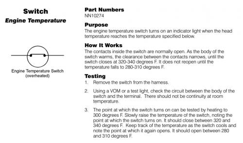

Switch Engine temperature Onan NN10274 .jpg 1.0.0
Taken from #492-4509 Electrical Manual
82-12o502* - Correct
82 -12o502 - Not correct

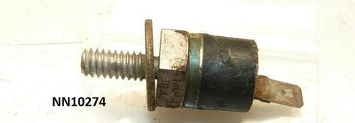

NN10274 Onan engine temperature switch
