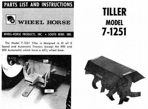

  5. Free
    Tiller 36in 1973-1974 7-1251 OM IPL SN.pdf
    Operator manual #526
    IPL
    14 pages 659.74KB
    Dated 7-73 Revised 9/73
    Fits all 8-speed and Automatic tractors with long frame 45-1/2" wheel base (Except 800 and 800 Automatic)
    Includes PSB's #143 #145 #T010 #T91-P 14
    Drive belt # 1599 (HA x 139.00in 1/2" x 139")
    If used on later twin-cylinder models use belt # 103635 which has been replaced by # 110265 (1/2" x 141.00")
    Tiller 1973 36in model 7-1251
    1973 serial numbers that have shown up for the 7-1251
    0955731 - Model 7-1251-8
    0982420 - Could be a 1974 model
    Tiller 1974 36in model 7-1251
    1974 serial numbers that have shown up for the 7-1251
    0050827 - Model 7-1251-9
    0051049 - Model 7-1251-9
    0051106 - Model 7-1251-9
    0991821 - Model 7-1251-9
    1032203 - Model 7-1251-9
    1032231 - Model 7-1251-9
    826 downloads
    Updated

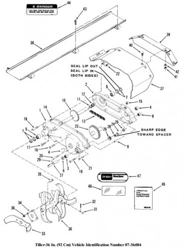

  8. Free
    Tiller 36in 1990-1991 07-36TL04 TIPL SN.pdf
    IPL from Toro Mater Parts Viewer
    5 pages 352.68KB
    Drive belt # 103635 which has been replaced by # 110265 (1/2" x 141.00")
    Tiller 1990 36in model 07-36TL04
    1990 serial numbers that have shown up for the 07-36TL04
    0070561
    0070602 - Build date 1990 0058 February 27 Tuesday
    0070710 - Build date 1990 0060 March 01 Thursday
    0071178 - Build date 1990 0117 April 27 Friday
    0071292 - Build date 1990 0134 May 14 Monday
    0071373 - Build date 1990 0135 May 15 Tuesday
    0071436 - Build date 1990 0135 May 15 Tuesday

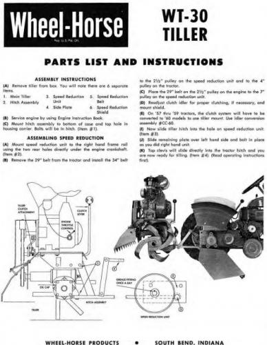

  9. Free
    Tiller 30in 1960 WT-30 OM IPL sn.pdf
    Operator manual #A-7139
    IPL
    3 pages 340.16KB
    Belt sleeve pdf
    1 page 168KB
    Self powered by horizontal shaft engine
    1957-1959 tractor models require CC-60 idler conversion assembly for speed reduction kit included with the WT-30
    RJ-58 and RJ-59 require CC-60 clutch conversion
    WT-30 Tiller for Suburban tractors used K91 Kohler engine
    Info from tiller illustrated parts list
    Item #45 Tiller drive belt 1571 - (4L x 32 or 1/2" x 32")
    Item #52 Speed reduction drive belt 1572 - (4L x 34" or 1/2" x 34")
    Info on belt sleeve
    WT-30 - 1960 tiller drive belt 1573 replaced by 1561 - (4Lx30" or 1/2" x 30")
    WT-30 - Speed reduction drive belt 1574 replaced by 517439 - (A x 33.10" or 1/2" x 33.1")
    Tiller 1960 30in model WT-30
    219 downloads
    Updated

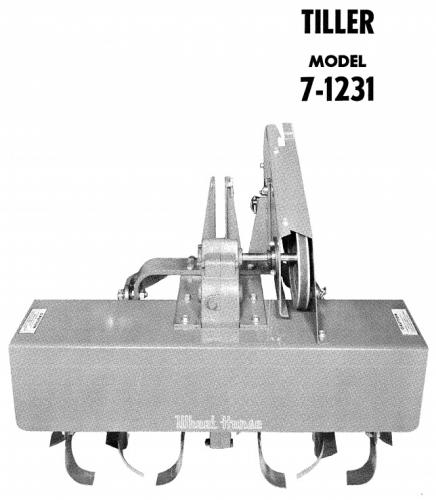

  11. Free
    Tiller 36in 1969 7-1231 OM IPL SN.pdf
    Operator manual #A-5251
    IPL
    4 pages 408.46KB
    Fits GT-14 with 3ph
    Drive belt 9151 (5L x 90 or 5/8" x 90")
    Supplement #A-5251
    Mower deck and dozer blade support hooks for GT-14
    2 pages 218.31KB
    Tiller 1969 36in model 7-1231
    1969 serial numbers that have shown up for the 7-1231
    608052
    608083
    452 downloads
