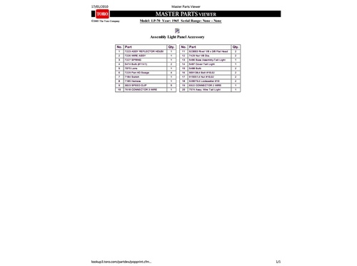

    Light kit 1965-1967 LP-70 TPL.pdf
    PL from Toro Master Parts Viewer
    1 page 85.40KB
    Found LP-7 headlamp panel in the 1968 Commando 8 model 1-4831 manual
    Found LP-75 at Toro for 1965-1967
    284 downloads
