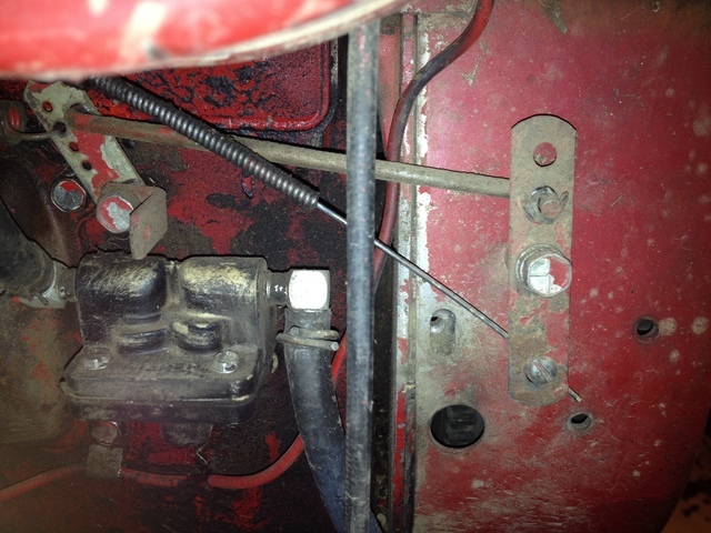

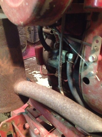

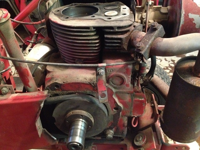

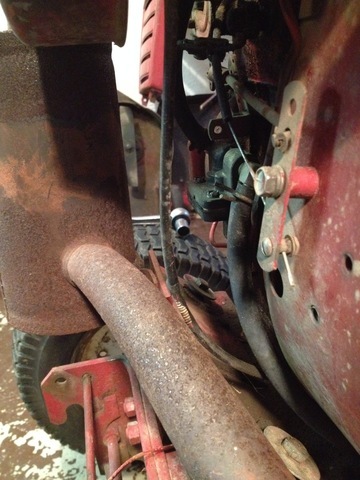

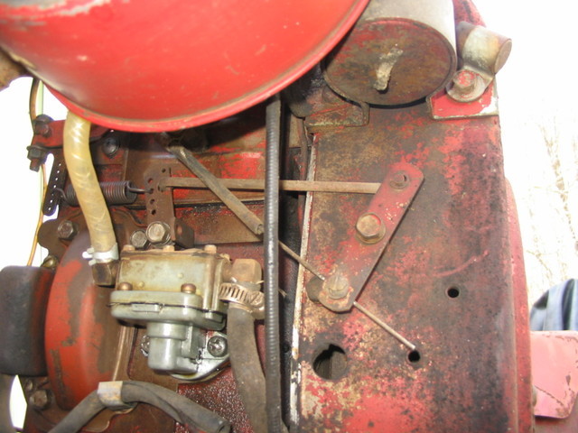

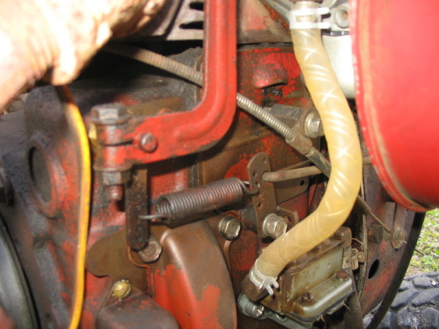

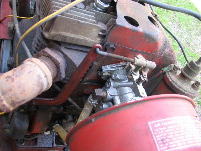

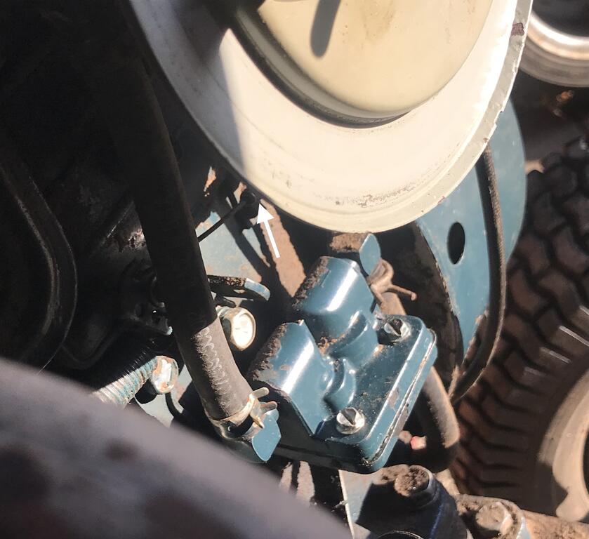

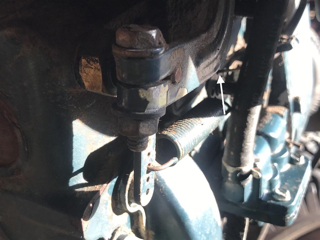

Morning all, does anyone have a picture of the correct route for the throttle cable on a C series 101-161?
I can't seem to find a good place for mine without fouling the governor arm, I'm not sure if I have brackets missing or what, so a picture of this set up would be greatly appreciated.

Here is a Kohler 10hp...s/b same as for a 16hp..

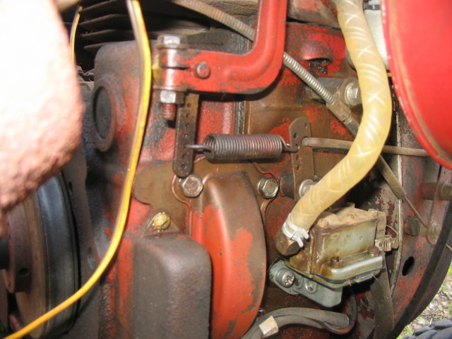

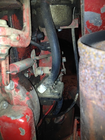

Here is my '79 C-121.
I don't know what the deal is with the last pic being so small.  There is bracket that supports the throttle cable which is mounted behind the pto lever bracket.

@cschannuth its a Kohler@daveoman1966 @TDF5G thanks guys that explains a lot.
I don't have the bracket from the breather/valve cover.
