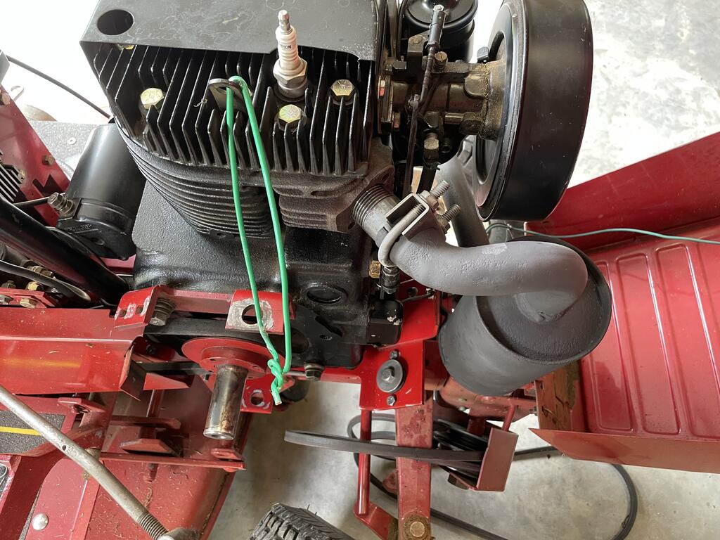

What is the correct routing for the throttle cable? This just CAN'T be correct! It's right on the cooling fins of the engine, it's done melted the skin off the cable! Maybe it's a replacement cable and simply too short?
If someone could post a pic of the correct routing it would be much appreciated!

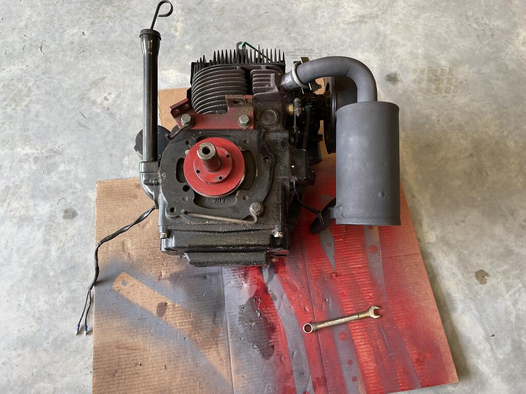

Hi all,
I was finally able to take a week off and lost myself in catching-up on the '80 C-125. I've had the engine sitting rebuilt on the bench - repaired the Hi/Lo last year - and was finally able to run her in last Tuesday after mounting. She only needed rings and a good valve lap. There is no end to the money that can be spent on a restoration or the amount of time in grinding, priming and painting with old Regal Red. At this rate, it will be summer before I'm done but it will have been worth the love. The 42" deck can use some minor welding but I had everything operational before I tore her down. Too much repair to list as this poor girl was buried in a southern backyard. Enjoy the pics - August last year after dragging it onto the trailer, this past Tuesday for break-in and just a few minutes ago. Back to work tomorrow so no more fun all day in the garage but should at least have the covers on when the Jacks belt and PTO brake order gets here later in the week.
