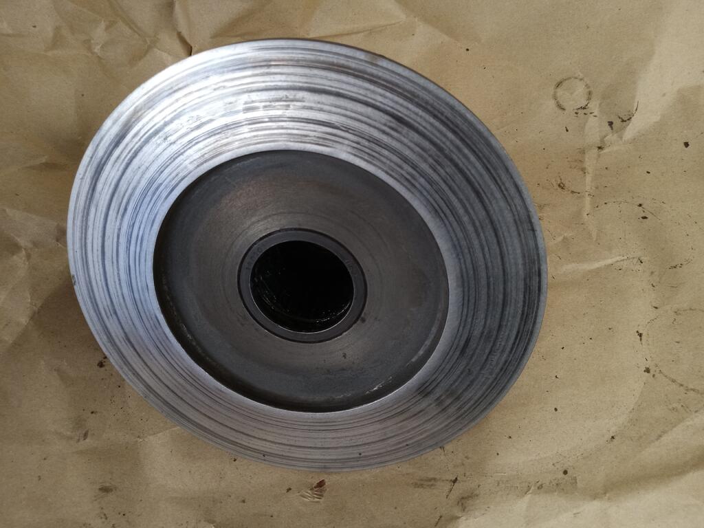

Bought one of the "blue belts" from TSC I read about on Wheel Horse Forum.  Used a random orbital sander to get all the melted belt off.  Replaced the outer bearing, repacked the inner.  I'll put it all back together today and see what happens...
You are showing the clutch face as if the belt might ride there.  I have never seen a clutch face look like yours, please tell us that the belt didn’t do that.
That's the back side of the clutch housing after being sanded down.  cCapture.JPG.5beecf2bddea2a98e1a6c701e6e84181.JPG
lynnmor
Yes, I know what it is but you mentioned
sanding the surface to remove belt residue.  I turn the clutch face on a lathe before installing new bearings.
Rick3478
If you're keeping the existing friction material, I'd leave it alone.  The contour already matches, and turning will cause increased slipping and wear until the contour matches again.  Now if you're gonna put in a new friction disk, cleaning it up makes sense.

@the jeep driver  your last clutch face picture , think i,m looking at the issue , notice the 7 to 5  rusty arc  at the bottom of that sleeve to needle bearing point ? if you had  lubricant failure there , to any degree , that entire unit  could not spin like it should . that needle bearing both carries and slides in function , from the belt burn on those pulleys , that entire unit is fighting itself  against binding . also did you re grease the muel drive bearings ? 550 deg  lucas grease . the lateral loading on those , destroys regular grease . wish you were closer , love to kick that in the a-- . pete

I have to apologize to everyone who participated, I never followed up regarding this... I replaced the bearing (part 36 in the schematic) and greased the others.  I put everything back together and it's been mowing great ever since.
