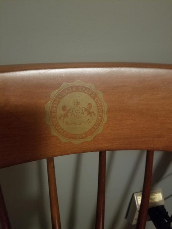

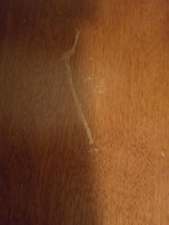

cafoose 3,853 #1 Posted August 11, 2022 @formariz @953 nut or anyone else. I have a 25 year anniversary chair for years of service at Hershey Medical Center. It has a scratch maybe 1/32 or 1/64 deep. How can I fix it? 1 Share this post Link to post Share on other sites

formariz 12,381 #8 Posted August 11, 2022 First you have to realize that it will always be somewhat visible specially to you. There isn’t also a quick fix. It takes time and patience.Having said that first determine whether scratch has penetrated only finish or has it gone into the wood it self. Do not attempt to stain it since most likely will turn dark and therefor even more noticeable. If it went into the wood the best way is to burn in a lacquer stick of the appropriate color. That requires a certain knowledge and equipment. However it will be the best fix and it is durable. If it is only through finish you have only to introduce appropriate finish material into damage area and build it up in little steps. Eventually then it has to be leveled off such as in the case of lacquer stick. That means the entire seat has to be polished otherwise you will have a big different spot rather than a scratch. You are going to need more instructions than a simple post. Determine what you need to do. I can lend you the proper stuff for the burning in method. If needed I can also do a small video teaching you how to do it. Always best watching someone . Take your time and don’t be in a hurry. That will only make it worse. 2 2 1 Share this post Link to post Share on other sites

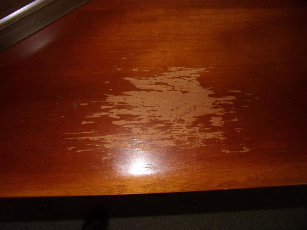

Ed Kennell 47,398 #9 Posted August 11, 2022 (edited) Congrats on the 25 year chair Chuck. I'm jealous, all i got for 48 years was a handful of tie tacks. And I never wear a tie. If you don't mind, while the experts are on here, what's the best way to fix this water damage on a maple dresser? Edited August 11, 2022 by Ed Kennell 1 3 Share this post Link to post Share on other sites

formariz 12,381 #11 Posted August 11, 2022 It’s deep and into the wood. Can be satisfactorily repaired but always noticeable. The only way to totally get rid of it would be to redo the whole seat. I know it’s important to you. You need to decide how you want it to come out. 1 1 Share this post Link to post Share on other sites
formariz 12,381 #12 Posted August 11, 2022 18 minutes ago, Ed Kennell said: best way to fix this water damage on a maple dresser? It may be best to redo the whole top Ed. That finish is a bit of a glaze where the top coat also has color. Commercially made furniture is sprayed with a toner so regardless of the differences in different pieces of material it all comes out with an even tone. 1 1 Share this post Link to post Share on other sites

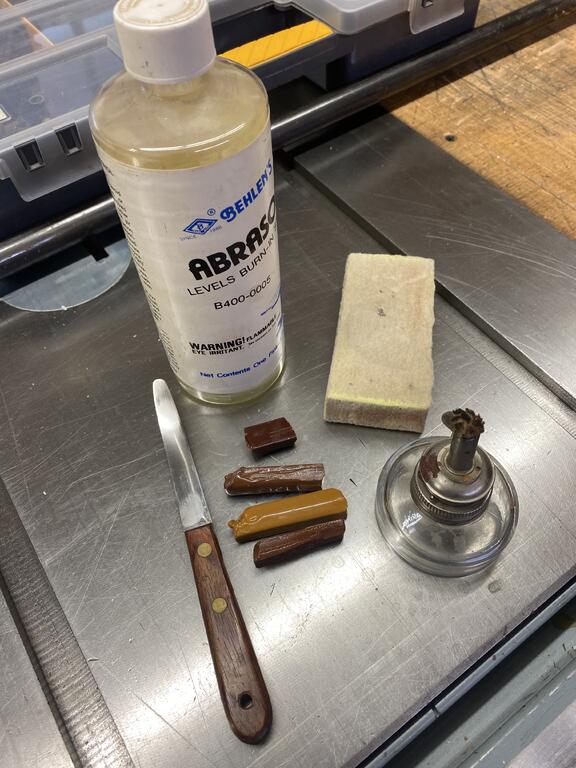

formariz 12,381 #14 Posted August 11, 2022 This is all you need for the repair. 1 1 Share this post Link to post Share on other sites
cafoose 3,853 #15 Posted August 11, 2022 4 minutes ago, formariz said: This is all you need for the repair. Thanks Cas, can you tell me how to use those things to make the repair? Share this post Link to post Share on other sites
formariz 12,381 #16 Posted August 11, 2022 (edited) 15 minutes ago, cafoose said: Thanks Cas, can you tell me how to use those things to make the repair? Yes. Give me a little time. I’ll do a short video. It’s real simple.just requires a bit of practice. Edited August 11, 2022 by formariz 2 1 1 Share this post Link to post Share on other sites

953 nut 69,478 #18 Posted August 12, 2022 19 hours ago, cafoose said: I have a 25 year anniversary chair for years of service at Hershey Medical Center. It has a scratch maybe 1/32 or 1/64 deep. Glad Cas has you covered on this problem. I have used multiple applications of wood Gel Stains to fill shallow scratches but having gone into the wood is quite another story. Looking forward to the video on the melting lacquer sticks from @formariz. 17 hours ago, Ed Kennell said: what's the best way to fix this water damage on a maple dresser You could try sanding to feather out the edges where the finish has lifted then give the whole top a light sanding and follow up with a good restoration finish. The illustration on the can is a bit misleading, without some sanding and blending nothing is going to hide a mark like that. I have used this one with success. 1 2 Share this post Link to post Share on other sites

formariz 12,381 #20 Posted August 12, 2022 Below you have a short video on how to repair scratch by “burning in “ a lacquer stick. You can use similar method using wax sticks also although it is not a durable repair. Keep a few things in mind for this and any other repairs; Don’t expect invisibility specially on a horizontal surface. It’s not possible. Light reflection differences are very noticeable on repairs in horizontal surfaces. Video is on a relatively dark piece of finished mahogany. You will get better results on a lighter finish. Take your time , the easy part was scratching it. Impatience, hard rubbing or drastic measures are only going to make it more noticeable. Scratches along grain will always be less visible than the ones across the grain. As much as possible touch only damaged area and nothing else. Doing so will only aggravate and spread problem The only way to get rid of it would be to sand seat part and refinish. Not easy due to spindles and then very good possibility that it will be different from rest of chair. Damage on chair seems to be on concave part of seat . To use my leveling method you will need a gouge and not a chisel. If you are going to attempt this method practice on another piece until you are comfortable with process and realize the result of certain actions. Let me know if I can assist you with anything you will need should you decide to take this route. 3 Share this post Link to post Share on other sites
