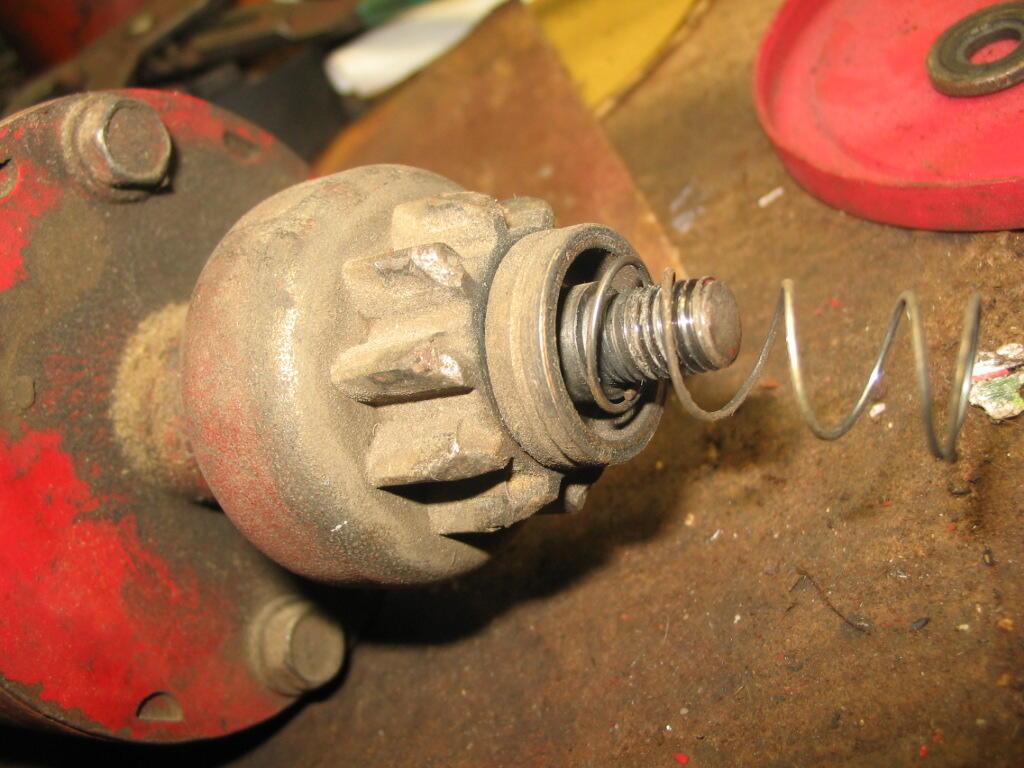

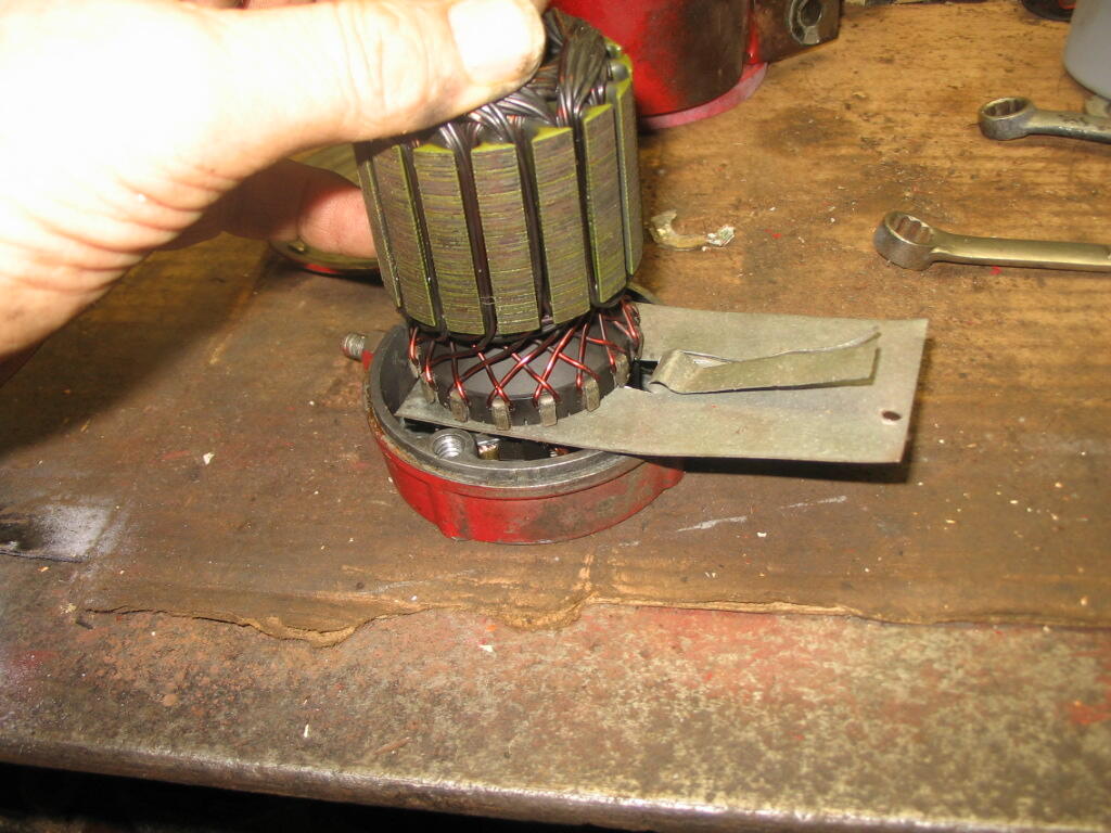

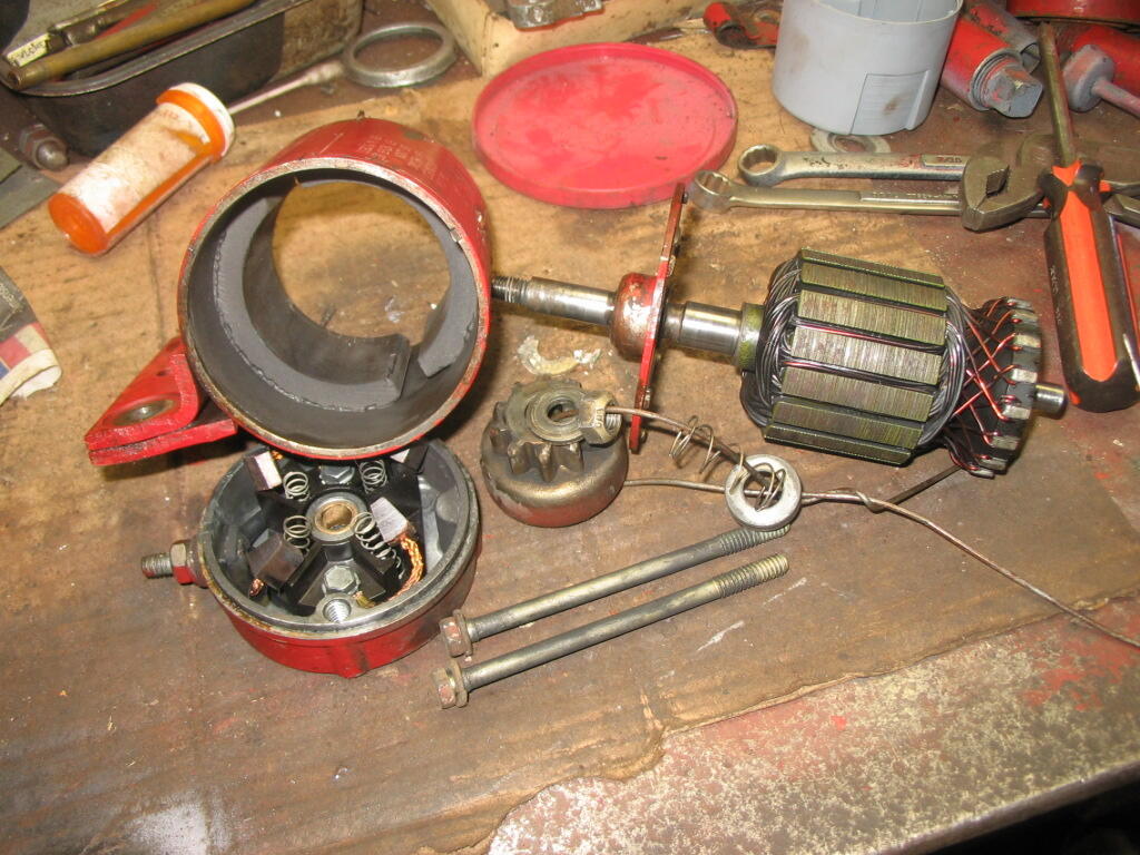

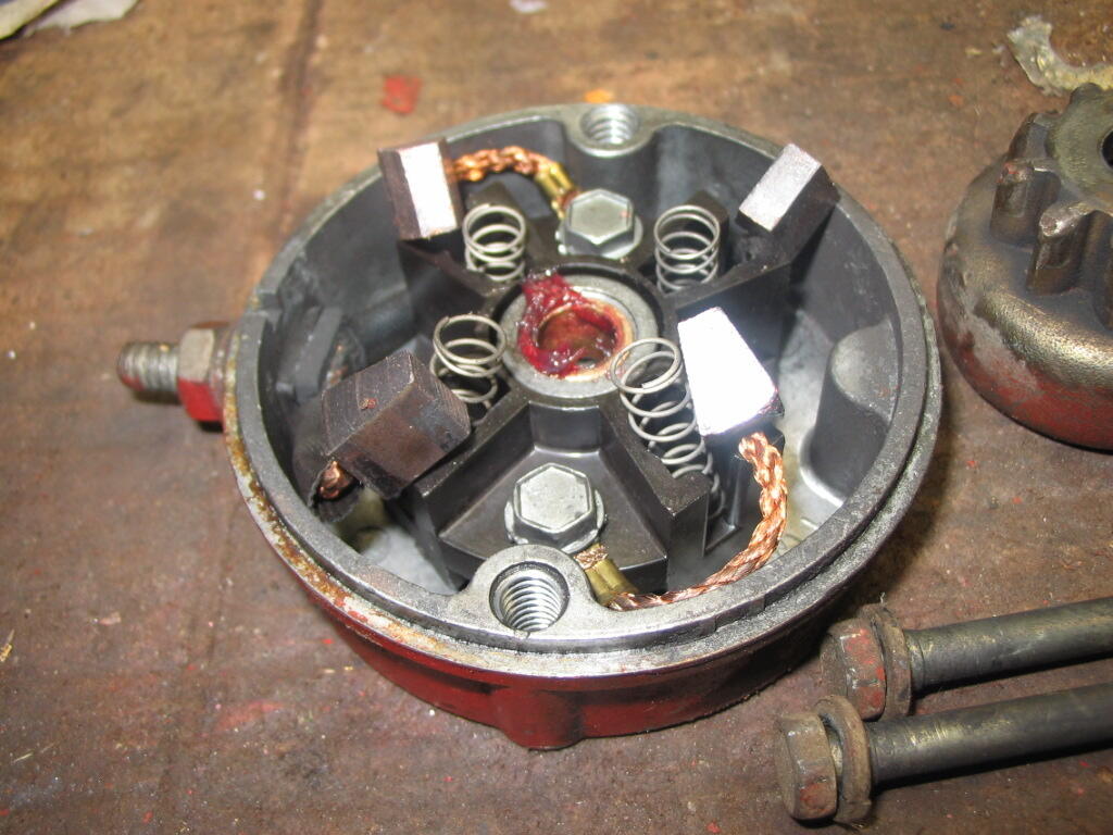

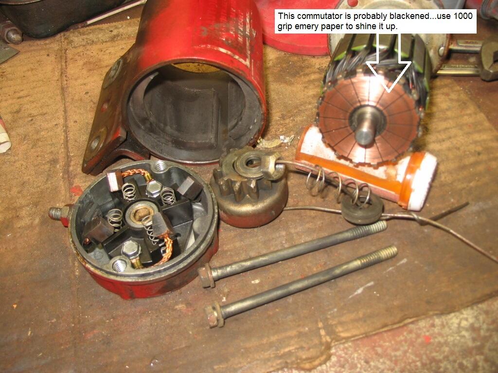

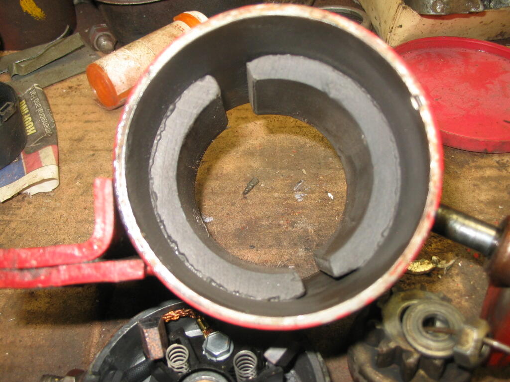

daveoman1966 3,884 #3 Posted August 6, 2022 (edited) Is the battery charged? Are all connections secure and NOT corroded? Will tractor start by jumpin the solenoid...with key ON? If ans to all is YES, then take the starter off and clean it up. Easy to do. Be sure to reassembly location marks on body and end caps BEFORE you tear it apart. These get all crudded up and usually (not always) just need cleaned out & lubed. Be sure the BENDIX GEAR isn't badly worn or chipped...it can be had new. The MAGNETS on the inside should not be grossly chipped...blow out any tiny chips that may impair function. Use LUCAS sticky red grease on BOTH bearings. The FOUR BRUSHES should be smooth, equally worn, and not worn down to the wire. If so, replace the 4 brushes. For reassembly, hold the 4 brushes in position with a trimmed-out piece of stiff metal...then lower the magnetic field down onto the end cap. slide the metal out when the brushes are positioned. Edited August 6, 2022 by daveoman1966 1 5 Share this post Link to post Share on other sites

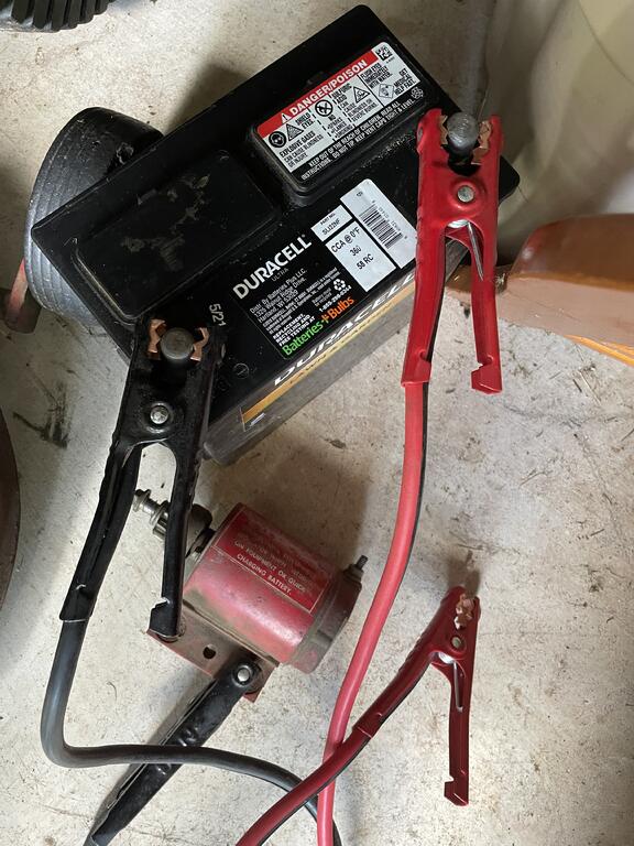

rnphila 5 #10 Posted August 7, 2022 The starter works fine, I took it off and tested with the battery. It had 12v on the black wire connected to it. How do I test solenoid? It has three wires, right? Ground, red and thin red wire going under the chassis. Share this post Link to post Share on other sites

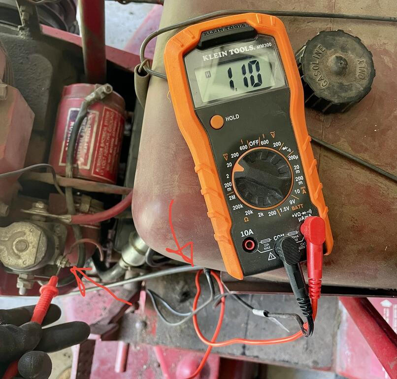

rnphila 5 #14 Posted August 7, 2022 9 minutes ago, squonk said: Another thing. Is there an ammeter on this tractor? If it fails or it's connections are bad it will kill all power to the key switch. Yes, there is ammeter. So, the salenoid 12 minutes ago, squonk said: Check for 12 volts at the little wire at the solenoid with the key in the start position. If you have it, check for 12 volts at the positive wire at the starter. If you have it. clean all of your ground connections. There is one big wire coming from the battery positive. Should be 12 volts all time. Other 2 wires should be 12 volts with the key in the crank position. Soleoid grounds through it's mounting bolts. Does it click when you try to start it? The solenoid clicked once after I put battery and started back. Not it’s quiet. Voltmeter shows 2v on the small wire when I put key at run position. And about 4V on solenoid red and black 12.5v when key is off Share this post Link to post Share on other sites

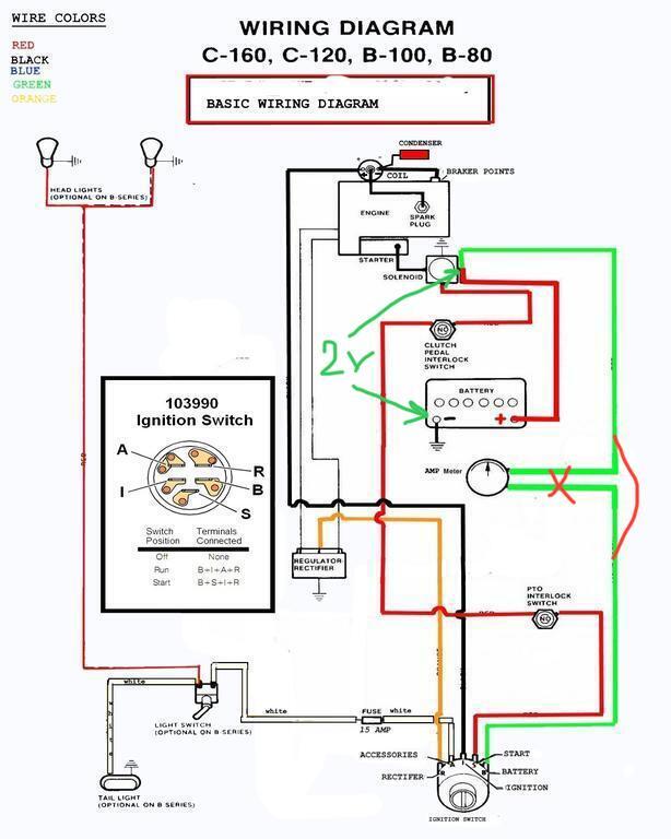

squonk 48,322 #15 Posted August 7, 2022 Just now, rnphila said: Yes, there is ammeter. So, the salenoid The solenoid clicked once after I put battery and started back. Not it’s quiet. Voltmeter shows 2v on the small wire when I put key at run position. And about 4V on solenoid red and black 12.5v when key is off The red and black large wires are both 12 volt wires. Do not put your meter across them to measure voltage. Is your meter ground going to the battery doing these tests? 1 1 Share this post Link to post Share on other sites

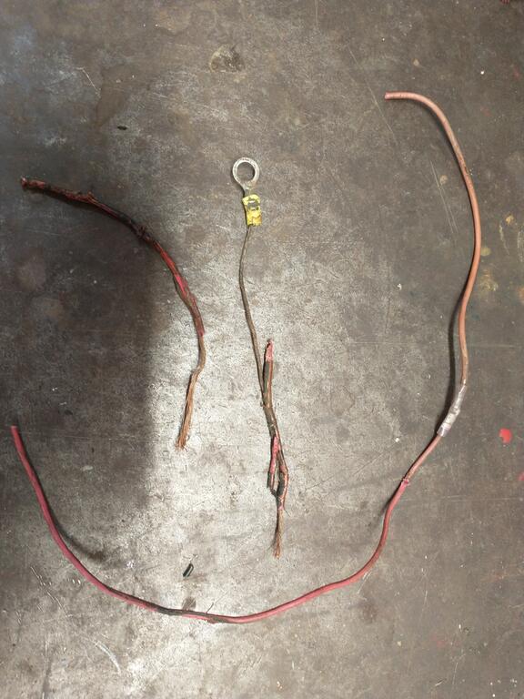

squonk 48,322 #16 Posted August 7, 2022 Look at this wire. It is the power feed on a 74 C-160. Same tractor as yours. It should be attached to your solenoid on the stud where your positive cable from your battery goes. This tractor had the same problem as yours. It feeds power to your ammeter. The ammeter was dead and the wire was actually broke where there was still insulation. Your low voltage readings make me think the issue is with this wire, ammeter or key switch. Share this post Link to post Share on other sites
rnphila 5 #17 Posted August 7, 2022 9 minutes ago, squonk said: Look at this wire. It is the power feed on a 74 C-160. Same tractor as yours. It should be attached to your solenoid on the stud where your positive cable from your battery goes. This tractor had the same problem as yours. It feeds power to your ammeter. The ammeter was dead and the wire was actually broke where there was still insulation. Your low voltage readings make me think the issue is with this wire, ammeter or key switch. There is definitely low reading (with key in run) so the solenoid get this 1.5V when the pedal pressed, which means switch on pedal working. The wires from pedal goes into the control panel. is there a way to isolate faulty device or circuit? Share this post Link to post Share on other sites
squonk 48,322 #18 Posted August 7, 2022 (edited) 13 minutes ago, rnphila said: There is definitely low reading (with key in run) so the solenoid get this 1.5V when the pedal pressed, which means switch on pedal working. The wires from pedal goes into the control panel. is there a way to isolate faulty device or circuit? There should be 12 volts at that wire with key in START There also should be a small wire on the post green wire in diagram with the large red wire feeding the key switch. I don't see it. Edited August 7, 2022 by squonk Share this post Link to post Share on other sites

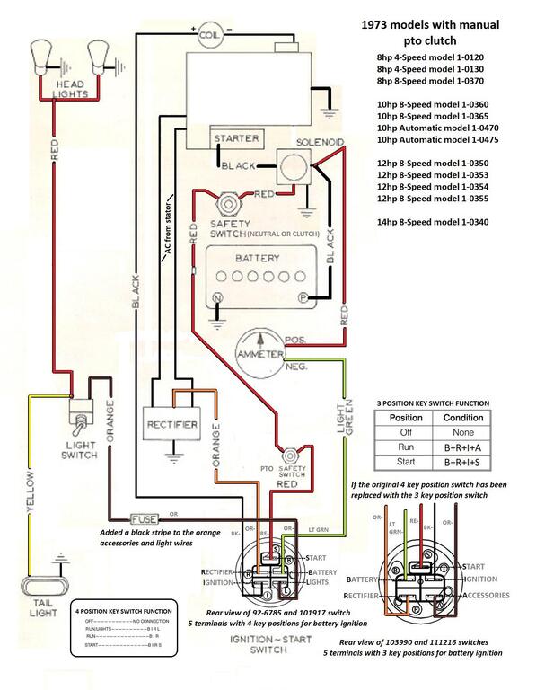

squonk 48,322 #20 Posted August 7, 2022 Here is a 73 diagram maybe it will help some. Share this post Link to post Share on other sites
rnphila 5 #21 Posted August 7, 2022 40 minutes ago, squonk said: There should be 12 volts at that wire with key in START There also should be a small wire on the post green wire in diagram with the large red wire feeding the key switch. I don't see it. Yes there is a small wire beneath the red one that connects to battery. Share this post Link to post Share on other sites
squonk 48,322 #22 Posted August 7, 2022 4 minutes ago, rnphila said: Yes there is a small wire beneath the red one that connects to battery. In the 2nd diagram, you can see it goes directly to the ammeter. If you have 12 volts on that wire at the solenoid, you should have the same at the terminal it connects to on the ammeter. If you have 12 volts there you should have 12 volts on the other ammeter post. If you don't have 12 volts on the first post, you have a bad wire like I did. If you have 12 volts on the first post but do not on the 2nd post you have a bad ammeter. Share this post Link to post Share on other sites
rnphila 5 #23 Posted August 7, 2022 36 minutes ago, squonk said: In the 2nd diagram, you can see it goes directly to the ammeter. If you have 12 volts on that wire at the solenoid, you should have the same at the terminal it connects to on the ammeter. If you have 12 volts there you should have 12 volts on the other ammeter post. If you don't have 12 volts on the first post, you have a bad wire like I did. If you have 12 volts on the first post but do not on the 2nd post you have a bad ammeter. I need to isolate where it is broken. Can I disconnect ammeter? Share this post Link to post Share on other sites
squonk 48,322 #24 Posted August 7, 2022 Yes. You will have to connect the 2 wires together and insulate them well. Power is just supposed to pass through. Share this post Link to post Share on other sites
rnphila 5 #25 Posted August 7, 2022 2 hours ago, squonk said: Yes. You will have to connect the 2 wires together and insulate them well. Power is just supposed to pass through. That didn’t change the state. however, when I tried to start it few times, 12V suddenly appeared on red, and even started went on for a second. Then voltage is back to 2V, dropping further when key switch to run. Why is the voltage so low when ignition is on? Share this post Link to post Share on other sites
