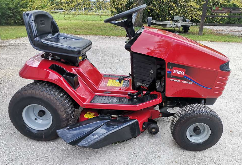

Rustyred 63 #1 Posted July 25, 2022 I rebuilt a C-81 - great tractor - but I've moved to Austria. I can't find another old Wheel Horse! What I have found is a used Toro Wheel Horse 16-38HXL. Should I buy it?? Please any help with this decision is needed. The price is 1290.00 but I could likely get it down a little. The machine does not have an hour meter. Model: 28Q777. Type: 0690-E1. Code: 010301ZE. The tractor has been repainted from what I see. Picture attached. Who has opinion? Thanks!!! Share this post Link to post Share on other sites
953 nut 67,374 #2 Posted July 25, 2022 33 minutes ago, Rustyred said: Should I buy it?? That is a silly question to ask this group, we all love watching other people spend money! Your selection of Wheel Horses in Austria will be rather limited so if your plans are to mow and tow with it then this looks like a good candidate for the job. 5 Share this post Link to post Share on other sites
sjoemie himself 3,117 #3 Posted July 25, 2022 @Rustyred depends on what you want/need I guess? Like @953 nut said, if you want to mow and tow (a bit) this is probably just fine. Don't hate me for this but if you want a more serious tractor to plow and do other 'ground engaging' work with, i'm sure you can find a Gutbrod, Agria or Maybe even a Kubota for around €1500 - €2000,- 6 Share this post Link to post Share on other sites
lynnmor 8,896 #4 Posted July 25, 2022 In my opinion, that is just a basic light duty lawn mower and I would compare it to other low priced mowers available there to arrive at a fair price. 7 Share this post Link to post Share on other sites
Rustyred 63 #5 Posted July 25, 2022 Sooo... The fact that it is a wheel horse (Toro) doesn't mean much? sorry to say? 1 Share this post Link to post Share on other sites
Mike'sHorseBarn 3,594 #6 Posted July 25, 2022 8 minutes ago, Rustyred said: Sooo... The fact that it is a wheel horse (Toro) doesn't mean much? sorry to say? No that tractor is pretty much a run of the mill box store lawnmower. Which is fine if all you want to do is mow the lawn. 4 hours ago, sjoemie himself said: i'm sure you can find a Gutbrod, Agria or Maybe even a Kubota for around €1500 - €2000,- I had to google gutbrod and agria.......my silly american brain didn't know what those were! After looking at pics of both I think you'd be good with either, they look cool! I like the articulating agria, are they all diesel? 1 Share this post Link to post Share on other sites

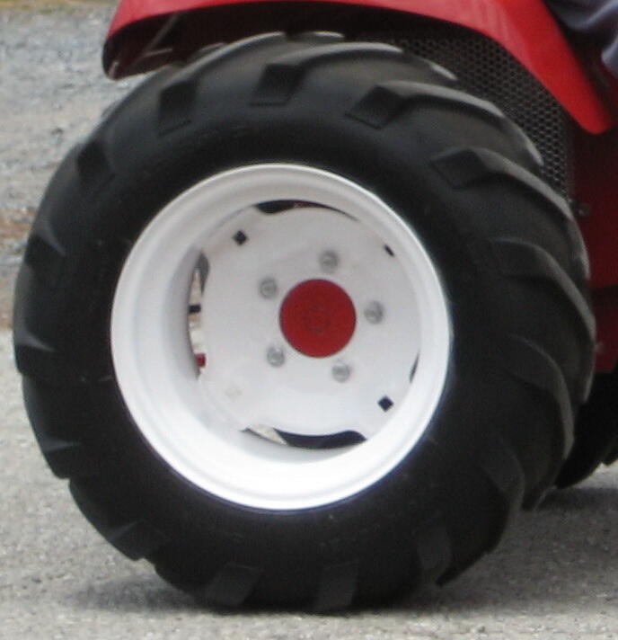

rmaynard 17,420 #10 Posted May 24, 2023 My opinion only - look at the rear wheels. Lawn tractor Garden tractor If you had a C-81, you won't be happy with anything less. 2 Share this post Link to post Share on other sites
