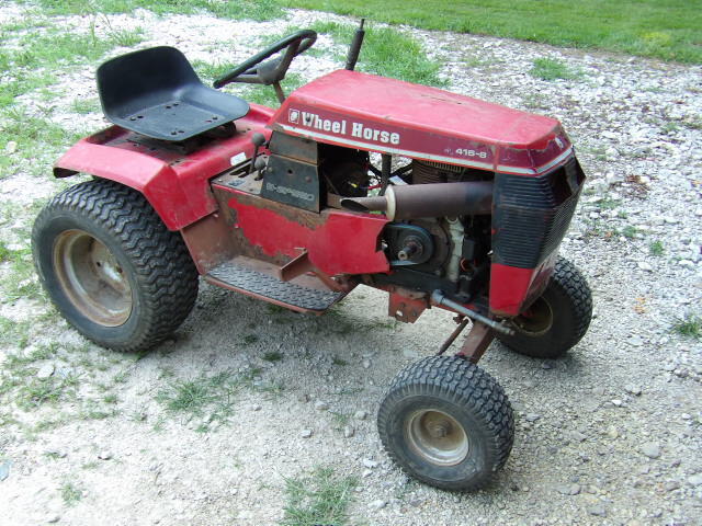

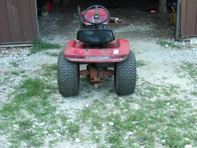

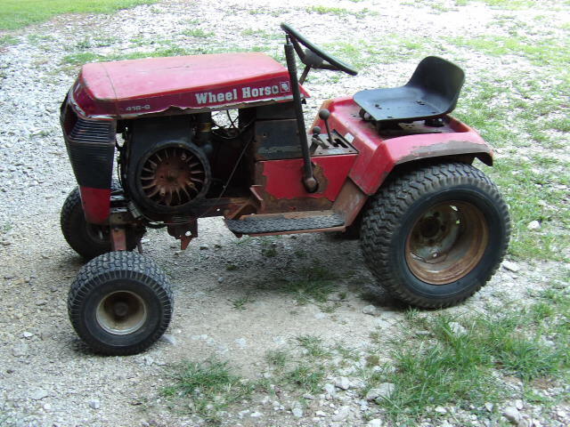

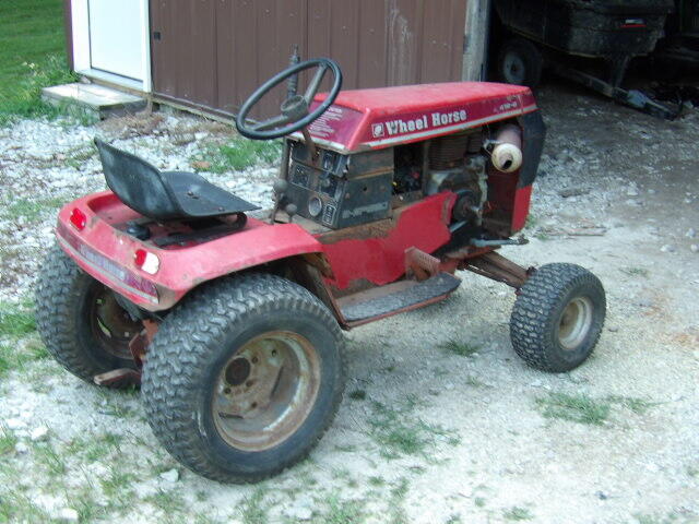

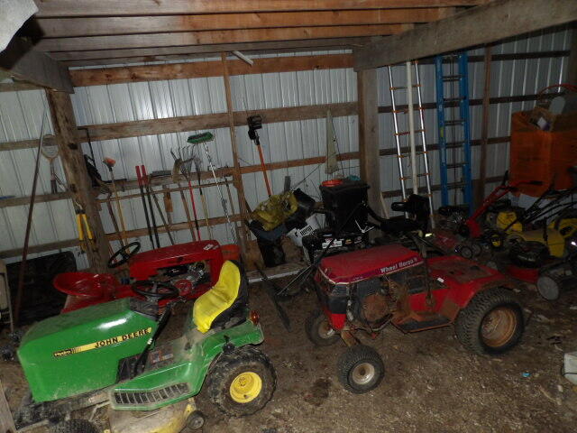

Snoopy11 5,731 #1 Posted July 9, 2022 I am starting this thread now... but things will get more interesting in Fall when I decide what kind of modifications are in order... I picked this 416-8 up from @davem1111 today... this was one of the 200$ tractors that he picked up a couple of months ago. Can't express how grateful I am to Dave. Thus far... I got the engine running which included cleaning out the flywheel which had an ENORMOUS amount of ground up leaves in it. I changed the oil, corrected wiring issues. Now, I have a running engine. I have to pop and drain the transmission fluid, among many other tasks coming up in the next couple of months. I will say, without actually doing anything to the transmission, I can tell it is very smooth and goes in each gear nicely. The shifter boot materials are toast... so I'll need to buy things like that later on. Painting will also be in order at some point. The hood is going to need some repair... nothing that I haven't faced in the past... I haven't decided which seat I am going to use... as I have 2. Hopefully those in the green don't argue too much with the horses... (the zero turn is hiding in the corner from the Horses)... I might very well either switch the wheels that are on the 800 special with the ones on the 416-8... or I may just end up buying AG tires for the 416-8 in the Fall... This one is going to be pretty sweet, Ladies and Gentlemen. Don 3 7 Share this post Link to post Share on other sites
peter lena 10,103 #2 Posted July 9, 2022 @Snoopy11 looks like a good project , as you know get a thorough baseline service and verify all your functions , paint and finish comes next , looks like that hood could be too squashed to save . after you gat some time on it , like first oil change time , might try some rislone zink , with the rotella . engines run much easier and smoother with that , oil changes are also like a coal oil flush . good luck with it pete 2 1 Share this post Link to post Share on other sites
8ntruck 9,368 #3 Posted July 10, 2022 Looks like it has possibilities. Most of the damage to the hood looks like folding around the headlight openings. Straighten those kinks out, and you should be real close to done. 2 1 Share this post Link to post Share on other sites

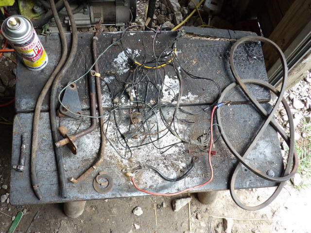

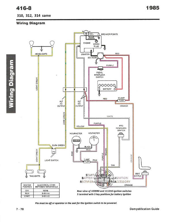

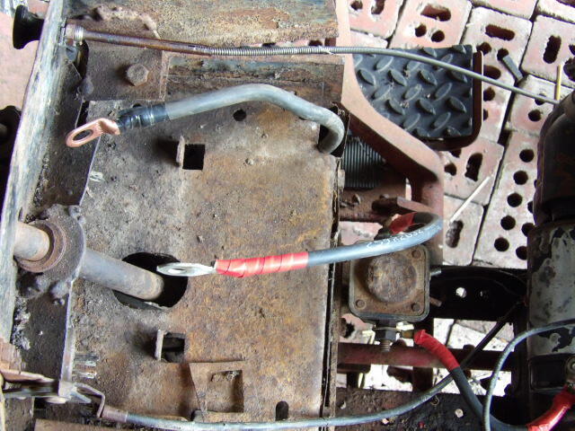

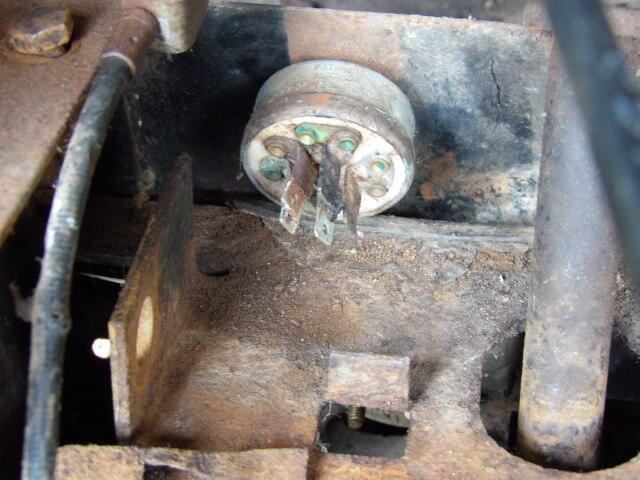

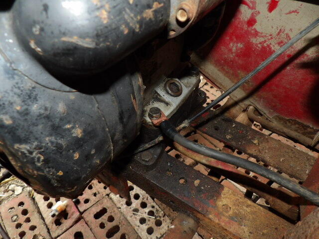

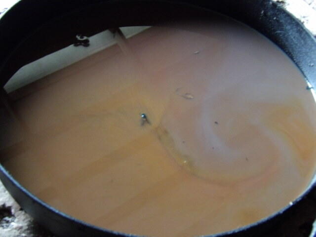

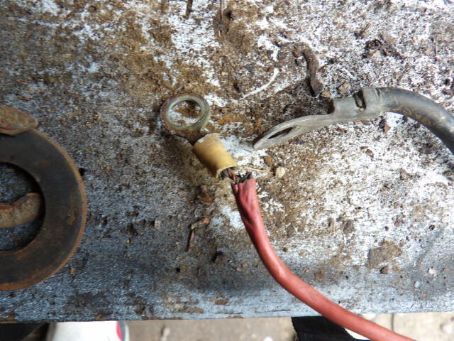

Snoopy11 5,731 #12 Posted July 11, 2022 Progress and electrical questions... Things that are going bye-bye... YIKES!!! I have no clue how to wire this switch, or even how to test it to see if it works... Brand new custom made wires... you guys please check out these pictures and tell me if everything looks right! Ground to engine block: What the hell is this wire??? Transmission fluid got changed today... little bit of rust... but no metal materials although... there is a little bit of "other" gunk in it as you can see (I flushed it out very well)... Now... I haven't looked at the wiring manual yet for the switch OR for the ignition coil. BUT... do you guys know anything about the key switch... particularly for testing purposes... as well as what wires go on the ignition coil terminals? Power goes to one to trigger... but I'm not entirely sure how to wire it... My goal here is to eliminate safety switches, as I don't have PTO or a mowing deck... so I plan for it to be like my other Wheel Horse tractors. I'm going to look at wiring diagrams, but I'd also appreciate any advice you guys can give! Oh, and I got my throttle and choke cables working @peter lena ...nicely lubed-up! Don 6 Share this post Link to post Share on other sites

ebinmaine 81,046 #14 Posted July 12, 2022 The diagram you found should give you the ability to test the ignition switch with a DVOM. 1 1 Share this post Link to post Share on other sites
Snoopy11 5,731 #15 Posted July 12, 2022 7 hours ago, ebinmaine said: The diagram you found should give you the ability to test the ignition switch with a DVOM. Yes sir. What I actually ended up doing was popping the hood on the Ranger... and running a positive wire from the truck battery to the switch... then I just put the negative pin from the multimeter on the battery ground... and starting manipulating the switch in different positions. Worked sweet... and proved that the switch is fully operational! Don 1 Share this post Link to post Share on other sites
peter lena 10,103 #16 Posted July 12, 2022 @Snoopy11 looks like you are fully involved ,don't forget to add another , battery cable off that battery ground bolt point , to the corner of your engine / chassis , clutch pedal side , for enhanced rectifier ground and on to headlights , WHOOPS JUST SAW YOUR ENGINE CABLE HOOK UP , glad for you , keep it sparky , pete 1 1 Share this post Link to post Share on other sites

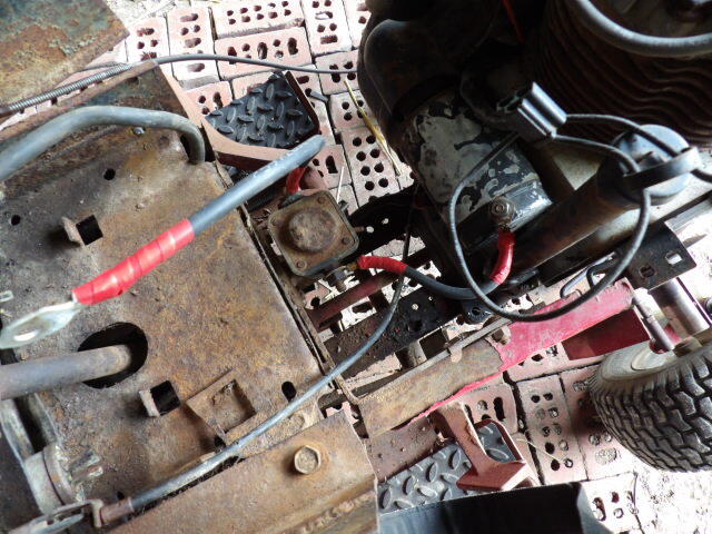

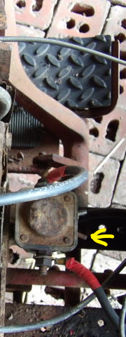

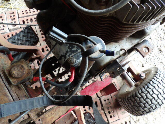

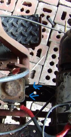

Snoopy11 5,731 #18 Posted July 14, 2022 So... yesterday... I picked up some more new fuel line... fittings for the fuel tank... and other gadgets I thought I needed. I already had the motor back on the tractor, and had everything wired in... so I thought I might as well try to get it running before I have to change the motor mounts on the Ranger this weekend. WELL... I ran into a few issues. I present exhibit "A" Exhibit "B" So... first of all. The passenger side terminal on the front of the starter solenoid DOES NOT go to ground in my rewire. @gwest_ca... you might want to take a look at this. So... in my rewire... I grounded this terminal... and it created some nice white smoke when I tried to start the tractor. Turns out... that terminal gets 12 volts when I go to start the tractor. I took the ground OFF that terminal on the starter solenoid and the tractor starts and stops just fine... so... in my case... that terminal was not used at all. Secondly... after putting the fuel line on and filling up the tractor with fuel... I tested the fuel pump. Works excellently. I did clean the carb early in the engine rebuild... so I didn't think there would be any issues. I was wrong... the float was stuck in the closed position. SO... a little bit of PB blaster, and the float is working excellently. I decided to hit the key. Spray of carb cleaner into the intake... crank crank crank... it fired up... just ran like hell. SO... I adjusted the carb... still ran like hell. I shut it down... and thought... hmm... must be fueling. I retested the fuel pump... NOPE... that works great. Pulled the carb, recleaned it... everything looked sweet. I pulled the spark plug to see if there was spark... THEN I noticed the problem. I noticed that the ground electrode on the spark plug was pushed against the center electrode. Hmm... I know I bought the right plug. I pulled out another spark plug from the stock drawer and I noticed 1 difference... the first plug did not have a gasket! It was missing in action. SO... I put a plug in that actually had a gasket... and BOOM SHACKA LACKA! It purrrrrrs.... no issues. So... now it is just getting the right belt... a battery... and getting everything back together... Don 3 Share this post Link to post Share on other sites
