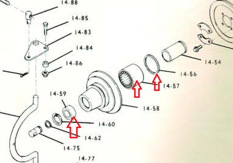

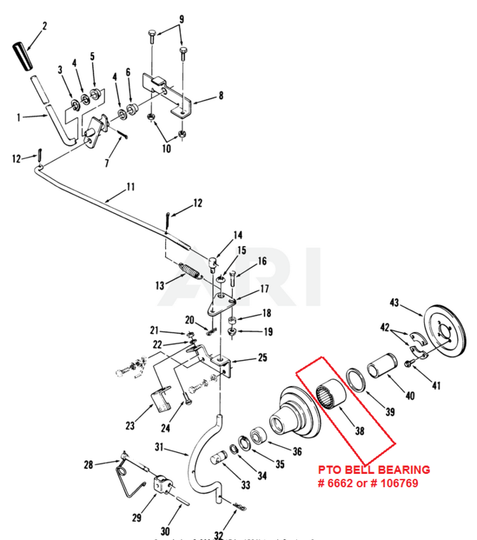

Mike C160 251 #1 Posted July 3, 2022 Does anyone have standard bearing and seal numbers for these WH Part #? They are, 5196 ball bearing 6662 needle bearing 6663 seal. This would really help if i could order these locally. Many thanks in advance! Cheers Share this post Link to post Share on other sites

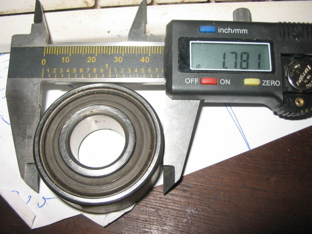

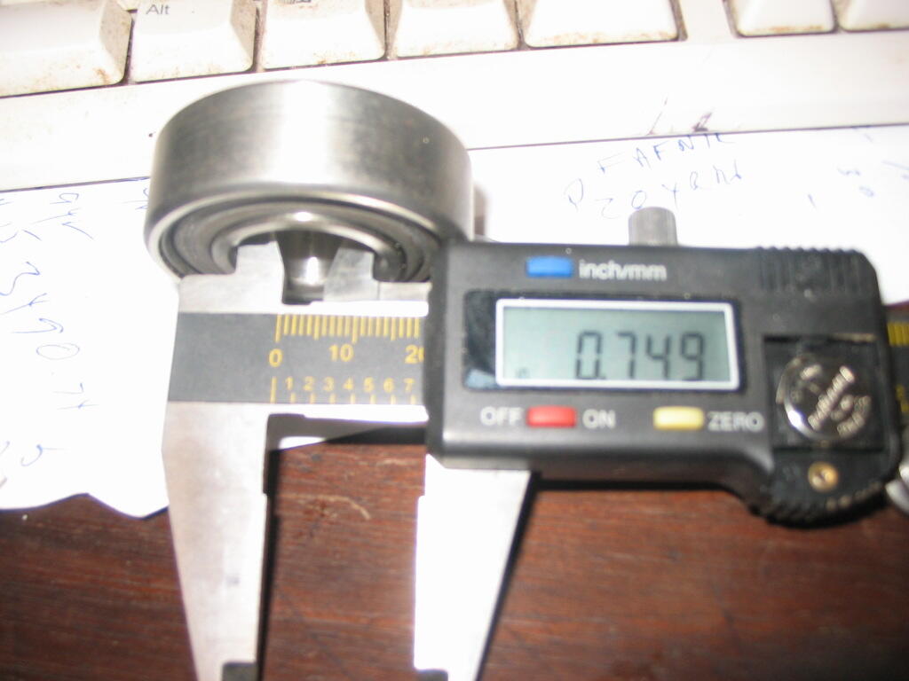

Jeff-C175 7,211 #3 Posted July 3, 2022 (edited) 2 hours ago, Mike C160 said: standard bearing and seal numbers The needle roller is a Torrington J-2420. I've got several numbers written on my hard copy part manual, presumably supercessions. Not sure if they are all Toro/WH numbers or not... some might be STENS numbers. 106947, 109842, 0.75" x 1.7805" x 0.61" 251-351 <-- Stens I think? 31-0530 <-- Toro superceded # ? 932559 <-- another WH/Toro # Nothing here on the seal. https://www.amazon.com/Wheel-Horse-Spindle-Bearing-106947/dp/B073FYDMWD https://thebigbearingstore.com/z9504rst-p204rr6-204bbar-special-ag-bearing/ Edited July 3, 2022 by Jeff-C175 Share this post Link to post Share on other sites
squonk 48,322 #4 Posted July 3, 2022 Outer bearing is a Napa PP204RR6 Share this post Link to post Share on other sites
Goldnboy 1,156 #5 Posted July 3, 2022 Available on Lowell's site Share this post Link to post Share on other sites

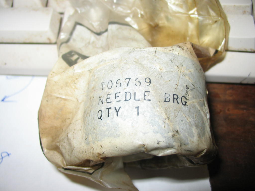

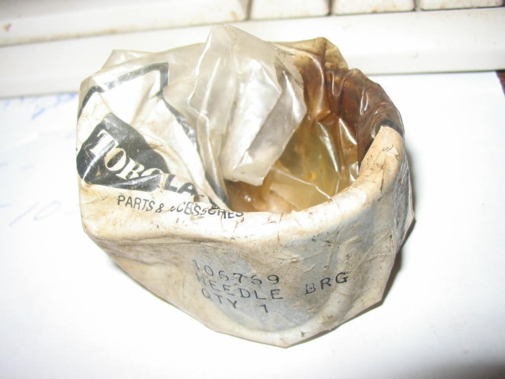

daveoman1966 3,884 #6 Posted July 3, 2022 (edited) I have that needle bearing #6662 ...(Superceded by part# 106769) on eBay now for $38...NEW... FREE SHIP EbAY ITEM # IS: 134133142339 I may also have the OUTER BEARING... will check my shop. ---NOPE---I don't have the outer bearing Edited July 3, 2022 by daveoman1966 Share this post Link to post Share on other sites

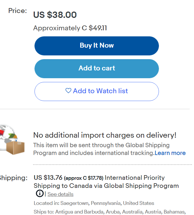

Mike C160 251 #7 Posted July 3, 2022 @daveoman1966 Thanks Just looked at the auction Im in Canada. So shipping isnt free according to your auction. it would be well over 60 bucks Canadian for me. Share this post Link to post Share on other sites
daveoman1966 3,884 #8 Posted July 3, 2022 (edited) 21 minutes ago, Mike C160 said: @daveoman1966 Thanks Just looked at the auction Im in Canada. So shipping isnt free according to your auction. it would be well over 60 bucks Canadian for me. When I posted FREE SHIPPING... that means the I am not charging you a ship cost....but eBay does in its Global program. I, of course, have no idea what eBay may charge you for the INTERNATIONAL fees... MAYBE I can ship this direct to you via USPS...outside of the eBay Global program.. What is your EXACT and full name and ship address in CANADA....so I can find a cheaper rate...maybe. Edited July 3, 2022 by daveoman1966 Share this post Link to post Share on other sites

Mike C160 251 #10 Posted July 3, 2022 Oh, in case anyone wants to know. The seal is a CR seal. CR14810 Is common seal. Cheers 1 1 Share this post Link to post Share on other sites

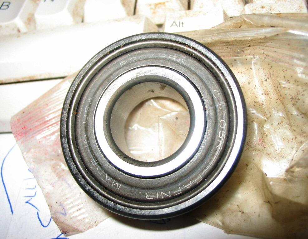

daveoman1966 3,884 #11 Posted July 5, 2022 As it turns out, I do, in fact, have the OUTER BEARING.. NEW, sealed wrapper ((had to open wrapper to see the micro-numbers). It is marked ; FAFNIR P204 RR6 MADE IN USA. Share this post Link to post Share on other sites
