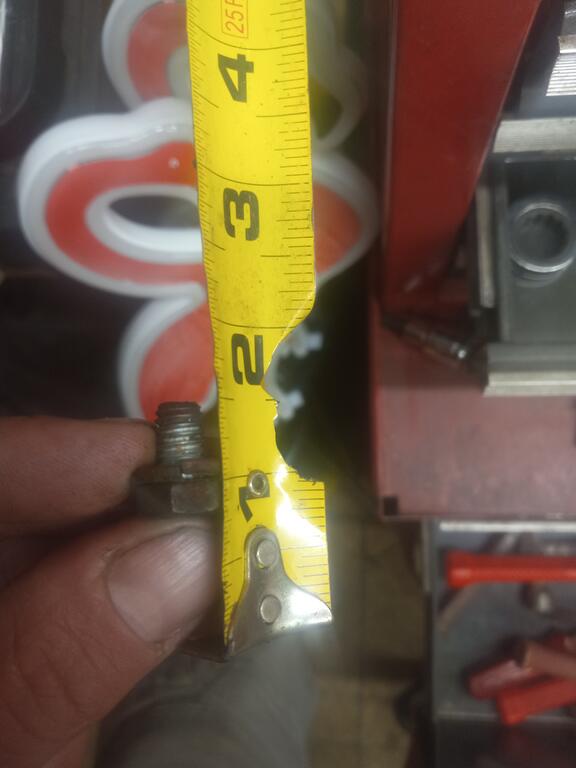

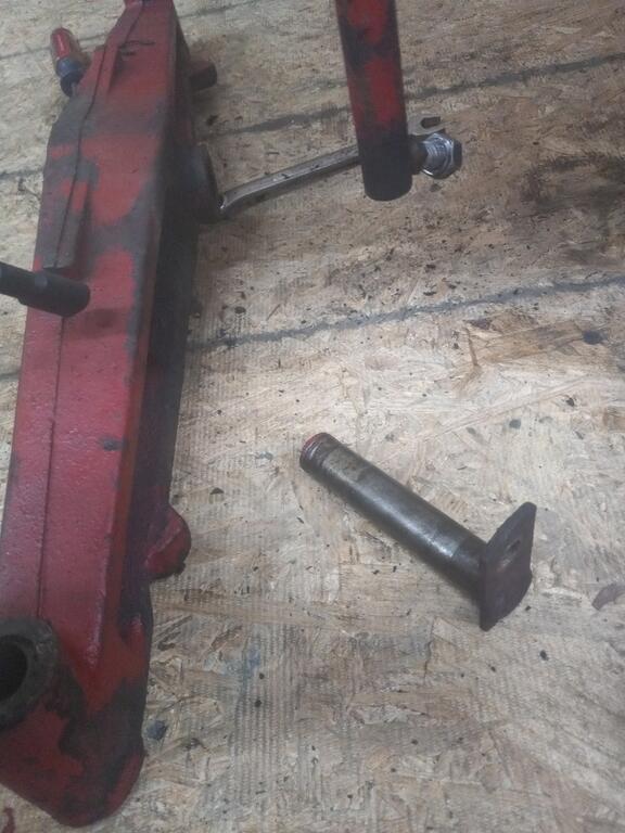

Wheelhorse#1 1,996 #1 Posted July 3, 2022 (edited) Anyone know what the hole is for on that tab? Looks like a bolt or some kind of fastener is missing on the front axle pivot pin but didn’t notice a corresponding hole. I pulled the mule drive to work on it when I noticed .The steering is a bit sloppy and thought this may have something to do with that as well as needing tie rods .thx all Edited July 3, 2022 by Wheelhorse#1 Share this post Link to post Share on other sites
Pullstart 71,215 #2 Posted July 3, 2022 A 5/16” bolt should hold that tab to the frame. 5 Share this post Link to post Share on other sites
Cee245 861 #3 Posted July 3, 2022 (edited) Yes, It holds the tab to the frame which is also connected to the pin that the axle goes on. It is 1 part. I'm dealing with the same on my C160. My pin is worn and the steering is sloppy in many other places too. I decided to start with this first. Maybe we can replace the pivot pin? I'll check if their available and if toro makes them out of gold or not... $$$ Edited July 3, 2022 by Cee245 Add pic 2 Share this post Link to post Share on other sites
Wheelhorse#1 1,996 #4 Posted July 3, 2022 29 minutes ago, Pullstart said: A 5/16” bolt should hold that tab to the frame. Thanks.I didn’t notice a hole on the other side.I’ll get in there and take a better look tomorrow.That would definitely allow the pin bounce around a bit without that bolt, Just a C-clip on the other end . thx 1 Share this post Link to post Share on other sites
Wheelhorse#1 1,996 #5 Posted July 3, 2022 (edited) 10 minutes ago, Cee245 said: Yes, It holds the tab to the frame which is also connected to the pin that the axle goes on. It is 1 part. I'm dealing with the same on my C160. My pin is worn and the steering is sloppy in many other places too. I decided to start with this first. Maybe we can replace the pivot pin? I'll check if their available and if toro makes them out of gold or not... $$$ Lol I dont believe they are available but not sure.I have read here of folks making a bushing to take up the play. Maybe Check Fleabay,might get lucky and find NOS dirt cheap🤣 thx Edited July 3, 2022 by Wheelhorse#1 Share this post Link to post Share on other sites

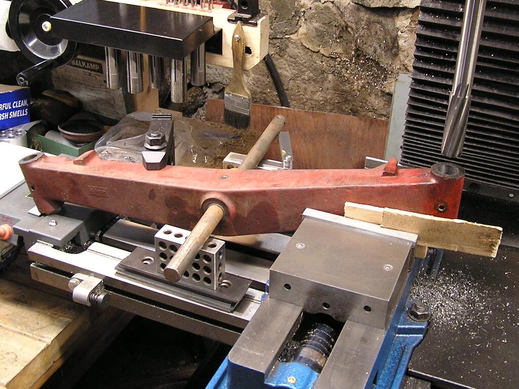

Cee245 861 #7 Posted July 3, 2022 (edited) As @Pullstartsays 5/16, and threads are short, 1/2 in length... as shown in Pic. Good timing.... I just got done tearing into my front end tonight and seen your post. Which model are you going to work on @Wheelhorse#1? 2nd Pic is of my tear down tonight. I've got a lot of greasing linkages and need some other stuff... not a bad way to spend a Saturday ,night in my book! Lol Edited July 3, 2022 by Cee245 Switched pics 1 3 Share this post Link to post Share on other sites

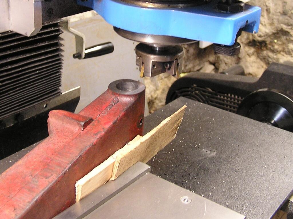

ri702bill 12,987 #8 Posted July 3, 2022 8 hours ago, Cee245 said: That's not so bad, but it doesn't mean the axle isn't worn. So a new pin would be futile. I see a new axle is about 300 so that's not realistic for me. Edited 8 hours ago by Cee245 That axle is repairable - I have opened up both the pivot and spindles bore for press in bronze bushings. I also machine the lower bosses down to add in a thrust washer, and at the same time compensate for thrust face wear. I've done several with no issues. Lowell at Wheelhorse Parts and more sells the repdoduction axle pivot pins. 3 2 1 Share this post Link to post Share on other sites

wallfish 20,576 #11 Posted July 3, 2022 If that tab is not holding the pin in place it will swivel with the axle (larger surface area contact) and wear the pin and the frame holes at the thin surface area contact points front and back. Look at those frame holes for the pin to check if they are wobbled out. If so they can be bushed too. All of the axle holes (pivot and spindles plus the frame holes) can be enlarged from 3/4 to 7/8 and bushed with bronze bushings to make them a nice tighter tolerance again. I don't have access to the precise machinery like 702bill has so I have done them by hand with a 7/8 construction reamer. and a cordless drill. The reamer will not pass all the way through the holes on the axle from a single side. (unless you grind the stop ring off and use an extension) So from experience I found it's best to start one side only drilling the wide part of the reamer into the hole about 1 1/2" or so and don't bury it from the first side of drilling, then drill from the other side until it sinks all the way through. This will better line up the holes. The reamer will ALMOST self align but it's important to align the drill with the hole as straight as possible as you drill. Look inside of that spindle hole and you will see that there's a larger gap in the center than at the ends for holding grease. If you use long bushings be sure to consider the grease fitting. Shorter bushings for each end are easier to find and still leave that grease gap to mimic the original design. After tapping in the bushings, you may need to file or sand the insides of the bushings because of the "squeeze" into those axle holes makes that 3/4 ID a little smaller. You want those bushings tight in the axle so they don't spin, just the pins spin in the bushings. If you have a bunch of axles to do then it's a big time saver to modify the reamer with an extension for drilling them with one pass from a single side. 5 2 Share this post Link to post Share on other sites

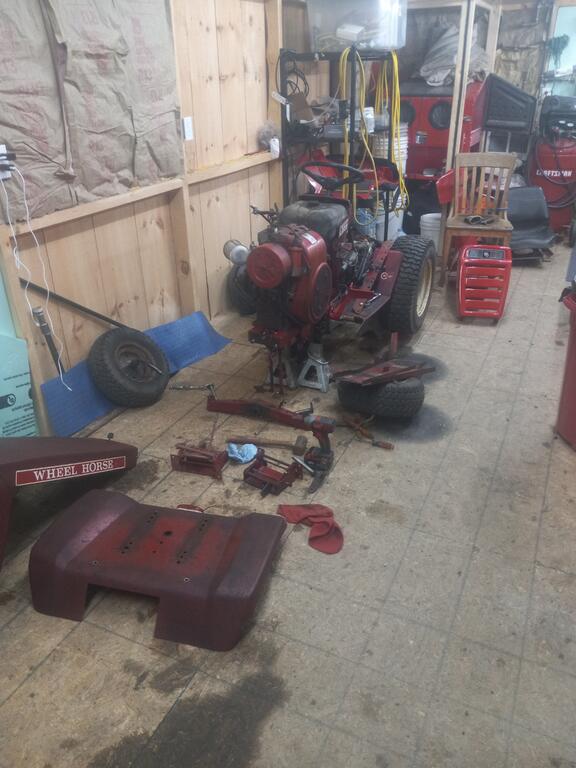

Wheelhorse#1 1,996 #12 Posted July 3, 2022 (edited) 11 hours ago, Cee245 said: @Wheelhorse#1 6216 is the part #. It's about $40.00 That's not so bad, but it doesn't mean the axle isn't worn. So a new pin would be futile. I see a new axle is about 300 so that's not realistic for me. Cee245 I’m working on a 73 12 automatic. Straighten out the mule drive,it was bent also replaced the adjust knob.I think the PO must of ran into a tree or something. Thanks for the part number.Im thinking of going ahead and replace it wile Im there. Im sure the axle is worn some,but I can live with a bit of play,doesn’t really seem too bad.I also need to replace the tie rods for the steering…their shot. Not perfect but better then it was. Edited July 3, 2022 by Wheelhorse#1 2 Share this post Link to post Share on other sites
peter lena 10,047 #13 Posted July 3, 2022 @Wheelhorse#1 , that axel pin set up n needs a bolt for holding it in place , as stated , use a grease that will stay with it , since using the lucas h/d chassis grease , in hi wear areas , the issues stopped . also when you grease the front end , raise it up so grease easily fills all the voids , when building a front axel set up , you can feel the solid smooth ease , that this grease has , most important is that it stays there , went after every trouble / failure area , with this , no noisy bearings , no failures , read the specs . just my experience , keep it greasy , pete 3 Share this post Link to post Share on other sites
Wheelhorse#1 1,996 #14 Posted July 3, 2022 (edited) Pete You are right.Maint.Is key to keeping these machines going with out too much trouble. I also found a broken off Grease Zerk,can’t have that! She’s screaming for some Lucas extra sticky HD right about now.Replaced and ready for some lube ! Edited July 3, 2022 by Wheelhorse#1 1 2 Share this post Link to post Share on other sites
Wheelhorse#1 1,996 #15 Posted July 3, 2022 1 hour ago, wallfish said: If that tab is not holding the pin in place it will swivel with the axle (larger surface area contact) and wear the pin and the frame holes at the thin surface area contact points front and back. Look at those frame holes for the pin to check if they are wobbled out. If so they can be bushed too. All of the axle holes (pivot and spindles plus the frame holes) can be enlarged from 3/4 to 7/8 and bushed with bronze bushings to make them a nice tighter tolerance again. I don't have access to the precise machinery like 702bill has so I have done them by hand with a 7/8 construction reamer. and a cordless drill. The reamer will not pass all the way through the holes on the axle from a single side. (unless you grind the stop ring off and use an extension) So from experience I found it's best to start one side only drilling the wide part of the reamer into the hole about 1 1/2" or so and don't bury it from the first side of drilling, then drill from the other side until it sinks all the way through. This will better line up the holes. The reamer will ALMOST self align but it's important to align the drill with the hole as straight as possible as you drill. Look inside of that spindle hole and you will see that there's a larger gap in the center than at the ends for holding grease. If you use long bushings be sure to consider the grease fitting. Shorter bushings for each end are easier to find and still leave that grease gap to mimic the original design. After tapping in the bushings, you may need to file or sand the insides of the bushings because of the "squeeze" into those axle holes makes that 3/4 ID a little smaller. You want those bushings tight in the axle so they don't spin, just the pins spin in the bushings. If you have a bunch of axles to do then it's a big time saver to modify the reamer with an extension for drilling them with one pass from a single side. Wall…Thanks for the know how.I don’t have a machine shop either so this method will work for me. I was wondering where do you get your Bronze bushings.Mc Master ? thx 1 Share this post Link to post Share on other sites
wallfish 20,576 #16 Posted July 3, 2022 (edited) 25 minutes ago, Wheelhorse#1 said: Wall…Thanks for the know how.I don’t have a machine shop either so this method will work for me. I was wondering where do you get your Bronze bushings.Mc Master ? thx Many places, Local hardware stores too. Just search 3/4 ID x 7/8 OD bronze bushings. You don't want flanged bushings just sleeve bushings. Longer bushings or many different lengths and sizes can be found here at ASB bearing. 2 1/2" is the longest for 3/4x7/8. Different size reamers and you can bush everything that moves and be a bushwacker! LoL https://asbbearings.com/pages/cast-bronze-inch-sleeves Wish I had some of the machinery but more importantly the know how and skill to do more precise stuff like Bill and the many other machinest on here! Their trade means precise and accurate tooling with the abilities and skills to know how to use them. But again, these little tractors aren't the space shuttle and only moving at 5-10 mph leaves some wiggle room for some less exact fixes. Is it better to be precise? ABSOLUTELY! Can we get away with some of the backyard fixes? ABSOLUTELY Edited July 3, 2022 by wallfish 3 5 Share this post Link to post Share on other sites

Wheelhorse#1 1,996 #21 Posted July 3, 2022 (edited) Wallfish you are right.Because The bolt was not installed or fell out it cause the plate to Waller out on the inside ,the axle boar was slightly worn too at the top as well.Not terribly bad I guess? I had a one inch bolt and installed it to to see how bad it was worn. Then wear was at the top on both, bottom pic the axle was upside down.You can see the slight wear. Edited July 3, 2022 by Wheelhorse#1 Share this post Link to post Share on other sites

wallfish 20,576 #23 Posted July 3, 2022 Just gonna throw this out there in this thread too for another backyard hammer mechanic fix. I bought one of these tools in order to true up the spindle arm surfaces to the spindle and remove material from the axles to fit trust bearings. I needed to make an attachment for it to be used in a drill but it works pretty good. Again, not an exact precise way to do it but it is a way to do it without expensive machines or paying someone else to do it. https://www.msdiscounttool.com/catalog/product_info.php?cPath=4255&products_id=112529 The 3/4 pin of the spindle keeps it true for doing the steering arm surfaces and then I used a piece of 3/4 rod for doing the axle surfaces. They do turn nice a smooth with those thrust washers in there. 1 3 Share this post Link to post Share on other sites
