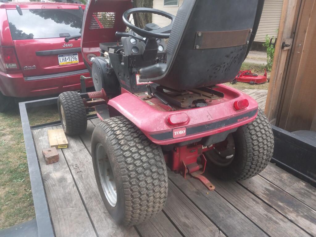

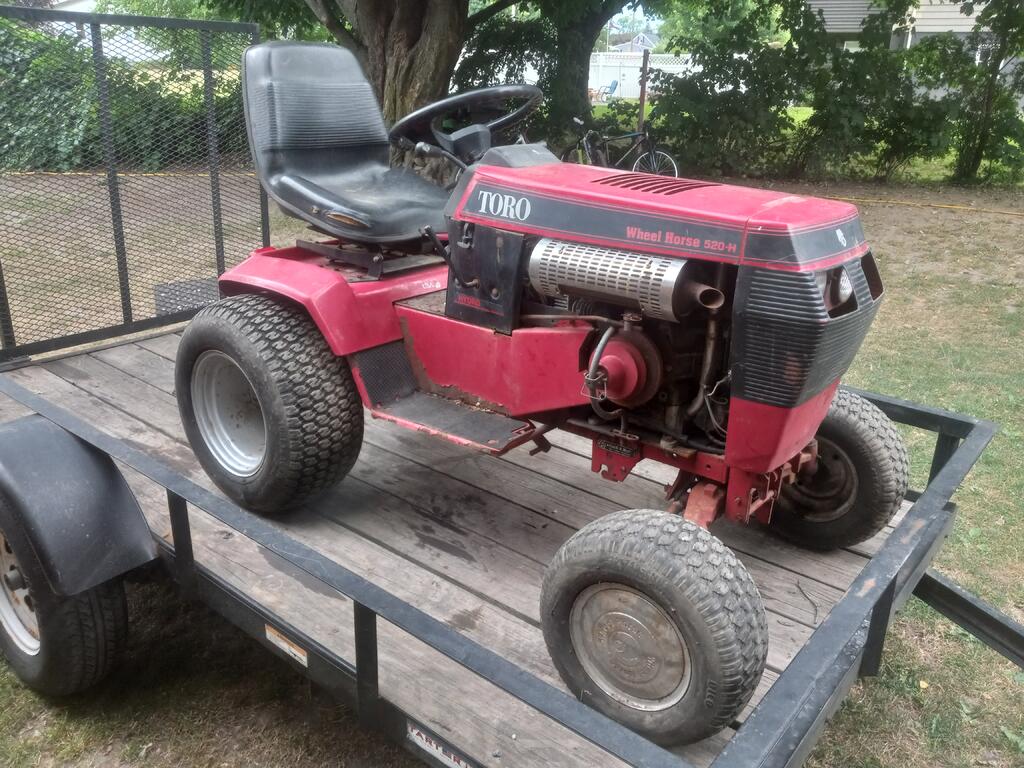

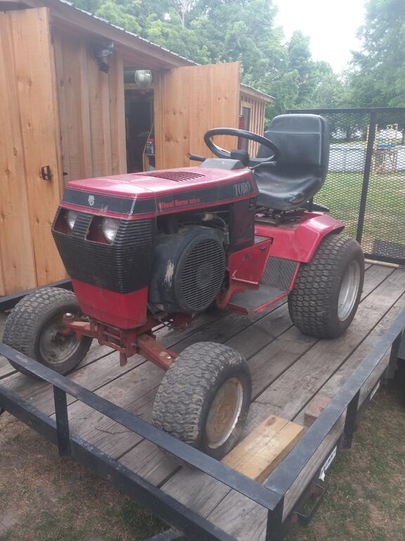

Cee245 861 #1 Posted July 1, 2022 Stumbled upon this 520H on Marketplace the other day. It was cheap, so I picked it up. It does not run and looks like it sat for some time with the missing air cleaner off. I'll attempt to start it in the coming months and see if I can save it. If the motor is junk, then I'll take the steering and put it on something else and part the rest. Model # shows 4120OE02 and serial #1031551. Anyone know the year for sure? I did a quick search and couldn't find the year. This appears to have the gear reduction steering from what I can see along with the swept axle. . I'm guessing 1991-1992 from memory of how the model numbering works. I know of the common issues with these, but I've never had a 520 before so I don't know much about them except for things that are the same as my 416H. Cory 5 Share this post Link to post Share on other sites

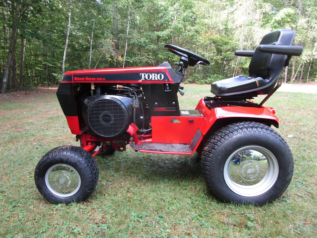

JCM 11,415 #4 Posted July 2, 2022 Gear reduction started in 1991. 1990 would be a E01 and 92 a E03. Lettering on the 93 was white, while the 90,1 and 2 was red. Pictured is a 91. 88 & 89 serial # started with a 31-. 2 Share this post Link to post Share on other sites

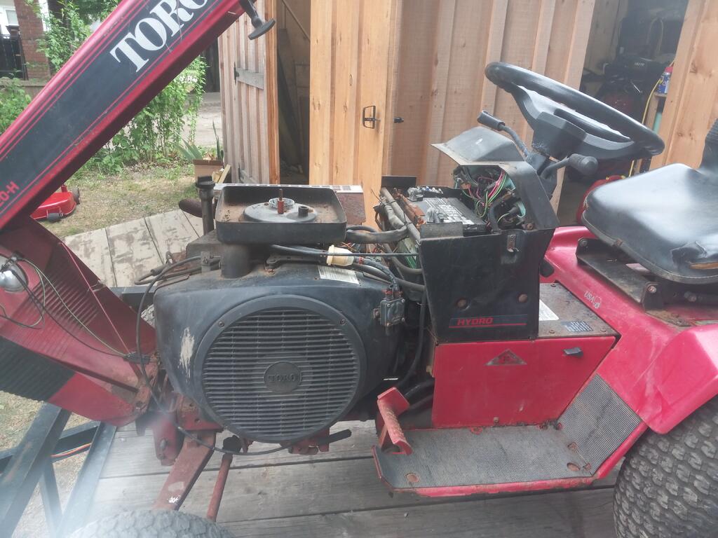

Cee245 861 #11 Posted August 29, 2022 Back on topic, I've looked into this 520 a little bit today. Unfortunately the previous owner left it outside without the air cleaner on... 😒 Drained oil and now have the muffler off. I should be able to bead blast it and have a spare if I decide to part this 520. I have compression in both cylinders, but I rotated the engine by hand clockwise a revolution or 2 and it wouldn't move beyond a certainpoint.... It moves counterclockwise freely and doesn't lock up. Meter says 681, but I have zero information on this thing. I can see electrical was repaired on 9 pin(decent job) I have no electric to the starter, so I'll go through and see if I can find chafing/broken wires etc. Goal is to get it turning over soon to see the compression number after I pop the engine tins off and clean it up a bit. Share this post Link to post Share on other sites
Howie 900 #12 Posted August 30, 2022 May have a stuck valve from water or moisture down the carb. 2 Share this post Link to post Share on other sites
kpinnc 18,940 #13 Posted August 30, 2022 (edited) 17 hours ago, Cee245 said: have compression in both cylinders, but I rotated the engine by hand clockwise a revolution or 2 and it wouldn't move beyond a certainpoint.... I suggest pulling the heads and cleaning the carbon. It's a 500 hour requirement anyway. My 518-H had the exact same symptoms- make two turns and stick. All four valves were free, but moisture had made it into the cylinders and rust accumulated. The rust must have combined with the carbon and made a crusty crud that kept the piston from making TDC. The cylinders were not damaged beyond repair, but there was some pitting as a result. Definitely don't try to run it without checking if the intake was exposed for a long period. Edited August 30, 2022 by kpinnc 1 Share this post Link to post Share on other sites
Cee245 861 #14 Posted August 30, 2022 @kpinnc, agreed. I only have muffler off so far. Both exhaust valves move and there is compression in each cylinder... the (Breather? Tube Goes from air cleaner base to a bulb looking thing) that's all nasty as well. When time permits(hopefully tonight I was going to pull engine tins etc and heads to see true internal condition. My first thought when seeing it was "man if they only put a plastic bag or something in there to block contamination " Not sure where to go from there. Just depends ...... I'll keep the steering components for a future project, but if I do make this a worker I'll need tons of help/reading on here about electrical issues. I have a smokey on start up nice now 75 C160, but I'm partial to the 80's-90's look although I'm not that good with electronics like on a 520. (Im not a complete moron. I can read and follow electrical directions/ diagrams well enough) I'd rather have a 416 either onan or kohler. Too many horror stories for me with gauges etc.... something would always be broke on it. I know I have a similar to 520 with my onan 416, but I used to have working gauges on mine until it wasn't worth it to me fixing a lot and took all associated wiring to gauges off. Will report back with findings! Share this post Link to post Share on other sites

Cee245 861 #17 Posted August 31, 2022 I pulled the front head off and the sight is pretty rough. Basically must've sat outside for years and years. The head had water in it. I'd say it's pretty much only worth scrap price now. Although there are many decent parts I can use or sell Share this post Link to post Share on other sites
