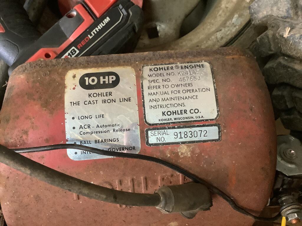

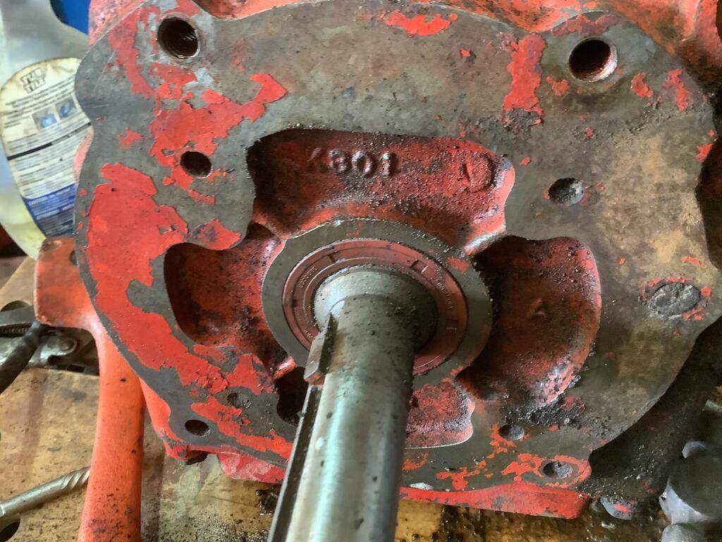

Pullstart 69,612 #1 Posted June 29, 2022 @richmondred01 @76c12091520h @gwest_ca I’m tagging you looking for knowledge, though I know many other people may know this answer too. I’m swapping engines that I believe both to be K241s. They both came from C-101’s (shaker plate) that I tore down. I needed to swap the drive pulley and see that both engine castings show K301. Are these indeed 12 hp with K241 shrouds or was there a casting mistake? The other engine has a missing tag on the shroud, but still shows K301 and definitely came from a C-101. 1 Share this post Link to post Share on other sites
richmondred01 2,359 #2 Posted June 29, 2022 This isn’t uncommon. Kohler didn’t stop the production line if they ran out of k241 blocks. They simply used the k301 block and bored it to the 10 hp spec. The only true way to know is to remove the head and measure your bore. K301 3.375 K241 3.251 5 3 1 Share this post Link to post Share on other sites
Pullstart 69,612 #3 Posted June 29, 2022 Thanks @richmondred01! This is not a performance oriented build, just a cruiser and light duty worker. I’ll let it remain a mystery for now! 3 Share this post Link to post Share on other sites
stevasaurus 23,662 #4 Posted June 29, 2022 @richmondred01 is absolutely correct. Measuring the bore is the only way to tell what you have. The K- 10, 12 & 14 hp blocks are the same block. 1 Share this post Link to post Share on other sites
Pullstart 69,612 #5 Posted June 29, 2022 I thought so, but figured I’d check 1 Share this post Link to post Share on other sites
