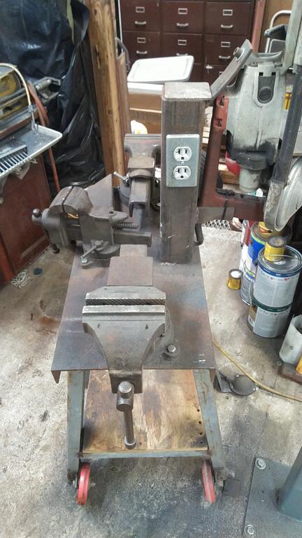

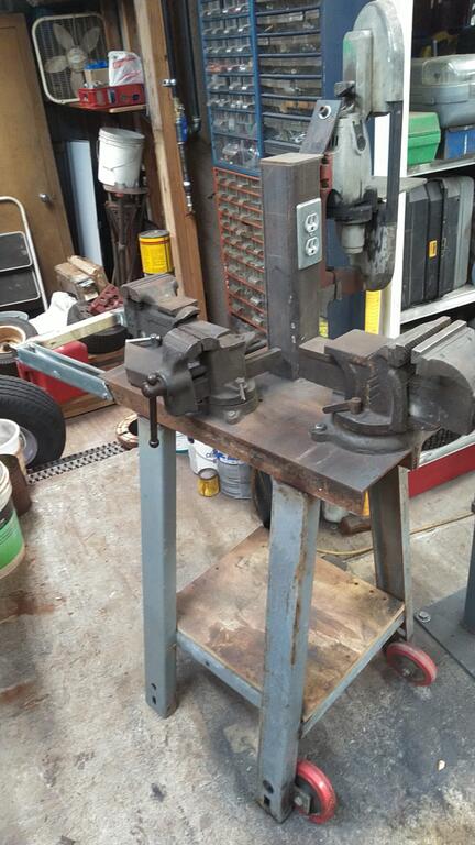

JPWH 6,544 #6 Posted June 10, 2022 I made a vise stand using 2 lengths of 6" channel iron. It has two wheels and a handle I can raise when needed to make moving easier. It also has my port-a-band mounted on the back side. 3 4 Share this post Link to post Share on other sites

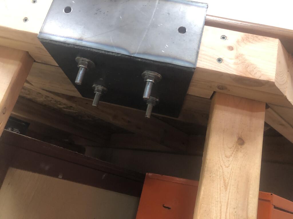

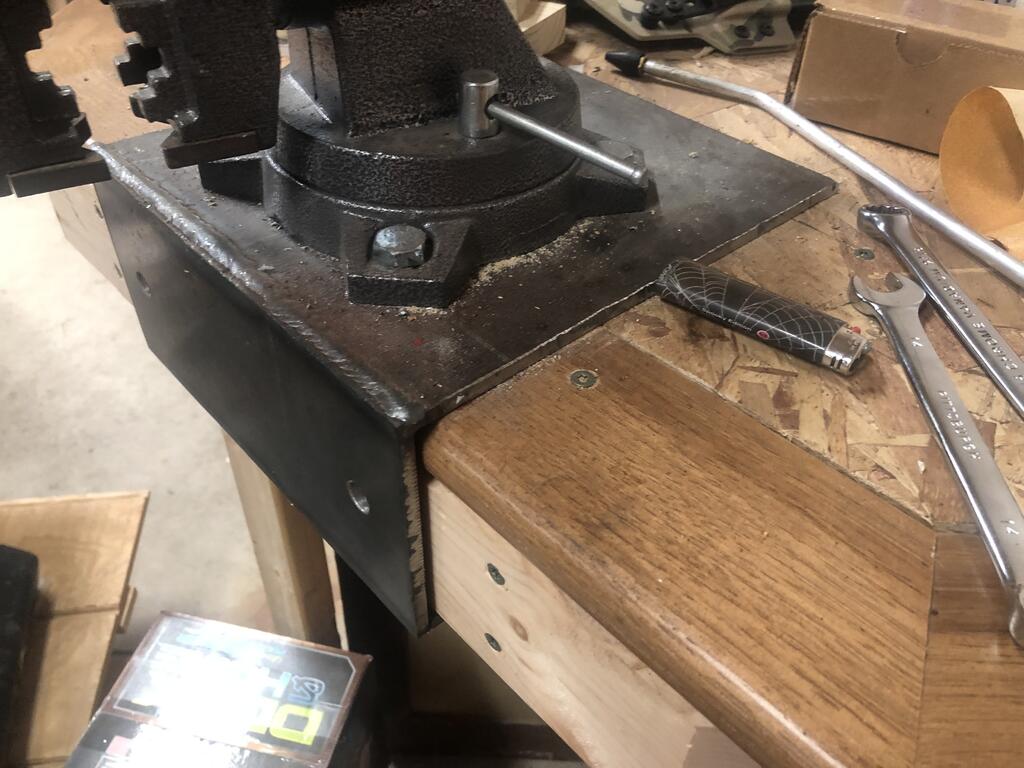

Rob J. 1,942 #9 Posted June 10, 2022 I made “sleeves” out of plate steel in the shape of a “u” and slide it in my bench and bolted the vise to the bench. I’ll send some pics later. Real simple and very stout. 2 Share this post Link to post Share on other sites
Rob J. 1,942 #10 Posted June 10, 2022 5 minutes ago, Rob J. said: I made “sleeves” out of plate steel in the shape of a “u” and slide it in my bench and bolted the vise to the bench. I’ll send some pics later. Real simple and very stout. 3 3 Share this post Link to post Share on other sites

pacer 3,180 #12 Posted June 10, 2022 @JPWH Wow! now THAT is quite a set-up!! THREE vises - moveable! I consider my vice to be very possibly THE most ... used? tool in my shop! I beat the CRAP out of it!! I lucked up some 30 years and while hunting and ran up on a falling down barn and was poking around in it and stumbled over a 5" solid mount Columbian bench vise ... in excellent condition!! - probable 50-60 yrs old. I had been using the swivel types and had developed a .... dislike for them, and had broke 2 of the cheap imports. So I quickly found the non-moveable Columbian a dream. I'm on my 3rd set of jaws for it, When I have beat them to death, I make up another set..... Gotta LOVE a vice --- A good one, not one of those cheap/breakable imports pieces of crap! 6 Share this post Link to post Share on other sites

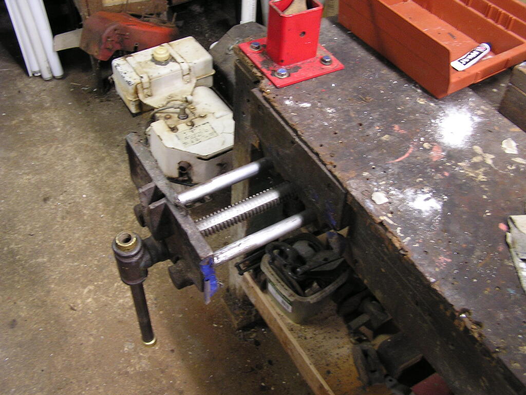

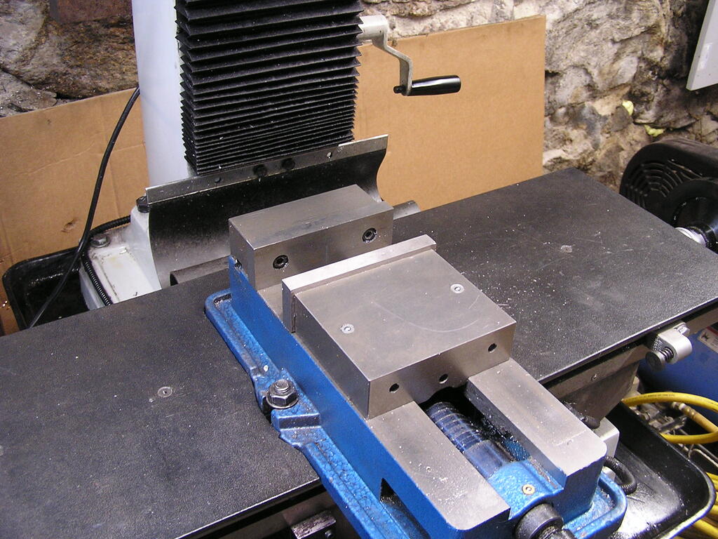

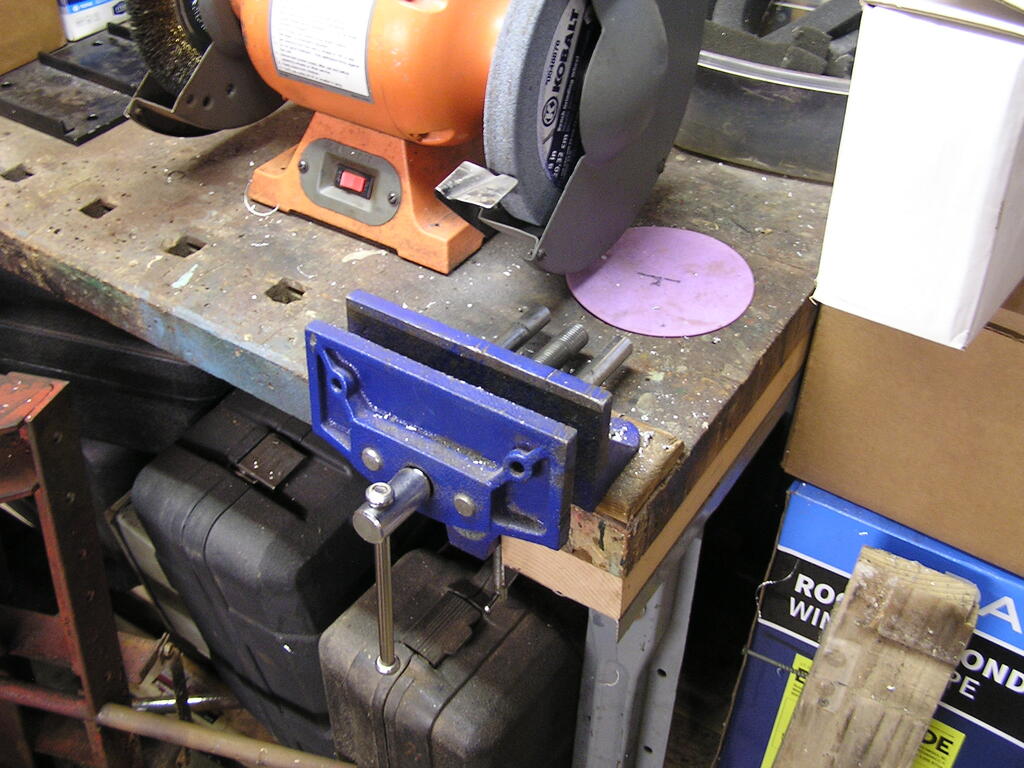

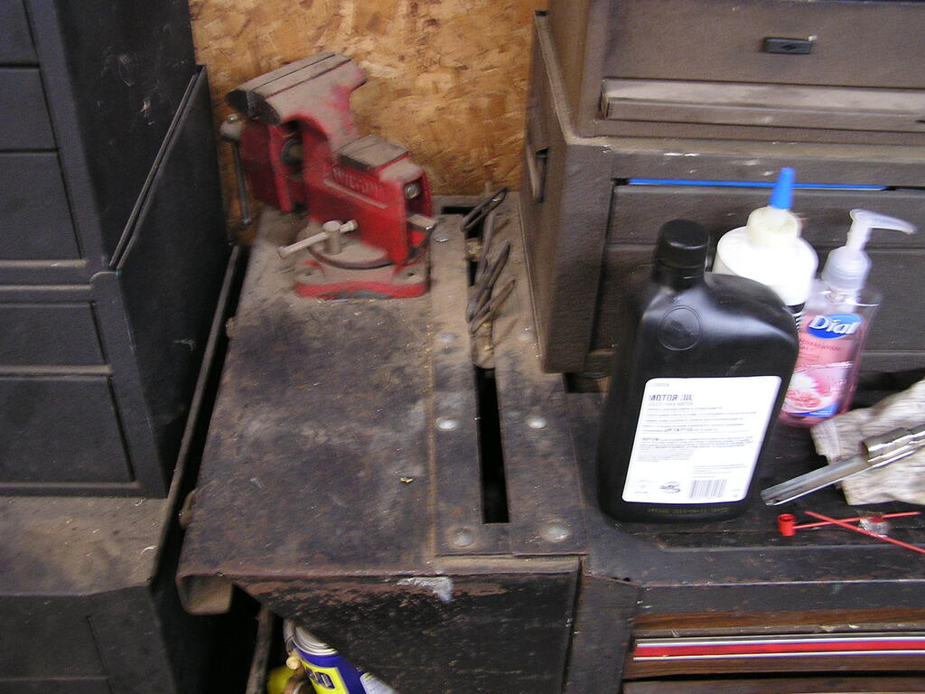

ri702bill 12,268 #14 Posted June 10, 2022 As they say, we all have our Vises! Over the years, I have acquired several. My primary use vise was my Dad's fixed mounted under the bench cast woodworking vise, that is mounted on the left hand end of his 10 foot workbench. A smaller removable clamp-on style I have mounted to the right end of a bench nearby - odd shapes sometimes require a different mount. A third, and probably the most useful of all at the time is a 3" Wilton swivel vise mounted on a heavy gauge shelf attached to my Assembly Roll away. It served as a third hand, mostly used to hold the tubing flareing tools - I did a LOT of custom pneumatic and hydraulic tubing work as a Machine Builder. Last is the 5 inch Milling Machine vise, shown without the removable swivel base. Any heavy pressing or bending now gets done in the 20 ton press. Bill 3 2 Share this post Link to post Share on other sites

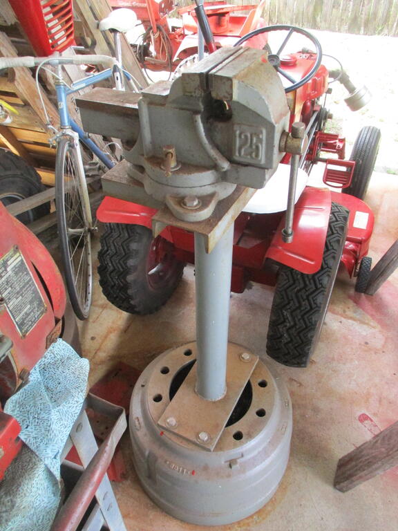

Kenneth R Cluley 680 #17 Posted June 10, 2022 Mounted my beating bending holding vise(4") to a pipe bolted to a truck brake drum. Fine for a lot of things but not stable enough for big torque jobs as it moves around. Built a trailer hitch mount for my other vise that accommodates a standard vise as well as a ridgid pipe vise. All very handy for their respective functions. 6 Share this post Link to post Share on other sites

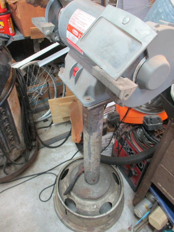

ebinmaine 79,189 #18 Posted June 10, 2022 42 minutes ago, Kenneth R Cluley said: truck brake drum What's the diameter on that drum? That'd be handy for a grinder or portable band saw. 3 1 Share this post Link to post Share on other sites
Kenneth R Cluley 680 #19 Posted June 10, 2022 19" x about a foot deep. approx 100 lbs. Came off a Fire Truck. No exchange or core on them anymore so they scrap them. Mechanic gave it to me. Old wheel rim from truck works well too. here is my grinder set up. 7 Share this post Link to post Share on other sites
