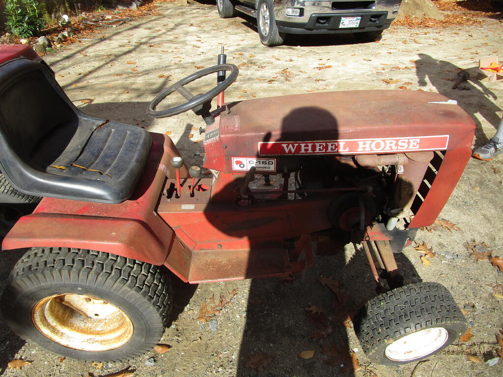

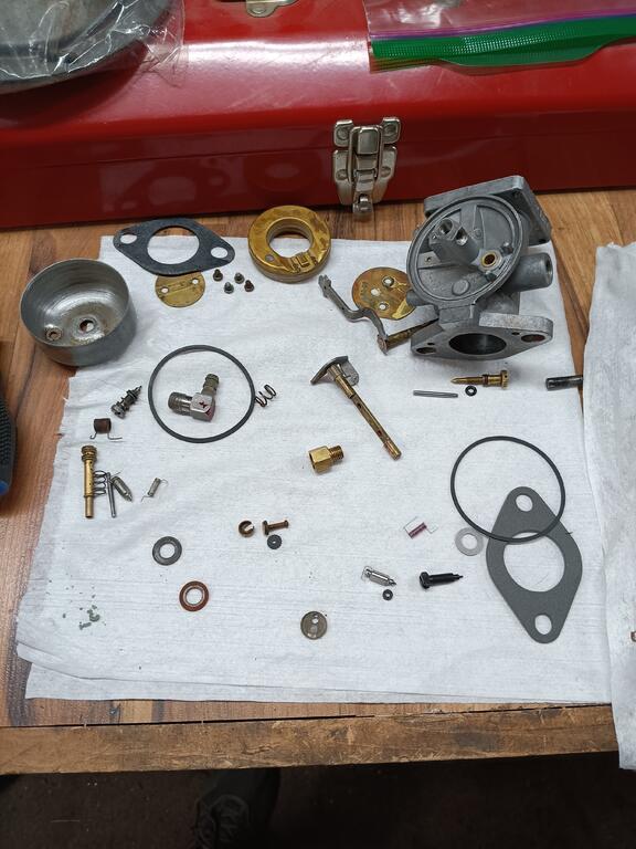

ebinmaine 80,684 #82 Posted July 6, 2024 Been thinking on getting this tractor running for @JCM Jim's Meet n Greet in September. I've had the carb soaking in lacquer thinner in the ultrasonic cleaner for a few days. ( I kinda forgot about it) This afternoon I commenced to spraying brake clean. I used a small portion of one can, a half of another can, and a whole can. Near as I can figure that's about 1.6 cans give or take. I sprayed the carb 7 ways to Sunday and back again. That should be about 49 ways. Carry the 8. Add the 3. I'm thinking it's fairly well clean. I still need to run some wicked tiny wires through a couple wicked tiny holes. Looks good though. 2 Share this post Link to post Share on other sites

ebinmaine 80,684 #84 Posted July 6, 2024 4 minutes ago, Sparky said: Tecumseh carb… good luck Oh man. I know. 4 minutes ago, Sparky said: Didn't I read here in RS years ago about an adapter so a Kohler carb could be used? In fact I've had a K341 carb on this very engine. No adapter is needed from carb to engine. The changeover is from governor linkage to carb and also repositioning the choke linkage. These mid 70s Walbro Big Block carbs aren't as unnecessarily complicated as some of Tecumseh's other... ideas. There are a few REALLY small metering orifices that I believe I've got cleansed now. 🤞 Share this post Link to post Share on other sites
ebinmaine 80,684 #85 Posted July 13, 2024 Got the carburetor parts all cleaned out as stated above and all spread out for reassembly. This afternoon The BBT aka Local Towing Service pulled the C160-8 Tecumseh Horse up to the barn where all our tools now reside. We'll decide what fender pan & seat looks best and get that on. Fair list of other things to do as well. 2 Share this post Link to post Share on other sites

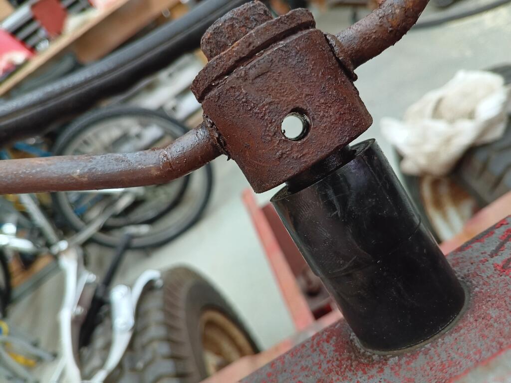

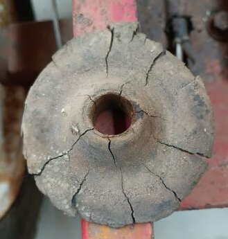

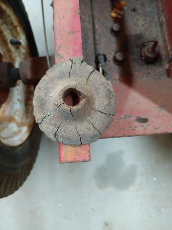

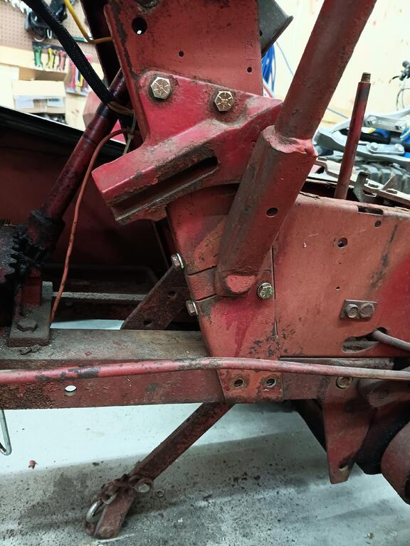

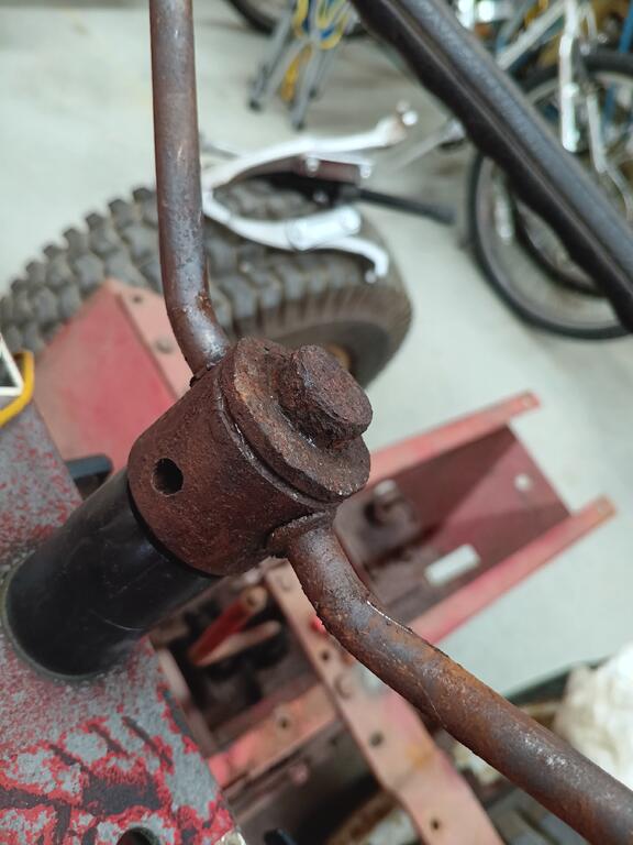

ebinmaine 80,684 #88 Posted July 15, 2024 Started disassembly today. Got the left side step off both the Bronco 14 and this C160-8. I'll clean up the surface of the step with no holes for this tractor and put new grip tape on it. There was an ancient non stock PO cable going to the rear hitch. It was too short and rusty so I cut that out. While fiddling around with the manual lift handle I noticed that the bolts were loose and worn out. One was missing completely. Two were overtightened in the past so there was a nut on the back. I replaced some with grade 8 or added hardened nuts/ washers. I was gonna leave the broken steering wheel on but it got to me. Couldn't do it. Being already damaged I didn't mi d cutting the outer rubber/plastic off to see what I was up against. The roll pin came out with very little irritation. The wheel hub however..... Any thoughts on this? @Handy Don @pfrederi @953 nut @Achto 1 Share this post Link to post Share on other sites

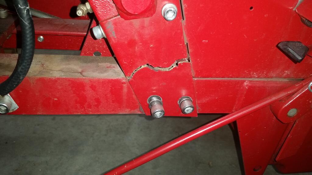

Handy Don 17,473 #89 Posted July 15, 2024 I’ve seen cracks in this area on heavily worked machines--always wondered if it was due to loose components of the lift mechanism putting unexpected strain on the hoodstand. 1 Share this post Link to post Share on other sites
ebinmaine 80,684 #90 Posted July 15, 2024 1 minute ago, Handy Don said: I’ve seen cracks in this area on heavily worked machines--always wondered if it was due to loose components of the lift mechanism putting unexpected strain on the hoodstand. There's logic to that. Share this post Link to post Share on other sites
Achto 32,666 #91 Posted July 15, 2024 1 hour ago, ebinmaine said: The wheel hub however..... Any thoughts on this? Your this far, I'd carefully cut a slit through one side of the hub to let it expand. Should slide right off then. If not, cut a slit on the other side and spit it apart. 1 1 1 Share this post Link to post Share on other sites

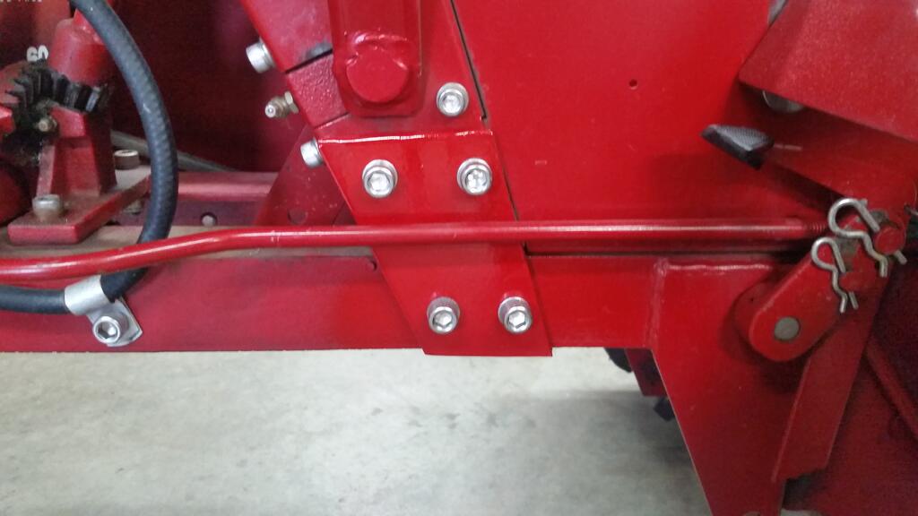

WHX?? 58,085 #92 Posted July 15, 2024 1 hour ago, Handy Don said: I’ve seen cracks in this area on heavily worked machines--always wondered if it was due to loose components of the lift mechanism putting unexpected strain on the hoodstand. Cracks you say? And the fix ... Note the zerk... greasy Pete approved... 3 3 Share this post Link to post Share on other sites
ebinmaine 80,684 #93 Posted July 15, 2024 6 hours ago, WHX?? said: And the fix ... Note the zerk Nicely done Jim! The zerk is simply a drill n tap? Share this post Link to post Share on other sites
ebinmaine 80,684 #94 Posted July 15, 2024 7 hours ago, Achto said: Your this far, I'd carefully cut a slit through one side of the hub to let it expand. Should slide right off then. If not, cut a slit on the other side and spit it apart. Appreciate that. It was the direction I was leaning. Looks me n the jigsaw will have some fun. 😁 1 Share this post Link to post Share on other sites
953 nut 69,228 #95 Posted July 15, 2024 2 hours ago, ebinmaine said: Looks me n the jigsaw will have some fun. Or the flame saw. 1 Share this post Link to post Share on other sites
ebinmaine 80,684 #96 Posted July 15, 2024 Just now, 953 nut said: Or the flame saw. I love the idea but all I have is a small propane torch Share this post Link to post Share on other sites
squonk 48,107 #97 Posted July 15, 2024 I get them welded with reinforcement. They crack due to the twist/torque of lifting a heavy implement like dual stage snowblowers, garden scratchers and 12" plows still pulling in the dirt. 2 Share this post Link to post Share on other sites
