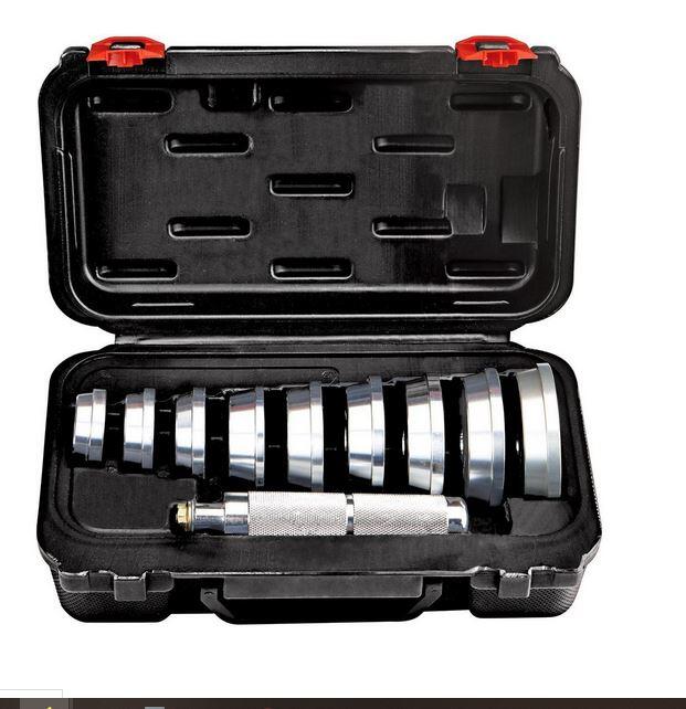

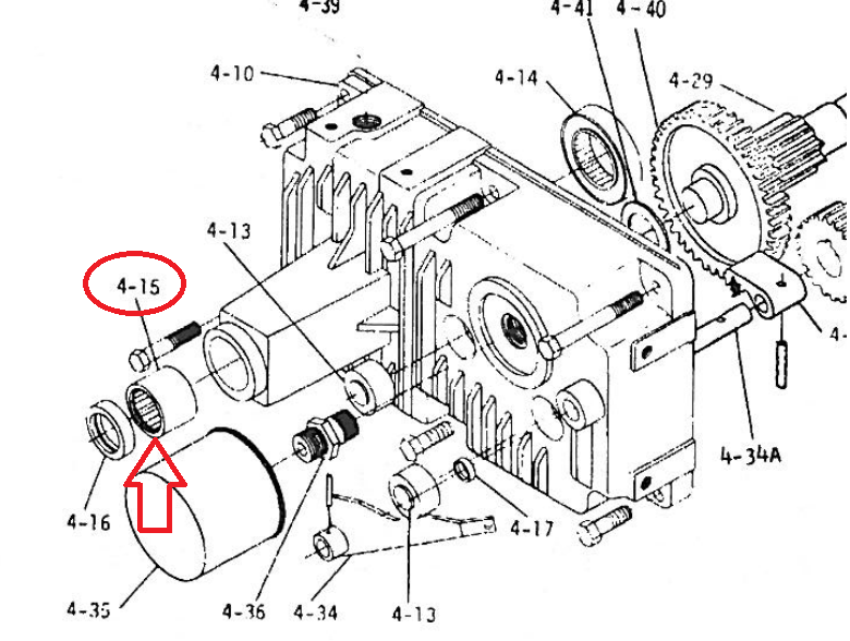

Mike C160 251 #32 Posted June 5, 2022 Can the outer wheel bearing be removed with a simple bearing puller and a new one re-installed by hand with a simple bearing driver? Like without a press? See the diagram. 1 Share this post Link to post Share on other sites
pfrederi 21,322 #33 Posted June 5, 2022 I drive them out from the inside with a bearing driver or appropriately sized socket 2 Share this post Link to post Share on other sites
Mike C160 251 #34 Posted June 5, 2022 Just now, pfrederi said: I drive them out from the inside with a bearing driver or appropriately sized socket And re-install them by hand? 1 Share this post Link to post Share on other sites
Mike C160 251 #35 Posted June 5, 2022 1 minute ago, pfrederi said: I drive them out from the inside with a bearing driver or appropriately sized socket I should ask > Do any of the other needle bearings in that case go? Thinking about ordering what i need... 1 Share this post Link to post Share on other sites
pfrederi 21,322 #36 Posted June 5, 2022 (edited) 8 minutes ago, Mike C160 said: And re-install them by hand? yes with something like this Edited June 5, 2022 by pfrederi 2 Share this post Link to post Share on other sites
