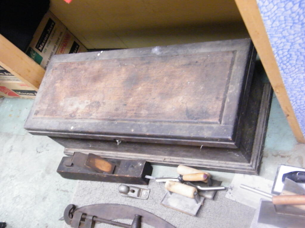

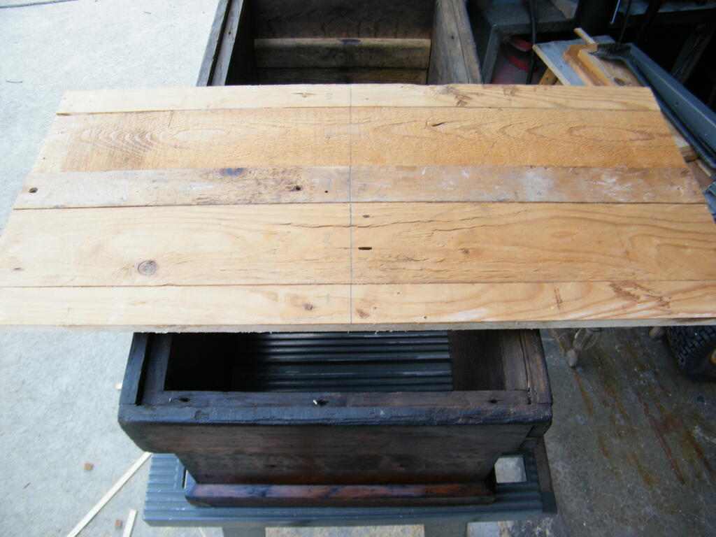

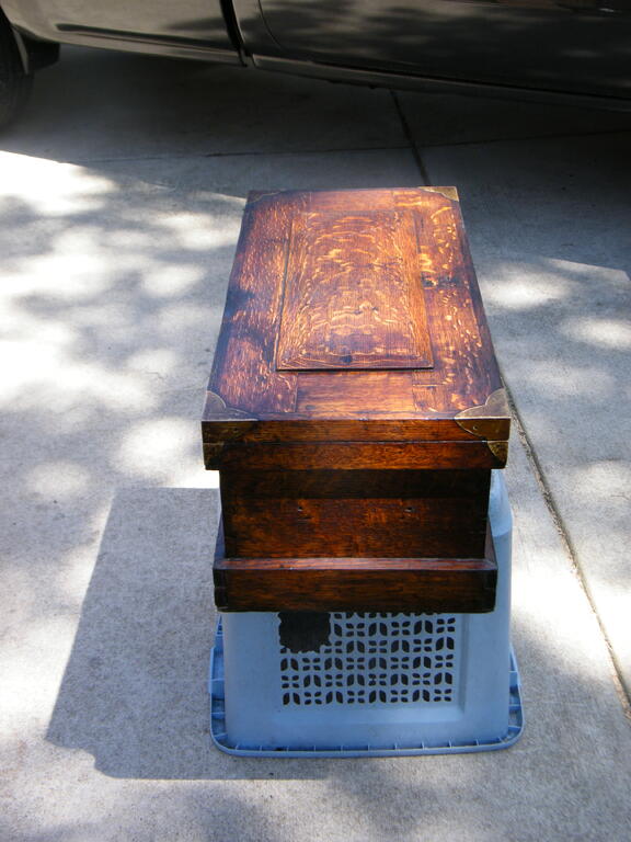

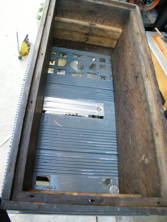

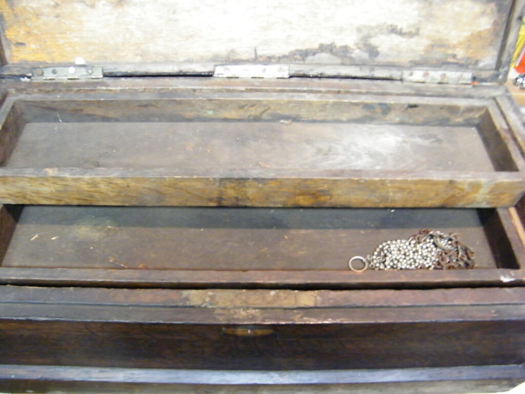

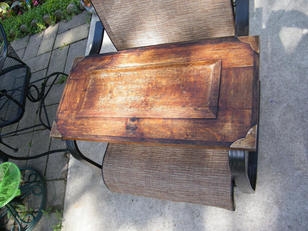

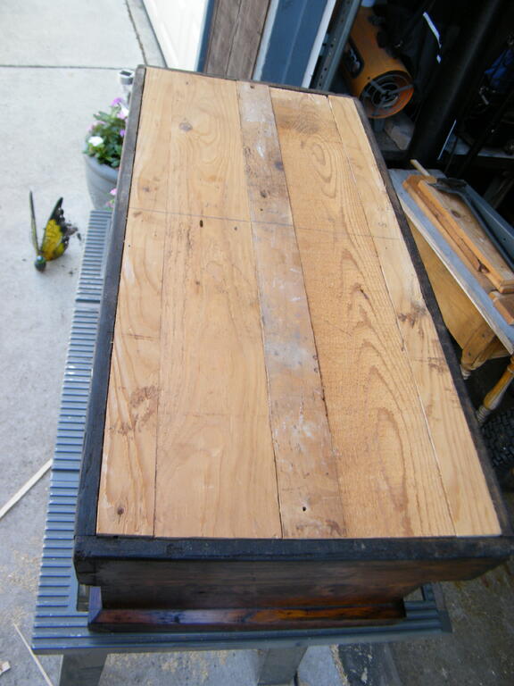

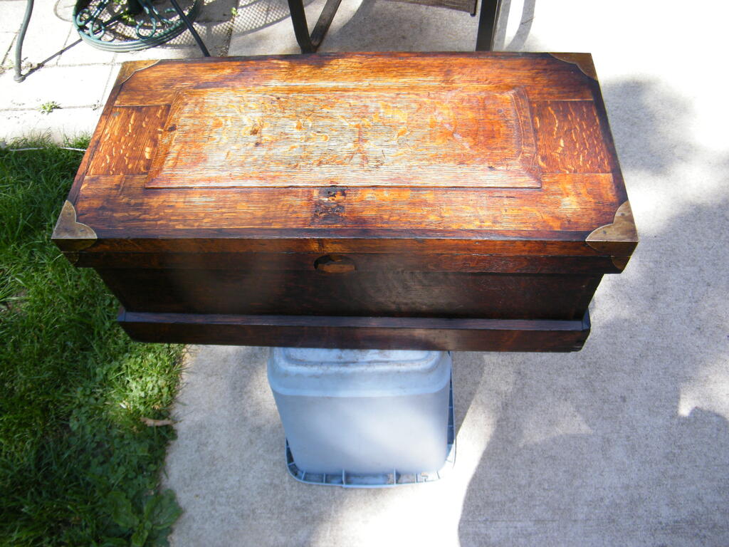

stevasaurus 23,890 #1 Posted June 2, 2022 After seeing what Cas did with one of these and with Cas' help and instruction, I also have (actually 2) of these boxes that I wanted to bring back to life. I inherited these from my Grandfather, who was a big truck mechanic in Chicago. That is why they look so oily and dirty. Here are some before pictures... I took off the lid, front clasp and the one handle, and started cleaning the lid 1st. On the main box, the wood was splitting where the wood screws hold the one side of the hinges. You could look in the screw holes and see light on the other side. I mixed some oak sawdust with Elmer's glue and filled the holes and cracks. Then I managed to back with some strips of wood and and a bunch of clamps to squeeze it together. This is the lid (just cleaned) used paint thinner and a green scrubby. Then looked at the bottom and all of the nails holding that in were rusted and the wood was all cracked and broke. Pulled out the bottom. I had some old, ruff sawn pine, so I cut the pieces, glued it together and then cut the rabbet on the table saw. It fits great, but I have not screwed it in yet...still a couple of thing to do, but the tool box is cleaned and finished with 3 coats of 1 part Boiled Linseed Oil and 2 parts Paint Thinner. I need to find a couple of antique looking handles yet. Thanks Cas. edit...I just want to give credit where credit is due. Here is the thread that was the inspiration for this. I consider myself a "rough carpenter"...Cas is a "Master Furniture Carpenter"...big difference !!! 4 9 4 Share this post Link to post Share on other sites
formariz 12,381 #2 Posted June 2, 2022 Great job on the restore Steve. Box has incredibly beautiful quarter sawn white or live oak. If you want them I have the proper handles for it. Your choice of which pair or both since you have two boxes. Top pair is cast iron. Bottom pair are steel. I do have more of bottom pair. You may want to build a till for the inside. Looks like it had one. Those boxes obviously have a special meaning for you. Fill them with tools specially if they are from your grandfather and pass them on to the next generation. It’s a great feeling when one is able to instill what one loves and one’s knowledge in others. There can be no greater thank you. 3 3 Share this post Link to post Share on other sites

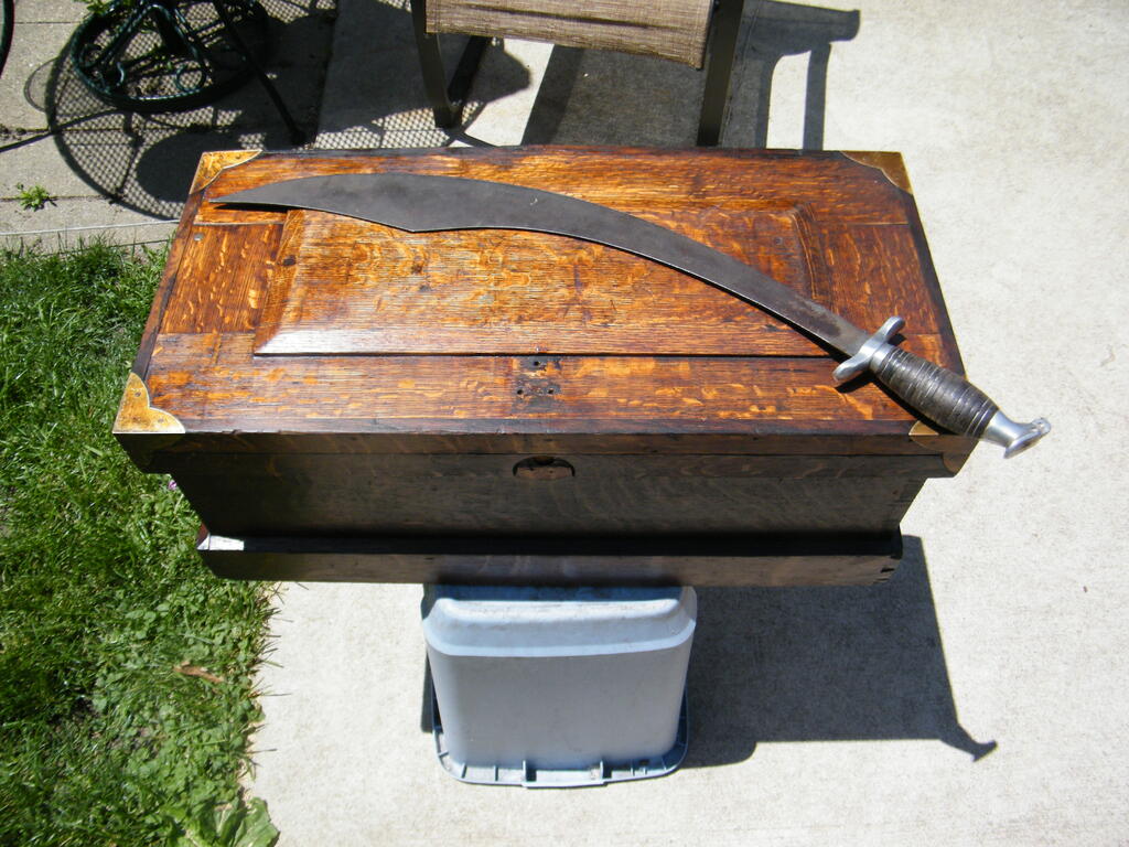

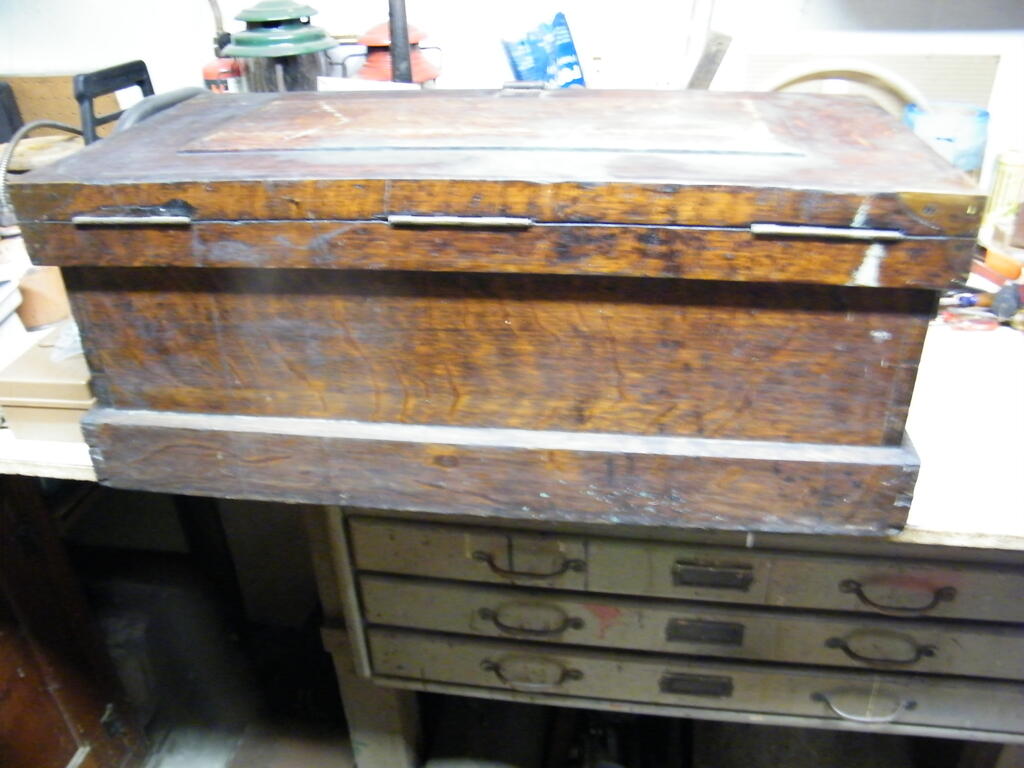

stevasaurus 23,890 #8 Posted June 2, 2022 Well, at this point, here is a couple pics of the second box. This box has no handles and may not have had any. I believe this box to be in better shape wood wise then the first box. After seeing how the first one turned out, I can't wait to get into the second one. Cas, did you notice the leather wrapped handle on the pirate's sword?? I actually found that in a field when I was working for the phone company. It was a little rusty, but cleaned up OK. I think it looks great myself. I'll PM you about the handles. That is a heck of an offer on your part...Thank you my friend...for your knowledge and help. BTW Cas, take a look at the old plane in the lower pictures. Is there a way to fix the missing handle on that so it is useable?? 2 Share this post Link to post Share on other sites

formariz 12,381 #19 Posted June 3, 2022 11 hours ago, stevasaurus said: Then looked at the bottom and all of the nails holding that in were rusted and the wood was all cracked and broke. The bottoms in these boxes always suffer the most damage because they are always on the floor absorbing moisture and being dragged around. That is the reason why they are all installed in this manner. Simply nailed onto the sides of box, rather than fit into grooves on sides. This way they are easy to replace. One way to avoid moisture from ruining bottoms and keep airflow underneath is to make a couple of “stands” to raise box from floor. Here is one made by my father when he was a young man with such stands. They also display box better if kept inside house. 3 2 Share this post Link to post Share on other sites

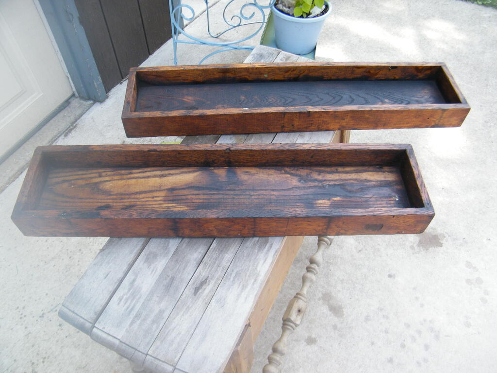

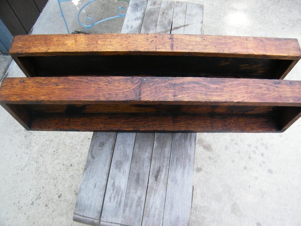

stevasaurus 23,890 #20 Posted June 13, 2022 The trays were so nasty, they just didn't look good with the newly finished chest, so I went and cleaned and finished the trays also. Here is a before picture and then a few of the cleaned up trays. 3 5 1 Share this post Link to post Share on other sites
ebinmaine 81,208 #21 Posted June 13, 2022 Steve ole buddy I think that looks just fantastic. 2 Share this post Link to post Share on other sites
Handy Don 17,703 #22 Posted June 13, 2022 Some stories that box could tell, eh? 2 Share this post Link to post Share on other sites
formariz 12,381 #23 Posted June 14, 2022 Trays are also built from the same type quartered oak . Looks like the bottoms maybe Ash. Who ever built it has great taste in wood choice. 1 Share this post Link to post Share on other sites
