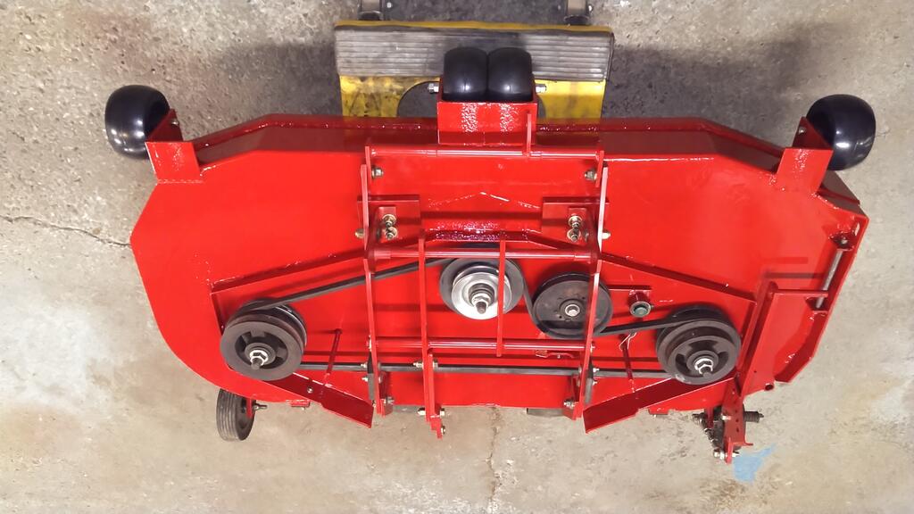

Bill D 2,794 #1 Posted April 1, 2022 (edited) Many of us have made custom parts, attachments or mods to our tractors, like foot pedal controls for example. Let's see the pictures. Close up pictures and descriptions are appreciated. I love gaining inspiration for a build of my own from the folks here. Here's my modified Bobcat deck. Got the idea from @kpinnc Edited April 1, 2022 by Bill D 10 4 1 Share this post Link to post Share on other sites

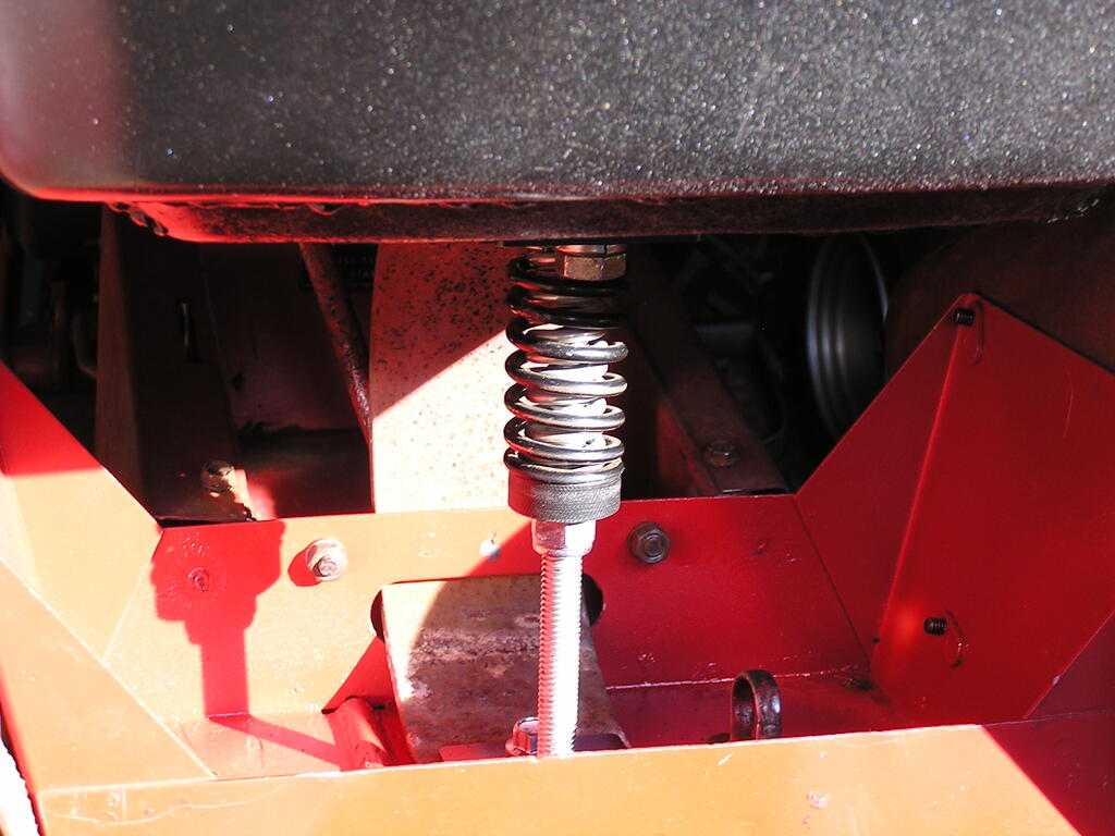

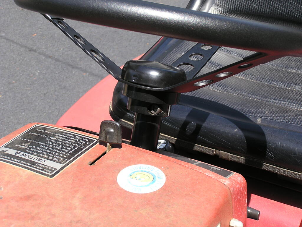

ri702bill 12,009 #2 Posted April 1, 2022 I have a couple - First, a two-piece clamp-on steering wheel adapter. No more roll pin, and you use the aftermarket steering wheel of your choice. Mine on the C81 kind of looks like a 420LSE. Second, an adjustable spring assist for the seat on Round Hoods to keep the seat from abrading the paint off the toolbox fenders. 9 5 1 Share this post Link to post Share on other sites

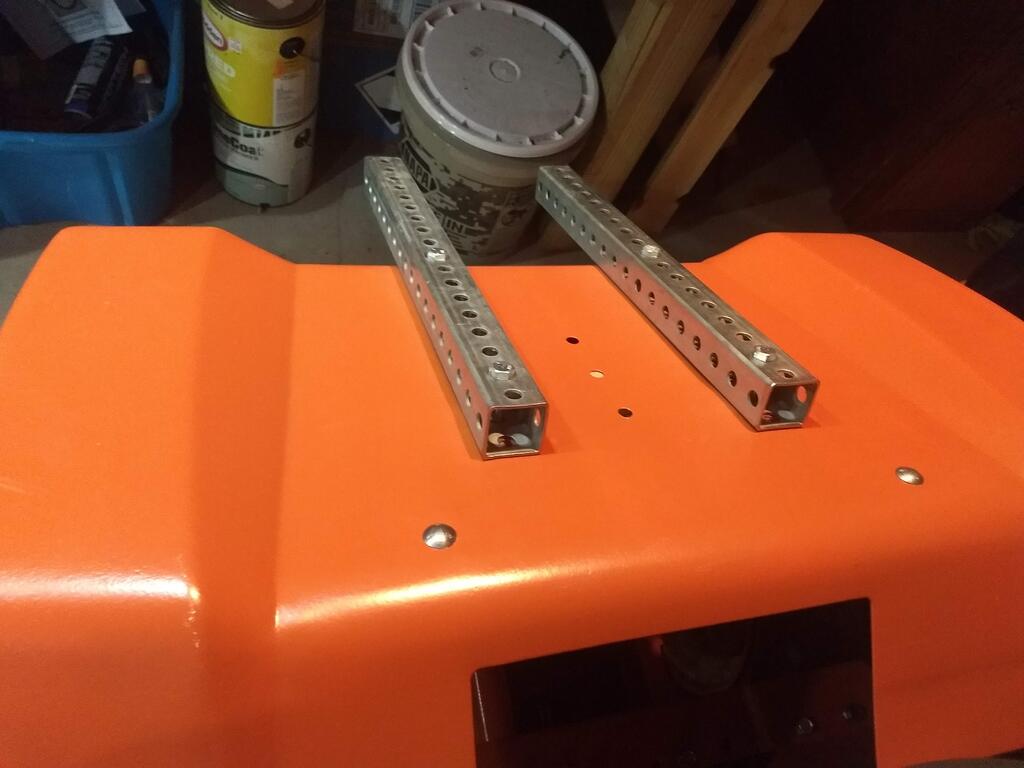

ebinmaine 78,552 #3 Posted April 1, 2022 Here's my solution to moving the seat back on the Cinnamon Horse 1974 c160. Bolted the square bars to the seat pan and the seat to the square bars. Gave me a good strong two inches of additional legroom. 10 1 Share this post Link to post Share on other sites

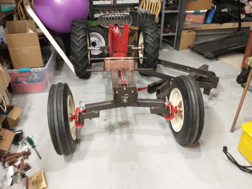

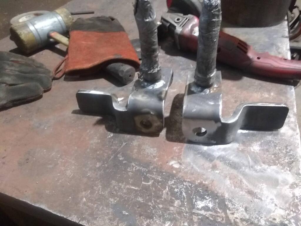

ebinmaine 78,552 #4 Posted April 1, 2022 My Colossus tractor project is quite a lot of custom work from one end to the other. I'm particularly happy with the spindles. I designed them and our fabricating friend built them. I helped her just a tiny bit with brute Force on a big wrench but everything else, credit to her. Here's a sequence of what they started as to the finished product as mounted. 6 4 Share this post Link to post Share on other sites

Lee1977 7,633 #6 Posted April 1, 2022 9 hours ago, Bill D said: Many of us have made custom parts, attachments or mods to our tractors, like foot pedal controls for example. Let's see the pictures. Close up pictures and descriptions are appreciated. I love gaining inspiration for a build of my own from the folks here. Here's my modified Bobcat deck. Got the idea from @kpinnc Looks like your blades are turning the wrong way unless they are sharpen on both sides. 1 Share this post Link to post Share on other sites
Bill D 2,794 #7 Posted April 1, 2022 50 minutes ago, Lee1977 said: Looks like your blades are turning the wrong way unless they are sharpen on both sides. They are turning the correct way. I've cut with it twice now. 1 Share this post Link to post Share on other sites

kpinnc 18,081 #13 Posted April 2, 2022 19 hours ago, Bill D said: Here's my modified Bobcat deck. Got the idea from @kpinnc Gotta get off my butt and finish mine. Your's looks so nice! 1 Share this post Link to post Share on other sites
Jeff-C175 7,207 #14 Posted April 2, 2022 There's a toenail trimmer, eh? I imagine you plan on running it with the discharge chute in place? 4 Share this post Link to post Share on other sites
kpinnc 18,081 #15 Posted April 2, 2022 (edited) 7 minutes ago, Jeff-C175 said: I imagine you plan on running it with the discharge chute in place? They are made that way so you can trim equally close on both sides... Unlike 'certain' older decks with 5 inches of metal past the tip of the blade. Edited April 2, 2022 by kpinnc 2 1 Share this post Link to post Share on other sites

clueless 3,397 #20 Posted April 2, 2022 23 hours ago, ebinmaine said: Here's my solution to moving the seat back on the Cinnamon Horse 1974 c160. Bolted the square bars to the seat pan and the seat to the square bars. Gave me a good strong two inches of additional legroom. So how do you bolt the seat on the brackets once their on the tractor? 2 Share this post Link to post Share on other sites
ebinmaine 78,552 #21 Posted April 2, 2022 3 hours ago, clueless said: So how do you bolt the seat on the brackets once their on the tractor? I've done the square tube mount set-up on both Cinnamon Horse C160-8 and the '75 C160 Automatic. I did a little variance on the two. Gimme a few here and I'll get some pics and info for ya. 1 Share this post Link to post Share on other sites

ebinmaine 78,552 #23 Posted April 2, 2022 7 hours ago, clueless said: So how do you bolt the seat on the brackets once their on the tractor? @clueless Here's a couple pics. I used 2 sets of 4 bolts. One set goes down from the middle of the square bars through the seat pan. The other set goes up through the seat pan, bars, and into the seat base. I could have likely used only the second set but I wanted the extra strength. 3 Share this post Link to post Share on other sites
kpinnc 18,081 #24 Posted April 3, 2022 On 4/1/2022 at 10:46 AM, ebinmaine said: Bolted the square bars to the seat pan and the seat to the square bars. Gave me a good strong two inches of additional legroom. Eb, I was just trying to figure out a new seat mount for the 867. I do believe I'm gonna steal your idea... 2 Share this post Link to post Share on other sites
ebinmaine 78,552 #25 Posted April 3, 2022 18 minutes ago, kpinnc said: Eb, I was just trying to figure out a new seat mount for the 867. I do believe I'm gonna steal your idea... Yer welcome to it bubba. Just be REALLY REALLY sure the seat pan tab lock is in excellent condition. 2 Share this post Link to post Share on other sites
