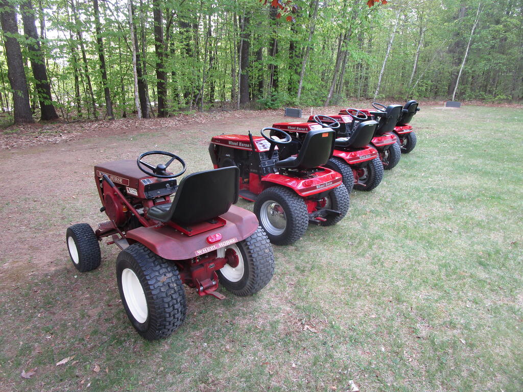

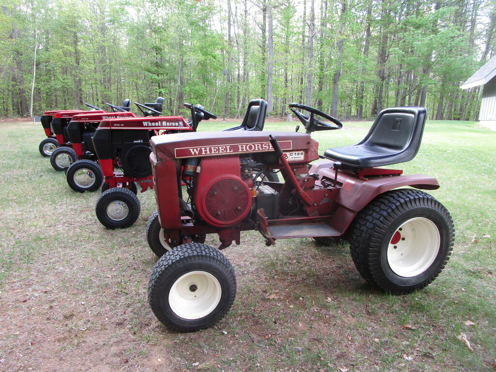

cutter-man 11 #12 Posted March 28, 2022 Nice collection you have 2 Share this post Link to post Share on other sites

WHX?? 54,899 #16 Posted March 29, 2022 (edited) 20 hours ago, cutter-man said: Nice collection you have Really Plunge that C-120 has got a patina to die for and the seat! Just don't fit in with yer herd tho I best come get it ....dibs at least.... If you are located with where I think you are you should have no problem finding a decent horse. My morning CL searches often find nice ones south of the border & looks like your not terrible far from the @stevasaurus. Ton of nice horses in his area. Edited March 29, 2022 by WHX?? 2 1 Share this post Link to post Share on other sites

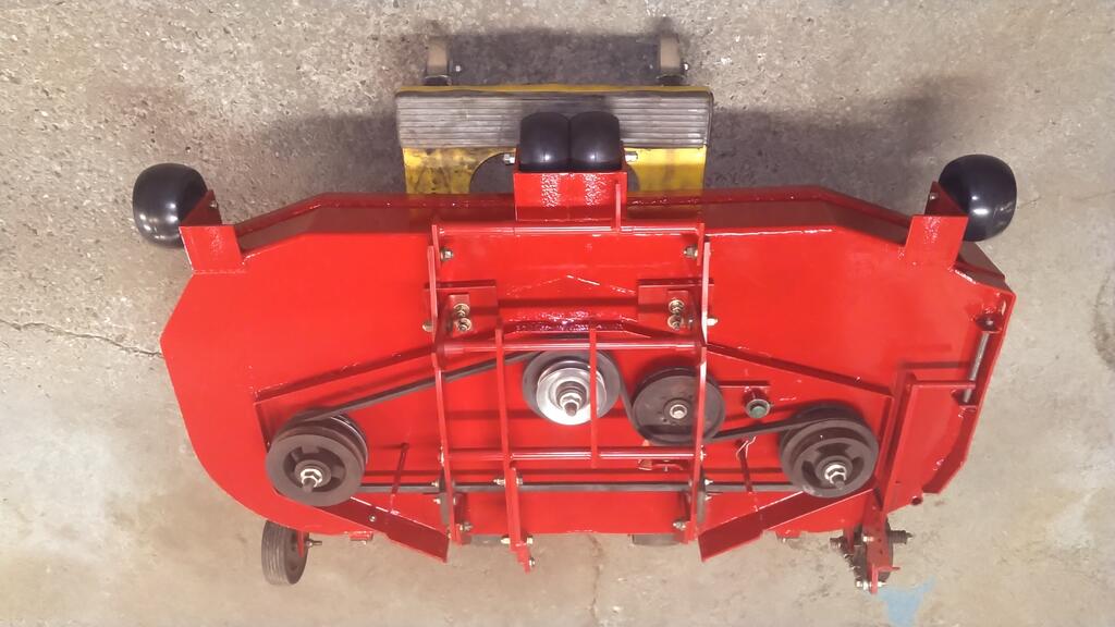

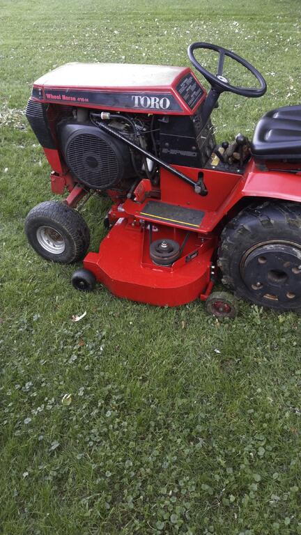

Bill D 2,593 #19 Posted March 30, 2022 Decks can be the weak point on a Wheel Horse, but if you're handy a deck from a walk behind mower can be modified to fit under one. I did it and so did @kpinnc. 2 4 Share this post Link to post Share on other sites
Tuneup 1,452 #20 Posted March 30, 2022 You want one so I'll assume you're handy with a wrench and can troubleshoot and repair. You're going to be doing something to make it run or run better as these aren't new machines. That out of the way, you're in an area that is Wheel Horse plentiful so you have your pick. If it were me, I'd go for the 300-500 series with a Kohler 14+ and a 48" deck. Those Onans are beasts but need a little more TLC than the one lungers. Don't forget to feed back and tell us what you found. Hearty group here that can solve almost anything. 2 Share this post Link to post Share on other sites
kpinnc 17,144 #21 Posted March 30, 2022 12 hours ago, Bill D said: Decks can be the weak point on a Wheel Horse, but if you're handy a deck from a walk behind mower can be modified to fit under one. I did it and so did @kpinnc. I'm such a slacker! Your's looks great Bill! 2 Share this post Link to post Share on other sites
Bill D 2,593 #22 Posted March 30, 2022 7 hours ago, kpinnc said: I'm such a slacker! Your's looks great Bill! I think yours cuts better though. Still need to add baffles. Getting a lot of clippings discharged out the front. I think your Exmark deck was a better starting point than the Bobcat deck. 1 Share this post Link to post Share on other sites
kpinnc 17,144 #23 Posted March 31, 2022 3 hours ago, Bill D said: Still need to add baffles. I think baffles are the only difference between them. 1 Share this post Link to post Share on other sites
Bill D 2,593 #24 Posted March 31, 2022 1 hour ago, kpinnc said: I think baffles are the only difference between them. If the deck from your Metro is the same as the one on my Viking, then they are drastically different. I like the Exmark deck better, but the Bobcat deck may have been easier to modify. I tried putting 8" tires on my 416 and they rub the deck. A forward swept front end would be preferred with these decks. I'll have to find the link to your deck build. 1 Share this post Link to post Share on other sites
kpinnc 17,144 #25 Posted March 31, 2022 It was a tight fit! And yes, I'm using it on a swept axle- equipped tractor. 2 1 Share this post Link to post Share on other sites
