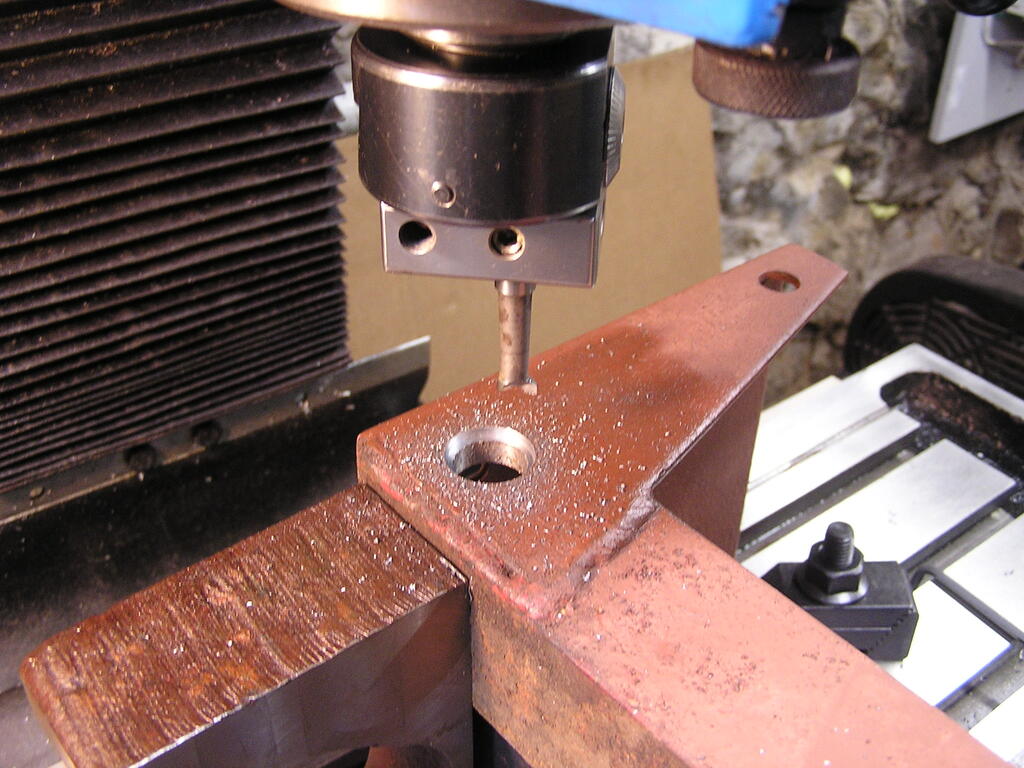

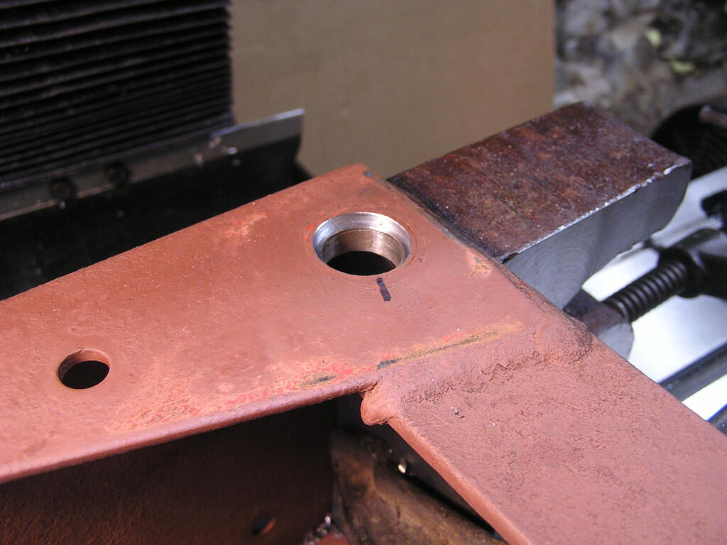

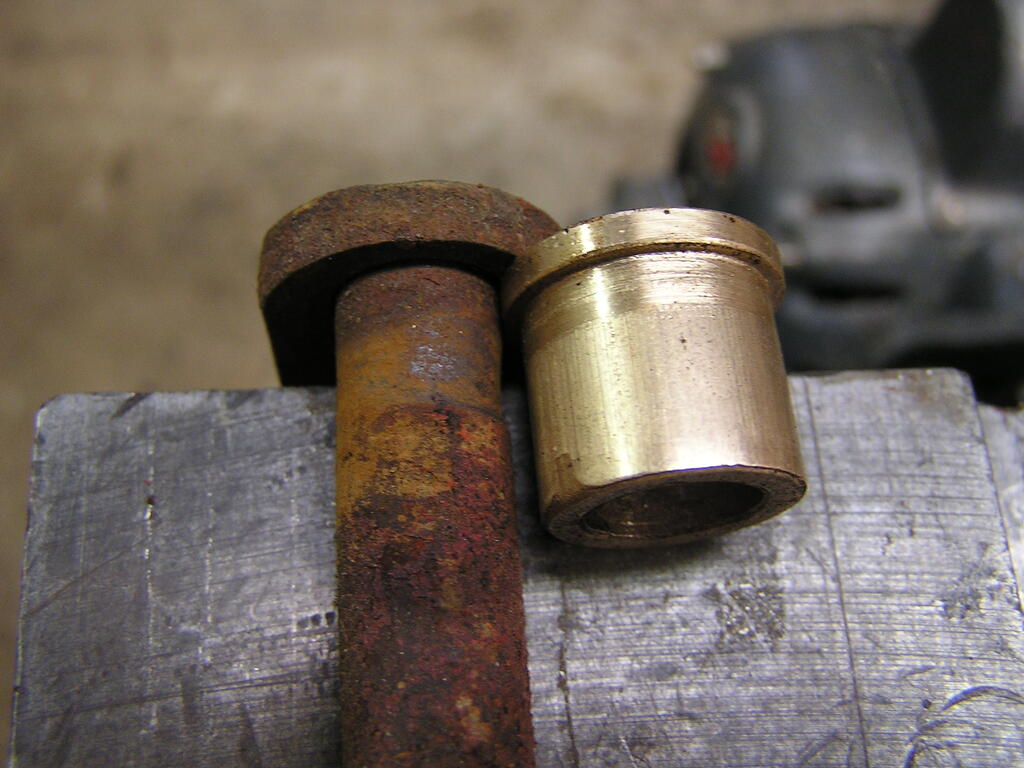

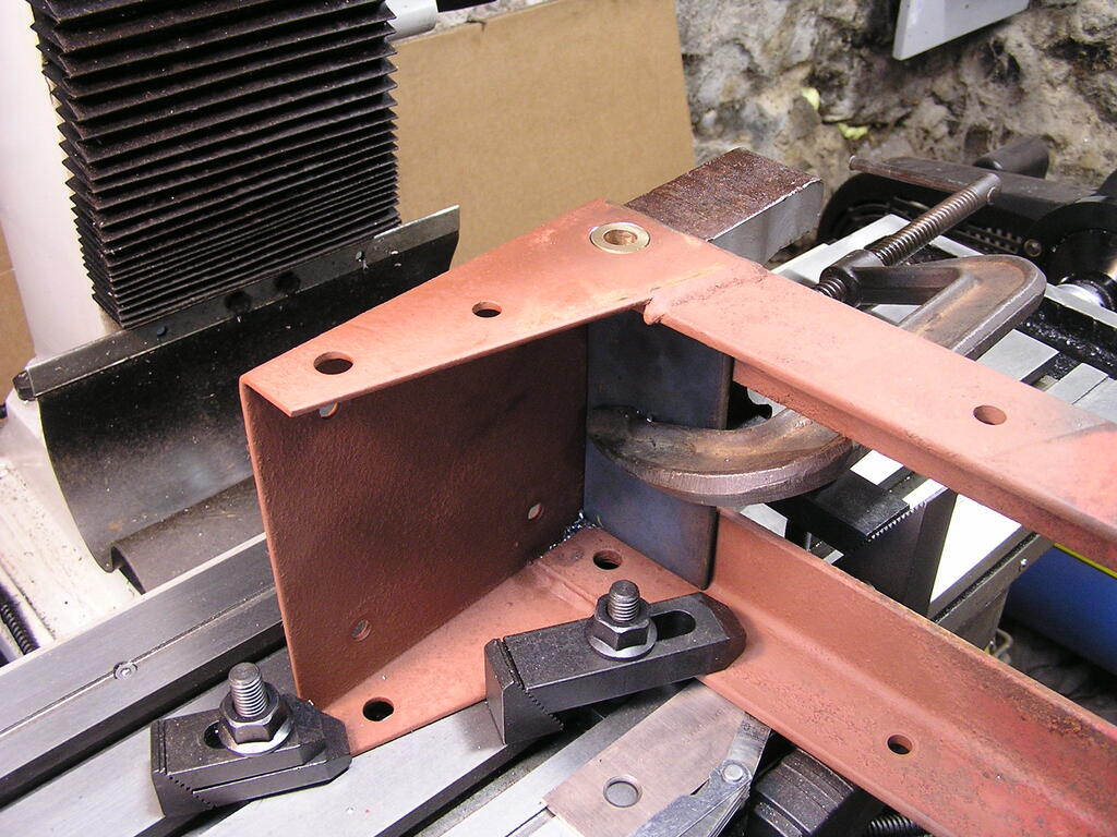

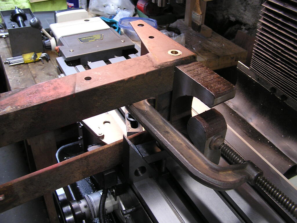

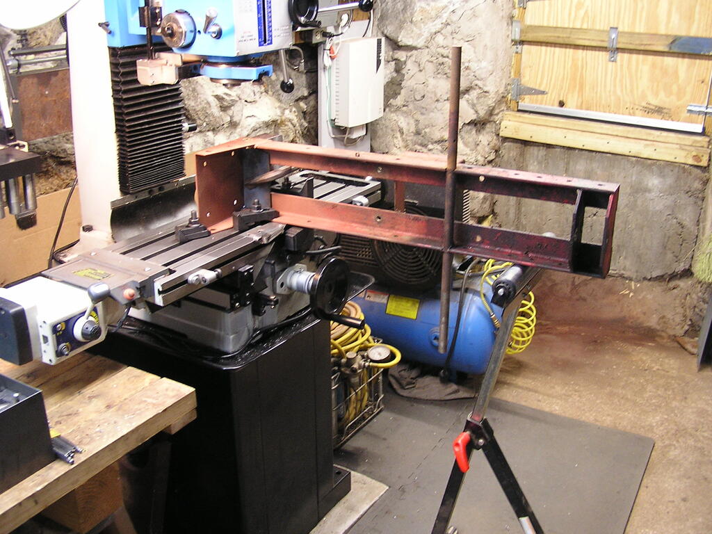

ri702bill 13,271 #1 Posted March 12, 2022 All: While I had the frame stripped of all hardware on the 502 I am building, I addressed the localized wear issue on the 1/2 inch diameter pivot shaft where both ends go thru the frame. The plan is to machine the frame to accept 2 flanged sintered bronze bushings with a longer contact length on the shaft. The original had a poor L to D (Length to Diameter) ratio of about .5 to 1, (and a less than desirable steel on steel design) the 3/4" long bushing gives it 1.5 to 1. I am not a fan of using a pistol drill to drill and ream the enlarged holes; I wanted to add a shallow .090 deep counterbore to capture the bushing and leave about .015 of the flange sticking out after fly cutting, so off to the milling machine. Some folks may criticize machining a sintered bushing that it closes off the pores - got an issue - go grab a tissue!! I intend to remove about .040 from the backside of the cast iron lever at assembly. Notice in the first picture that there was no contact at the inside of the welded lever - the holes thru the frame plate are oversized - only the holes in the frame rails did the locating. More to follow upon assembly. Bill 1 6 Share this post Link to post Share on other sites

ri702bill 13,271 #9 Posted March 12, 2022 9 minutes ago, ebinmaine said: After the initial application of the green grease is there a creeping lubricant you can use. Periodically? Since the bushings are 3/4 inch long, I just might pop them back into the lathe and undercut the middle 1/4 inch of the ID by about .020 and pack that recess with the green grease at assembly. That still gives me a 1:1 L to D ratio.......... 2 Share this post Link to post Share on other sites

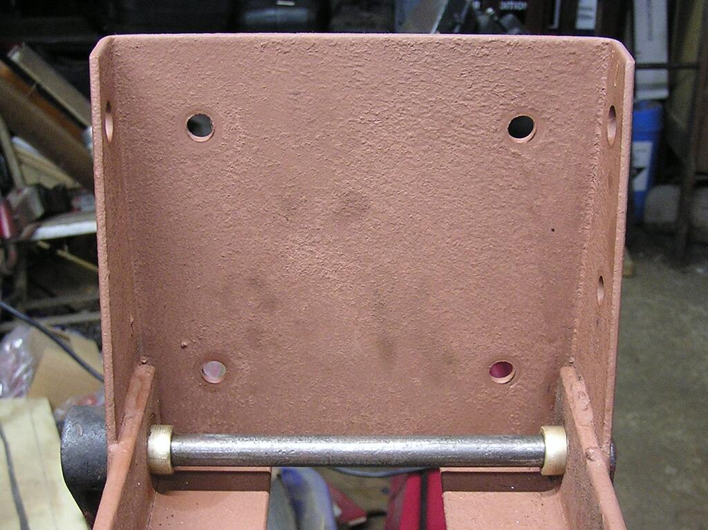

ri702bill 13,271 #21 Posted March 13, 2022 (edited) The finished product - I did undercut the middle of the ID on both bushings - gives me the option to pack with green grease or not. The "parts department" yielded two thin steel 1/2" shims to go onto the flanges. Cut .045 off the inside of the cast iron lever - pin hole lines up nicely and there is about .010 clearance gap to the frame when assembled. All in all, about a 3-beer job .... Done. Edited March 13, 2022 by ri702bill 1 3 Share this post Link to post Share on other sites
