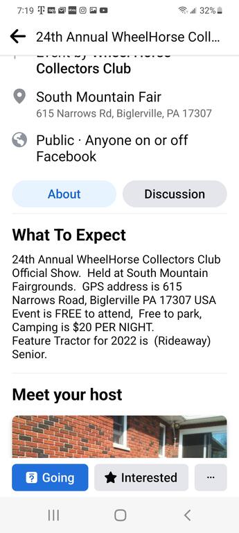

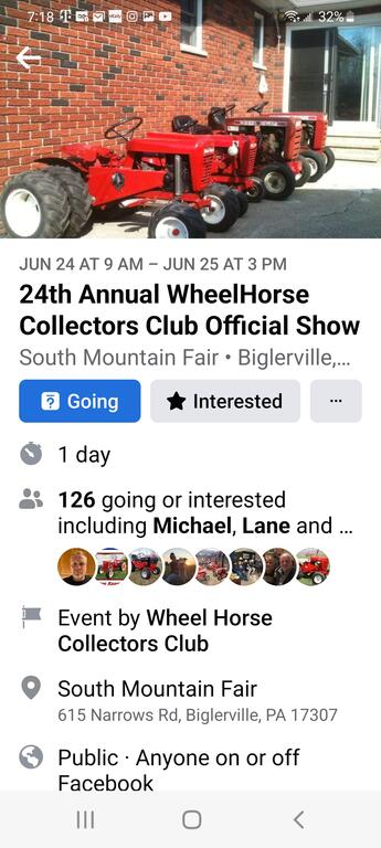

857lover 291 #17 Posted March 2, 2022 On 2/26/2022 at 9:07 PM, squonk said: The PA show is 3 1/2 month's away. Yes I'm biased but you could buy my motor at about what a predator cost and not have to fool with finding a pulley to fit and rigging up a throttle ect. A Kohler replacement is a 2 hour job swapping the external parts and that's taking your time doing it. where is this show?? Share this post Link to post Share on other sites
oliver2-44 11,694 #18 Posted March 2, 2022 Bieglerville Pa. Probable just down the road from you. In June the weekend after Father’s Day every year. Share this post Link to post Share on other sites
AMC RULES 37,259 #19 Posted March 2, 2022 9 hours ago, 857lover said: where is this show?? 1 Share this post Link to post Share on other sites

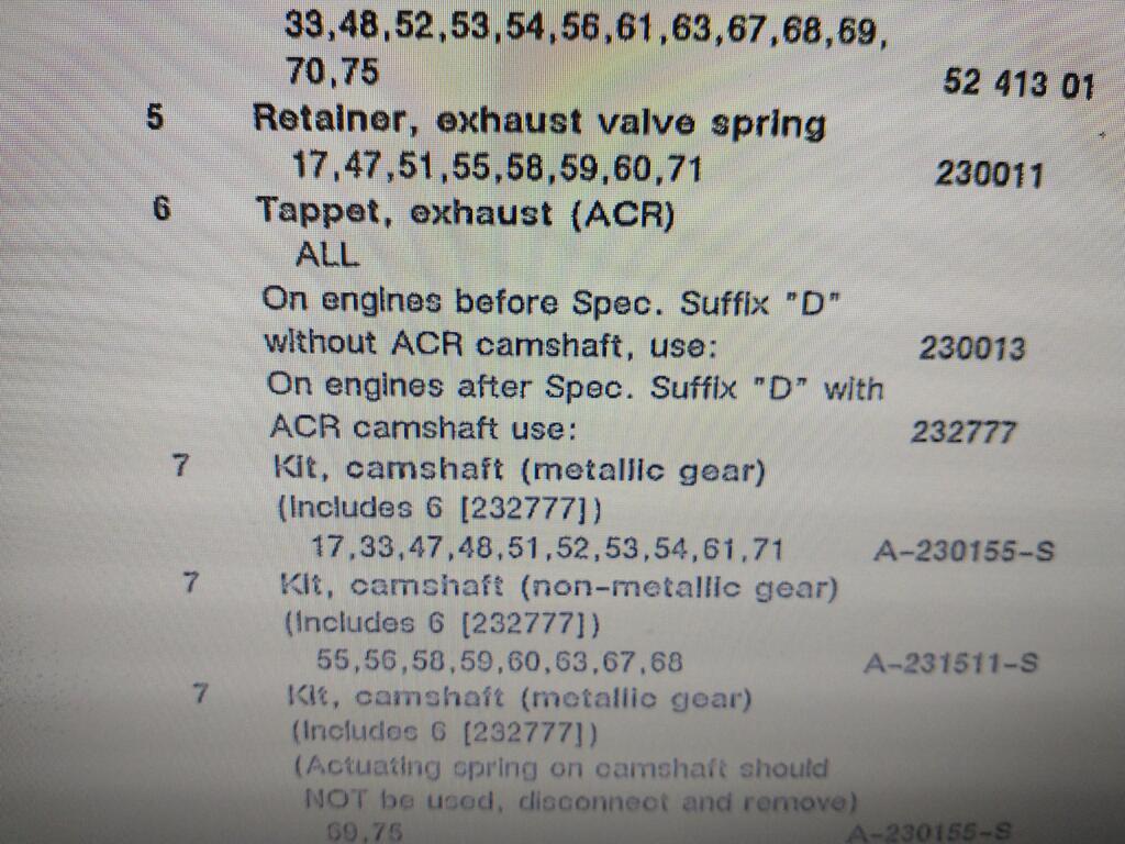

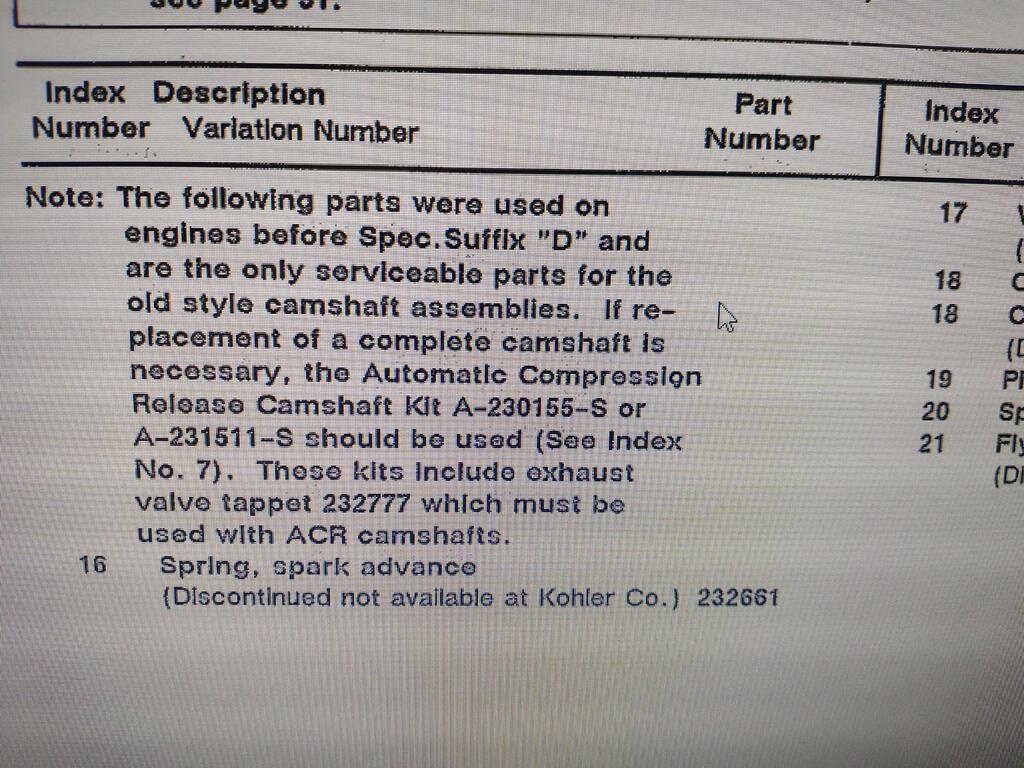

csvt99 173 #21 Posted March 5, 2022 Sqounks motor is a 30108A. Mine is a 30108D. Will this pretty much be a direct swap? Hopefully one of you knows the what the differences are between the two. Will all my other engine components bolt up to it? Thanks! 1 Share this post Link to post Share on other sites
squonk 47,887 #22 Posted March 5, 2022 (edited) 20 minutes ago, csvt99 said: Sqounks motor is a 30108A. Mine is a 30108D. Will this pretty much be a direct swap? Hopefully one of you knows the what the differences are between the two. Will all my other engine components bolt up to it? Thanks! Direct fit. The A is an older version of the D. I got 2 engines one A and D. The only difference between the 2 is the A had a spark advance cam and the D came with a Compression Release cam (ACR). I have no idea if the previous owners swapped the shrouds and tags around. This engine has the D style camshaft. All external parts will bolt on. I believe I got the shrouds switched when I was working on them. It didn't look like this engine was ever apart before and it had the suffix D cam. Edited March 5, 2022 by squonk 1 Share this post Link to post Share on other sites
csvt99 173 #23 Posted March 5, 2022 Looks like I'm going with Sqounk's motor. Turns out he switched his photos, and this motor is indeed the D and the same model as mine. Thanks for all of your help, I'm looking forward to getting the little 877 rolling again! 1 Share this post Link to post Share on other sites
