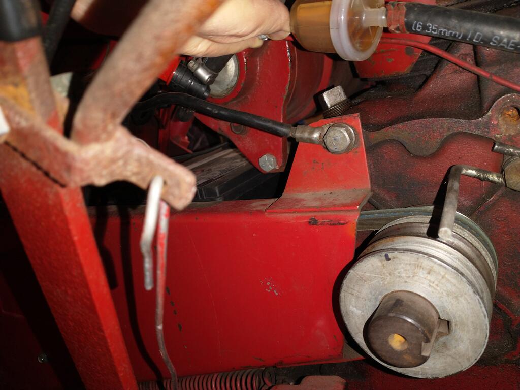

csvt99 173 #4 Posted January 7, 2023 The only issue I'm having so far is hooking up the battery. I had taken it off to put on the charger before I got started on the motor, so I don't have pictures. I only have two wires that I can find that are to be hooked to the battery. One larger one and one smaller green wire that connects to the regulator. It seems these both would go to the positive terminal, but that leaves nothing for the ground. Any suggestions? I I might have to dig around some more to make sure there isn't one hiding somewhere. 1 Share this post Link to post Share on other sites
squonk 48,324 #5 Posted January 7, 2023 (edited) Ground wire from battery connects to the engine block anywhere (preferred) or to the frame. My 857 goes to the engine / belt guard bolt above the pulley. Edited January 7, 2023 by squonk 2 Share this post Link to post Share on other sites
csvt99 173 #6 Posted January 7, 2023 Ah hah! Thanks so much. I checked the corner of my garage where I stashed the pulley guard and sure enough the ground strap was laying with the cover. Now I just have to get the battery connected, install the new nipple and muffler, and hope she starts! 1 Share this post Link to post Share on other sites
