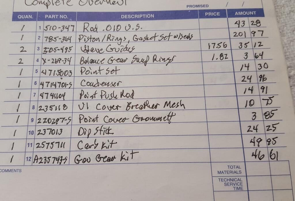

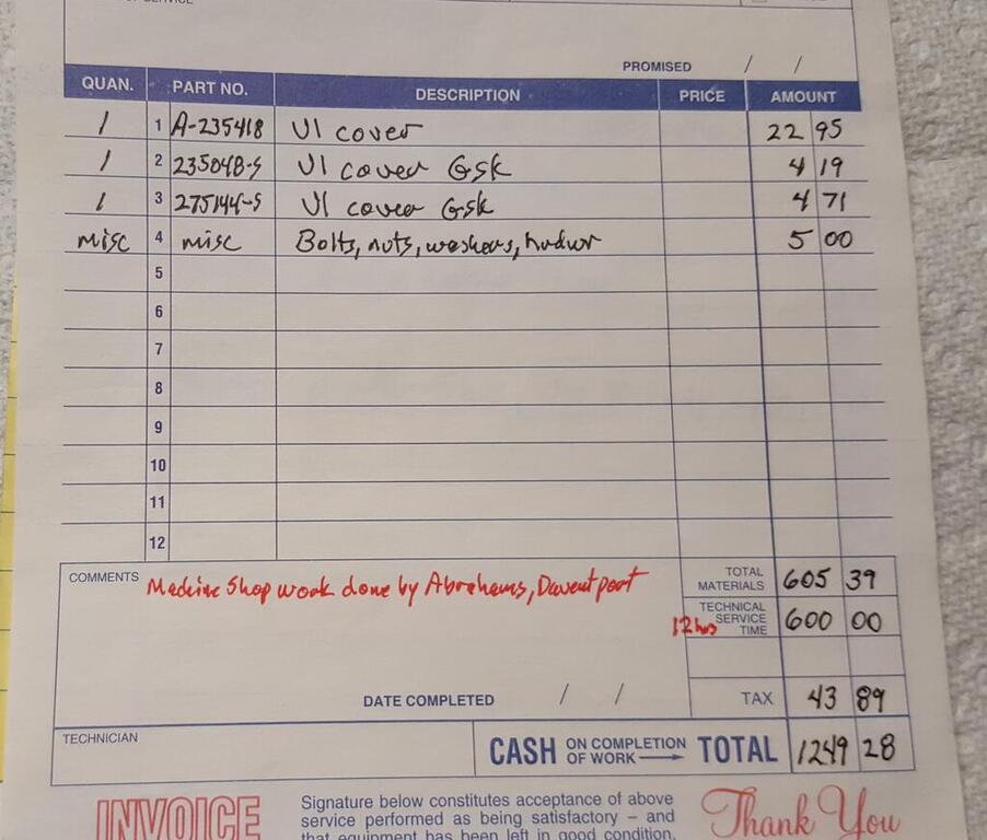

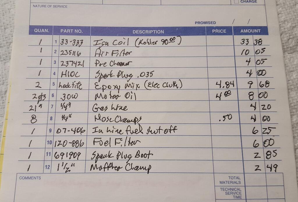

Gregor 4,848 #10 Posted December 30, 2020 (edited) You can buy a complete rebuld kit from isavetractors, poke here for less than $250. Assuming your motor does not need any machining, you can install this kit and have a decent motor, and it's fun. ( most of the time ) If you buy a kit, I would not install the carburetor. Rebuild the one you have, and reuse it. That being said, yes you could rebuild it for less than $300. But........... To do it right, you will need some tools, most guys don't always have on hand. A torque wrench, (possibly more than 1), A ring compressor. A valve spring compressor, Feeler gauges. Cylinder hone. A bearing puller and press, if you want to replace the bearings. ( I didn't ) Rebuilding is a lot of fun, but you just can't do it with a pair of pliers, and a screwdriver. This is a good video I think. https://www.youtube.com/watch?v=M13vyu9bDQQ Edited December 30, 2020 by Gregor 3 Share this post Link to post Share on other sites
adsm08 5,243 #11 Posted December 30, 2020 5 hours ago, Gregor said: Assuming your motor does not need any machining Is a great way to do it wrong. I recently opened up one of these engines too. After pricing the machine work it was going to need, and the parts it was going to need I was into the range of about $600 to rebuild it, doing most of the work myself, and using the same kit from isavetractors. Share this post Link to post Share on other sites
Gregor 4,848 #12 Posted December 30, 2020 (edited) I expect him to take the block to a machine shop to have is checked. I would not rebuild a block without knowing this first. "I was into the range of about $600 to rebuild it, doing most of the work myself" To me it is a hobby. Hobbies are sometimes expensive. Edited December 30, 2020 by Gregor Share this post Link to post Share on other sites
ebinmaine 81,138 #13 Posted December 30, 2020 Just has the point of information on the rebuild kits here folks... Norman from Isave tractors is a super cool guy and I believe he's trying to do the right thing by everybody but his prices are just not competitive. I've spoken to him on the phone a few times. He's very courteous and very helpful and in fact only lives about 30 minutes away from me but it's unlikely I'll buy anything from him... Shop around a few minutes and you may be able to cut the parts price substantially without sacrificing quality 1 Share this post Link to post Share on other sites
tom2p 2,396 #14 Posted December 30, 2020 (edited) rebuild can be expensive - but both Kohler engines and Wheel Horse tractors are worth the expense for a rebuild or rebuilt Kohler I would consider @richmondred01 Edited December 30, 2020 by tom2p 1 Share this post Link to post Share on other sites
Gregor 4,848 #15 Posted December 30, 2020 Does richmondred1 sell kits or parts, or does he simply rebuild the motors? Here is one of the reasons I got into this hobby. I like garden tractors, but sometimes the motors are pretty well shot. I had one rebuilt. This was about 3 years ago. I told him I wanted nothing left to chance. DO IT RIGHT! There is a machine shop bill of about $300 on top of this. Share this post Link to post Share on other sites
adsm08 5,243 #16 Posted December 30, 2020 (edited) 51 minutes ago, Gregor said: I expect him to take the block to a machine shop to have is checked. I would not rebuild a block without knowing this first. "I was into the range of about $600 to rebuild it, doing most of the work myself" To me it is a hobby. Hobbies are sometimes expensive. Same. I still intend to rebuild that engine, eventually. But I need the tractor up and running before eventually, and in the mean time Brian from K&B is supposed to be hooking me up with a K181S out of a 70-something. He is just waiting on a final bench test of the engine to give the go-head. If all goes well I'm supposed to go pick it up Saturday. That means I should have the tractor running Sunday, I go back to work Monday, then I can start saving to rebuild it. Also, I wasn't saying you were doing it wrong, your wording just left the perfect jump off to point out that machine work is always necessary to at least some degree. Edited December 30, 2020 by adsm08 Share this post Link to post Share on other sites

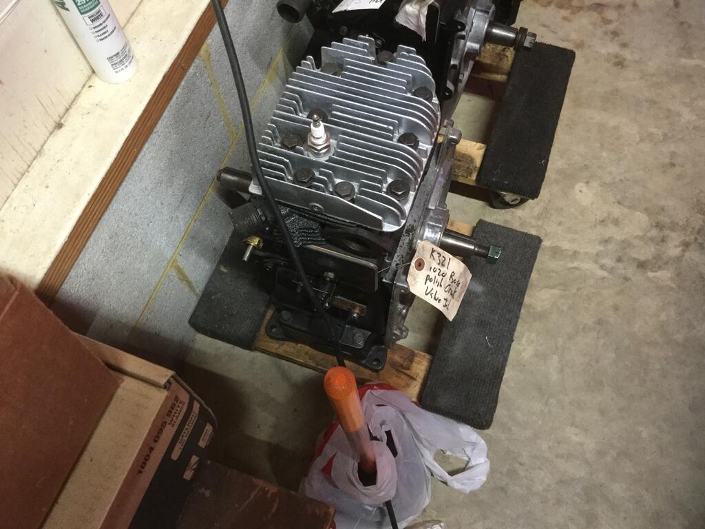

richmondred01 2,393 #19 Posted January 1, 2021 That’s a steep price for sure. I’ve got a complete rebuilt k321 and a rebuilt K321 long block. I also have a M14 in the shed that has yet to be rebuilt that I can have done in about 10 days. One thing to be careful of is who you buy your parts from. Not all suppliers are sell the same parts. Just because they have a fancy website and make YouTube videos doesn’t mean they sell quality parts. 2 Share this post Link to post Share on other sites
richmondred01 2,393 #20 Posted January 1, 2021 On 12/30/2020 at 6:24 PM, rjg854 said: I bought a rebuilt 16hp Kohler from @richmondred01 for less than that I wanna say he could do an 8hp for even less than that. Of course you'd have to work that out with him. A complete k181 would be more then half his quoted price for me to do. However, I have no overhead and I have no employees. He has to jack up his prices to stay afloat especially in PA who taxes you to breath anymore. 1 Share this post Link to post Share on other sites
