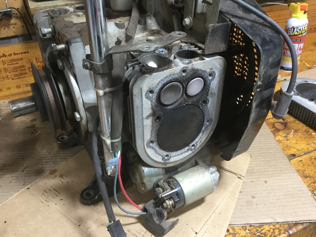

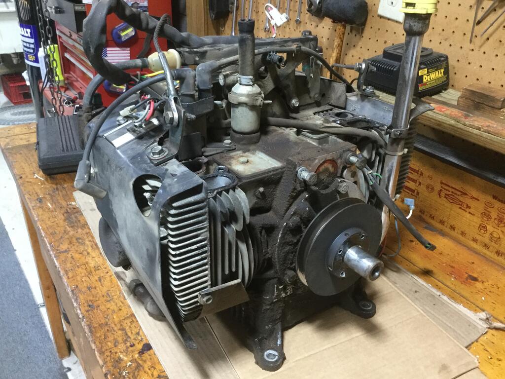

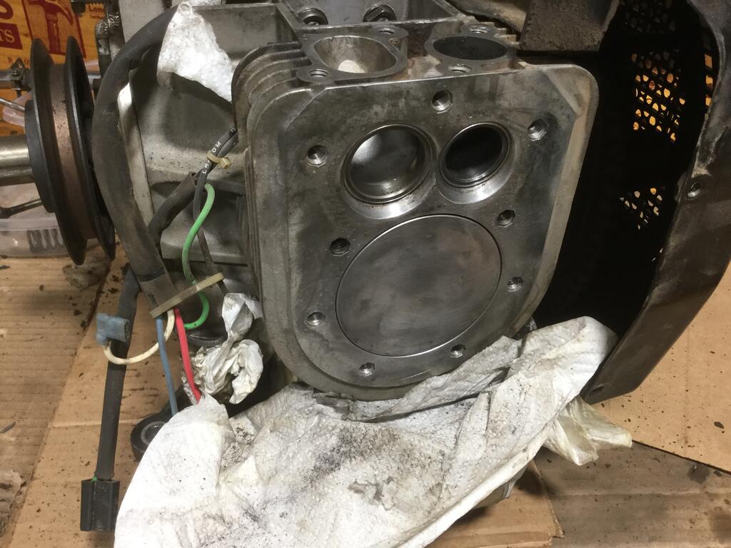

richmondred01 2,388 #14 Posted February 5, 2022 Every onan over 500 hours I planned on keeping, I would take it off the trailer, run it into the garage and pull the engine. I would pull the heads and valves, decarb, face the valves, new ignition module and replace all the gaskets I removed in the process. cheap insurance and good for another 500 hours. 1 2 1 Share this post Link to post Share on other sites
lynnmor 9,013 #15 Posted February 5, 2022 3 hours ago, richmondred01 said: Every onan over 500 hours I planned on keeping, I would take it off the trailer, run it into the garage and pull the engine. I would pull the heads and valves, decarb, face the valves, new ignition module and replace all the gaskets I removed in the process. cheap insurance and good for another 500 hours. I too, would go over a used one immediately after bring it home. I would set the limit higher at 750 hours unless there was some issue. These things are getting old so gaskets and intake valve seals need replaced. I bought one of those well maintained one owner 520H tractors that just had a valve adjustment, when I pulled the exhaust for glass beading and paint along with the intake for inspection and carburetor cleaning, I found the valve covers buried in solid debris that was there from day one. TRUST, but VERIFY. 2 Share this post Link to post Share on other sites
Handy Don 17,316 #16 Posted February 6, 2022 (edited) I have only limited experience with Onan's, but I agree with @lynnmor and @richmondred01 about preemptive maintenance -- the 700-750 hour threshold works for me. I especially concur about pulling the engine to do the work--that engine truly fills up the front of a WH and the on/off effort was more than repaid by ease of access for the maintenance, being able to closely examine all the bits and bobs, and a chance to do a thorough cleaning not only of the engine but the area behind and. below the hoodstand. (Important note: these engines are heavy so I highly recommend using a hoist attached before loosening the mounting bolts--the designers put those lift rings on there for a reason!) Edited February 6, 2022 by Handy Don 1 Share this post Link to post Share on other sites
