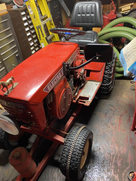

formariz 12,381 #1 Posted February 3, 2022 Since I am on street frequently plowing this should make it safer and easier on my neck. 8 7 Share this post Link to post Share on other sites
elcamino/wheelhorse 9,363 #2 Posted February 4, 2022 Love it , where did you get that mirror ? 1 Share this post Link to post Share on other sites
formariz 12,381 #3 Posted February 4, 2022 48 minutes ago, elcamino/wheelhorse said: Love it , where did you get that mirror ? Amazon.https://www.amazon.com/dp/B07ST9PTM9?psc=1&ref=ppx_yo2_dt_b_product_details Been looking for a while. This one works great Good size mirror and projects out just enough with plenty of adjustment. Mirror is a little like the ones on passenger side giving you a wider field of view. 2 1 Share this post Link to post Share on other sites
peter lena 10,103 #4 Posted February 4, 2022 @formariz looks good , think of other side mount , with more exposed bolts to go to , having that 3rd eye , would be good ,pete 1 Share this post Link to post Share on other sites
lynnmor 9,064 #5 Posted February 4, 2022 You can buy cheap golf cart mirrors and some magnets on the usual online sites. Buying the parts instead of paying for a vendor to do a 30 second assembly is the best way to go. I have them on my Kubota using larger magnets. video 3 Share this post Link to post Share on other sites

tunahead72 2,662 #7 Posted February 4, 2022 16 hours ago, formariz said: ... ... 12 hours ago, formariz said: ... projects out just enough with plenty of adjustment. Mirror is a little like the ones on passenger side giving you a wider field of view. Great ideas here, guys! If I'm reading the Amazon description correctly, there's a mounting bracket that bolts on to the tractor, and then the mirror can be removed and re-installed with the locking knob, no tools required? I only see one mirror on this tractor, two sounds like an even better idea. What passenger side mirrors are you referring to, any in particular or just the general concept? 28 minutes ago, lynnmor said: ... video You guys have to watch this video, even if you're not especially interested in the mirrors... There's an amusing little comment just about a minute in for residents of California. 2 minutes ago, kpinnc said: ... I'm finding the older I get, the harder it is to turn around far enough to see behind me. Arthur has settled in on my neck, and it flipping hurts. This has me thinking I need some rear view mirrors that can easily move from one machine to the other. I hear that loud and clear, but "flipping" isn't a strong enough word to describe the pain. I spend a good bit of time bush hogging fields at our place in Virginia, and like to back into corners to get them cleaned up nice. Turning around to see where I'm going gets seriously painful after a couple of corners, mirrors might help that situation a lot. They would probably also help on the rare occasions that I have to drive on the road (my current service guy lives just up the road a couple of miles, I'm constantly turning around to see if anyone's coming up behind me). 1 Share this post Link to post Share on other sites

formariz 12,381 #14 Posted February 4, 2022 (edited) 10 hours ago, tunahead72 said: Great ideas here, guys! If I'm reading the Amazon description correctly, there's a mounting bracket that bolts on to the tractor, and then the mirror can be removed and re-installed with the locking knob, no tools required? I only see one mirror on this tractor, two sounds like an even better idea. What passenger side mirrors are you referring to, any in particular or just the general concept? Yes these are readily removed from bracket. You can see the knob on my photo. There are two mirrors. I was going to use two, but the one on the right side would interfere with the plow turning lever unless i positioned it way up front. I want them where i can reach and adjust them if needed without getting up from tractor. I also realized that the on the left is really the important one anyway since it is the one used to check for vehicles coming up from behind in in the direction of traffic. If I am on the opposite lane against traffic i see them coming ahead anyway. Passenger side mirrors are a little convex showing a more panoramic view. These are ever so slightly like that. I backup as much as I go forward plowing my place. These will help greatly on that also. Some advice if you get these. They are made for the Jeep therefor arm is bent for that particular location on Jeep. I was reluctant in drilling the hood but realized that with a magnet every time I would be moving big piles they would come out of adjustment, so I drilled only the top hole ( in that location on my tractor with bracket vertical only one hole falls on hood anyway). That works out great due to the fact that tilting the bracket from vertical a few degrees will provide 100% adjustment such as if it was mounted on the Jeeps pillar. Edited February 5, 2022 by formariz 3 Share this post Link to post Share on other sites

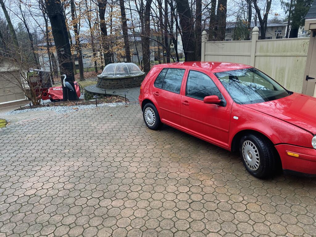

stevasaurus 23,861 #15 Posted February 4, 2022 Cas, that sure beats backing up gently until you hit something. 3 4 Share this post Link to post Share on other sites

formariz 12,381 #18 Posted February 4, 2022 41 minutes ago, stevasaurus said: Cas, that sure beats backing up gently until you hit something. Specially this poor guy. It’s the right color . They always seem to want to greet each other. 3 Share this post Link to post Share on other sites
