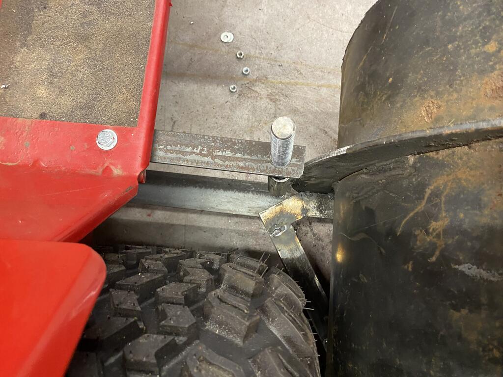

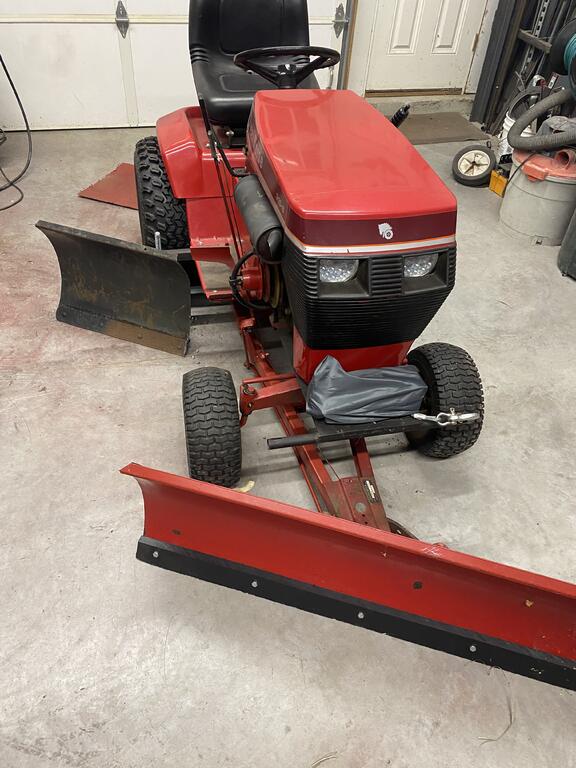

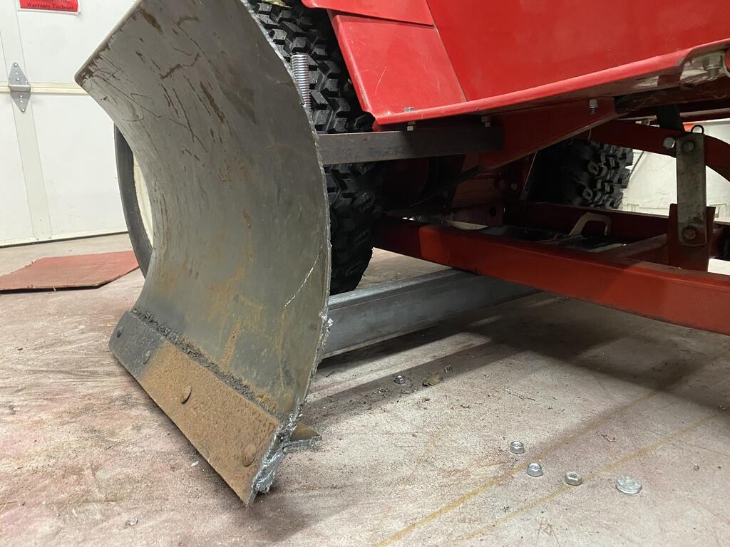

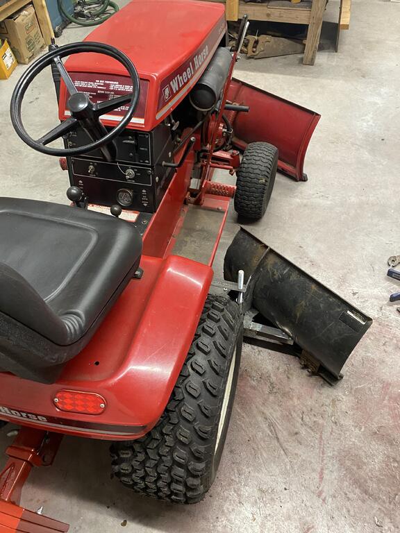

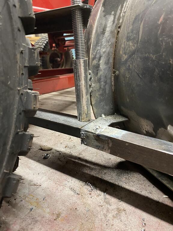

BeninCT 451 #1 Posted January 6, 2022 Been noodling on this for a while and finally took a shot at a mock up today. Hoping to catch all the stuff that seems to fall back under the rear tire plus widen my swath in an easily removable way. It rides on the factory plow frame and I will replace the all thread with a smooth rod that just rests in the holes under its own weight. The plow sits on the pavement out at an angle and you just reach down and lift it up about 1 1/2” and it will swing back and sit parallel to the tire. Prob just drag against the sidewall…. Anyway thought I would share. Weatherman got me all heated with the threat of .38” of snow Fri. Wanted to get a rough look at it and try it in the light stuff before committing to drilling the plow frame. Just used what I had- wish I had some C channel or smaller rect tube but the lower 2x2 angle should be fine and I think the upper 1 1/2” angle might need to be 2x2. Will add a few braces/gussets if I go all in. Thinking I would make 1 pass with it up then turn around and put it down and do the rest that way. It will actually come off the ground when I lift the front plow with the factory lever but I think I may do away wiht that to avoid too much stress on the plow frame. Going to need a centering stabilizer up front too. 2 7 Share this post Link to post Share on other sites
ebinmaine 77,092 #6 Posted January 6, 2022 I like it. Excellent design. I've thought about doing this in the past. I went a different direction in that I now have a 60" wide plow originally made by @wallfish. I've strengthened it a little and added a beast of a cutting edge. It's HEAVY. I tell you that to tell you this: 19 minutes ago, BeninCT said: It will actually come off the ground when I lift the front plow with the factory lever but I think I may do away with that to avoid too much stress on the plow frame I don't think you're going to be putting too much stress on the factory frame. Unless there's a specific benefit to keeping ONLY the wing down, keep the lift/lower as one motion. Just an FYI... If you become a site supporter you can post all the pics in one window, eliminate the ads, and it helps keep the place going... I'll be looking forward to seeing more of this project. 4 Share this post Link to post Share on other sites

Lee1977 7,545 #8 Posted January 6, 2022 My only concern is if there is any change in elevation of your drive it could cause you to get hung up. I had my grader blade on over at the farm it raises around 4". I was going across a terrace and got hung up. You can't lift 650 or 700 pounds of tractor to get unstuck. It was a real pain to remove the grader and get it out from under the tractor. You may need to made the side attachment real easy to remove and could still be hard to get it off if you get hung up. 2 1 Share this post Link to post Share on other sites
SylvanLakeWH 30,492 #9 Posted January 6, 2022 Good point, but I think it floats on the sleeve up /down? Share this post Link to post Share on other sites
BeninCT 451 #10 Posted January 6, 2022 Yes it will when that all thread is swapped for smooth 3/4 rod. My driveway is flat so very little elevation change and no lips to get stuck on. Rod will be like a duplex nail so you can just pull it straight up and the pplow blade will be off. Going to take some R&D lol. Thanks for the comments and likes! Will keep you updated. 2 Share this post Link to post Share on other sites

ri702bill 11,155 #16 Posted January 6, 2022 Creative design - my concern is the ability (or inability) to steer with all that side force from the snow. Ever notice what the tractor does while plowing with the blade angled and you push into the berm of snow at the end - it scoots the tractor to the side. You MAY need to add more weight to the front of the tractor to be able to steer better. 2 Share this post Link to post Share on other sites
ebinmaine 77,092 #17 Posted January 6, 2022 59 minutes ago, ri702bill said: You MAY need to add more weight to the front of the tractor to be able to steer better And roller chains if they aren't already on there 2 Share this post Link to post Share on other sites

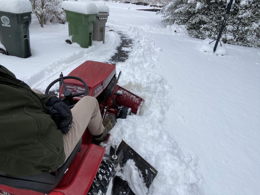

BeninCT 451 #23 Posted January 7, 2022 22 hours ago, peter lena said: @BeninCT was just thinking about a SPRING ASSIST TO THE SIDE PLOW . maybe use 3/8 threaded eyebolts , from side plow frame to main frame area . think about it , as the plow loads , the blade curve , pulls it to ground , if that drag was lessened with a spring pull , it would work to a lighter drag . you could always go back with a finish pass. I use CAR HOOD SPRINGS , for my plow frame and blower assist help . just an idea , but WATCHING THE PROBLEM START ,IS YOUR AWNSER , then you make a change to that . the side drag / imbalance can be reduced with spring tension , brain fart , pete Agree 100% and the lack of springs to let this flex a little is my biggest concern. My driveway is new asphalt that is very flat so will see how it goes. I have the springs from the plow that I could use if it proves to be needed but will see today. Looks like 8” of snow fell overnight in SW CT so going to give it a test ride today. Thx 1 1 Share this post Link to post Share on other sites
peter lena 9,727 #24 Posted January 7, 2022 @BeninCT yes today will be a good road test on that , that flat new driveway , can be tricky , traction , and grip on a new finish. you might even get someone else to very slowly try using the blade experiment , SO YOU CAN WATCH WHATS GOING ON , think its imbalance and function . anything that show's up , could be helped or worsen it , don't ask me how i know that ! done a lot of trials , hope you find the start of the fix , pete Share this post Link to post Share on other sites
