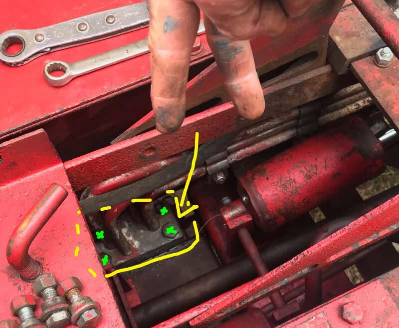

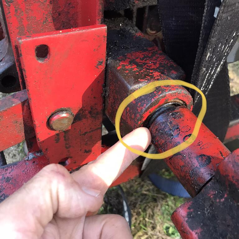

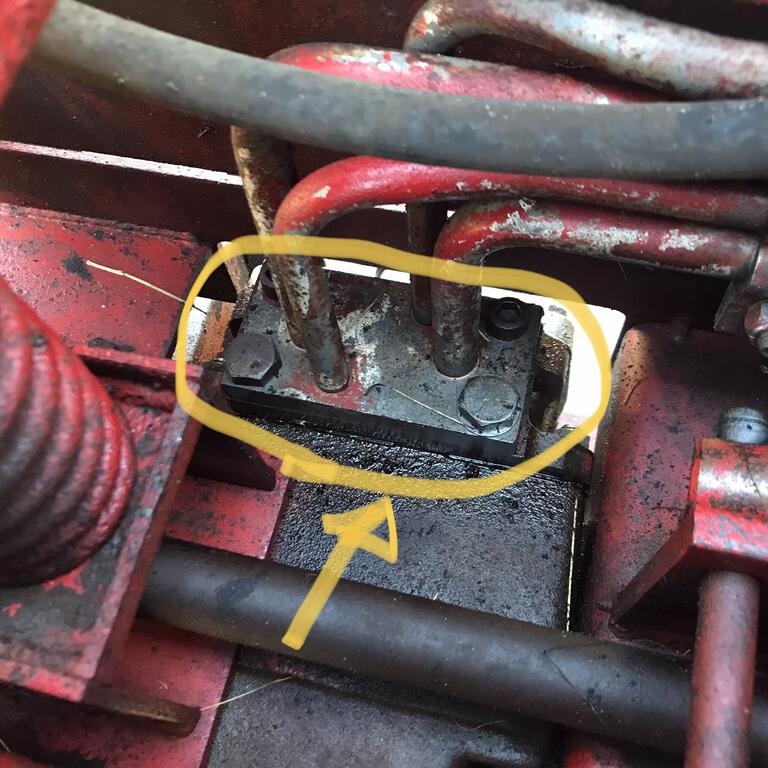

wheelhorse-c-161-1979 117 #1 Posted December 26, 2021 Hi everyone, My 1973 Auto 18 is having some major oil leak problems. Daveoman66 did an amazing job rebuilding it when I first bought it over a decade ago. But sadly I've been Unable to get a hold of him. She still runs but I need to add about 1 1/2 qt of oil to use it, as it all leaks out every day I use it! The leaks come out of the axle seals and also out of hydro line plate. I have no clue how to change the axle seals as I can't seem to even pull off the wheel mounts. Afraid to push too hard and break them. Also is there a gasket between where the hydro line plate is screwed in? Yes Ive looked at the the Sunstrand manuals, but it's overwhelming and not sure how I can solve this problem. Ive attached some pics and would love any guidance if any one can weigh in. 👍🙏🇺🇸 Happy New Year to all! May 2022 be even better than 2021 😳! Edited … Jacques Share this post Link to post Share on other sites
stevebo-(Moderator) 8,742 #2 Posted December 26, 2021 I edited the last comment … anyhow in terms of the auto 18. I had one that I did a total rear rebuild. Based on what you have there you may want to consider doing the same. Reason I say this is the auto 18 and all D series prior to 1976 came with non hardened pinion bolts. Do to that the bolts would sheer and the bolt heads would drop to the bottom of the case and the bull gear would push it out the bottom of the case. The other issue you have with that tranny design is the “pawl” e brake. When engaged and you forgot to disengage it you will sheer the gear. For those reasons I would pull it apart and replace the carrier bolts with grade 8 and at that time change the seals and bearings that need to be replaced. Lastly I would put a mechanical stop on the parking pawl so that you can never engage it. Before doing this work I would check the bottom of those cases and see if they have been repaired via weld or brazing. After a complete rebuild I found out I should not use the parking pawl 😳 1 Share this post Link to post Share on other sites

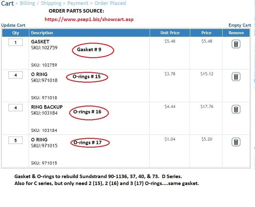

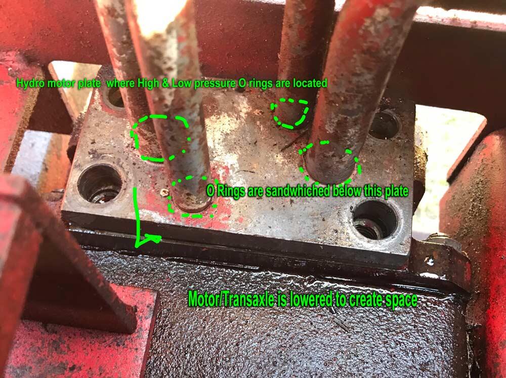

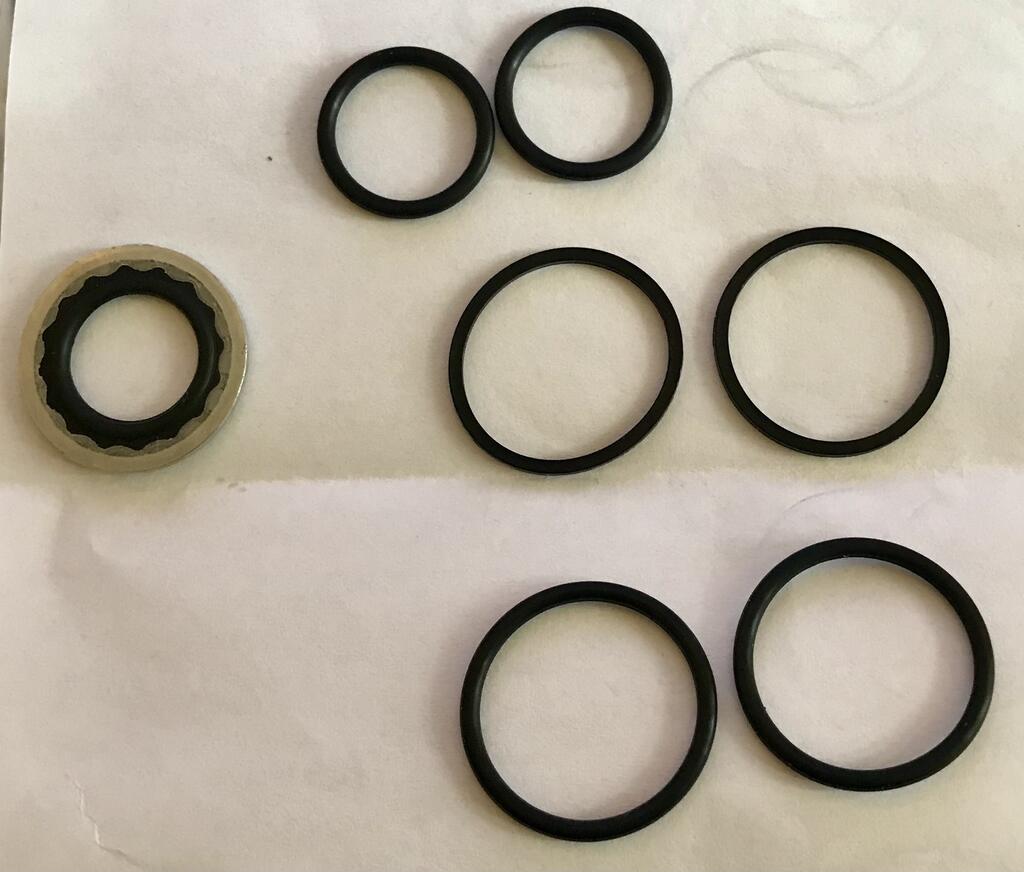

pfrederi 21,172 #3 Posted December 26, 2021 (edited) OK Pulling the hubs can be a big challenge (you have to pull from the back of the hub) ...but if the seals have been leaking maybe it will not be to bad. The manifold leak you show is not a gasket issue (there is none) there are 4 O rings 2 backer tings and a "special sealing washer". ( i can send you all of them no charge) Working on D series is not real easy. This is not a quick Saturday afternoon in the driveway project. Hate to say this but how would you rate your mechanical ability and availability of tools??? Edited December 26, 2021 by pfrederi 1 Share this post Link to post Share on other sites

953 nut 69,544 #5 Posted December 27, 2021 @stevebo has some good advise there. Ditch the three jaw puller before you bust the hub. Rent a large bearing splitter that will clear the hub. What is that spacer doing on your axle, it has eaten you axle seal. Once the hubs are off you can pull the spacers off and throw them away. 1 1 Share this post Link to post Share on other sites

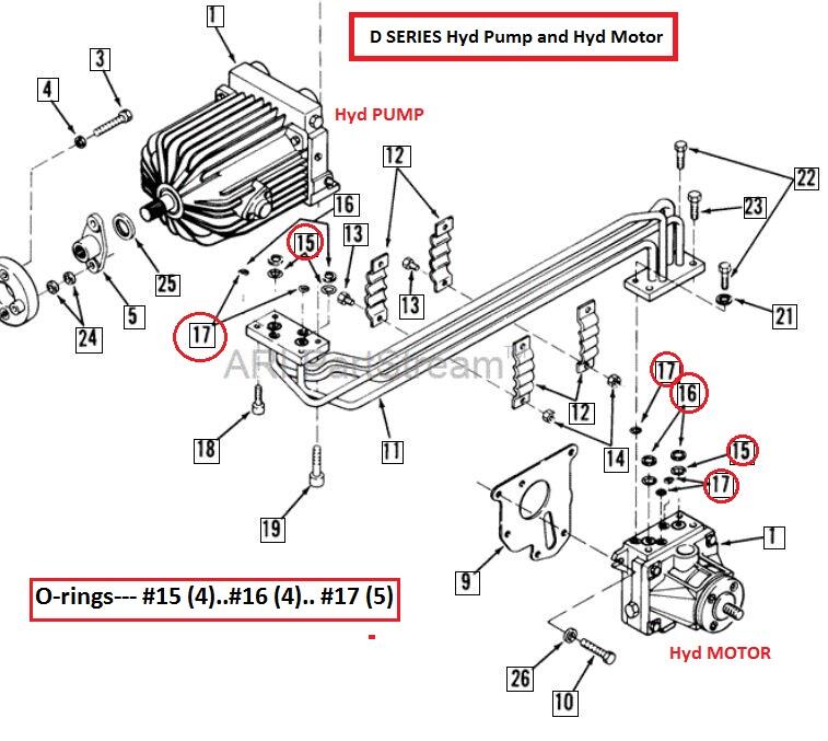

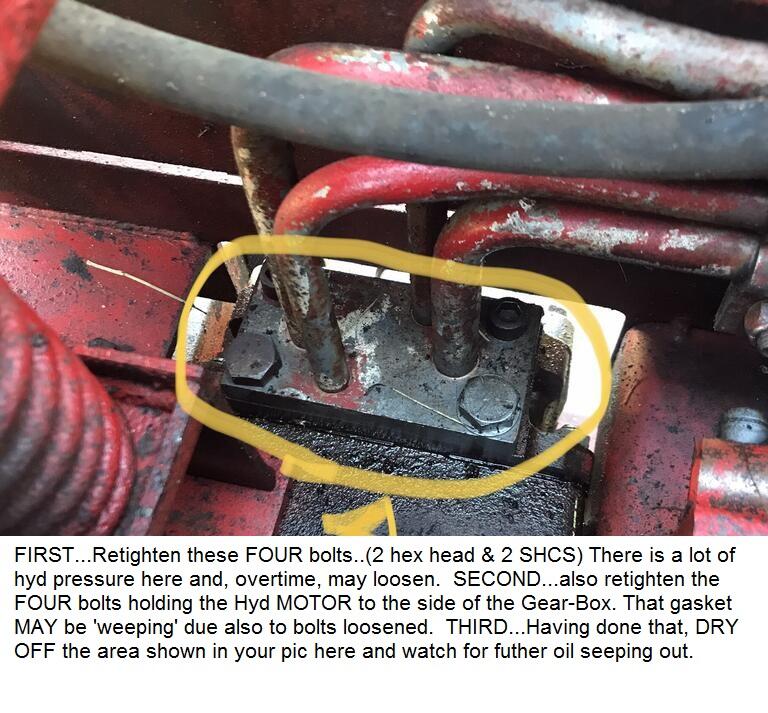

daveoman1966 3,884 #9 Posted December 27, 2021 I hear you Jacques... and have no idea why you can't contact me. Anyway... About the 18 Auto leaking. From your pic of the Hyd Line Plate... It appears to me that your trans oil is 'weeping' at the plate...causing the wet messy area on top. When I rebuilt the Sundstrand pump, I sent new O-rings and gasket to your mechanic in New York. To replace these is NOT a simple task as noted by pfrederi. Before replacing the O-rings and Seal, may I suggest that you FIRST retighten the 4 bolts holding that plate...as well as the 4 bolts holding the Hyd Motor to the transmission case. Things loosen up over time and this MAY be an easy and quick way to stop the oil seeping. After you tighten things up, wipe the area dry and watch for further seeping. As for the really bad axle seals you have...Don't use any sort of 3-jaw puller...likely to break a hub. Instead, rent the Big Bearing separator (Auto Zone). The axle seal part number is 6449 readily available and there are Youtube videos of how to remove and install new seals. Finally the 'spacer' shown on your axles are OEM axle covers and are shown in the Toro MPV as part # 103406 in the 18-Auto schematics (13-16 in this schematic). You can see all the schematics for the 18 Auto here... (using model # 1-0620) https://lookup3.toro.com/partdex/back2lst.cfm?xCaller=Toro&o=2&x=580 You can, of course contact me at: daveoman@windstream.net 2 Share this post Link to post Share on other sites

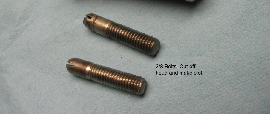

"Manic-Mechanic" 1,486 #10 Posted December 27, 2021 (edited) I would also like to chime in here. Should you have to replace the seals on the manifold plate there are a set simple set of studs that can be made to align the plate so as to prevent the slippage of the series of seals between the manifold plate and the pump. The Service manual depicts these very clearly. Edited December 27, 2021 by "Manic-Mechanic" 3 1 1 Share this post Link to post Share on other sites
pfrederi 21,172 #11 Posted December 27, 2021 Definitely follow Dave's advice and just clean up the area and retighten first. I am sending you the Orings and sealing washer replacement today. If you have to replace things note the backer rings have concave surface on one side..that goes against the other O-ring a little grease helps hold them in place during assembly. Axle seal is CR/SKF 11124 1 1 Share this post Link to post Share on other sites
wheelhorse-c-161-1979 117 #12 Posted December 27, 2021 1 hour ago, "Manic-Mechanic" said: I would also like to chime in here. Should you have to replace the seals on the manifold plate there are a set simple set of studs that can be made to align the plate so as to prevent the slippage of the series of seals between the manifold plate and the pump. The Service manual depicts these very clearly Hi Sir, Thanks for chiming in! And the pictures you show are from a manual I do not have. I have Sunstrand pt1 thru 4. Which manual are you using that I should be downloading? Thank you again for that helpful tip! All the best, Jacques 1 1 Share this post Link to post Share on other sites

wheelhorse-c-161-1979 117 #14 Posted December 27, 2021 7 hours ago, daveoman1966 said: Before replacing the O-rings and Seal, may I suggest that you FIRST retighten the 4 bolts holding that plate...as well as the 4 bolts holding the Hyd Motor to the transmission case. Things loosen up over time and this MAY be an easy and quick way to stop the oil seeping. After you tighten things up, wipe the area dry and watch for further seeping. Hi Dave, Its so great to hear from you again. Yes I am one of the proud Americans who has been banned from FB. 😇🙏✊🇺🇸 An exciting turn of events as I am now on board with 45's Class Action lawsuit against big tech censorship. 👍⚖️ I left you a PM of my new contact info. I'll send you an email as well. Jacques_usa@mac.com Two years ago the tractor broke down in the snow deep in the woods. The plate had come loose and the O-rings blew. I cleaned it all up in 20F weather and put in the best O rings I could find. It worked well enough to get the tractor operational, though a constant but manageable leak continued. Now that I am safely in LA, ( Lower Alabam') I have the old girl hoisted up with ample room to work on her. Than you again for your steadfast help and knowledge, that has kept my '73 running every day on little farm! To be continued by private email! Jacques 1 Share this post Link to post Share on other sites

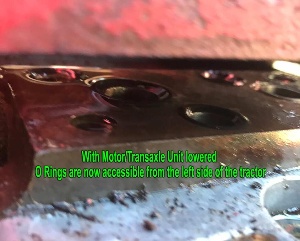

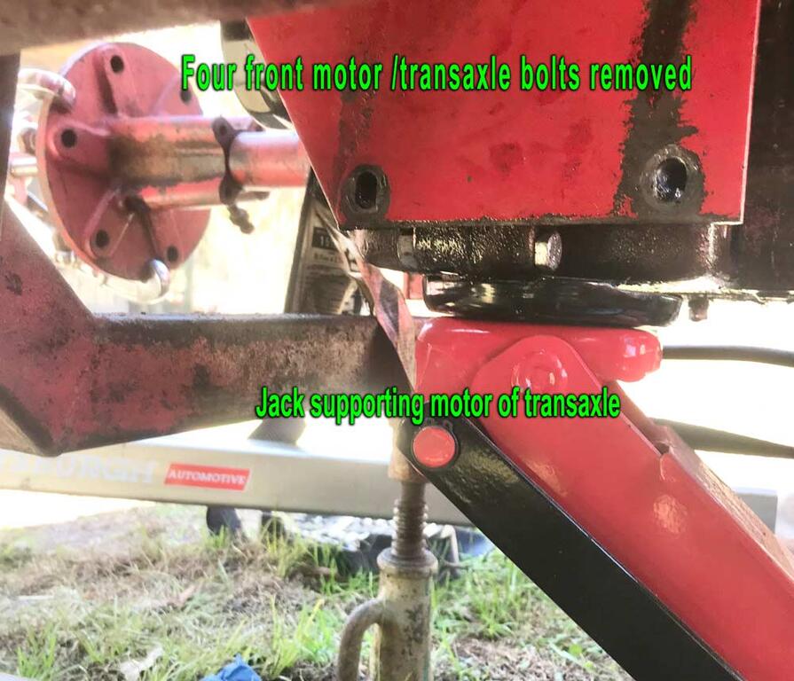

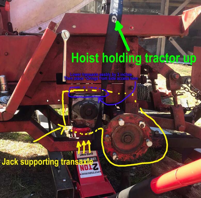

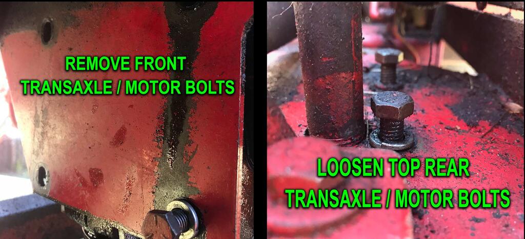

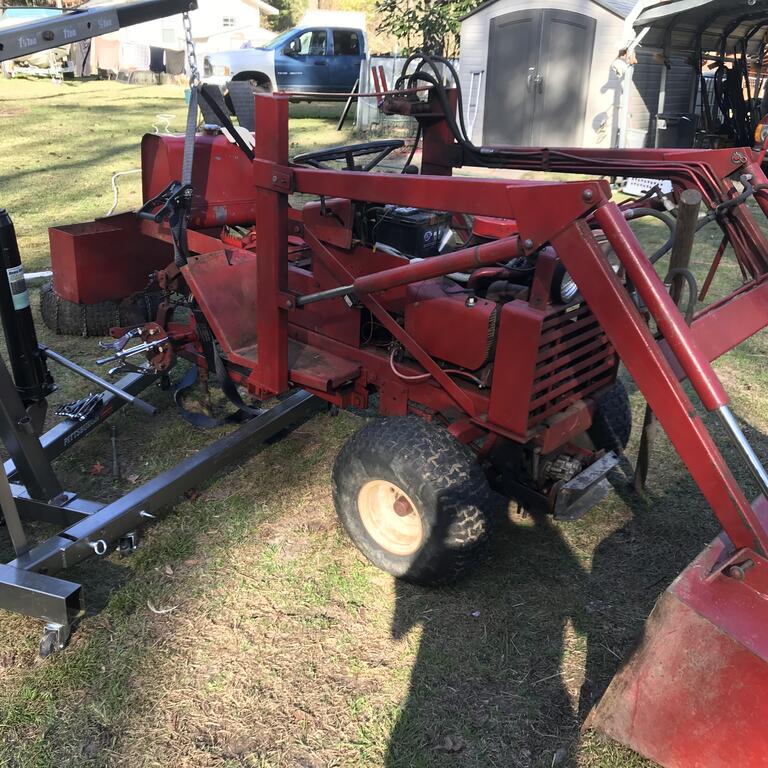

wheelhorse-c-161-1979 117 #23 Posted February 2, 2022 Howdy to all! Update on the Auto 18 axle leak and the hydrostatic oil leak... ( I hope all is well with all who are fighting the arctic cold & snow. I do miss selling off my C-161 with the snow thrower. It was awesome. The cold and endless winters not so much! ) So eternal thanks to Pfrederi on this blog for his amazing help in actually sending me the O Rings you see a few posts above! The O-Rings seem like a 3 minute job at first glance... Remove 4 screws, Lift the hydraulic plate, remove old rings, clean up area and put new O-Rings in and put the bolts back in, and job done. Lol Except that accessing the O-Rings from above where the seat was removed, provides virtually No visibility & No room to put them in! DISCLAIMER: There might have been a much easier way to do this, but this is how I managed the O-Ring replacement! lol So I realized that instead of removing all the side plates of the tractor, I decided instead to remove 8 (eight) 9/16" bolts that hold the transaxle in place ( four bolts accessible from the rear and four bolts from the front) I could gently lower the transaxle and it's hydraulic plate that hold the O-Rings, by about 3 inches or so, giving me room to insert the new O-Rings to the high pressure ports and low pressure ports. Being the only person on this job, I realized, before lowering the transaxle that there was no way I would be able to line up the bolts again, if I simply dropped the transaxle, as it is much to heavy for one person.. Therefore, I ensured that the transaxle would stay in place by loosening the four top bolts, and replacing two of them temporarily with Two Longer bolts as vertical guides, which would give me additional space to seat the new O-Rings in place from the left side of the tractor. The plate would become visible and accessible from the side after lowering the transaxle. The hoist with the strap, held up the rear of the tractor, while, the hydraulic jack, gently supported the transaxle which I lowered after loosening the bolts. Once the O rings where seated with a little grease, as per the manual, I then jacked up the transaxle sufficiently to get all four hydro plate bolts partially screwed in, and then continued jacking up the transaxle, until i could remove the long bolt guides and then tighten up all 8 bolts to secure the transaxle assembly in place. Following a little prayer, I then refilled the Sunstrand hydro with oil, and started the tractor in place while still cradled by the hoist. Miraculously, there was no leak, and thanks to Pfrederi and ManicMechanic, the first oil leak source seems fixed!!! Now it's time to address the major leak coming from the transaxle seals that are shot! To be continued! 1 3 Share this post Link to post Share on other sites
